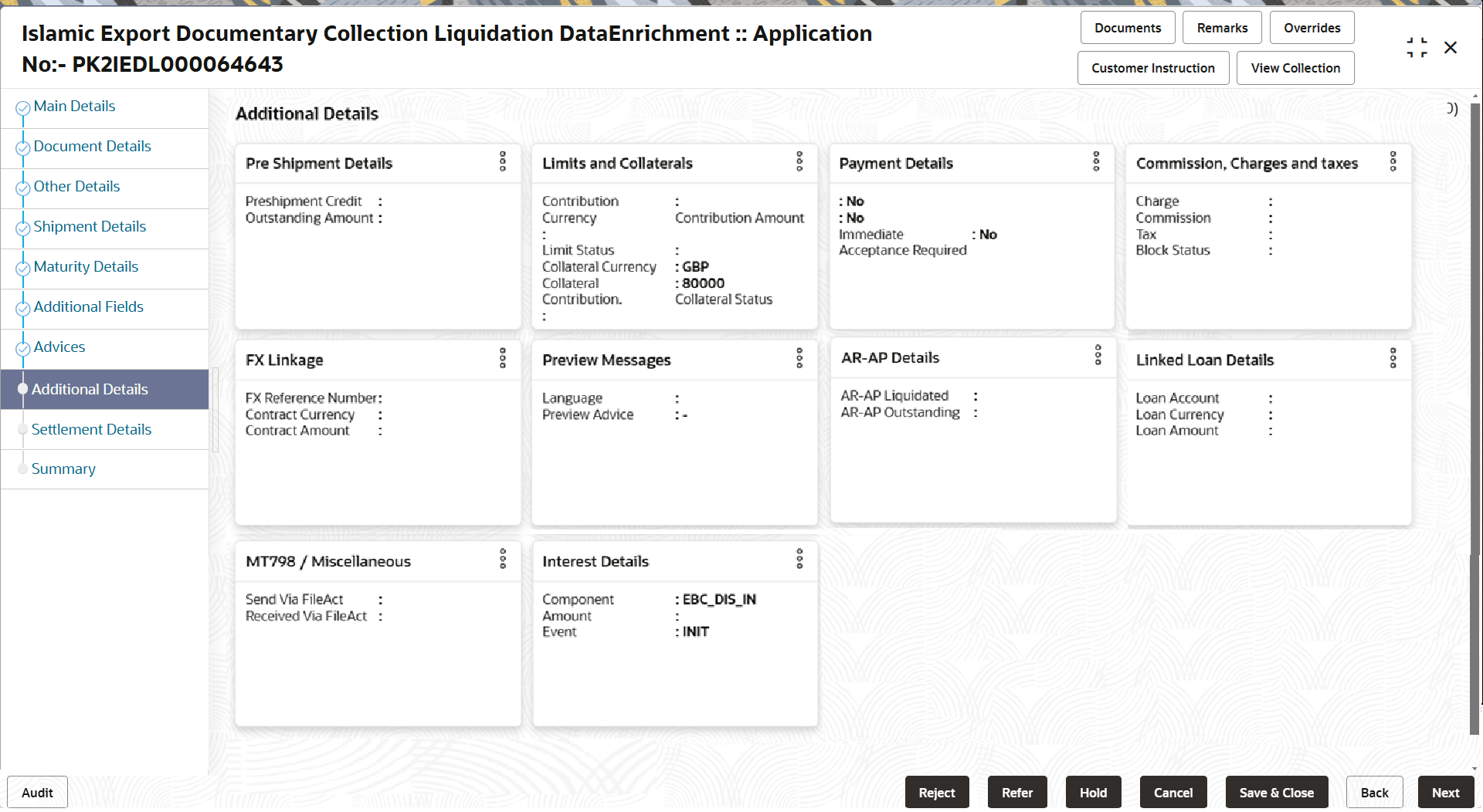

3.3.8 Additional Details
This topic provides the systematic instructions to capture the additional details
A Data Enrichment user can verify and enter the basic additional details available in the Islamic Export Collection Liquidation.
  1. On Additional Details screen, click View on any Additional Details tile to view the details.

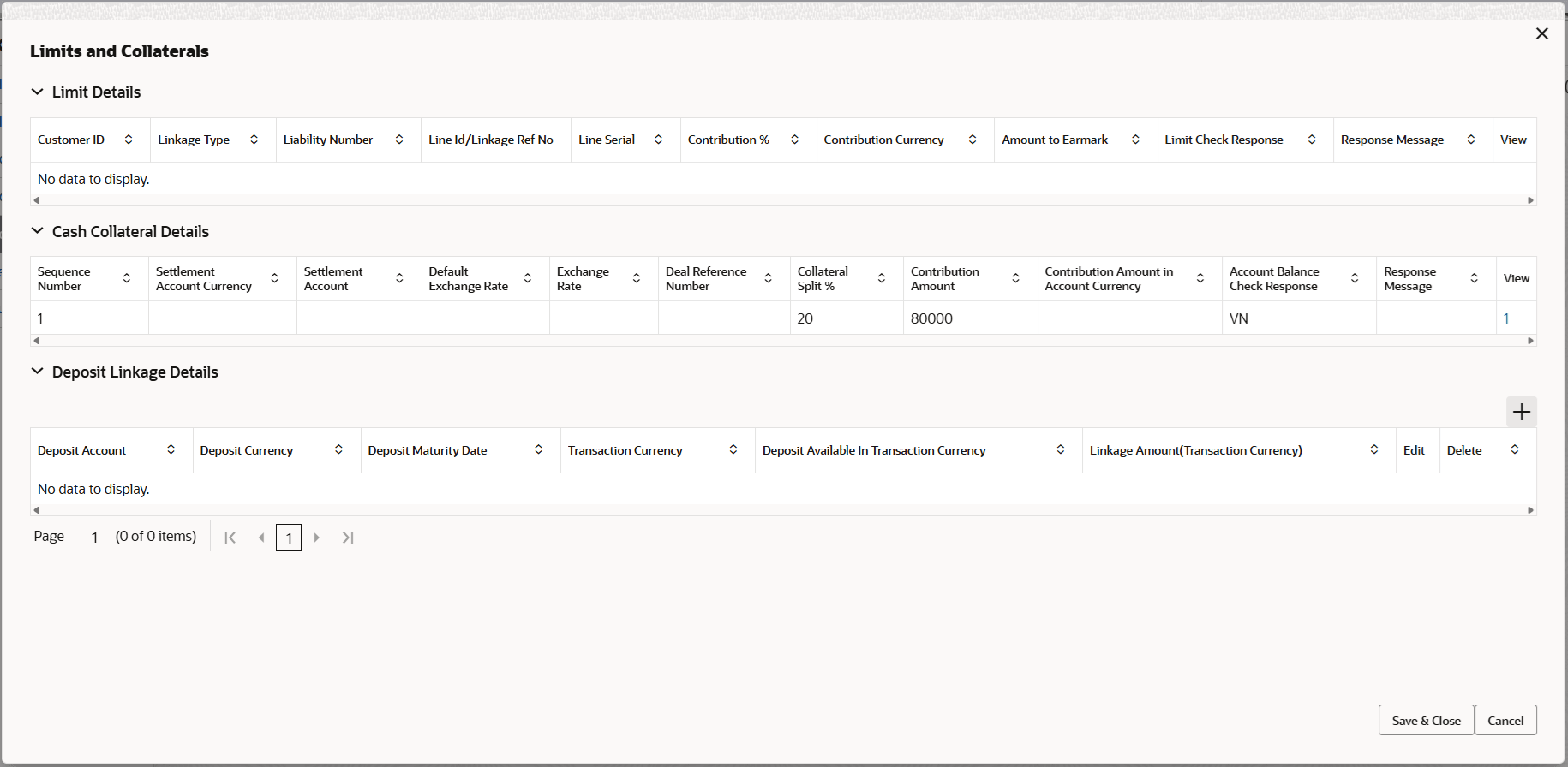

    Limits and Collaterals
    Limit availability needs to be checked if amendment involves increase in amount or tolerance or both.
    On Approval, system should not release the Earmarking against each limit line and system should handoff the “Limit Earmark Reference Number “to the back office. On successful handoff, back office will make use of these “Limit Earmark Reference Number” to release the Limit Earmark done in the mid office (OBTFPM) and should Earmark the limit from the Back office.
    In case multiple Lines are applicable, Limit Earmark Reference for all lines to be passed to the back office.
    Description of delimitdetails.png follows
    Figure 3-18 Collateral Details
    Collateral availability needs to be checked if amendment involves increase in amount or tolerance.
    Description of Figure 3-18 follows
    Description of "Figure 3-18 Collateral Details"

    Table 3-19 Limit Details - Field Description
    Field Description
    Limit Details
    Click + plus icon to add new limit details.
    Below fields are displayed on the Limit Details pop-up screen, if the user clicks plus icon.
    Customer ID This field displays the applicant’s/applicant bank customer ID defaulted from the application.
    Linkage Type Select the linkage type.
    Linkage type can be:
    • Facility
    • Liability
    By default Linkage Type should be Facility.
    Contribution % System will default this to 100%. User can modify, if contribution is more than 100%. System will display an alert message, if modified.
    Once contribution % is provided, system will default the amount.
    System to validate that if Limit Contribution% plus Collateral% is equal to 100. If the total percentage is not equal to 100 application will display an alert message.
    The collateral % maintained for the customer is defaulted into the Collateral Details screen. If collateral % is not maintained for the customer, then system should default the collateral % maintained for the product. User can modify the defaulted collateral percentage, in which case system should display a override message “Defaulted Collateral Percentage modified.
    Liability Number Click Search to search and select the Liability Number from the look-up.
    The list has all the Liabilities mapped to the customer.
    Contribution Currency This field displays the contribution currency.
    Line ID/Linkage Ref No Click Search to search and select from the various lines available and mapped under the customer id gets listed in the drop-down.
    LINE ID-DESCRIPTION will be available for selection along with Line ID. When you click on 'verify', the system will return value if the limit check was successful or Limit not Available. If limit check fails, the outstanding limit after the transaction value will be shown in the limit outstanding amount.
    The user can click the Line Id link to view the limit details.
    User can also select expired Line ID from the lookup and on clicking the verify button, system should default “The Earmarking cannot be performed as the Line ID is Expired” in the “Response Message” field.
    This field is disabled and read only, if Linkage Type is Liability.
    Limit/Liability Currency This field displays the limit currency, when the user select the Liability Number.
    Limits Description This field displays the limits description.
    Limit Check Response This field displays the limit check response.
    Response can be ‘Success’ or ‘Limit not Available’ based on the limit service call response.
    The value in this field appears, if you click the Verify button.
    Amount to Earmark Amount to Earmark will default based on the contribution %.
    User can change the value.
    Expiry Date This field displays the date up to which the Line is valid.
    Limit Available Amount This field displays the value of available limit, i.e., limit available without any earmark. The Limit Available Amount must be greater than the Contribution Amount.
    Response Message This field displays the detailed response message.
    ELCM Reference Number This field displays the ELCM reference number.
    Limit Details grid Below fields appear in the Limit Details grid along with the above fields.
    Line Serial Displays the serial of the various lines available and mapped under the customer id.
    This field appears on the Limits grid.
    View Click the link to view the Limit Details.

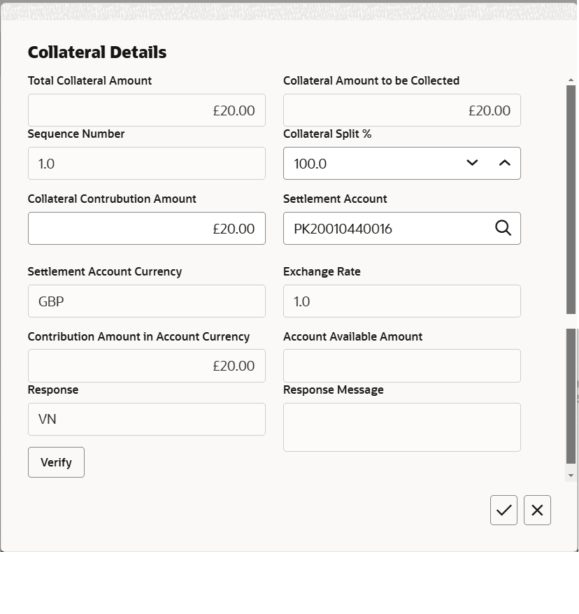

    Cash Collateral Details Click + plus icon to add new collateral details.
    Provide the collateral details based on the description provided in the following table:
    Below fields are displayed on the Collateral Details pop-up screen, if the user clicks plus icon.
    Edit Click edit link to edit the collateral details.
    Total Collateral Amount Read only field.
    This field displays the total collateral amount provided by the user.
    Collateral Amount to be Collected Read only field.
    This field displays the collateral amount yet to be collected as part of the collateral split.
    Sequence Number Read only field.
    The sequence number is auto populated with the value, generated by the system.
    Collateral Split %
    Specify the collateral split% to be collected against the selected settlement account.
    Collateral Contribution Amount Specify the collateral amount to be collected against the selected settlement account.
    User can either provide the collateral % where the collateral amount will be auto populated or modifying the collateral amount will auto correct the collateral %.
    Settlement Account Click Search to search and select the settlement account for the collateral.
    Settlement Account Currency Read only field.
    This field displays the settlement account currency defaulted by the system.
    Default Exchange Rate Read only field.
    This field displays the maintained exchange rate when the component currency differs from the settlement account currency.

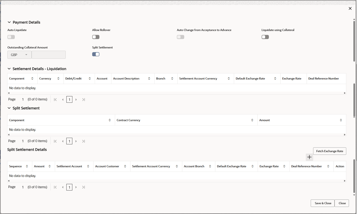

    Exchange Rate
    Specify Exchange Rate upto 4 decimal places, if applicable. System rounds off values beyond 4 decimals.
    • Do not specify Exchange Rate for deferred charges, commission, and tax components under AR-AP.
      System restricts input for these components.
    • Specify Exchange Rate within the allowed range.
      System allows save without any message.
    • If Exchange Rate exceeds the allowed range but is within the override band. Click Save and Close.
      System displays the override message - "Exchange Rate has exceeded Override Limit"
      Proceed after accepting the override.
    • If Exchange Rate exceeds the stop limit. Click Save and Close.
      System displays the error message - "Exchange Rate has exceeded Stop Limit"
      System does not allow the transaction to proceed.
    Note: In Payment Details section, except for liquidation components (e.g., BILL_LIQ_AMTEQ and LCGCLM_LIQD), settlement account currency, exchange rate, default exchange rate, and deal reference number fields are not editable for all other components.
    Deal Reference Number
    Deal Reference Number allows up to 30 characters. Entries longer than 30 characters aren not allowed.
    Deal Reference Number can be specified only when Exchange Rate has a value. If Exchange Rate is blank and a Deal Reference Number is specified, the system displays: “Cannot add Deal Reference without specifying the Exchange Rate value.”
    Contribution Amount in Account Currency Read only field.
    This field displays the contribution amount in the settlement account currency as defaulted by the system.
    Account Available Amount Read only field.
    System populates the account available amount on clicking the Verify button.
    Response Read only field.
    System populates the response on clicking the Verify button.
    Response Message Read only field.
    System populates the response message on clicking the Verify button.
    Verify Click to verify the account balance of the Settlement Account.
    Save & Close Click to to save and close the record.
    Cancel Click to cancel the entry.
    Cash Collateral Details grid Below fields appear in the Cash Collateral Details grid along with the above fields.
    Collateral % Specify the percentage of collateral to be linked to this transaction. If the value is more than 100% system will display an alert message.
    Contribution Amount This field displays the collateral contribution amount.
    Account Balance Check Response Read only field.
    System populates the account balance check response on clicking the Verify button.

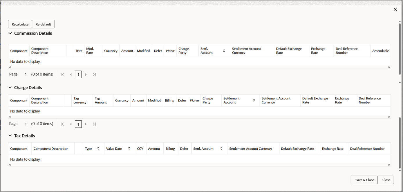

    Charge Details
    This section displays charge details.
    For more information on fields, refer to the field description table below.
    Table 3-20 Charge Details - Field Description
    Field Description
    Commission Details This section displays the commission details.
    Component This field displays the commission component.
    Rate This field displays the rate that is defaulted from product.
    The commission rate, if available in Back Office defaults in OBTFPM. The user is able to change the rate.
    If flat commission is applicable, then commission amount defaulted from back office is modifiable by the user. Rate field will be blank and the user cannot modify the Rate field.
    Modified Rate From the default value, if the rate is changed the value gets updated in this field.
    Currency This field displays the currency in which the commission have to be collected.
    Amount This field displays the amount that is maintained under the product code.
    The commission rate, if available in Back Office defaults in OBTFPM. The user is able to change the rate, but not the commission amount directly. The amount gets modified based on the rate changed and the new amount is calculated in back office based on the new rate and is populated in OBTFPM.
    Modified Amount From the default value, if the amount is changed, the value gets updated in the modified amount field.
    Defer If enabled, charges/commissions has to be deferred and collected at any future step.
    Waive Based on the customer maintenance, the charges/commission can be marked for Billing or Defer.
    If the defaulted Commission is changed to defer or billing or waive, system must capture the user details and the modification details in the ‘Remarks’ place holder.
    Charge Party Charge party is 'Applicant' by default. User can change the value to Beneficiary.
    Settlement Account Select the settlement account.
    Exchange Rate

    Amendable Displays if the field is amendable or not.
    Charge Details This section displays the charge details.
    Component This field displays the charge component type.
    Tag Currency This field displays the tag currency in which the charges have to be collected.
    Tag Amount This field displays the tag amount that is maintained under the product code.
    Currency This field displays the currency in which the charges have to be collected.
    Modified From the default value, if the rate is changed or the amount is changed, the value gets updated in the modified amount field.
    Billing If charges are handled by separate billing engine, then by selecting billing the details to be available for billing engine for further processing.
    On simulation of charges/commission from Back Office, if any of the Charges/Commission component for the customer is ‘Billing’ enabled, ‘Billing’ toggle for that component should be automatically enabled in OBTFPM.
    The user can not enable/disable the option, if it is de-selected by default.
    This field is disabled, if ‘Defer’ toggle is enabled.
    Defer If charges have to be deferred and collected at any future step, this check box has to be selected.
    On simulation of charges/commission from Back Office, if any of the Charges/Commission component for the customer is AR-AP tracking enabled, ‘Defer’ toggle for that component should be automatically checked in OBTFPM.
    The user can enable/disable the option the check box. On de-selection the user has to click on ‘Recalculate’ charges button for re-simulation.
    Waive Enble the toggle, if charges has to be waived.
    Based on the customer maintenance, the charges should be marked for Billing or for Defer.
    This field is disabled, if Defer toggle is enabled.
    Charge Party Charge party is applicant by default. User can change the value to beneficiary.
    Settlement Account Indicates the settlement account.
    Exchange Rate
    Tax Details This section displays the charge details.
    The tax component is calculated based on the commission and defaults if maintained at product level. User cannot update tax details and any change in tax amount on account of modification of charges/ commission will be available on click of Re-Calculate button or on hand off to back-end system.
    Component This field displays the tax component.

    Payment Details
    Description of depaymentdetails1.png follows
    Table 3-21 Payment Details - Field Description
    Field Description
    Auto Liquidate Read only field.
    Auto Liquidation enables liquidation of the bill on the due date automatically from the back office system.
    Allow Rollover Enable this option to allow rollover.
    Auto Change from Acceptance to Advance Read only field.
    This flag indicates whether an Acceptance type of bill should be automatically converted into an Advance type of bill on its liquidation date.
    This option is applicable only for the bills that are co-accepted by the bank.
    Liquidate using Collateral Enable this option to liquidate using Collaterals.
    Outstanding Collateral Amount Read only field.
    The outstanding collateral amount along with the currency.
    Split Settlement Enable the option as ‘On’ to select more than one account for settlement (Split Settlement) for the liquidation of an import or export drawing or collection bill.
    Disable the option as ‘Off’ Disables the user to select more than one account for settlement (Split Settlement) for the liquidation of an import or export drawing or collection bill.
    Avalization Enable the option as ‘On’ for availization.
    Settlement Details - Liquidation This section displays the Settlement Details - Liquidation.
    Component This field displays the component based on the product selected.
    Currency This field displays the currency for the component.
    Debit/Credit This field displays the debit/credit indicators for the components.
    Account This field displays the account details for the components.
    Account Description This field displays the description of the selected account.
    Branch This field displays the branch of the selected account.
    Account Currency This field displays the currency for all the items based on the account number.
    Original Exchange Rate System displays the Original Exchange Rate as simulated in settlement details section from OBTF.
    Exchange Rate The exchange rate for the settlement.
    Exchange Rate
    Split Settlement This section displays the Split Settlement details.
    Contract Currency This field displays the default currency for the component.
    Amount This field displays the amount for each component. This is populated from the transaction details of the drawing.
    Split Settlement Details The user can click + to add multiple Split Settlement Details.
    Sequence Indicates the sequence of the settlement details.
    Amount Specify the amount for the split settlement.
    Settlement Account Click Search to search and select the settlement account.
    Account Customer This field displays customer account based on the selected settlement account.
    Account Branch This field displays branch of the customer’s account
    Exchange Rate Click the Fetch Exchange Rate button, the field displays the exchange rate for the split settlement.
    Action Click Edit icon to edit the Split Settlement.
    Click Delete icon to delete the Split Settlement.

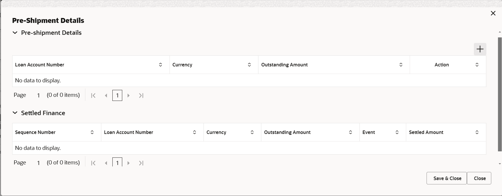

    Pre-Shipment Details
    This section links an existing Preshipment Credit.
    Description of depreshipmentdetails.png follows
    Table 3-23 Pre-Shipment Details - Field Description
    Field Description
    Pre Shipment Details The user can click + to add multiple Pre Shipment Details.
    Loan Account Number Click Search to search and select the pre-shipment loan account number.
    If there are any pre-shipment credits available for the selected pre-shipment credit number, application will display message: There are earlier pre-shipment credit/s. Do you want to continue?
    Currency This field displays the currency of the pre-shipment loan account number.
    The user can change the currency.
    Outstanding Amount This field displays the pre-shipment credit outstanding amount.
    The user can change the outstanding amount.
    Action Click Edit icon to edit the pre-shipment details.
    Click Delete icon to delete the pre-shipment details.
    Setteled Finance This section displays the Setteled Finance details.
    Sequence Number This field displays the sequence of the settled loan.
    Loan Account Number This field displays the settled loan account number.
    Currency This field displays the currency of the settled loan account number.
    Outstanding Amount This field displays the outstanding amount.
    Event This field displays the event.
    Setteled Amount This field displays the settled amount.
  4. Click Save and Close to save the details and close the screen.

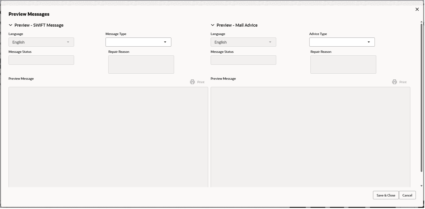

    Preview
    The bank user can view a preview of the outgoing SWIFT message and advise simulated from back office.Description of deadditionaldetailspreview1.png follows
    Table 3-24 Preview - Field Description
    Field Description
    Preview SWIFT Message This section displays the Preview SWIFT Message details.
    Language Select the language for the SWIFT message.
    Message Type Select the message type.
    Message Status Read only field.
    Display the message status of draft message of liquidation details.
    Repair Reason Read only field.
    Display the message repair reason of draft message of liquidation details.
    Preview Message This field displays a preview of the draft message.
    Preview Mail Device This section displays the Preview Mail Device details.
    Language Select the language for the advice message.
    Advice Type Select the advice type.
    Print (SWIFT messages)
    If the required SMS rights are available, user can print SWIFT message previews and enquiry views, and Mail advice previews and enquiry views.
    Printed output matches the back-office format and includes a watermark based on context: DRAFT MESSAGE/DRAFT ADVICE for previews and midoffice enquiries, and COPY MESSAGE/COPY ADVICE for back-office enquiries.
    Note: If printing fails due to a technical issue (for example, printer, workstation, or connectivity issues), the system displays the error message: “Unable to Print. Try again later !”
    Print (Mail advices) If the required SMS rights are available, user can print Mail advice previews and enquiry views. Printed output matches the back-office format and includes a watermark based on context: DRAFT MESSAGE/DRAFT ADVICE for previews and midoffice enquiries, and COPY MESSAGE/COPY ADVICE for back-office enquiries.
  5. Click Save and Close to save the details and close the screen.

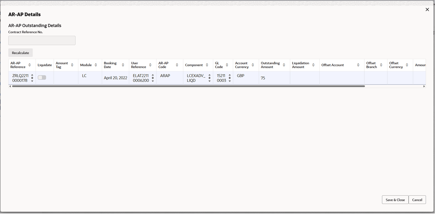

    This section displays the account receivable and account payable (AR/AP) records for the contract, using the data elements defined for the tile.
    Figure 3-21 AR-AP Outstanding Details
    Table 3-25 AR-AP Outstanding Details - Field Description
    Field Description
    Contract Reference System displays the Contract Reference.
    Recalculate Click Recalculate to apply updated values such as Negotiated Rate or charge changes. System recalculates all amounts and refreshes the Settlement and related details accordingly.
    AR-AP Reference System displays the reference number of the Account Receivable.
    Liquidate Select the toggle to mark the Account Receivable component for liquidation.
    Amount Tag System displays the Amount Tag associated with the receivable component.
    Module System displays the Module from which the Account Receivable is generated.
    Booking Date System displays the date on which the Account Receivable was created.
    User Reference System displays the User Reference number associated with the receivable entry.
    AR-AP Code System displays the AR-AP Code defined for the receivable component.
    Component System displays the charge or Component component for which the receivable is generated.
    GL Code System displays the General Ledger account associated with the receivable component.
    Account Currency System displays the currency of the receivable component..
    Outstanding Amount System displays the Outstanding Amount available for liquidation.
    Liquidation Amount Specify the amount to be liquidated for the selected receivable component.
    Offset Account Specify the account to be debited for liquidation of the receivable amount.
    Offset Branch System displays the branch associated with the selected offset account.
    Offset Currency System displays the currency of the selected offset account.
    Amount System displays the debit amount calculated based on the liquidation amount and exchange rate.
    Exchange Rate System displays the system derived exchange rate between receivable currency and offset account currency.
    Negotiated Rate Specify a negotiated exchange rate to override the system derived rate for the transaction.
  6. Click Save and Close to save the details and close the screen.

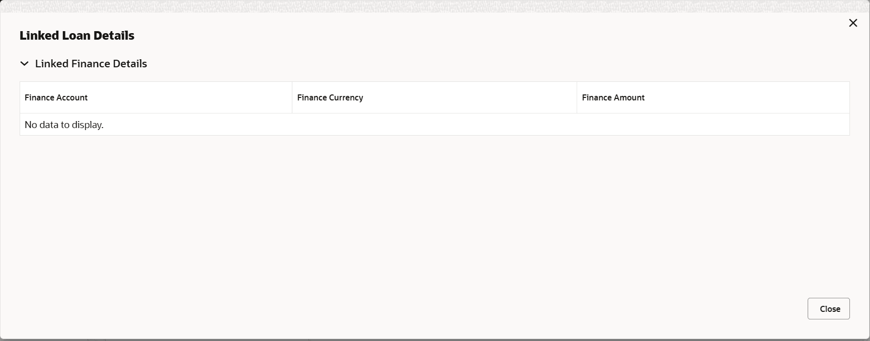

    Linked Finance Details
    The bank user can view the details of linked finance accounts.
    Description of delinkedloandetails.png follows
    Table 3-26 Linked Finance Details - Field Description
    Field Description
    Finance Account The details of the linked finance account.
    Finance Currency Finance currency of the linked finance account.
    Finance Amount Finance amount of the linked finance account.
  7. Click Save and Close to save the details and close the screen.

    For more information on action buttons, refer to the field description table below.
    Table 3-27 Additional Details - Action Buttons - Field Description
    Field Description
    Documents View/Upload the required document.
    Application displays the mandatory and optional documents.
    The user can view and input/view application details simultaneously.
    When a user clicks on the uploaded document, Document window get opened and on clicking the view icon of the uploaded document, Application screen should get split into two. The one side of the document allows to view and on the other side allows to input/view the details in the application.
    Remarks Specify any additional information regarding the collection. This information can be viewed by other users processing the request.
    Content from Remarks field should be handed off to Remarks field in Backend application.
    Overrides Click to view the overrides accepted by the user.
    Customer Instruction Click to view/ input the following
    • Standard Instructions – In this section, the system will populate the details of Standard Instructions maintained for the customer. User will not be able to edit this.
    • Transaction Level Instructions – In this section, OBTFPM user can input any Customer Instructions received as part of transaction processing. This section will be enabled only for customer initiated transactions.
    View Collection Enables the user to view the latest collection values displayed in the respective fields.
    Reject On click of Reject, user must select a Reject Reason from a list displayed by the system.
    Reject Codes are:
    • R1- Documents missing
    • R2- Signature Missing
    • R3- Input Error
    • R4- Insufficient Balance/Limits
    • R5 - Others
    Select a Reject code and give a Reject Description.
    This reject reason will be available in the remarks window throughout the process.
    Refer Select a Refer Reason from the values displayed by the system.
    Refer Codes are:
    • R3- Input Error
    • R5 - Others
    Hold The details provided will be saved and status will be on hold. User must update the remarks on the reason for holding the task.
    This option is used, if there are any pending information yet to be received from applicant.
    Cancel Cancel the Data Enrichment stage inputs. The details updated in this stage are not saved. The task will be available in 'My Task' queue.
    Save & Close Save the details provided and holds the task in ‘My Task’ queue for further update. This option will not submit the request.
    Back On click of Back, system moves the task back to previous data segment.
    Next On click of Next, system validates if all the mandatory fields have been captured. Necessary error and override messages to be displayed. On successful validation, system moves the task to the next data segment.
