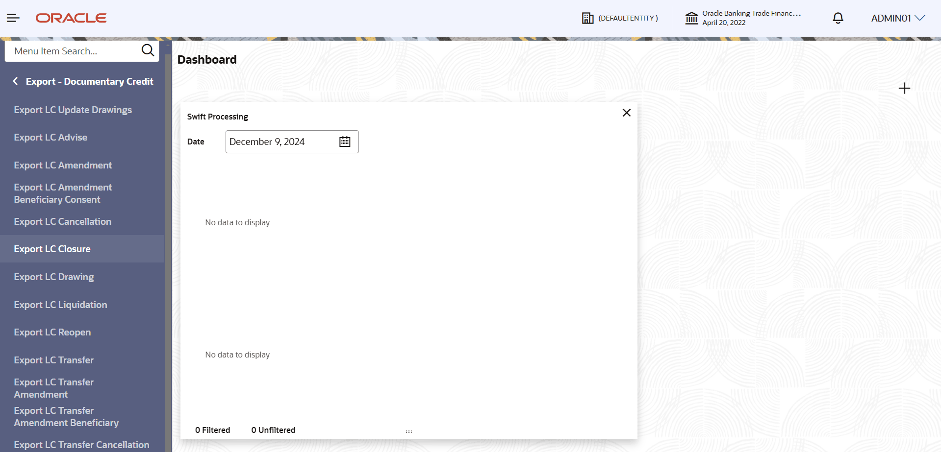

Specify User ID and Password, and login to Home screen.
  1. On Home screen, click Trade Finance. Under Trade Finance, click Export Documentary Credit.
  2. Under Export Documentary Credit, click Export LC Closure.
    The Export LC Closure - Registration screen appears.

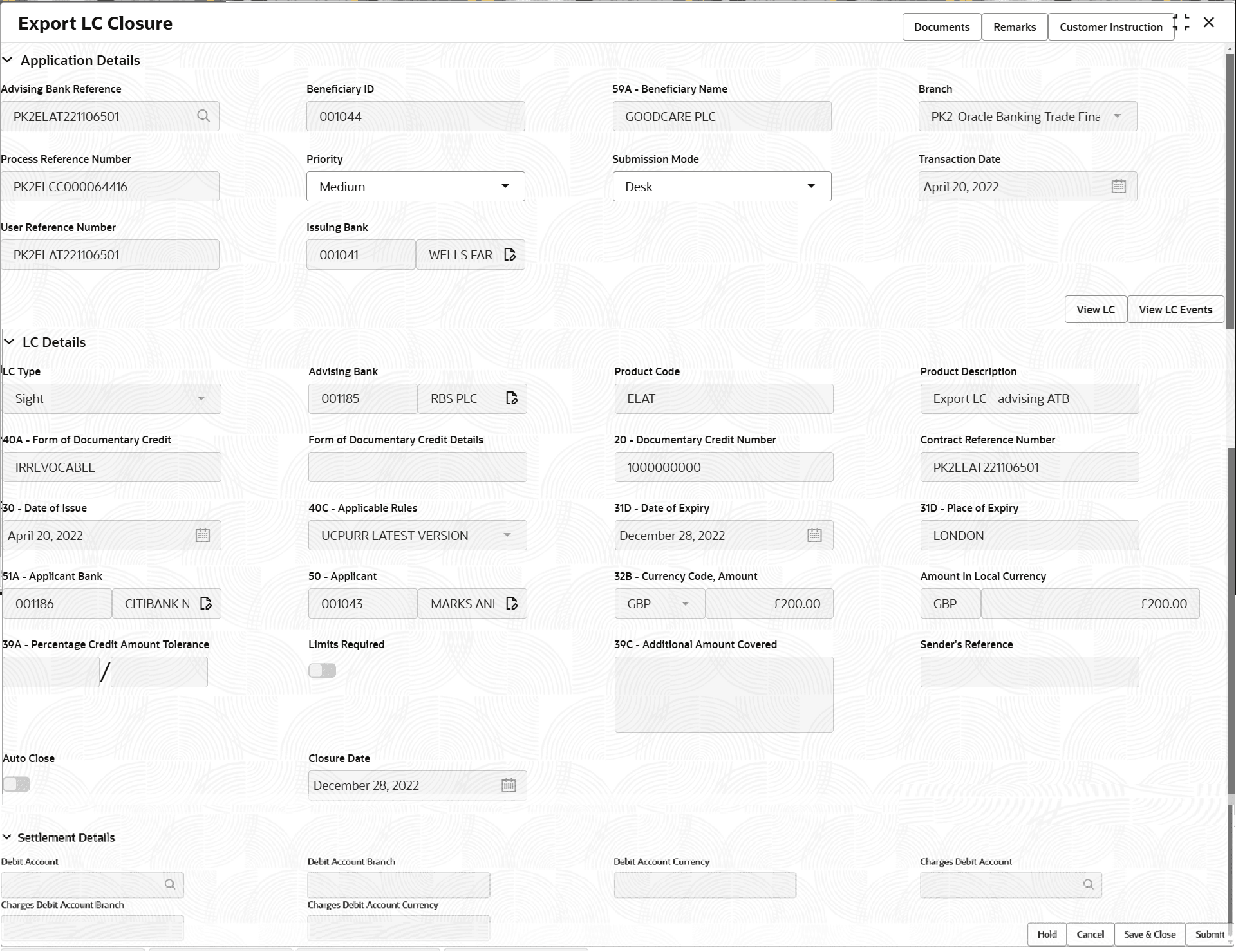

    The Export LC Closure - Registration stage has two sections Application Details and LC Details. Let’s look at the details of Registration screens below:
    Figure 1-4 Export LC Closure - Registration - Application Details
    Description of registrationapplicationdetails.png follows
  3. On Export LC Closure - Registration - Application Details screen, specify the fields.
    The fields which are marked as Required are mandatory.
    For more information on fields, refer to the field description table below.
    Table 1-3 Export LC Closure - Registration - Application Details - Field Description
    Field Description
    Advising Bank Reference Click Search to search and select the advising bank reference number from the look-up.
    Alternatively, specify the advising bank reference number of the LC to be closed.
    In the look-up serach, user can specify the Advising Bank Ref, Customer Id, Currency, Amount, User Reference, and Issuing Bank Reference to fetch the Export LC details. System displays all the Export LC’s outstanding against the given Applicant-beneficiary combination which are active and not closed.
    Beneficiary ID Read only field.
    Beneficiary ID is auto-populated from the value available in LC.
    Beneficiary Name Read only field.
    Beneficiary name will be auto-populated from the value available in LC.
    Branch Read only field.
    Branch details will be auto-populated based on the Export LC details.
    Process Reference Number Unique sequence number for the transaction.
    This is auto generated by the system based on process name and branch code.
    Priority System populates the priority of the customer based on priority maintenance, also enables the user to change the priority as per the requirement.
    Set the priority of the Export LC Closure request as Low/Medium/High. If priority is not maintained for a customer, ‘Medium' priority will be defaulted.
    Submission Mode System populates the submission mode of Export LC Closure request.
    By default the submission mode will have the value as ‘Desk’, for the transactions created via registration. User can change the defaulted priority.
    The submission mode are:
    • Courier - Request received through Courier
    • Desk - Request received through Desk
    • Email - Request received through Email
    • Fax - Request received through Fax
    Transaction Date By default, the application will display branch’s current date.
    User cannot change the date to a back date are a future date. System should change the date to branch date as on approval if the task is approved on a date later than the registration date.
    User Reference Number Read only field.
    User reference number will be auto-populated by the system based on selected Export LC.
    Issuing Bank Read only field.
    Issuing Bank details is auto-populated based on the value available in Export LC.

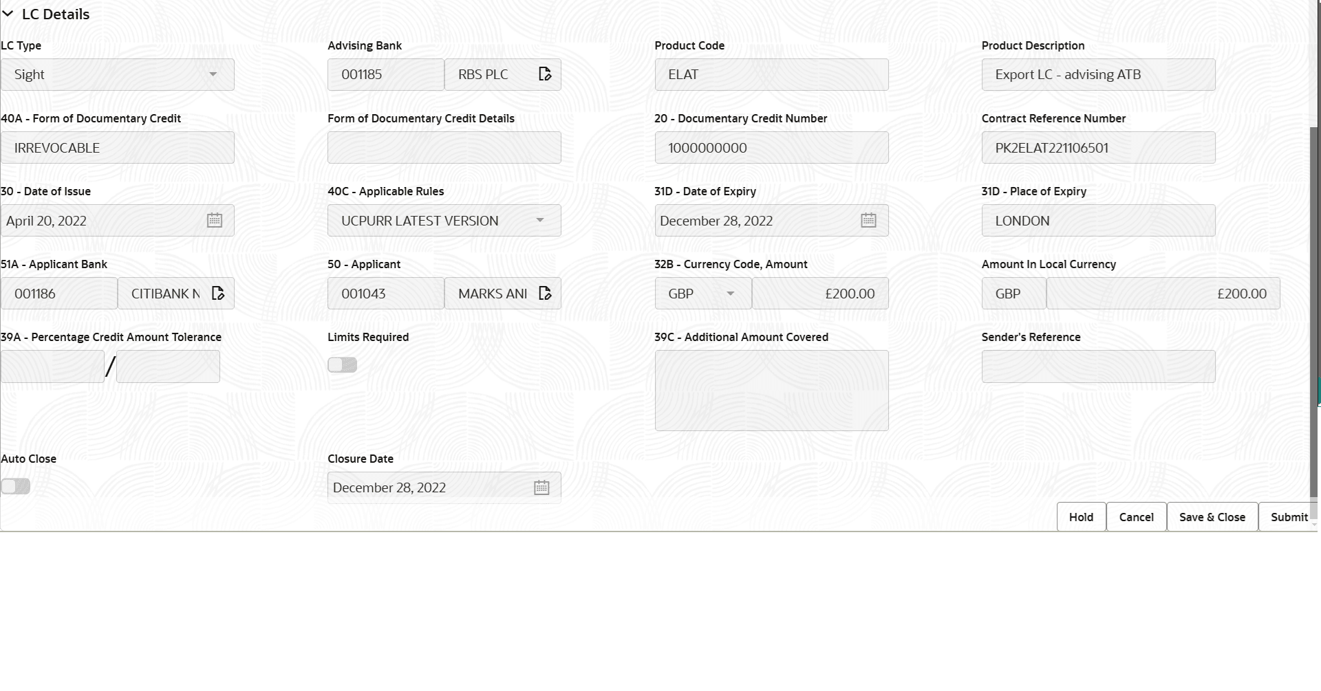

    LC Details
    Registration user can view the latest LC values defaulted in the respective fields in the LC Details section. All the fields in this section is read only.
    Description of registrationlcdetails.png follows
  4. On Export LC Closure - LC Details screen, specify the fields.
    Table 1-4 Export LC Closure - Registration - LC Details - Field Description
    Field Description
    LC Type Read only field.
    LC type is auto-populated based on the latest LC details.
    Advising Bank Read only field.
    This field displays the advising bank details of the selected Export LC.
    Product Code Read only field.
    This field displays the product code used during issuance.
    Product Description Read only field.
    This field displays the description of the product as per the product code displayed as in export LC advice.
    40A - Form of Documentary Credit Read only field.
    This field displays the form of documentary credit details available in Export LC.
    Form of Documentary Credit Details Read only field.
    This field displays the form of documentary credit details, if confirmation details are received from advising bank.
    20 - Documentary Credit Number Read only field.
    This field displays the documentary credit number as available in export LC.
    Contract Reference Number Read only field.
    This field displays the 'Reference number' provided by the beneficiary bank.
    The unique Customer Reference Number which will be the User Reference Number in LC.
    Date of Issue Read only field.
    This field displays the LC issuance date.
    Applicable Rules Read only field.
    This field displays the rules of the selected export LC as per the latest LC details.
    Date of Expiry Read only field.
    This field displays the expiry date as per the latest LC details.
    The Export LC should be allowed to be closed only if the LC is expired.
    Place of Expiry Read only field.
    This field displays the place of expiry as per the latest LC details.
    Applicant Bank Read only field.
    This field displays the applicant bank details as per the latest LC details.
    Applicant Read only field.
    This field displays the details of the applicant as per the latest LC details.
    Currency Code, Amount Read only field.
    This field displays the details of the currency code and LC amount as per the latest LC details.
    Amount In Local Currency Read only field.
    System fetches the local currency equivalent value for the LC amount from back office (with decimal places).
    Percentage Credit Amount Tolerance Read only field.
    This field displays the details of the percentage credit amount tolerance as per the latest LC details.
    Limits Required Read only field.
    Limits Required (Y/N) will be auto-populated as per the latest LC details.
    Additional Amount Covered Read only field.
    This field displays the details of the additional amount covered as per the latest LC details.
    Sender's Reference Read only field.
    This field displays the sender’s reference value as in underlying LC.
    Auto Close Read only field.
    System default the value from the previous versions of the contracts.
    Closure Date Read only field.
    System default the value of closure date from the previous versions of the contracts.

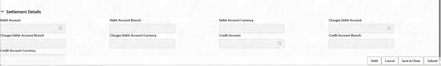

  5. On Export LC Closure - Registration - Settlement Details screen, specify the fields.
    Figure 1-5 Export LC Closure - Registration - Settlement Details
  6. For more information on fields, refer to the field description table below.
    The fields which are marked as 'Required' are mandatory.
    Table 1-5 Export LC Closure - Registration - Settlement Details - Field Description
    Field Description
    Settlement Details Specify the following settlement details:
    Debit Account
    Select the customer Debit Account from the list of values. If not selected, the default settlement account is used for debit components in this contract.
    Debit Account Branch Read only field.
    This field displays the Debit Account Branch as per the Debit Account selected.
    Debit Account Currency Read only field.
    This field displays the Debit Account Currency as per the Debit Account selected.
    Charges Debit Account Select the account for debiting charges, commission, and taxes. If not selected, the system defaults to the maintained settlement account for all applicable components, and users can modify it at the component level.
    • If both the Debit Account and the Charges Debit Account are selected, the Debit Account applies to Cash Collateral, and the Charges Debit Account applies to Charges, Commission, and Taxes.
    • If only the Credit account is selected, that is applicable only for Commission, Charge, and Tax, not for Cash Collateral.
    • If only the Debit account is selected, it applies to Commission, Charge, Tax and Cash Collateral.
    Charges Debit Account Branch Read only field.
    This field displays the Charges Debit Account Branch as per the Charges Debit Account selected.
    Charges Debit Account Currency Read only field.
    This field displays the Charges Debit Account Currency   as per the Charges Debit Account selected.
