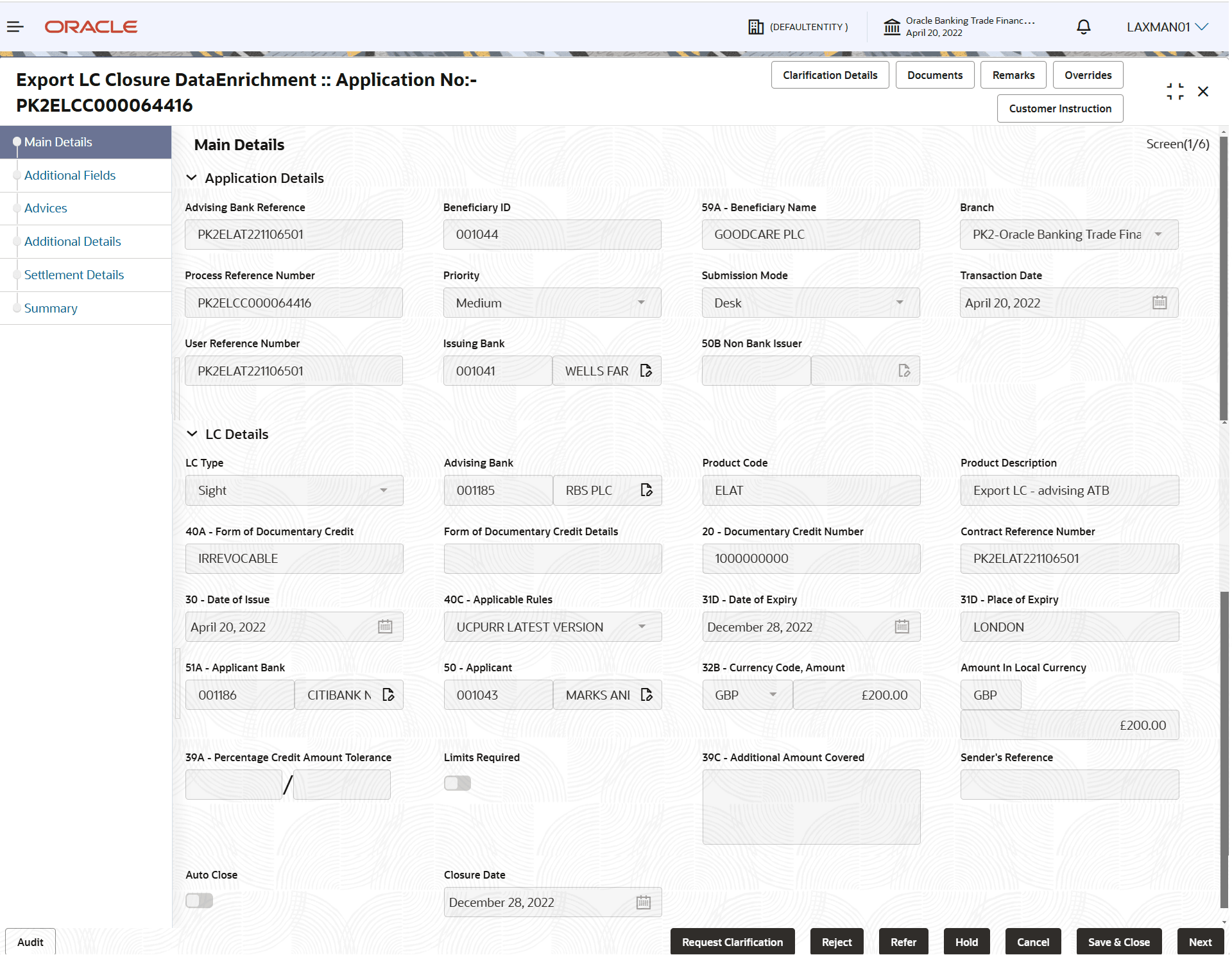

1.3.1 Main Details
This topic provides the systematic instructions to initiate the main details of Data Enrichment stage of Export LC Closure request.
Main details section has two sub section as follows:
  • Application Details
  • LC Details.
Application Details
All fields displayed under Application Details section, would be read only except for the 'Priority'.
  1. On Main Details screen, specify the fields that were not entered at Registration stage.
    For more information on fields, refer to the field description table below.
    Table 1-7 Export LC Closure - Main Details - Application Details - Field Description
    Field Description
    Advising Bank Reference Read only field.
    The value is auto-populated from the Registration stage.
    Beneficiary ID Read only field.
    Beneficiary ID is auto-populated from the value available in LC.
    Beneficiary Name Read only field.
    Beneficiary name will be auto-populated from the value available in LC.
    Branch Read only field.
    Branch details will be auto-populated based on the selected Export LC.
    Process Reference Number Read only field.
    Unique sequence number for the transaction.
    This is auto generated by the system based on process name and branch code.
    Priority System populates the priority of the customer based on priority maintenance, also enables the user to change the priority as per the requirement.
    Set the priority of the Export LC Closure request as Low/Medium/High. If priority is not maintained for a customer, ‘Medium' priority will be defaulted.
    Submission Mode Read only field.
    System populates the submission mode of Export LC Closure request.
    By default the submission mode will have the value as ‘Desk’.
    Closure Date
    By default, the application will display branch’s current date.
    User Reference Number Read only field.
    User reference number will be auto-populated by the system based on selected Export LC.
    Issuing Bank Read only field.
    This field displays the issuing bank as available in LC.

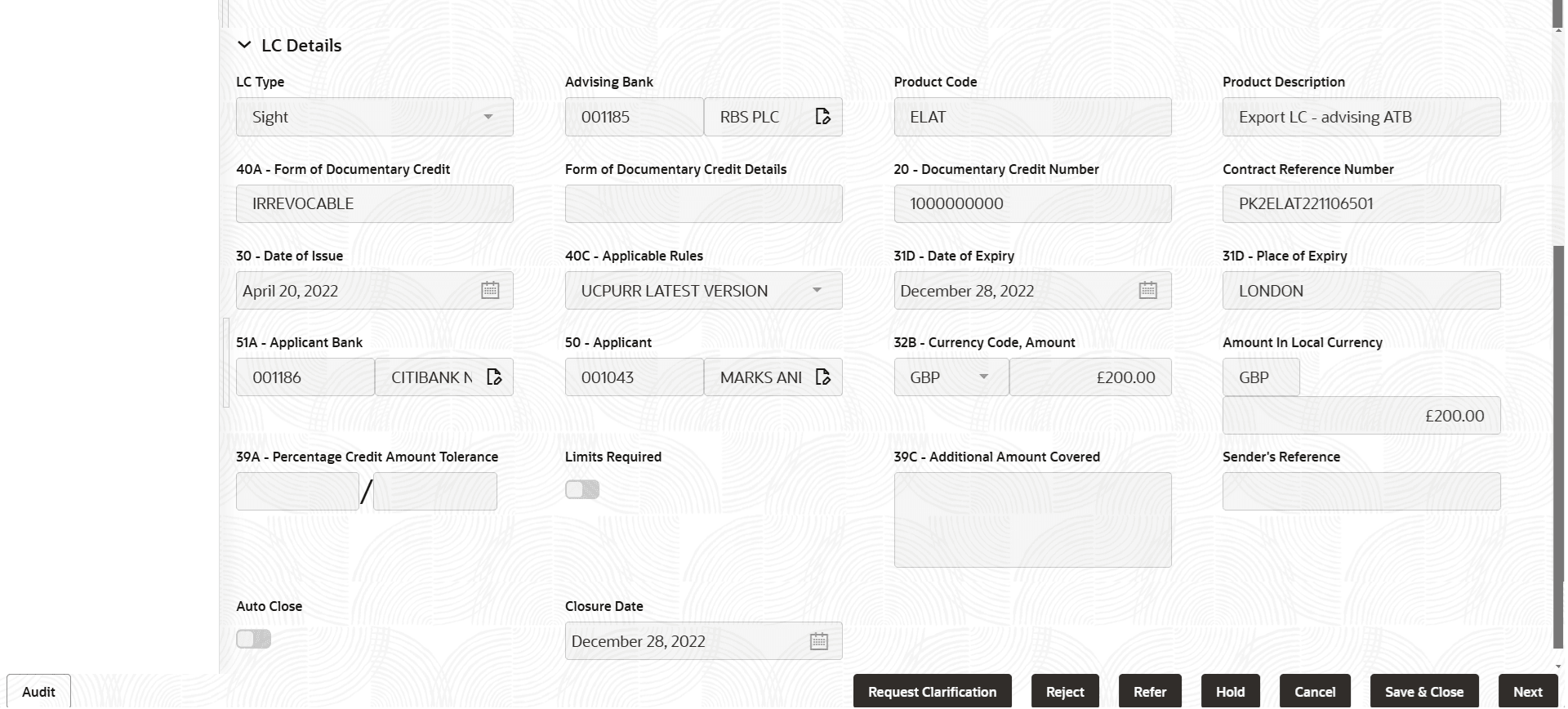

    LC Details
    The fields listed under this section are same as the fields listed under the LC Details section in Registration stage. All fields displayed under LC Details section, would be read only.
    Table 1-8 Export LC Closure - LC Details - Field Description
    Field Description
    LC Type Read only field.
    LC type is auto-populated based on the latest LC details.
    Advising Bank Read only field.
    This field displays the advising bank details of the selected Export LC.
    Product Code Read only field.
    This field displays the product code used during issuance.
    Product Description Read only field.
    This field displays the description of the product as per the product code displayed as in export LC advice.
    40A - Form of Documentary Credit Read only field.
    This field displays the form of documentary credit details available in Export LC.
    Form of Documentary Credit Details Read only field.
    This field displays the form of documentary credit details, if confirmation details are received from advising bank.
    20 - Documentary Credit Number Read only field.
    This field displays the documentary credit number as available in export LC.
    Contract Reference Number Read only field.
    This field displays the 'Reference number' provided by the beneficiary bank.
    The unique Customer Reference Number which will be the User Reference Number in LC.
    Date of Issue Read only field.
    This field displays the LC issuance date.
    Applicable Rules Read only field.
    This field displays the rules of the selected export LC as per the latest LC details.
    Date of Expiry Read only field.
    This field displays the expiry date as per the latest LC details.
    The Export LC should be allowed to be closed only if the LC is expired.
    Place of Expiry Read only field.
    This field displays the place of expiry as per the latest LC details.
    Applicant Bank Read only field.
    This field displays the applicant bank details as per the latest LC details.
    Applicant Read only field.
    This field displays the details of the applicant as per the latest LC details.
    Currency Code, Amount Read only field.
    This field displays the details of the currency code and LC amount as per the latest LC details.
    Amount In Local Currency Read only field.
    System fetches the local currency equivalent value for the LC amount from back office (with decimal places).
    Percentage Credit Amount Tolerance Read only field.
    This field displays the details of the percentage credit amount tolerance as per the latest LC details.
    Limits Required Read only field.
    Limits Required (Y/N) will be auto-populated as per the latest LC details.
    Additional Amount Covered Read only field.
    This field displays the details of the additional amount covered as per the latest LC details.
    Sender's Reference Read only field.
    This field displays the sender’s reference value as in underlying LC.
    Auto Close Read only field.
    System default the value from the previous versions of the contracts.
    Closure Date Read only field.
    System default the value of closure date from the previous versions of the contracts.
