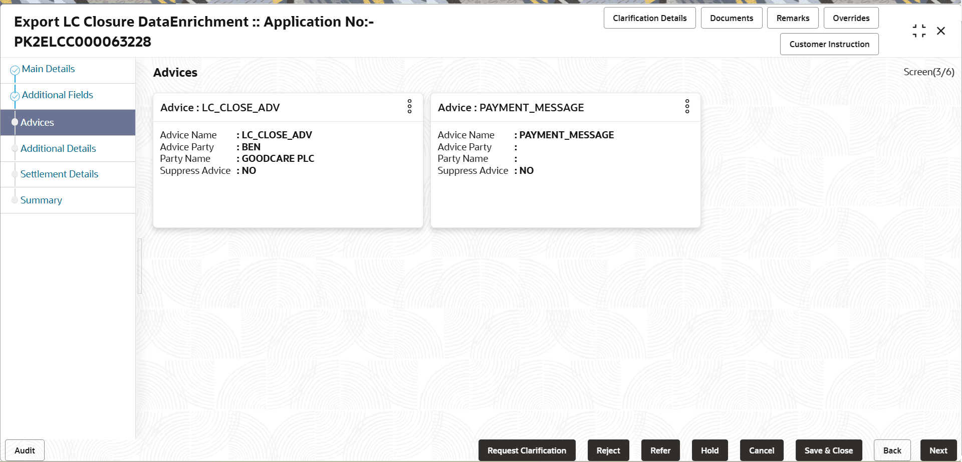

1.3.3 Advices
This topic provides the systematic instructions to capture the advices details of Export LC Closure process.
This section defaults the advices maintained for the product/event simulated from the advices maintained at the product level. The user can also suppress the Advise, if required
  1. On Advices screen, , click View on any advice tile to view the advice details.
    Advice DetailsDescription of deadvicedetails.png follows
    For more information on fields, refer to the field description table below.
