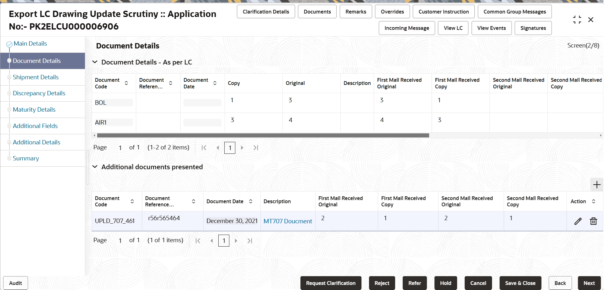

2.3.2 Document Details
This topic provides the systematic instructions to capture the details of the documents received.
User can verify the documents received and identify discrepancies, if any. Compare the document received with the required documents and identify the discrepancies, if any. This section also enables user can add any new documents provided by beneficiary. Provide the information based on the description in the following table.
  1. On Document Details screen, specify the fields.
    Figure 2-10 Scrutiny - Document Details
    Description of scrutinydocumentdetails.png follows
    For more information on fields, refer to the field description table below.

    Action Click Edit icon to edit the document details.
    Additional documents presented Specify the additional documents presented details.
    The user can click + to add multiple document details.
    This table fetches document details as maintained for the specific bill drawing product (BCDPRMNT). Here user can add/modify/delete additional document received, if any, during bill drawing. Once bill drawing is authorized, details from this table will be fetched in update drawing operation also.
