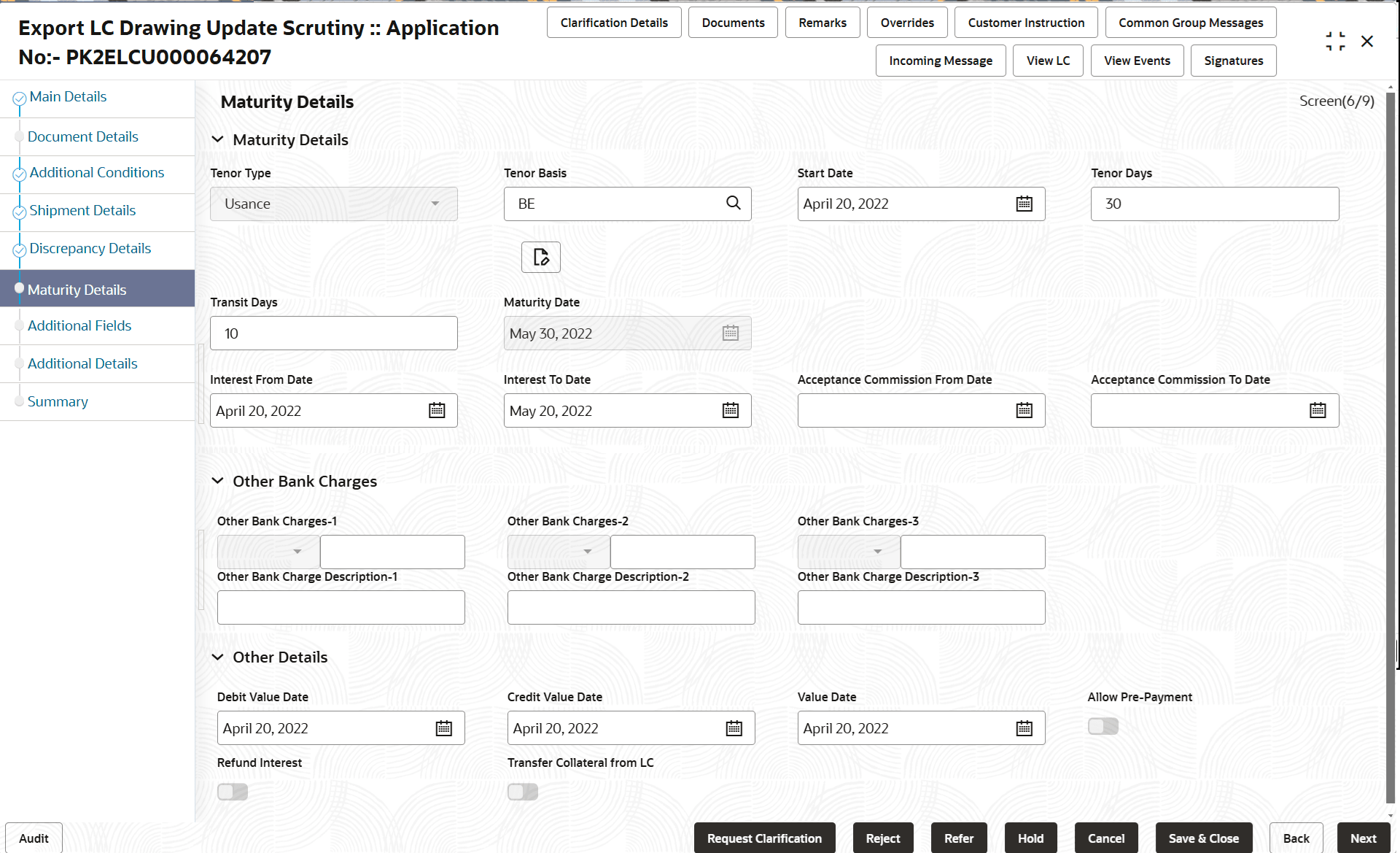

2.3.6 Maturity Details
This topic provides the systematic instructions to capture the maturity details.
  1. On Maturity Details screen, specify the fields.
    For more information on fields, refer to the field description table below.
    Table 2-19 Maturity Details - Field Description
    Field Description
    Tenor Type Read only field.
    This field displays the tenor type as per LC.
    Tenor Basis Specify the tenor basis, if the tenor is not sight.
    The tenor base code description is displayed based on the selected tenor basis.
    Start Date System defaults the start date.
    The user can change the date.
    Tenor Days Specify the number of tenor days.
    Transit Days Specify the transit days, if the tenor is sight.
    Maturity Date System displays the due date for the bill based on tenor and tenor basis.
    If tenor is sight, system will calculate the maturity date as five working days from Document Received Date. User can change this value to any date earlier than the maturity date up to system date. User cannot change the value to later than maturity date.
    If tenor is Usance, system will calculate the maturity date based on the tenor basis and populate the maturity date.
    Interest From Date Select the interest from date.
    The interest from date cannot be earlier than branch date and later than maturity date.
    Interest To Date Select the interest to date.
    Acceptance Commission From Date Select the accept commission from date.
    Acceptance Commission To Date Select the accept commission to date.
    Other Bank Charges Specify the Other Bank Charges details.
    Other Bank Charges - 1 Indicates the charges to be collected for the other bank as part of the drawings transaction.
    Other Bank Charges - 2 Indicates the charges to be collected for the other bank as part of the drawings transaction.
    Other Bank Charges - 3 Indicates the charges to be collected for the other bank as part of the drawings transaction.
    Other Bank Description -1 This field displays the description of charges to be collected for the other bank as part of the drawings transaction.
    Other Bank Description - 2 This field displays the description of charges to be collected for the other bank as part of the drawings transaction.
    Other Bank Description - 3 This field displays the description of charges to be collected for the other bank as part of the drawings transaction.
    Other Charges Specify the Other Charges details.
    Debit Value Date System defaults the debit value date.
    Credit Value Date System defaults the credit value date.
    Value Date System defaults the value date.
    Allow Pre-Payment Enable the option to allow pre-payment.
    Disable the option if pre-payment is not allowed.
    Refund Interest Toggle On: Indicates refund of interest.
    Toggle Off: Indicates interest refund is denied.
    Transfer Collateral from LC Toggle On: Indicates that the transfer collateral from LC is allowed.
    Toggle Off: Indicates that the transfer collateral from LC is denied.
  2. Click Next.
    The task will move to next data segment.
