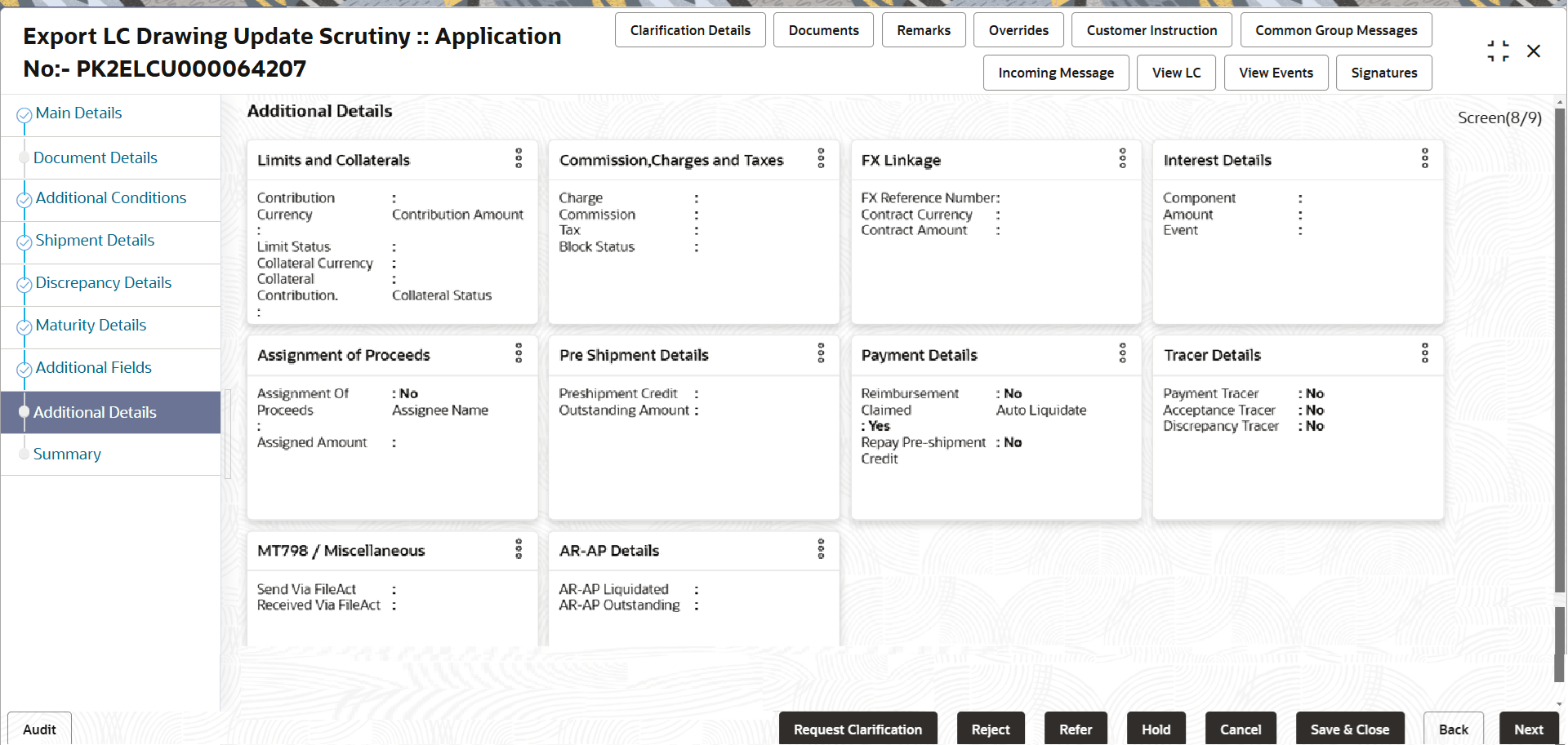

A Scrutiny user can verify/input/update the additional details Data Segment of the Export LC Update Drawings request.
  1. On Additional Details screen, click View on any Additional Details tile to view the details.

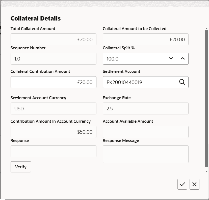

    Collateral Details pop-up screen Click + plus icon to add new collateral details.
    Below fields are displayed on the Collateral Details pop-up screen, if the user clicks plus icon.
    Total Collateral Amount Read only field.
    This field displays the total collateral amount provided by the user.
    Collateral Amount to be Collected Read only field.
    This field displays the collateral amount yet to be collected as part of the collateral split.
    Sequence Number Read only field.
    The sequence number is auto populated with the value, generated by the system.
    Collateral Split %
    Specify the collateral split% to be collected against the selected settlement account.
    Collateral Contribution Amount Specify the collateral amount to be collected against the selected settlement account.
    User can either provide the collateral % where the collateral amount will be auto populated or modifying the collateral amount will auto correct the collateral %.
    Settlement Account Click Search to search and select the settlement account for the collateral.
    Settlement Account Currency Read only field.
    This field displays the settlement account currency defaulted by the system.
    Default Exchange Rate Read only field.
    This field displays the maintained exchange rate when the component currency differs from the settlement account currency.
    Exchange Rate
    Specify Exchange Rate upto 4 decimal places, if applicable. System rounds off values beyond 4 decimals.
    • Do not specify Exchange Rate for deferred charges, commission, and tax components under AR-AP.
      System restricts input for these components.
    • Specify Exchange Rate within the allowed range.
      System allows save without any message.
    • If Exchange Rate exceeds the allowed range but is within the override band. Click Save and Close.
      System displays the override message - "Exchange Rate has exceeded Override Limit"
      Proceed after accepting the override.
    • If Exchange Rate exceeds the stop limit. Click Save and Close.
      System displays the error message - "Exchange Rate has exceeded Stop Limit"
      System does not allow the transaction to proceed.
    Note: In Payment Details section, except for liquidation components (e.g., BILL_LIQ_AMTEQ and LCGCLM_LIQD), settlement account currency, exchange rate, default exchange rate, and deal reference number fields are not editable for all other components.
    Deal Reference Number
    Deal Reference Number allows up to 30 characters. Entries longer than 30 characters aren not allowed.
    Deal Reference Number can be specified only when Exchange Rate has a value. If Exchange Rate is blank and a Deal Reference Number is specified, the system displays: “Cannot add Deal Reference without specifying the Exchange Rate value.”
    Contribution Amount in Account Currency Read only field.
    This field displays the contribution amount in the settlement account currency as defaulted by the system.
    Account Available Amount Read only field.
    System populates the account available amount on clicking the Verify button.
    Response Read only field.
    System populates the response on clicking the Verify button.
    Response Message Read only field.
    System populates the response message on clicking the Verify button.
    Verify Click to verify the account balance of the Settlement Account.
    Save & Close Click to to save and close the record.
    Cancel Click to cancel the entry.

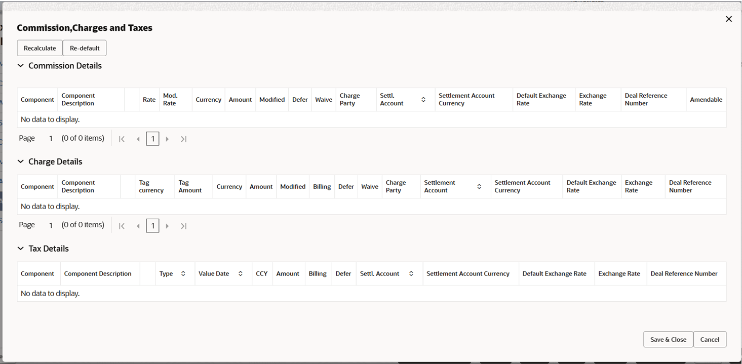

    Commission, Charges and Taxes Details
    This section displays charge details. On landing the additional tab, charges and tax if any will get defaulted from Back end simulation. If default charges are available under the product, they should be defaulted here with values. If customer or customer group specific charges are maintained, then the same will be defaulted from back end system.
    Description of scrutinychargedetails.png follows
    For more information on fields, refer to the field description table below.
    Table 2-23 Charge Details - Field Description
    Field Description
    Commission Details Specify the commission details.
    Component This field displays the commission component.
    Rate This field displays the rate that is defaulted from product.
    The commission rate, if available in Back Office defaults in OBTFPM. The user is able to change the rate.
    If flat commission is applicable, then commission amount defaulted from back office is modifiable by the user. Rate field will be blank and the user cannot modify the Rate field.
    Modified Rate From the default value, if the rate is changed the value gets updated in this field.
    Currency This field displays the currency in which the commission have to be collected.
    Amount This field displays the amount that is maintained under the product code.
    The commission rate, if available in Back Office defaults in OBTFPM. The user is able to change the rate, but not the commission amount directly. The amount gets modified based on the rate changed and the new amount is calculated in back office based on the new rate and is populated in OBTFPM.
    Modified Amount From the default value, if the amount is changed, the value gets updated in the modified amount field.
    Defer If enabled, charges/commissions has to be deferred and collected at any future step.
    Waive Based on the customer maintenance, the charges/commission can be marked for Billing or Defer.
    If the defaulted Commission is changed to defer or billing or waive, system must capture the user details and the modification details in the ‘Remarks’ place holder.
    Charge Party Charge party is 'Applicant' by default. User can change the value to Beneficiary.

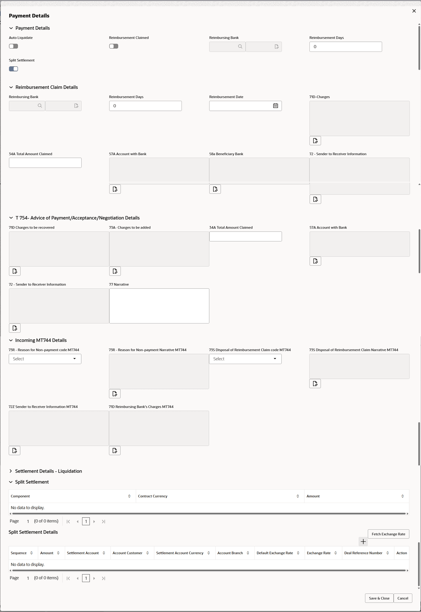

    Settlement Account Select the settlement account.
    Exchange Rate
    Charge Details Specify the charge details.
    Component This field displays the charge component type.
    Tag Currency This field displays the tag currency in which the charges have to be collected.
    Tag Amount This field displays the tag amount that is maintained under the product code.
    Currency This field displays the currency in which the charges have to be collected.
    Modified From the default value, if the rate is changed or the amount is changed, the value gets updated in the modified amount field.
    Billing If charges are handled by separate billing engine, then by selecting billing the details to be available for billing engine for further processing.
    On simulation of charges/commission from Back Office, if any of the Charges/Commission component for the customer is ‘Billing’ enabled, ‘Billing’ toggle for that component should be automatically enabled in OBTFPM.
    The user can not enable/disable the option, if it is de-selected by default.
    This field is disabled, if ‘Defer’ toggle is enabled.
    Defer If charges have to be deferred and collected at any future step, this check box has to be selected.
    On simulation of charges/commission from Back Office, if any of the Charges/Commission component for the customer is AR-AP tracking enabled, ‘Defer’ toggle for that component should be automatically checked in OBTFPM.
    The user can enable/disable the option the check box. On de-selection the user has to click on ‘Recalculate’ charges button for re-simulation.
    Waive Enble the toggle, if charges has to be waived.
    Based on the customer maintenance, the charges should be marked for Billing or for Defer.
    This field is disabled, if Defer toggle is enabled.
    Charge Party Charge party is applicant by default. User can change the value to beneficiary.
    Exchange Rate
    Tax Details Specify the tax details.
    The tax component is calculated based on the commission and defaults if maintained at product level. User cannot update tax details and any change in tax amount on account of modification of charges/ commission will be available on click of Re-Calculate button or on hand off to back-end system.
    Component This field displays the tax component.
    Type This field displays the type of tax component.
    Value Date This field displays the value date of tax component.
    Currency This field displays the currency in which the tax have to be collected.
    The tax currency is the same as the commission.
    Amount This field displays the tax amount based on the percentage of commission maintained.
    You can edit the tax amount, if applicable.
    Billing If taxes are handled by separate billing engine, then by selecting billing the details to be available for billing engine for further processing.
    Defer If taxes have to be deferred and collected at any future step, this option has to be enabled.
    Settlement Account System defaults the settlement account.
    The user can modify the settlement account.
    Exchange Rate
  3. Click Save and Close to save the details and close the screen.

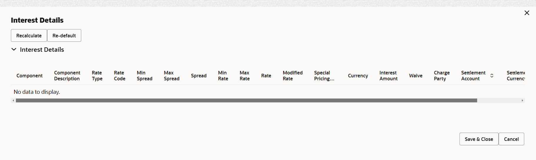

    Interest Details
    The user can view and modify the Interest details simulated from the back office system. On update of the Interest rate user has to click on Recalculate button. System will trigger a simulation call to the back office and the updated Interest details will be reflected in this section.
    Description of intrestdetails.png follows
    Table 2-25 Interest Details - Field Description
    Field Description
    Component This field displays the component maintained in the back office.
    Component Description This field displays the description of the component.
    Rate Type This field displays the rate type maintained for the component in back office.
    • Fixed Floating
    • Special
    Rate Code This field displays the rate code applicable for the component.
    Min Spread This field displays the minimum spread applicable for the Rate Code.
    This field have value, if the Rate Type is Floating.
    Max Spread This field displays the maximum spread applicable for the Rate Code.
    Spread This field displays the spread applicable for the Component in case of Floating Rate Component. User can change the defaulted value.
    System validates whether the spread input is within the Minimum to Maximum Spread.
    Min Rate This field displays the minimum rate applicable for the Rate Code.
    Max Rate This field displays the maximum rate applicable for the Rate Code.
    Rate This field displays the value applicable for the Rate Code.
    You can modify the value, if the Rate Type is Fixed. System validates whether the Rate input is between the Minimum and Maximum Rate.
    Modified Rate This field displays the modified rate.
    Special Pricing Reference Number Specify the Special Pricing Reference Number, when there is a special Interest rate to be provided for that customer against the interest component (Main Component).
    Special Pricing Reference is not applicable for Penal Interest components.
    For transactions initiated from OBDX, the Special Pricing Reference Number will be populated from OBDX and user cannot edit the same.
    System displays an override as “Special Pricing Applicable”, on clicking “Save” in the Interest Details screen, if Special Pricing Reference number has been provided.
    Currency This field displays the interest currency.
    Amount Specify the interest amount, if the Rate Type is Special.
    In other cases , the amount will be calculated by back office immediately only if the Interest is collected in Advance or if Back Dated Interest is collected. In that scenario, the Amount will be populated on Re-simulation from back office. Otherwise Interest will be calculated only in the batch as maintained.
    Waive User can waive the Interest applicable. System displays an override, if the user has waived the Interest.
    Charge Party This field displays the Charge Party based on the type of transaction.
    In case of Export Transactions, Drawer should be the defaulted Charge Party for Collection Bills and Beneficiary for the LC Bills. In case of Import Transactions, Drawee should be the Charge Party for Collection and Applicant for the LC Bills.
    Settlement Account This field displays the settlement account of the Charge Party for debit of Interest. User can change the value. System displays an error if a different customer is chosen. If different account of the Charge Party is selected, system should display a override.
    In case the user modifies the Interest Rate, the user should click on Recalculate button to get the modified amount from the back office and display the new Amount.(Recalculation is done in back office and not in OBTFPM).
    Settlement Currency This field displays the settlement account currency.
    Settlement Branch This field displays the settlement account branch.
  5. Click Save and Close to save the details and close the screen.

    Payment Details
    Description of scrutinypaymentdetails.png follows
    Table 2-28 Payment Details - Field Description
    Field Description
    Payment Details Specify the Payment Details.
    Auto Liquidate If LC Advised by us option is enabled, auto liquidation required details gets defaulted from the LC.
    If LC Advised by us option is disabled, enable Auto Liquidate, if auto liquidation is required. It is applicable only if the drawing is without discrepancy.
    Disable Auto Liquidate, if auto liquidation is not required.
    Preshipment Credit Availed If LC Advised by us option is enabled, pre-shipment credit availed details gets defaulted from the LC.
    If LC Advised by us option is disabled, enable Preshipment Credit Availed, if pre-shipment credit is availed.
    Disable Preshipment Credit Availed, if pre-shipment credit is not availed.
    Preshipment Credit A/C No. This field displays the pre-shipment credit account number.
    Preshipment Credit Outstanding Amount Specify the preshipment credit outstanding amount.
    Repay Preshipment Credit If LC Advised by us option is enabled, repay pre-shipment credit details gets defaulted from the LC.
    If LC Advised by us option is disabled, enable Repay Pre-shipment Credit, if pre-shipment credit to be repaid.
    Disable Repay Pre-shipment Credit, if there is no pre-shipment credit to be repaid.
    Preshipment Credit Repayment Amount This field displays the pre-shipment credit repayment amount.
    Reimbursement Claimed If LC Advised by us option is enabled, reimbursement claimed details gets defaulted from the LC.
    If LC Advised by us option is disabled, enable Reimbursement Claimed, if reimbursement to be claimed.
    Disable Reimbursement Claimed, if there are no reimbursement to be claimed.
    Reimbursing Bank If LC Advised by us option is enabled, reimbursing bank details gets defaulted from the LC.
    Click Search to search and select the reimbursing bank, if Reimbursement Claimed option is enabled.
    If the user selects another bank and in case the selected Bank is not RMA Compliant, the system displays error message “RMA arrangement not available, Only MT999 messages can be sent to the bank”.
    Reimbursement Days Specify the number of days before the maturity date on which the reimbursement claim needs to be triggered.
    Liquidate using Collateral Enable the option, if liquidation is done using Collateral.
    Reimbursing Claim Details Specify the Reimbursing Claim Details.
    Reimbursing Bank
    Reimbursement Date Reimbursement date will be displayed based on the reimbursement days and maturity date.
    Enables user to capture the reimbursement date. If reimbursement date is later than the branch date, system will display an error.
    Charges Click the edit icon and specify the charge details in Line 1-6 and click Save & Close to save the changes.
    The user can edit the details by clicking the edit icon.
    Total Amount Claimed Specify the total amount claimed.
    Account with Bank Click the edit icon and specify the account with bank details in Line 1-6 and click Save & Close to save the changes.
    Beneficiary Bank Click the edit icon and specify the beneficiary bank details in Line 1-6 and click Save & Close to save the changes.
    Sender to Receiver Information Click the edit icon and specify the sender to receiver information in Line 1-6 and click Save & Close to save the changes.
    T 754- Advice of Payment/Acceptance/Negotiation Details Specify the T 754- Advice of Payment/Acceptance/Negotiation Details.
    Charges to be recovered Click the edit icon and specify the charges to be recovered in Line 1-6 and click Save & Close to save the changes.
    Charges to be added Click the edit icon and specify the charges to be added in Line 1-6 and click Save & Close to save the changes.
    Narrative Specify the narrative.
    Settlement Details - Liquidation Specify the Settlement Details - Liquidation.
    Component This field displays the component based on the product selected.
    Currency This field displays the currency for the component.
    Debit/Credit This field displays the debit/credit indicators for the components.
    Account This field displays the account details for the components.
    Account Description This field displays the description of the selected account.
    Branch This field displays the branch of the selected account.
    Exchange Rate
  8. Click Save and Close to save the details and close the screen.

    For more information on action buttons, refer to the field description table below.
    Table 2-30 Additional Details - Action Buttons - Field Description
    Field Description
    Clarification Details Clicking the button opens a detailed screen, user can see the clarification details in the window and the status will be 'Clarification Requested'.
    Documents View/Upload the required document.
    Application displays the mandatory and optional documents.
    The user can view and input/view application details simultaneously.
    When a user clicks on the uploaded document, Document window get opened and on clicking the view icon of the uploaded document, Application screen should get split into two. The one side of the document allows to view and on the other side allows to input/view the details in the application
    Remarks Specify any additional information regarding the Export LC Update Drawings. This information can be viewed by other users processing the request.
    Content from Remarks field should be handed off to Remarks field in Backend application.
    Overrides Click to view the overrides accepted by the user.
    Customer Instruction Click to view/ input the following
    • Standard Instructions – In this section, the system will populate the details of Standard Instructions maintained for the customer. User will not be able to edit this.
    • Transaction Level Instructions – In this section, OBTFPM user can input any Customer Instructions received as part of transaction processing. This section will be enabled only for customer initiated transactions.
    Common Group Messages Click Common Group Message button, to send MT759,790,91,92,95,96,98,799,999 messages from within the task.
    Incoming Message Displays the incoming message, if any.
    In case of MT798-MT726-MT759 request, user can view MT798 message(726-759) in this placeholder in Header of the task.
    In case of MT798_MT788-MT799 request, user can view MT798 message (788-799) in this placeholder in Header of the process-task.
    View LC Click to view the latest LC values displayed in the respective fields. All fields displayed in LC details section are read only fields..
    Signatures Click the Signature button to verify the signature of the customer/ bank if required.
    The user can view the Customer Number and Name of the signatory, Signature image and the applicable operation instructions if any available in the back-office system.
    If more than one signature is required, system should display all the signatures.
    Request Clarification Click the Request Clarification button to submit the request for clarification to the “Trade Finance Portal” User for the transactions initiated offline.
    Reject On click of Reject, user must select a Reject Reason from a list displayed by the system.
    Reject Codes are:
    • R1- Documents missing
    • R2- Signature Missing
    • R3- Input Error
    • R4- Insufficient Balance/Limits
    • R5 - Others
    Select a Reject code and give a Reject Description.
    This reject reason will be available in the remarks window throughout the process.
    Refer Select a Refer Reason from the values displayed by the system.
    Refer Codes are:
    • R3- Input Error
    • R5 - Others
    Hold The details provided will be saved and status will be on hold. User must update the remarks on the reason for holding the task.
    This option is used, if there are any pending information yet to be received from applicant.
    Cancel Cancel the Data Enrichment stage inputs. The details updated in this stage are not saved. The task will be available in 'My Task' queue.
    Save & Close Save the details provided and holds the task in ‘My Task’ queue for further update. This option will not submit the request.
    Back Click the Back button, to go back to the previous screen.
    Next On click of Next, system validates if all the mandatory fields have been captured. Necessary error and override messages to be displayed. On successful validation, system moves the task to the next data segment.
