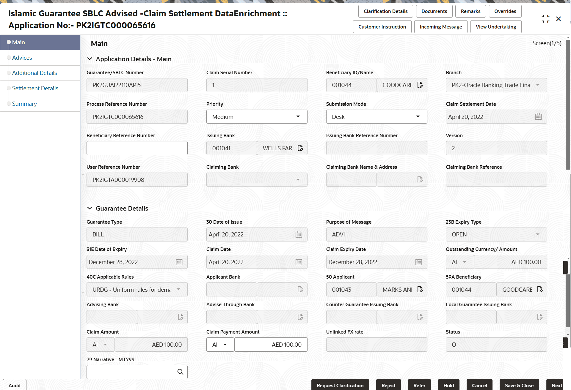

Application Details
  1. On Data Enrichment - Main screen, specify the fields that were not entered at Registration stage.
    Figure 2-7 Data Enrichment - Main
    The fields which are marked as Required are mandatory.
    For more information on fields, refer to the field description table below.
    Table 2-5 Main - Application Details - Field Description
    Field Description
    Guarantee/SBLC Number Read only field.
    System defaults the value from Registration stage.
    Claim Serial Number Read only field.
    System defaults the claim serial number from Guarantee/ SBLC advise.
    Beneficiary ID/Name Read only field.
    System defaults the customer ID/ Name from Guarantee/ SBLC claim.
    Branch Read only field.
    System defaults the branch name from Guarantee /SBLC advised.
    Process Reference Number Read only field.
    Unique OBTFPM task reference number for the transaction.
    This is auto generated by the system based on process name and branch code.
    Priority Priority maintained will be populated as either 'Low/Medium/High/Essential/Critical'. If priority is not maintained for a customer, Medium priority will be defaulted.
    User can change the priority.
    Submission Mode System defaults the submission mode of Guarantee Advised Claim Settlement request.
    By default the submission mode will have the value as Desk.
    • Desk - Request received through Desk
    • Fax- Request received through Fax
    • Email - Request received through Email
    The user can change the submission mode.
    Claim Settlement Date Read only field.
    By default, the application will display branch’s current date for the claim settlement date.
    Beneficiary Reference Number Specify the Beneficiary Reference Number.
    Issuing Bank Read only field.
    System defaults the Issuing Bank name from Guarantee/ SBLC advise.
    Issuing Bank Reference Number Read only field.
    System defaults the Issuing Bank Reference Number from Guarantee/ SBLC advise.
    Version Read only field.
    System defaults the version number.
    User Reference Number Read only field.
    System defaults the User Reference Number from Guarantee/ SBLC advise.

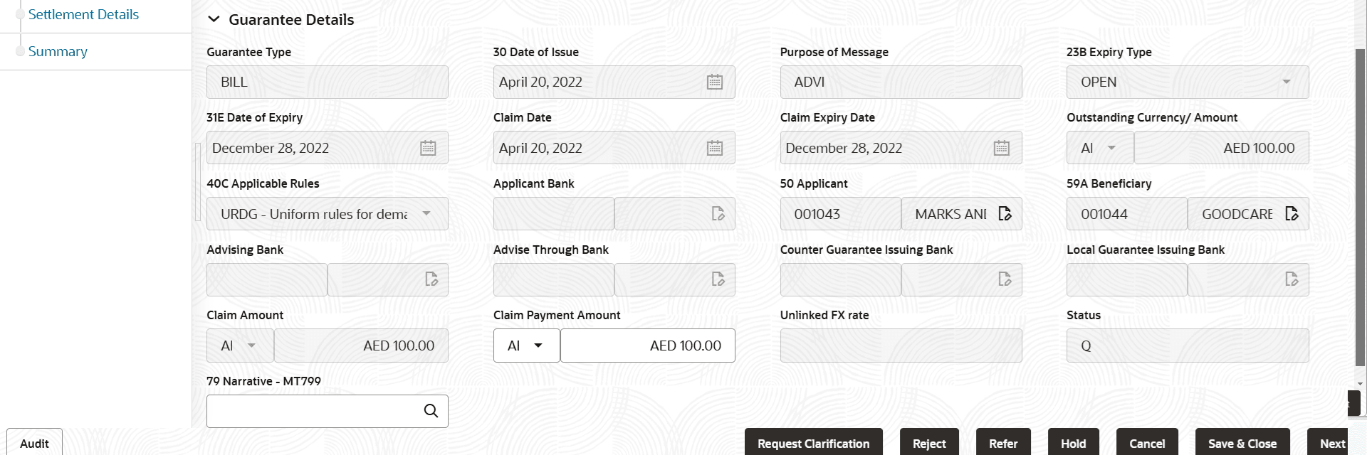

    Main - Guarantee Details
    The fields listed under this section are same as the fields listed under the Guarantee Details section in Registration stage. For more information on the fields, refer to Guarantee Details of Registration stage. During registration, if user has not captured input, then user can capture the details in this section.
    Table 2-6 Main - Guarantee Details - Field Description
    Field Description
    Guarantee Type Read only field.
    Guarantee type defaults from Guarantee/ Standby Advised.
    Date of Issue Read only field.
    System defaults the date of issue from Guarantee /SBLC Advised.
    Purpose of Message Read only field.
    System dafaults the purpose of message from Guarantee/ Standby Advised.
    Expiry Type Read only field.
    System defaults the expiry type from Guarantee/ SBLC Advised.
    Date of Expiry Read only field.
    Expiry date of the Guarantee Advise.
    System defaults the expiry date from Guarantee/ SBLC Advised.
    Claim Date Read only field.
    System defaults the claim date from Guarantee/ SBLC Advised.
    Claim Expiry Date Read only field.
    System defaults the claim expiry date from Guarantee/ SBLC Advised.
    Outstanding Currency/ Amount Read only field.
    System defaults outstanding currency and amount from Guarantee/ Standby Advised.
    Applicable Rules Read only field.
    System defaults the value from Guarantee Advised details.
    Applicant Bank Read only field.
    This system defaults the applicant bank details available in Guarantee.
    Applicant Read only field.
    System defaults the applicant from Guarantee/ SBLC Advised.
    Beneficiary Read only field.
    System defaults the beneficiary as in Guarantee/ SBLC Advised.
    Advising Bank Read only field.
    System defaults the advising bank if available.
    Advising Through Bank Read only field.
    System defaults the advising through bank if available in Guarantee Advise.
    Counter Guarantee Issuing Bank Read only field.
    System defaults the counter guarantee issuing through bank, if available in Guarantee Advise.
    Local Guarantee Issuing Bank Read only field.
    System defaults the local guarantee issuing bank, if available in Guarantee Advise.
    Claim Amount Read only field.
    System defaults the claim amount from the Guarantee Claim.
    Claim Payment Amount System defaults the claim amount and currency from the Guarantee Claim.
    The user can change the claim payment amount and currency.
    Unlinked FX rate Read only field.
    If claim currency is different from local currency system displays the unlinked FX rate.
    Status Read only field.
    This field displays the status of the Guarantee advised claim settlement.
    Narrative - MT799 Specify or click search icon to search and select the narrative.

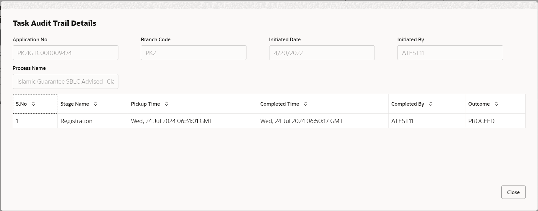

    Audit
    This button provides information about user initiated the transaction, initiated date, stage wise detail etc.
    For more information on audit, refer to the field description table below.
    Table 2-7 Audit - Field Description
    Field Description
    Application No. This field displays the appliation number of the process.
    Branch Code This field displays the branch code.
    Initiated Date This field displays the date on which process is initiated.
    Initiated By This field displays the user ID of the user who had initiated the process.
    Process Name This field displays the name of the process which is initiated.
    S. No This field displays the serial number of the audit record.
    Stage Name This field displays the current stage of the process.
    Completed Time This field displays the time on which the audit of the current stage is completed.
    Completed By This field displays the user ID of the user who had completed the audit.
    Outcome This field displays the outcome of the audit.
