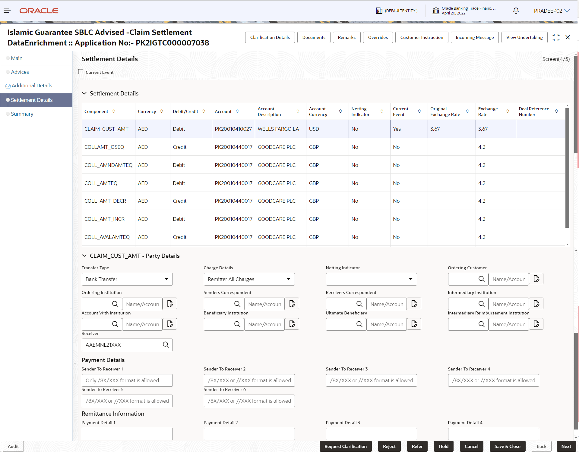

2.2.4 Settlement Details
This topic provides the systematic instructions to capture the settlement details of Guarantee SBLC Advised - Claim Settlement Islamic request.
A DE user can verify and enter the basic settlement details available in the Claim Settlement request. In case the request is received through online channel user will verify the details populated.
  1. On Settlement Details screen, specify the fields.
    For more information on fields, refer to the field description table below.
    Table 2-17 Settlement Details – Field Description
    Field Description
    Current Event Select the check box to populate the settlement details of the current event associated with the task. On De-selecting the check box, the system list all the accounts under the settlement details irrespective of the current event.
    Component Read only field.
    System defaults the value from Guarantee /SBLC claim.
    Currency Read only field.
    Debit/Credit Read only field.
    Account Read only field.
    Account Description Read only field.
    Account Currency Read only field.
    Netting Indicator Read only field.
    This field displays the applicable netting indicator.
    Current Event System displays the current event as Y or N.
    Default Exchange Rate System displays the Default Exchange Rate as simulated in settlement details section from OBTF.
    Exchange Rate System populates the exchange rate maintained.
    Deal Reference Number System defaults the exchange deal reference number.
  2. Click any component in the grid.
