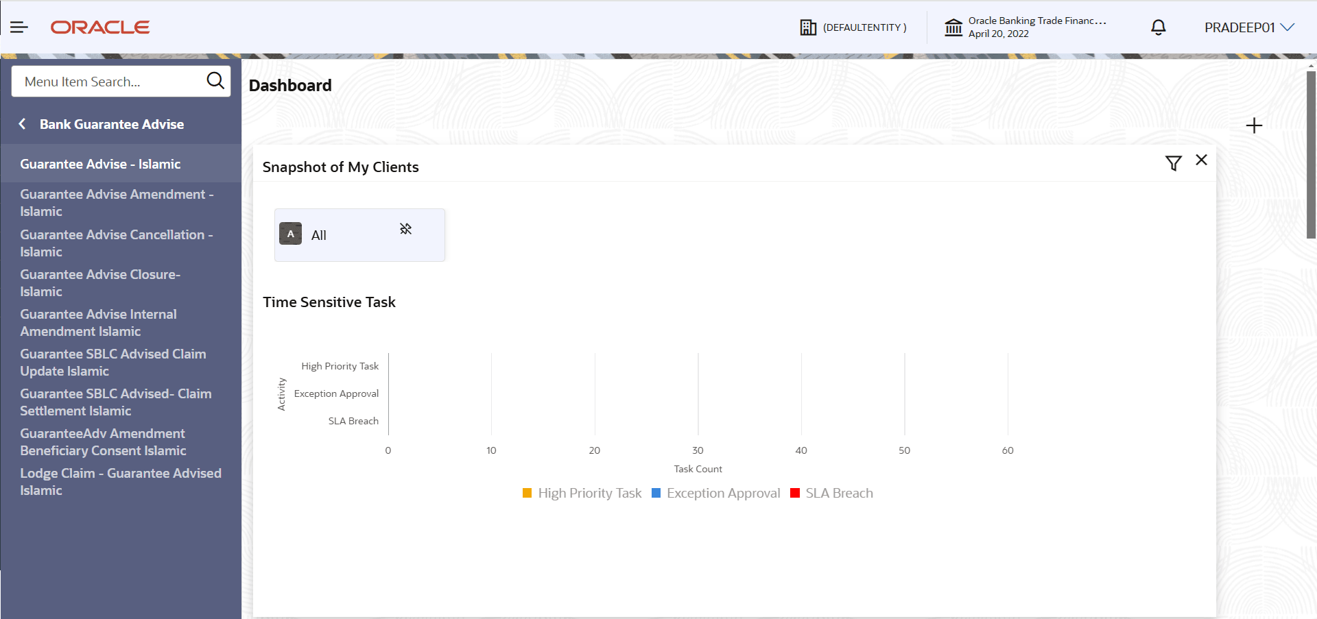

  1. On Home screen, click Trade Finance Islamic. Under Trade Finance Islamic, click Bank Guarantee Advise.
  2. Under Bank Guarantee Advise, click Guarantee Advise Islamic.
    Figure 2-3 Guarantee Advice Islamic
    Description of Figure 2-3 follows
    Description of "Figure 2-3 Guarantee Advice Islamic"
    The Guarantee Advise Islamic - Registration screen appears.

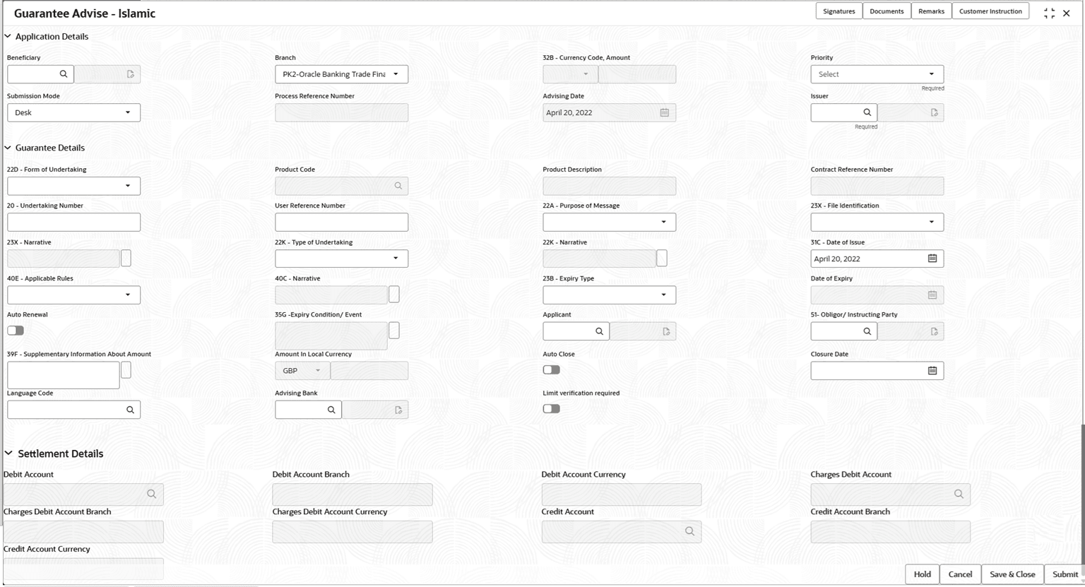

    The Guarantee Advise Islamic - Registration stage has two sections Application Details and Guarantee Details. Let’s look at the details of Registration screens below:

  3. On Guarantee Advise Islamic - Registration - Application Details screen, specify the fields.
    The fields which are marked as Required are mandatory.
    For more information on fields, refer to the field description table below.
    Table 2-3 Guarantee Advise Islamic - Registration - Application Details - Field Description
    Field Description
    Beneficiary Specify the beneficiary or click Search to search and select the beneficiary customer from look-up.
    If beneficiary is a customer of the bank, system will check for valid KYC status. If KYC status is not valid, system will display alert.
    For Guarantee Advising MT760, the Customer ID to be resolved from incoming message. If required use Walk-in ID. Bene ID/ name should be made amendable by the user.
    Branch Displays the customer’s home branch based on the customer ID.
    Once the request is submitted, Branch field is non-editable.
    For Guarantee Advising MT760, the branch to be resolved from CIF.
    Currency Code, Amount Select the currency code from the drop-down list.
    Specify the value of guarantee (with decimal places) as per currency type.
    For Guarantee Advising MT760, the currency code is Read only and populated from Incoming MT 760.
    Priority Set the priority of the Guarantee Advise request as Low/Medium/High/Essential/Critical. If priority is not maintained for the customer, system will populate 'Medium' as the default priority.
    For Guarantee Advising MT760, the field is defaulted and user can change its value.
    Submission Mode Select the submission mode of Guarantee Advise request from the drop-down list.
    By default the submission mode will have the value as ‘Desk’.
    • Desk - Request received through Desk
    • Courier - Request received through Courier
    For Guarantee Advising MT760, the Submission Mode is Read only - SWIFT.
    Process Reference Number Read only field.
    Unique OBTFPM task reference number for the transaction.
    This is auto generated by the system based on process name and branch code.
    For Guarantee Advising MT760, the Process Reference Number is read only and generated by the system.
    Advising Date Read only field.
    System will default branch date. Back dating not allowed, if approved on a subsequent date, that date will be populated here.
    For Guarantee Advising MT760, the branch date to be defaulted. User cannot change the date. If approved on a later date, system should populate the branch date as on date of approval.
    Issuer Specify the issuing bank name or click Search to search and select the issuing bank.
    Party type with banks will only be displayed in look-up. The system will display the
    1. SWIFT code (if available)
    2. Name and address of the bank
    On selection of the record if SWIFT code is available then SWIFT code will be populated, if SWIFT code is not available then the bank's name and address will be populated.
    For Guarantee Advising MT760, the issuing bank is read only and populated from Incoming MT 760.

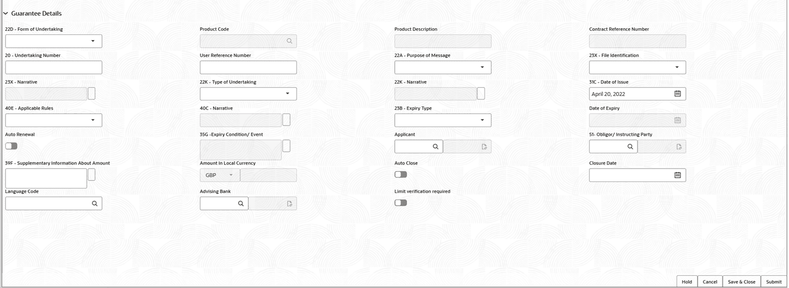

    Guarantee Details
    Registration user can provide Guarantee details in this section. Alternately, details can be provided by Scrutiny user.
  4. On Guarantee Advise Islamic - Registration - Guarantee Details screen, specify the fields.
    The fields which are marked in asterisk are mandatory.
    Figure 2-5 Guarantee Advise Islamic - Registration - Guarantee DetailsDescription of registrationguaranteedetails1.png follows
    Table 2-4 Guarantee Advise Islamic - Registration - Guarantee Details - Field Description
    Field Description
    Form of Undertaking Select the type of LC (Documentary Credit) as per the requirement. By default LC type is Irrevocable.
    • DGAR - Guarantee
    • STBY - Standby LC
    For Guarantee Advising MT760, the Form of Undertaking value is read only and populated from Incoming MT 760.
    Product Code Specify the product code and on tab out system will validate and populate the selected product description. The product codes will be listed based on the selected value in Form of Undertaking.
    Alternatively, click Search to search and select the product code with code or product description.
    For Guarantee Advising MT760, user can enter the product code.
    Product Description Read only field.
    This field displays the description of the product as per the product code.
    For Guarantee Advising MT760, Product Description is populated based on product code selected.
    Contract Reference Number Read only field.
    Auto-generated by back end application. Number will be populated on the selection of Product Code.
    For Guarantee Advising MT760, Contract Reference Number is generated from Back office System.
    Undertaking Number Specify the undertaking number available in the guarantee/SBLC.
    For Guarantee Advising MT760, the Undertaking Number is read only and populated from Incoming MT 760.
    User Reference Number System defaults the user reference number, depending on the selection of product code.
    The user can change the value.
    Purpose of Message Select the purpose of message from the drop-down.
    The values are:
    • ACNF - Advice and confirmation of issued undertaking
    • ADVI - Advice of issued undertaking.
    This field is read only if Form of Undertaking value is DGAR - Guarantee.
    For Guarantee Advising MT760, the Purpose of message is read only and populated from Incoming MT 760. Values are:
    • ACNF - Advice and confirm (Limits required)
    • ADVI - Advice
    File Identification Select the type of delivery channel and its associated file name or reference from the available values.
    The options are:
    • COUR - Courier delivery
    • EMAL - Email transfer
    • FACT - SWIFTNet FileAct
    • FAXT - Fax transfer
    • HOST - Host-to-Host
    • MAIL - Postal Delivery
    • OTHR - Other delivery channel
    For Guarantee Advising MT760, the File Identification value is read only and populated from Incoming MT 760.
    Narrative Specify the description in this field, if File Identification field values are COUR or OTHR .
    For Guarantee Advising MT760, the Narrative is read only and populated from Incoming MT 760.
    Type of Undertaking Select the guarantee type from the following available options:
    • Advance Payment Guarantee
    • BILL - Bill of Lading
    • CUST - Customs
    • DPAY - Direct Pay
    • INSU - Insurance
    • JUDI - Judicial
    • LEAS - Lease
    • PAYM - Payment
    • PERF - Performance
    • RETN - Retention
    • SHIP - Shipping - For shipping guarantee
    • TEND - Tender or Bid
    • WARR - Warranty/ maintenance
    • OTHR - Any other local undertaking type.
    For Guarantee Advising MT760, the value is read only and populated from Incoming MT 760.
    Narrative Specify the details of any other type of local undertaking.
    This field is enabled if the Type of Undertaking has value as OTHR .
    Date of Issue This field displays the branch’s current date as date of issue defaulted from the application.
    Application will populate the Date of Issue field with branch date on approval if date of approval is later than date of Registration.
    Expiry Type Select the expiry type for guarantee advise.
    This field indicates whether undertaking has specified expiry date or is open-ended.
    The options are:
    • COND- Without Expiry
    • COND - With Expiry
    • FIXD - Specified expiry date (with/without automatic expansion)
    • OPEN - No specific date of expiry
    Date of Expiry Select the expiry date of the Islamic Guarantee advise. The expiry date can be equal or greater than the issue date.
    If the Expiry Date is earlier than the issue date, system will provide an error and if the ‘Expiry Date is equal to the Issue Date’, system will provide a alert message.
    The field is enabled, if Expiry Type is COND - With Expiry and FIXD.
    Expiry Condition/Event Specifies the documentary condition/event that indicates when the local undertaking will cease to be available.
    The field is enabled, if Expiry Type is COND - With Expiry or COND - Without Expiry.
    Applicant Specify the applicant or alternatively, click Search to search and select the applicant from the look-up.
    If the request is received from Applicant bank, select the applicant from the List of Values.
    Obligor/ Instructor Party Specify the party obligated to reimburse the issuer or click Search to search and select the name of the obligor from the lookup.
    Applicable Rules Select the applicable rules for guarantee issuance.
    The options are:
    • URDG - Uniform rules for demand guarantees
    • UCPR - Uniform customs and Practices
    • ISPR - International standby Practices
    • NONE - Not subject to any rules
    Narrative Specify the description in this field, if Applicable Rules field values is None .
    Supplementary Information About Amount Specify the additional information about amount related to undertaking.
    Amount In Local Currency Read only field.
    After the tab out of ‘Currency Code, Amount’ field, system populates the Local currency and amount value in this field. System fetches the local currency equivalent value for the transaction amount from back office (with decimal places).
    Auto Close Enable the option, if Auto close is required for that transactions.
    Disable the option, if Auto close is not required for that transactions.
    Closure Date This field displays the “Closure Date”defaulted by the system, with the value “Expiry Date” + No of Closure days maintained in the respective Product in which the contract has been created.
    System automatically close the contract on the specified Closure Date if Auto Close is selected as “Yes” for the specific contract.
    User can modify the system defaulted “Closure Date” and system should validate the same for the below conditions,
    • Closure Date must be after the Issue Date.
    • Closure Date must be after the Expiry Date.
    • Closure Date cannot be blank, when the “Auto Close” is checked.
    The field is enabled, if Auto Close field is enabled.
    Language Code Click Search to search and select the language code from the look-up.
    Advising Bank Specify the Advising Bank reference number or click Search to search and select the advising bank reference number from look-up, by entering the search criteria.
    Limit verification required Switch to Enable to enables for limit verification.
    Switch to Disable ,
    and provide the Finance Amount, the system prompts an override message on Submit.

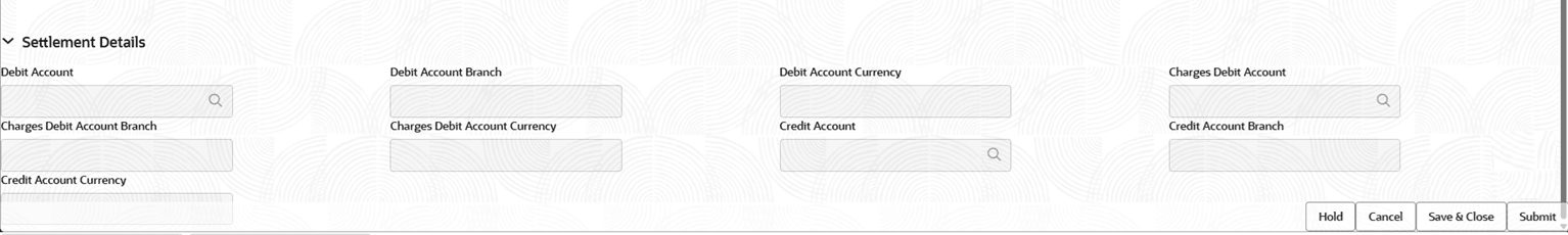

  5. On Guarantee Advise Islamic - Registration - Settlement Details screen, specify the fields.
    Figure 2-6 Guarantee Advise Islamic - Registration - Settlement Details
  6. For more information on fields, refer to the field description table below.
    The fields which are marked as 'Required' are mandatory.
    Table 2-5 Guarantee Advise Islamic - Registration - Settlement Details - Field Description
    Field Description
    Settlement Details Specify the following settlement details:
    Debit Account
    Select the customer Debit Account from the list of values. If not selected, the default settlement account is used for debit components in this contract.
    Debit Account Branch Read only field.
    This field displays the Debit Account Branch as per the Debit Account selected.
    Debit Account Currency Read only field.
    This field displays the Debit Account Currency as per the Debit Account selected.
    Charges Debit Account Select the account for debiting charges, commission, and taxes. If not selected, the system defaults to the maintained settlement account for all applicable components, and users can modify it at the component level.
    • If both the Debit Account and the Charges Debit Account are selected, the Debit Account applies to Cash Collateral, and the Charges Debit Account applies to Charges, Commission, and Taxes.
    • If only the Credit account is selected, that is applicable only for Commission, Charge, and Tax, not for Cash Collateral.
    • If only the Debit account is selected, it applies to Commission, Charge, Tax and Cash Collateral.
    Charges Debit Account Branch Read only field.
    This field displays the Charges Debit Account Branch as per the Charges Debit Account selected.
    Charges Debit Account Currency Read only field.
    This field displays the Charges Debit Account Currency   as per the Charges Debit Account selected.
    Credit Account
    Select the customer Credit Account from the list of values.
    If a Credit Account is selected in the Main Settlement Details section, it is applied as the settlement credit account for all components.
    If not selected, the system defaults the maintained settlement credit account, that can be modified at component level.
    Credit Account Branch Read only field.
    This field displays the Credit Account Branch as per the Credit Account selected.
    Credit Account Currency Read only field.
    This field displays the Credit Account Currency as per the Credit Account selected.
  7. Click Submit.
    The task will move to next logical stage of Guarantee Advise Islamic.
