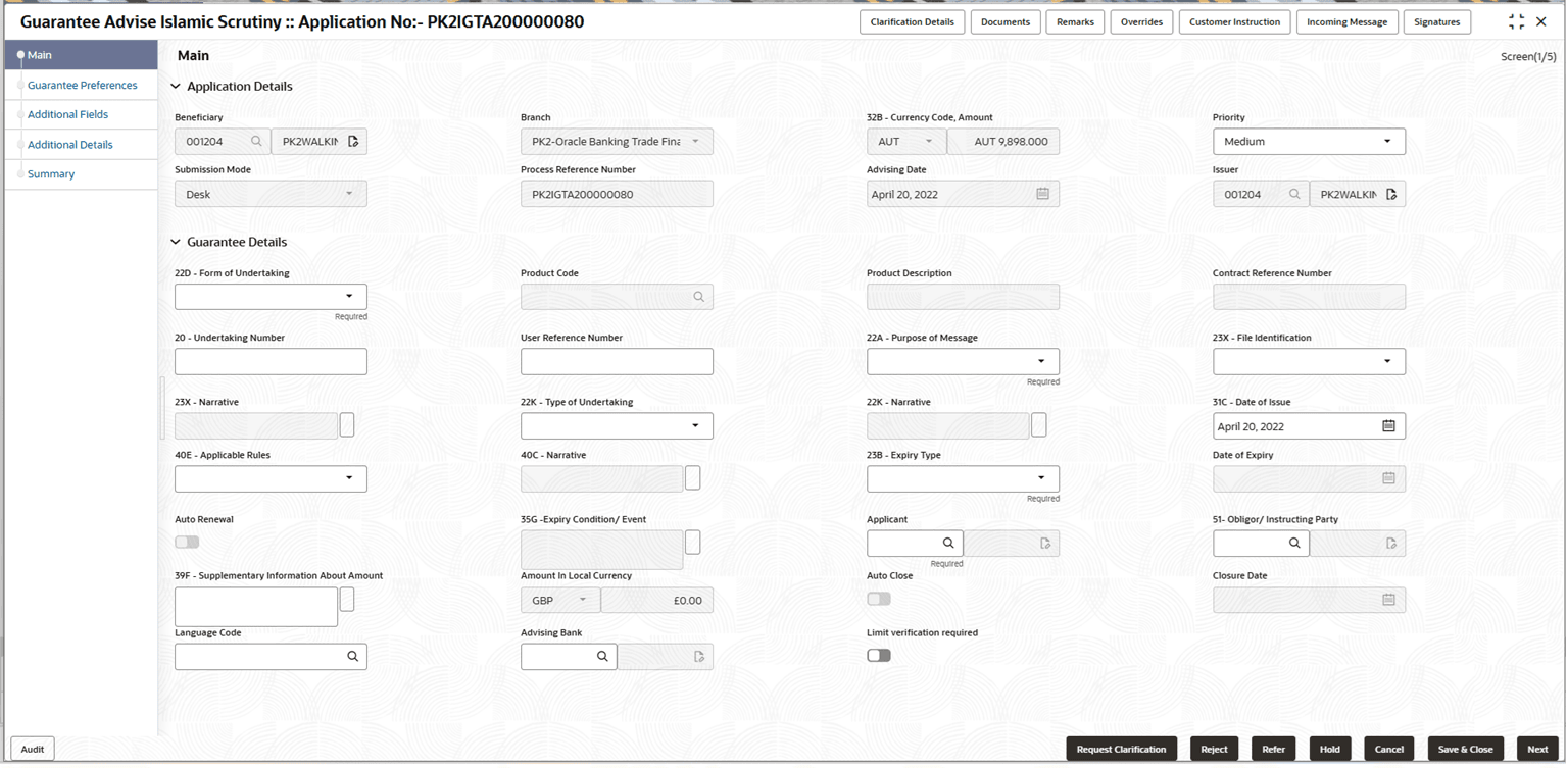

2.3.1 Main Details
This topic provides the systematic instructions to initiate the main details of Scrutiny stage of Guarantee Advise Islamic request.
Main details section has two sub section as follows:
  • Application Details
  • Guarantee Details.
Application Details
  1. On Scrutiny - Main Details screen, specify the fields that were not entered at Registration stage.
    The fields which are marked as Required are mandatory.
    For more information on fields, refer to the field description table below.
    Table 2-7 Guarantee Advise Islamic - Main - Application Details - Field Description
    Field Description
    Beneficiary Read-only field.
    Displays the beneficiary.
    Branch Read-only field.
    Displays the customer’s home branch based on the customer ID.
    Currency Code, Amount Read-only field.
    Displays the currency code of guarantee (with decimal places) as per currency type.
    Priority Set the priority of the Guarantee issuance request as Low/Medium/High/Essential/Critical. If priority is not maintained for the customer, system will populate 'Medium' as the default priority. User can change the priority populated any time before submit of Registration stage as per the requirement.
    If priority is not maintained for a customer, ‘Medium' priority will be defaulted. For Guarantee Advising MT760, the field is defaulted and user can change its value.
    Submission Mode Read-only field.
    Displays the submission mode of Guarantee Advise Islamic request. By default the submission mode will have the value as ‘Desk’.
    • Desk - Request received through Desk
    • Courier - Request received through Courier
    Process Reference Number Read-only field.
    Unique OBTFPM task reference number for the transaction.
    This is auto generated by the system based on process name and branch code.
    For Guarantee Advising MT760, the Process Reference Number is read only and generated by the system.
    Advising Date Read-only field.
    Displays the branch’s current date by default. If approved on a subsequent date, that date will be populated here.
    Issuer Read-only field.
    Displays the issuing bank name.

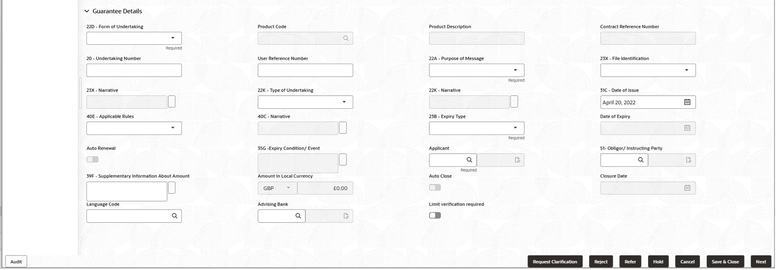

    Guarantee Details
    The fields listed under this section are same as the fields listed under the Guarantee Details section in Registration stage. For more information on the fields, refer Registration stage. During Registration, if user has not captured input, then user can capture the details in this section.
    Table 2-8 Guarantee Advise Islamic - Main - Guarantee Details - Field Description
    Field Description
    Form of Undertaking Select the type of LC (Documentary Credit) as per the requirement. By default LC type is Irrevocable.
    • DGAR - Guarantee
    • STBY - Standby LC

    Date of Issue Displays the branch’s current date as date of issue defaulted from the application.
    User cannot change the defaulted date. Application will populate the Date of Issue field with branch date on approval if date of approval is later than date of Registration.
    Expiry Type Select the expiry type for guarantee advise.
    This field indicates whether undertaking has specified expiry date or is open-ended.
    The options are:
    • COND- Without Expiry
    • COND- With Expiry
    • FIXD - Specified expiry date (with/without automatic expansion)
    • OPEN - No specific date of expiry
    Date of Expiry Select the expiry date of the LC. The expiry date can be equal or greater than the issue date.
    If the Expiry Date is earlier than the issue date, system will provide an error and if the ‘Expiry Date is equal to the Issue Date’, system will provide a alert message.
    The field is enabled, if Expiry Type is COND - With Expiry and FIXD..
    Expiry Condition/Event Specifies the documentary condition/event that indicates when the local undertaking will cease to be available.
    The field is enabled, if Expiry Type is COND - With Expiry or COND - Without Expiry.
    Applicant Specify the applicant or alternatively, click Search to search and select the applicant from the look-up.
    If the request is received from Applicant bank, select the applicant from the List of Values.
    Obligor/ Instructor Party Specify the party obligated to reimburse the issuer or click Search to search and select the name of the obligor from the lookup.
    Applicable Rules Select the applicable rules for guarantee issuance.
    The options are:
    • URDG - Uniform rules for demand guarantees
    • UCPR - Uniform customs and Practices
    • ISPR - International standby Practices
    • NONE - Not subject to any rules
    Narrative Specify the description in this field, if Applicable Rules field values is NONE .
    Supplementary Information About Amount Specify the additional information about amount related to undertaking.
    Amount In Local Currency Read only field.
    After the tab out of ‘Currency Code, Amount’ field, system populates the Local currency and amount value in this field. System fetches the local currency equivalent value for the transaction amount from back office (with decimal places).
    Auto Close Enable the option, if Auto close is required for that transactions.
    Disable the option, if Auto close is not required for that transactions.
    Closure Date Displays the “Closure Date”defaulted by the system, with the value “Expiry Date” + No of Closure days maintained in the respective Product in which the contract has been created.
    System automatically close the contract on the specified “Closure Date” if “Auto Close” is selected as “Yes” for the specific contract.
    User can modify the system defaulted “Closure Date” and system should validate the same for the below conditions,
    • Closure Date must be after the Issue Date.
    • Closure Date must be after the Expiry Date.
    • Closure Date cannot be blank, when the “Auto Close” is checked.
    The field is enabled, if Auto Close field is enabled.
    Language Code Click Search to search and select the language code from the look-up.
    Advising Bank Specify the Advising Bank reference number or click Search to search and select the advising bank reference number from look-up, by entering the search criteria.
    Limit verification required Switch to Enable to enables for limit verification.
    Switch to Disable ,
    and provide the Finance Amount, the system prompts an override message on Submit.
    AuditDescription of audit1.png follows
    This button provides information about user initiated the transaction, initiated date, stage wise detail etc.
    For more information on audit, refer to the field description table below.
    Table 2-9 Audit - Field Description
    Field Description
    Application No. This field displays the appliation number of the process.
    Branch Code This field displays the branch code.
    Initiated Date This field displays the date on which process is initiated.
    Initiated By This field displays the user ID of the user who had initiated the process.
    Process Name This field displays the name of the process which is initiated.
    S. No This field displays the serial number of the audit record.
    Stage Name This field displays the current stage of the process.
    Completed Time This field displays the time on which the audit of the current stage is completed.
    Completed By This field displays the user ID of the user who had completed the audit.
    Outcome This field displays the outcome of the audit.
