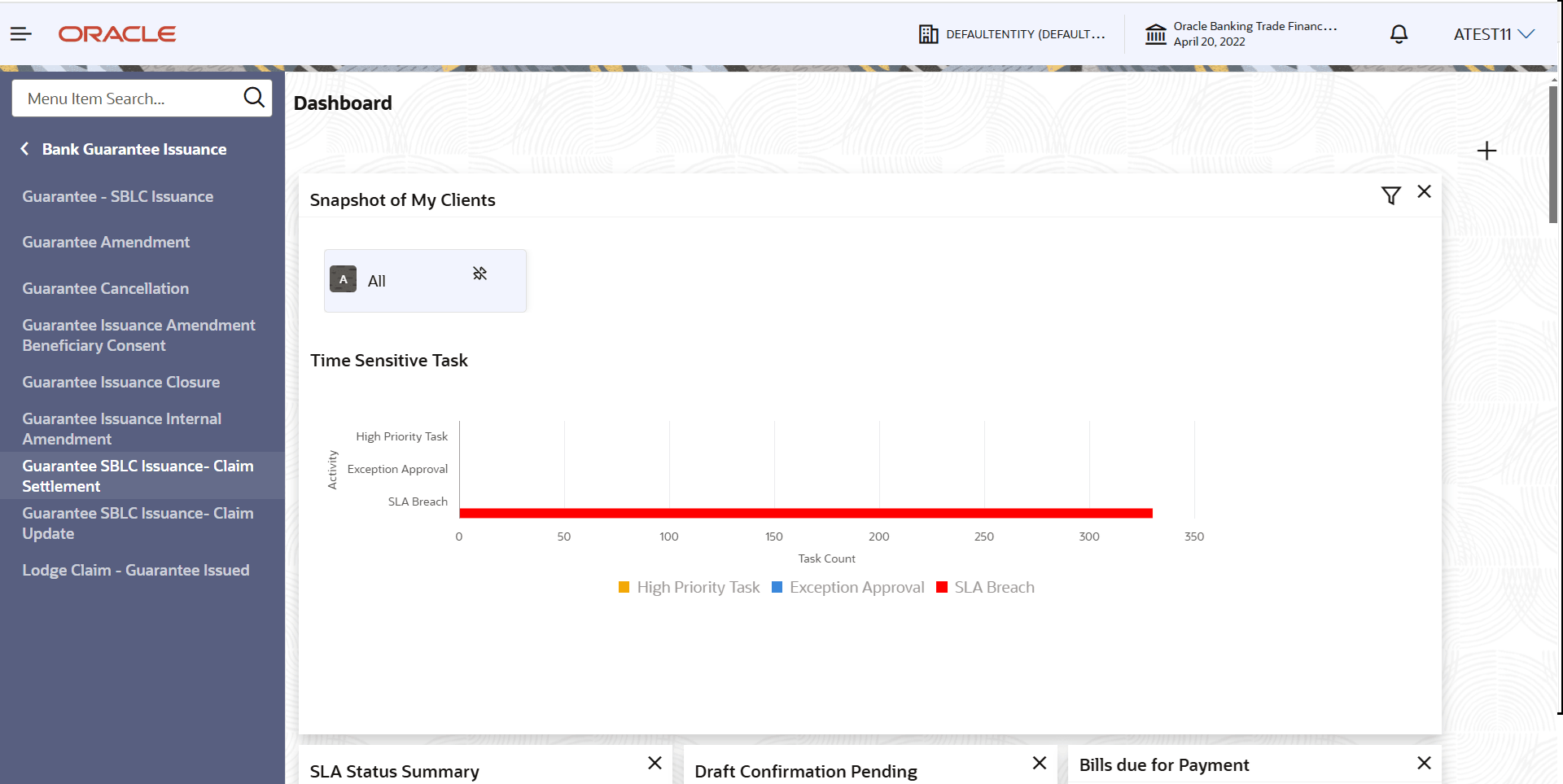

Specify User ID and Password, and login to Home screen.
  1. On Home screen, click Trade Finance. Under Trade Finance, click Bank Guarantee Issuance.
  2. Under Bank Guarantee Issuance, click Guarantee SBLC Issuance - Claim Settlement.

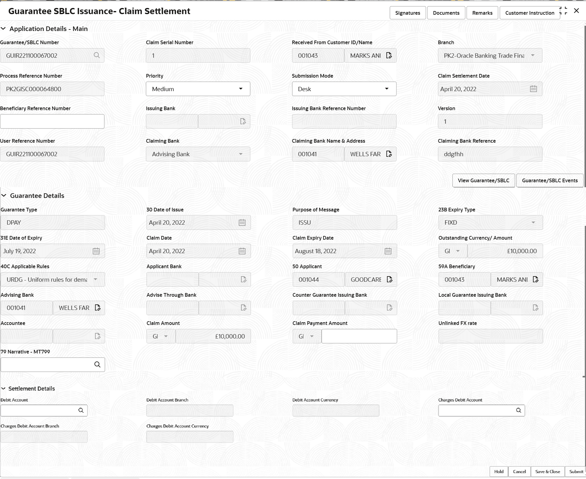

    The Guarantee SBLC Issuance Claim Settlement - Registration stage has two sections Application Details and Guarantee Details. Let’s look at the details of Registration screens below:
    The request is received at the Branch/ Front office or Processing centre. The user should be able to input the following details.
  3. On Guarantee SBLC Issuance - Claim Settlement - Registration - Application Details screen, specify the fields.
    The fields which are marked as Required are mandatory.
    For more information on fields, refer to the field description table below.
    Table 2-3 Guarantee SBLC Issuance - Claim Settlement - Registration - Application Details
    Field Description
    Guarantee/SBLC Number Specify the Guarantee/SBLC number.
    Alternatively, click Search to search and select the Guarantee/SBLC number from the look-up.
    Claim Serial Number Read only field.
    System defaults the claim serial number from Guarantee/ SBLC claim.
    Received From Customer ID/Name Read only field.
    System defaults the customer ID/ Name from Guarantee/ SBLC claim.
    Branch Read only field.
    System defaults the branch name from Guarantee /SBLC issuance.
    Customer’s home branch will be displayed.
    Process Reference Number Read only field.
    Unique sequence number for the transaction. This is auto generated by the system based on process name and branch code.
    Priority Priority maintained will be populated as either Low or Medium or High or Essential, Critical. If priority is not maintained for a customer, Medium priority will be defaulted.
    User can change the priority populated any time before submit of Registration stage.
    Submission Mode Select the submission mode of Guarantee Issuance Claim Settlement request from the drop-down list.
    By default the submission mode will have the value as ‘Desk’.
    • Desk - Request received through Desk
    • Fax- Request received through Fax
    • Email- Request received through Email
    Claim Settlement Date Read only field.
    By default, the application will display branch’s current date for the claim settlement date.
    Beneficiary Reference Number Specify the Beneficiary Reference Number.
    Issuing Bank Read only field.
    System defaults the Issuing Bank name from Guarantee/ SBLC claim.
    Issuing Bank Reference Number Read only field.
    System defaults the Issuing Bank Reference Number from Guarantee/ SBLC claim.
    Version Read only field.
    System defaults the version number.
    User Reference Number Read only field.
    Claiming Bank Read only field.
    The Claiming Party from whom the claim under the Bank Guarantee issued is received while lodging the Guarantee Claim.
    Claiming Bank Name & Address Read only field.
    This field displays the claiming bank details, that is bank ID and name.
    Claiming Bank Reference Read only field.
    This field displays the claiming bank reference number.

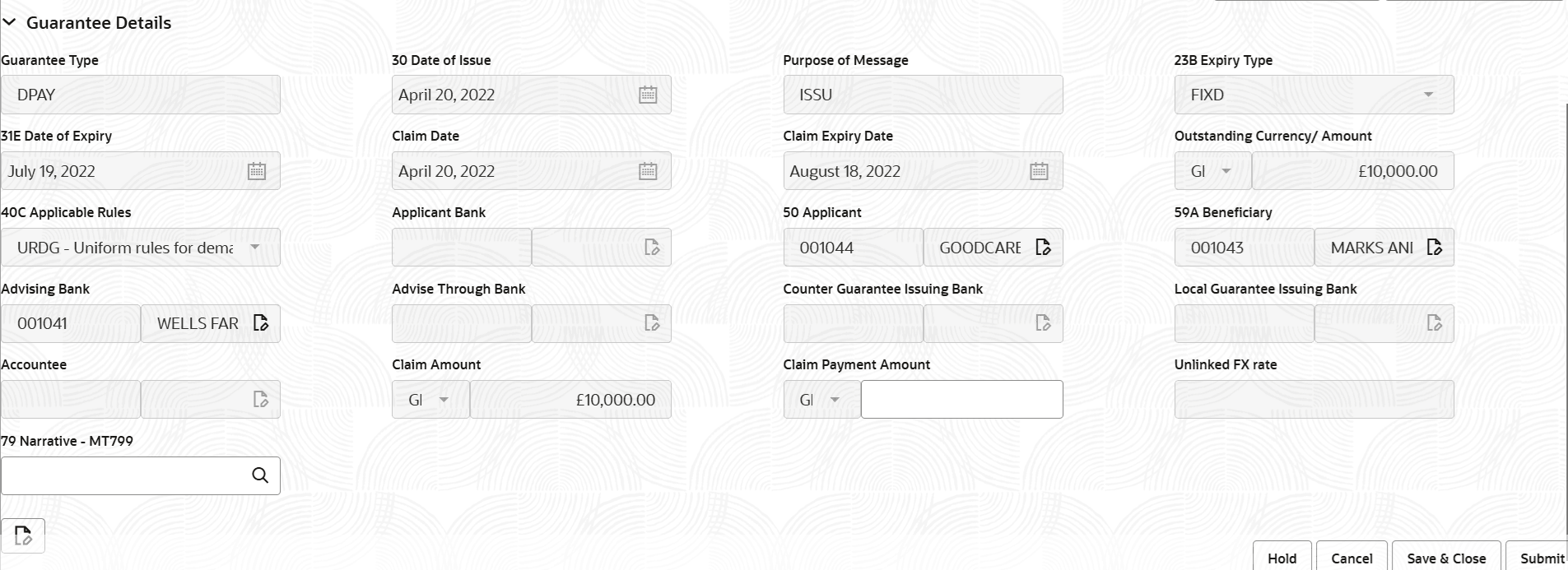

    Guarantee Details
    Registration user can provide Guarantee details in this section. Alternately, guarantee details can be provided by Data Enrichment user. Description of registrationguaranteedetails1.png follows
  4. On Guarantee SBLC Issuance - Claim Settlement - Registration - Guarantee Details screen, specify the fields.
    Table 2-4 Guarantee SBLC Issuance - Claim Settlement - Registration - Guarantee Details - Field Description
    Field Description
    Guarantee Type Read only field.
    System defaults the Guarantee type from Guarantee/ Standby Issuance.
    Date of Issue Read only field.
    System defaults the date of issue from Guarantee /SBLC issuance.
    Purpose of Message Read only field.
    System defaults the purpose of message from Guarantee/ Standby Issuance. The value can be:
    • URDG - Uniform rules for demand guarantees
    • UCPR - Uniform customs and Practices
    • ISPR - International standby Practices
    • NONE - Not subject to any rules
    • OTHR
    Expiry Type Read only field.
    System defaults the expiry type from Guarantee/ SBLC Issuance.
    Date of Expiry Read only field.
    Expiry date of the Guarantee Issuance.
    System defaults the expiry date from Guarantee/ SBLC Issuance.
    Claim Date Read only field.
    System defaults the claim date from Guarantee/ SBLC Issuance.
    Claim Expiry Date Read only field.
    System defaults the claim expiry date from Guarantee/ SBLC Issuance.
    Outstanding Currency/ Amount Read only field.
    System defaults outstanding currency and amount from Guarantee/ Standby Issuance.
    Applicable Rules Read only field.
    This field displays the rules of the Guarantee/ Standby issuance.
    System defaults the value from Guarantee issuance details.
    Applicant Bank Read only field.
    This system defaults the applicant bank details from Guarantee issuance.
    Applicant Read only field.
    System defaults the applicant from Guarantee issuance.
    Beneficiary Read only field.
    System defaults the beneficiary from Guarantee/ SBLC Issuance.
    Advising Bank Read only field.
    System defaults the details of the advising bank, if available.
    Advising Through Bank Read only field.
    System defaults the value of advising through bank from Guarantee/ Standby Issuance, if available.
    Counter Guarantee Issuing Bank Read only field.
    System defaults the counter guarantee issuing through bank, if available.
    Local Guarantee Issuing Bank Read only field.
    System defaults the loacl guarantee issuing bank, if available.
    Accountee Read only field.
    System defaults the accountee name, if available in Guarantee.
    Claim Amount Read only field.
    System defaults the claim amount from the Guarantee Claim.
    Claim Payment Amount Specify the the claim payment amount.
    Unlinked FX rate Read only field.
    If claim currency is different from local currency system displays the unlinked FX rate.
    Narrative - MT799 Specify or click Search to search and select the narrative.

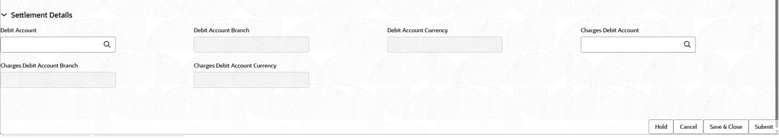

  5. On Guarantee SBLC Issuance - Claim Settlement - Registration - Settlement Details screen, specify the fields.
    Figure 2-5 Guarantee SBLC Issuance - Claim Settlement - Registration - Settlement Details
  6. For more information on fields, refer to the field description table below.
    The fields which are marked as 'Required' are mandatory.
    Table 2-5 Guarantee SBLC Issuance - Claim Settlement - Registration - Settlement Details - Field Description
    Field Description
    Settlement Details Specify the following settlement details:
    Debit Account
    Select the customer Debit Account from the list of values. If not selected, the default settlement account is used for debit components in this contract.
    Debit Account Branch Read only field.
    This field displays the Debit Account Branch as per the Debit Account selected.
    Debit Account Currency Read only field.
    This field displays the Debit Account Currency as per the Debit Account selected.
    Charges Debit Account Select the account for debiting charges, commission, and taxes. If not selected, the system defaults to the maintained settlement account for all applicable components, and users can modify it at the component level.
    • If both the Debit Account and the Charges Debit Account are selected, the Debit Account applies to Cash Collateral, and the Charges Debit Account applies to Charges, Commission, and Taxes.
    • If only the Charges Debit account is selected, that is applicable only for Commission, Charge, and Tax, not for Cash Collateral.
    • If only the debit account is selected, it applies to Commission, Charge, Tax and Cash Collateral.
    Charges Debit Account Branch Read only field.
    This field displays the Charges Debit Account Branch as per the Charges Debit Account selected.
    Charges Debit Account Currency Read only field.
    This field displays the Charges Debit Account Currency   as per the Charges Debit Account selected.
