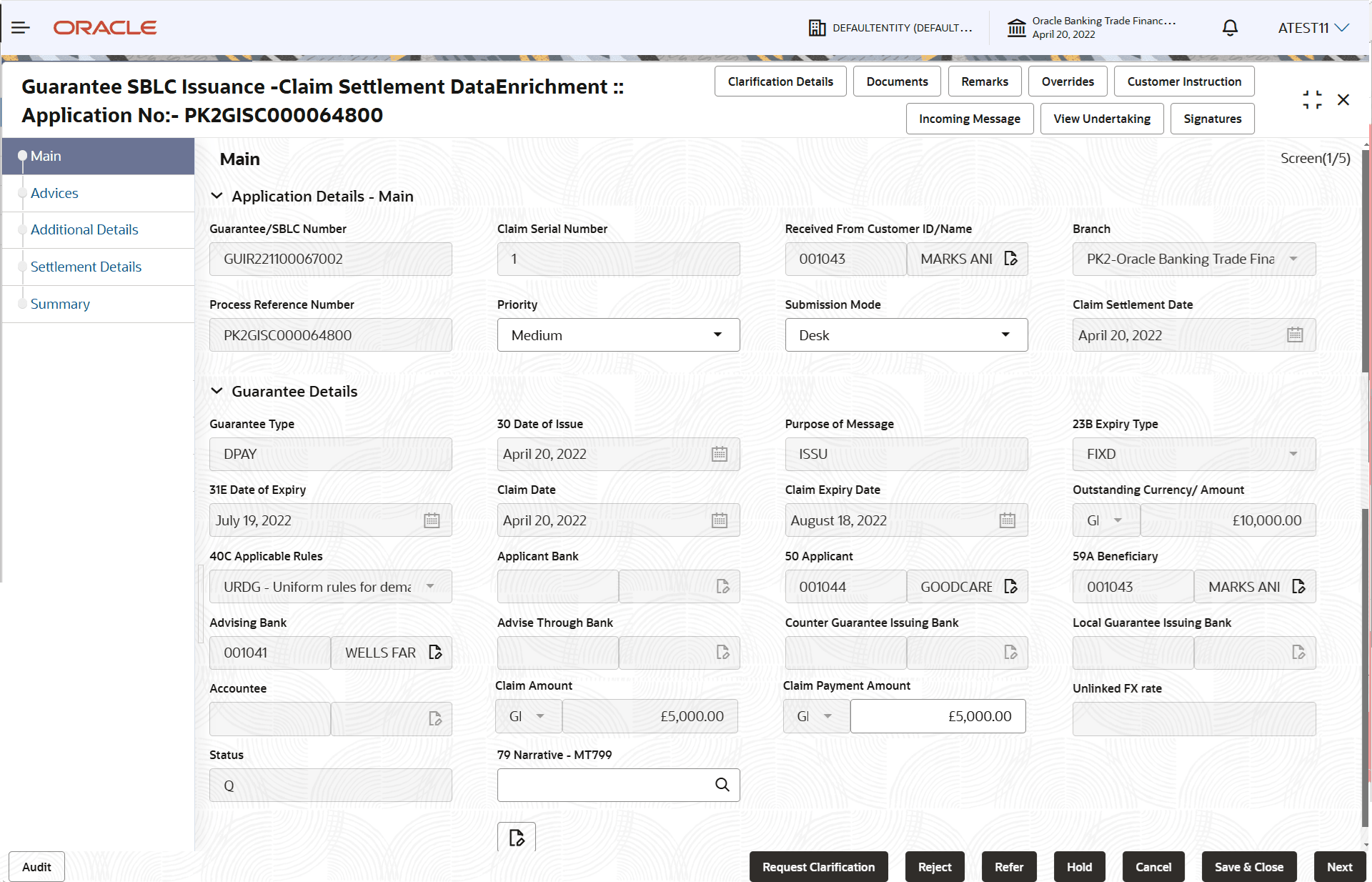

2.3.1 Main Details
This topic provides the systematic instructions to initiate the main details of Data Enrichment stage of Guarantee Issuance Claim Settlement request.
Main details section has two sub section as follows:
  • Application Details
  • Guarantee Details.
Application Details
  1. On Data Enrichment - Main screen, specify the fields that were not entered at Registration stage.
    Figure 2-8 Data Enrichment - Main
    Description of Figure 2-8 follows
    Description of "Figure 2-8 Data Enrichment - Main "
    The fields which are marked as Required are mandatory.
    For more information on fields, refer to the field description table below.
    Table 2-7 Main - Application Details - Field Description
    Field Description
    Guarantee/SBLC Number Read only field.
    System defaults the value from Registration stage.
    Claim Serial Number Read only field.
    System defaults the claim serial number from Guarantee/ SBLC claim.
    Beneficiary ID/Name Read only field.
    System defaults the customer ID/ Name from Guarantee/ SBLC claim.
    Branch Read only field.
    System defaults the branch name from Guarantee /SBLC issuance.
    Process Reference Number Read only field.
    Unique OBTFPM task reference number for the transaction.
    This is auto generated by the system based on process name and branch code.
    Priority Priority maintained will be populated as either Essential/Critical/Low/Medium/High. If priority is not maintained for a customer, Medium priority will be defaulted.
    User can change the priority.
    Submission Mode System defaults the submission mode of Lodge Claim Guarantee Issued request.
    By default the submission mode will have the value as ‘Desk’.
    • Desk - Request received through Desk
    • Fax- Request received through Fax
    • Email- Request received through Email
    • Courier - Request received through Courier
    The user can change the submission mode.
    Claim Settlement Date Read only field.
    By default, the application will display branch’s current date for the claim settlement date.
    Beneficiary Reference Number Specify the Beneficiary Reference Number.
    Issuing Bank Read only field.
    System defaults the Issuing Bank name from Guarantee/ SBLC claim.
    Issuing Bank Reference Number Read only field.
    System defaults the Issuing Bank Reference Number from Guarantee/ SBLC claim.
    Version Read only field.
    System defaults the version number.
    User Reference Number Read only field.
    Claiming Bank Read only field.
    The Claiming Party from whom the claim under the Bank Guarantee issued is received while lodging the Guarantee Claim.
    Claiming Bank Name & Address Read only field.
    This field displays the claiming bank details, that is bank ID and name.
    Claiming Bank Reference Read only field.
    This field displays the claiming bank reference number.

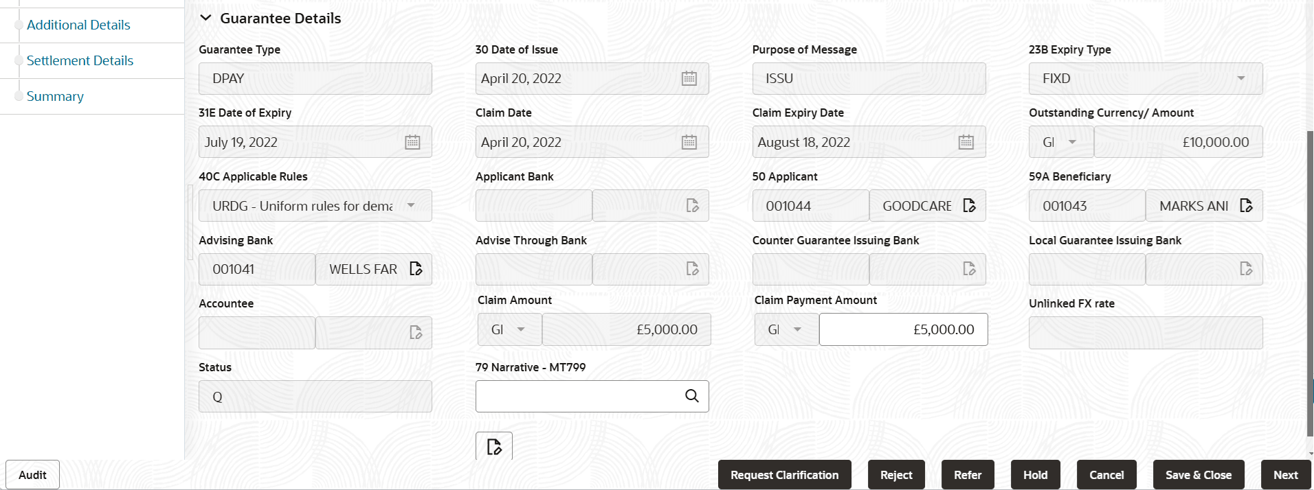

    Main - Guarantee Details
    The fields listed under this section are same as the fields listed under the Guarantee Details section in Registration stage. During registration, if user has not captured input, then user can capture the details in this section.
    Figure 2-9 Main - Guarantee Details
    Description of Figure 2-9 follows
    Description of "Figure 2-9 Main - Guarantee Details"
    Table 2-8 Main - Guarantee Details - Field Description
    Field Description
    Guarantee Type Read only field.
    Guarantee type defaults from Guarantee/ Standby Issuance.
    Date of Issue Read only field.
    System defaults the date of issue from Guarantee /SBLC issuance.
    Purpose of Message Read only field.
    System dafaults the purpose of message from Guarantee/ Standby Issuance.
    Expiry Type Read only field.
    System defaults the expiry type from Guarantee/ SBLC Issuance.
    Date of Expiry Read only field.
    Expiry date of the Guarantee Issuance.
    System defaults the expiry date from Guarantee/ SBLC Issuance.
    Claim Date Read only field.
    System defaults the claim date from Guarantee/ SBLC Issuance.
    Claim Expiry Date Read only field.
    System defaults the claim expiry date from Guarantee/ SBLC Issuance.
    Outstanding Currency/ Amount Read only field.
    System defaults outstanding currency and amount from Guarantee/ Standby Issuance.
    Applicable Rules Read only field.
    System defaults the value from Guarantee issuance details.
    Applicant Bank Read only field.
    This system defaults the applicant bank details available in Guarantee.
    Applicant Read only field.
    System defaults the applicant from Guarantee/ SBLC Issuance.
    Beneficiary Read only field.
    System defaults the beneficiary as in Guarantee/ SBLC Issuance.
    Advising Bank Read only field.
    System defaults the advising bank if available.
    Advising Through Bank Read only field.
    System defaults the advising through bank if available in issuance.
    Counter Guarantee Issuing Bank Read only field.
    System defaults the counter guarantee issuing through bank, if available in issuance.
    Local Guarantee Issuing Bank Read only field.
    System defaults the local guarantee issuing bank, if available in issuance.
    Accountee Read only field.
    System defaults the accountee name, if available in Guarantee.
    Claim Amount Read only field.
    System defaults the claim amount from the Guarantee Claim.
    Claim Payment Amount System defaults the claim amount from the Guarantee Claim.
    Unlinked FX rate Read only field.
    If claim currency is different from local currency system displays the unlinked FX rate.
    Narrative - MT799 Specify or click Search to search and select the narrative.

  2. Click Next.
    The task will move to next data segment.
