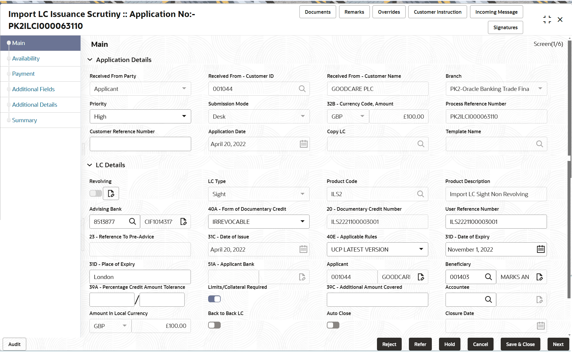

2.4.1 Main
This topic provides the systematic instructions to initiate the main details of Scrutiny stage of import LC Issuance request.
Main details section has two sub section as follows:
  • Application Details
  • LC Details.
Application Details
All fields displayed under Basic details section, would be read only except the Priority and Customer Reference Number' fields. For more information on the fields, refer Application Details of Registration stage .
  1. On Scrutiny - Main screen, specify the fields that were not entered at Registration stage.
    Table 2-8 Scrutiny - Main - Application Details - Field Description
    Field Description
    Received from Party Read only field.
    Import LC Issuance request can be received either from the applicant or the applicant’s bank or accountee.
    Received From - Customer ID Read only field.
    The Customer ID of the applicant or applicant’s bank, as selected in Registration stage.
    Received From - Customer Name Read only field.
    Name of the customer or applicant. This field will be auto populated based on the selected customer ID.
    Branch Read only field.
    By default, customer’s home branch will be displayed based on the customer ID and it can be changed, if required.
    Priority Set the priority of the Import LC issuance request as Essential/Critical/Low/Medium/High. If priority is not maintained for the customer, system will populate 'Medium' as the default priority.
    User can change the priority populated any time before submit of Registration stage.
    Submission Mode Read only field.
    The submission mode of Import LC Issuance request.
    By default the submission mode will have the value as ‘Desk’.
    Currency Code, Amount Read only field.
    The currency code and amount is defaulted from Registration stage.
    Process Reference Number Read only field.
    Unique OBTFPM task reference number for the transaction.
    This is auto generated by the system based on process name and branch code.
    Customer Reference Number Specify a unique Customer Reference Number which will be the User Reference of the LC.
    Application Date Read only field.
    The application displays the branch’s current date by default.
    Copy LC Read only field.
    Displays the LC number and LC details, if selected/entered in Registration stage.
    Template Name Read only field.
    Displays the template name and details if selected/entered in Registration stage.

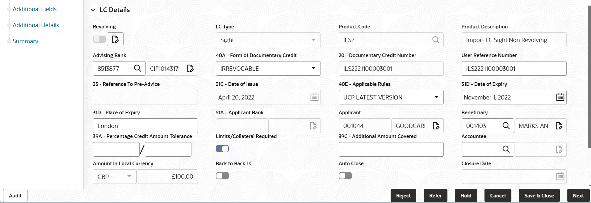

    LC Details
    The fields listed under this section are same as the fields listed under the LC Details section in Registration stage. During Registration, if user has not captured input, then user can capture the details in this section.
    For more information on fields, refer to the field description table below.
    Table 2-9 Scrutiny - Main - LC Details - Field Description
    Field Description
    Revolving Read only field.
    Displays whether the LC type is revolving.
    LC Type Read only field.
    Displays the applicable LC type.
    Product Code Read only field.
    Displays the product code. The value is defaulted from Registration stage.
    Product Description Read only field.
    Displays the description of the product as per the product code.
    Advising Bank Specify the advising bank name or click Search to search and select the advising bank based on Party ID/Party Name. User can also input the party ID and on tab out system will validate and populate the 'Advising Bank’ name.
    1. In case the selected Bank is not RMA Compliant, the system prompts the user to use a different advising bank or use non SWIFT Media to transmit the LC and displays error message “RMA arrangement not available, please change the bank or use MAIL Medium”.
    2. If the party is blacklisted the system displays a warning message.
    3. If the KYC non-compliant party is selected then the system immediately gives instant alert as “Customer ID - (CIF ID) is not KYC compliant.”
    Form of Documentary Credit Select the type of LC (Documentary Credit) as per the requirement. By default LC type is Irrevocable.
    Documentary Credit Number Read only field.
    This field displays the documentary credit number, simulated from the back office. Number will be populated on the selection of Product Code.
    User Reference Number User Reference Number will be auto populated by the system based on selection of Product Code.
    This field is editable.
    Reference To Pre-Advice Read only field.
    This field displays the details of Pre-Advice, if issued by the bank.
    Date of Issue Read only field.
    This field displays the branch’s current date as date of issue defaulted from the application.
    User cannot change the defaulted date. Application will populate the Date of Issue field with branch date on approval if date of approval is later than date of Registration.
    Applicable Rules Select the applicable rules for the LC. Default rule as UCP Latest Version.
    Rule Narrative Specify the rules narrative.
    Enter the rules narrative. This field is available if the value in Applicable Rules is OTHR.
    Date of Expiry Select the expiry date of the LC. The expiry date can be equal or greater than the issue date.
    If the Expiry Date is earlier than the issue date, system will provide an error and if the ‘Expiry Date is equal to the Issue Date’, system will provide a alert message.
    Place of Expiry Specify the place of expiry of LC.
    Applicant Bank Read only field.
    This field displays the applicant bank details , if Received From Party is Applicant's Bank, the applicant bank details will be displayed here.
    If request is not received from applicant bank, this field must be blank.
    Applicant Read only field.
    This field displays the applicant details based on the details provided in Application Details section.
    If the request is received from Applicant bank, select the applicant from the List of Values.
    1. If the selected applicant/ party is blacklisted the system displays a warning message.
    2. If the KYC non-compliant party is selected then the system immediately gives instant alert as “Customer ID - (CIF ID) is not KYC compliant.”
    Beneficiary Specify the beneficiary of the LC or click Search to search and select the beneficiary based on Party ID/Party Name.
    If beneficiary is not a customer of the bank, then choose WALKIN customer id and provide the beneficiary details. If beneficiary is a customer and KYC status is not valid, then system will display alert message.
    If the selected beneficiary/ party is blacklisted the system displays a warning message.
    Percentage Credit Amount Tolerance Specify the tolerance (+/-) on the total LC value. Tolerance value must be either one or two digit value.
    If tolerance is more than 10%, alert message will be displayed.
    Limits/Collateral Required Switch to Enable the option, to enable limit check during the process flow of this request.
    Switch to Disable the option, to disable limit check during the process flow of this request.
    Additional Amount Covered Specify the additional amount included in LC.
    Accountee Specify the accountee or click Search to search and select the accountee.
    Amount In Local Currency Read only field.
    After the tab out of ‘Currency Code, Amount’ field, system populates the Local currency and amount value in this field. System fetches the local currency equivalent value for the LC amount from back office (with decimal places).
    Back to Back LC Read only field.
    Switch to Enable the option, if the back to back Import LC is issued.
    Switch to Disable the option, if back to back LC is not applicable.
    Export LC Reference Specify the export LC reference or click Search to search and select the underlying export LC reference number.
    This field is appears , if you enable Back to Back LC field.
    Export LC Available Amount System displays the available amount under the Export LC.
    Export LC Expiry Date System displays the expiry date of the underlying export LC.
    Export LC Shipment Date System displays the latest shipment date of the underlying export LC.
    Auto Close Switch to Enable the option, if Auto close is required for that transactions.
    Switch to Disable the option, if Auto close is not required for that transactions.
    Closure Date Read only field.
    This field displays the “Closure Date”defaulted by the system, with the value “Expiry Date” + No of Closure days maintained in the respective Product in which the contract has been created.
    System automatically close the contract on the specified “Closure Date” if “Auto Close” is selected as “Yes” for the specific contract.
    User can modify the system defaulted “Closure Date” and system should validate the same for the below conditions,
    • Closure Date must be after the Issue Date.
    • Closure Date must be after the Expiry Date.
    • Closure Date cannot be blank, when the “Auto Close” is checked.
