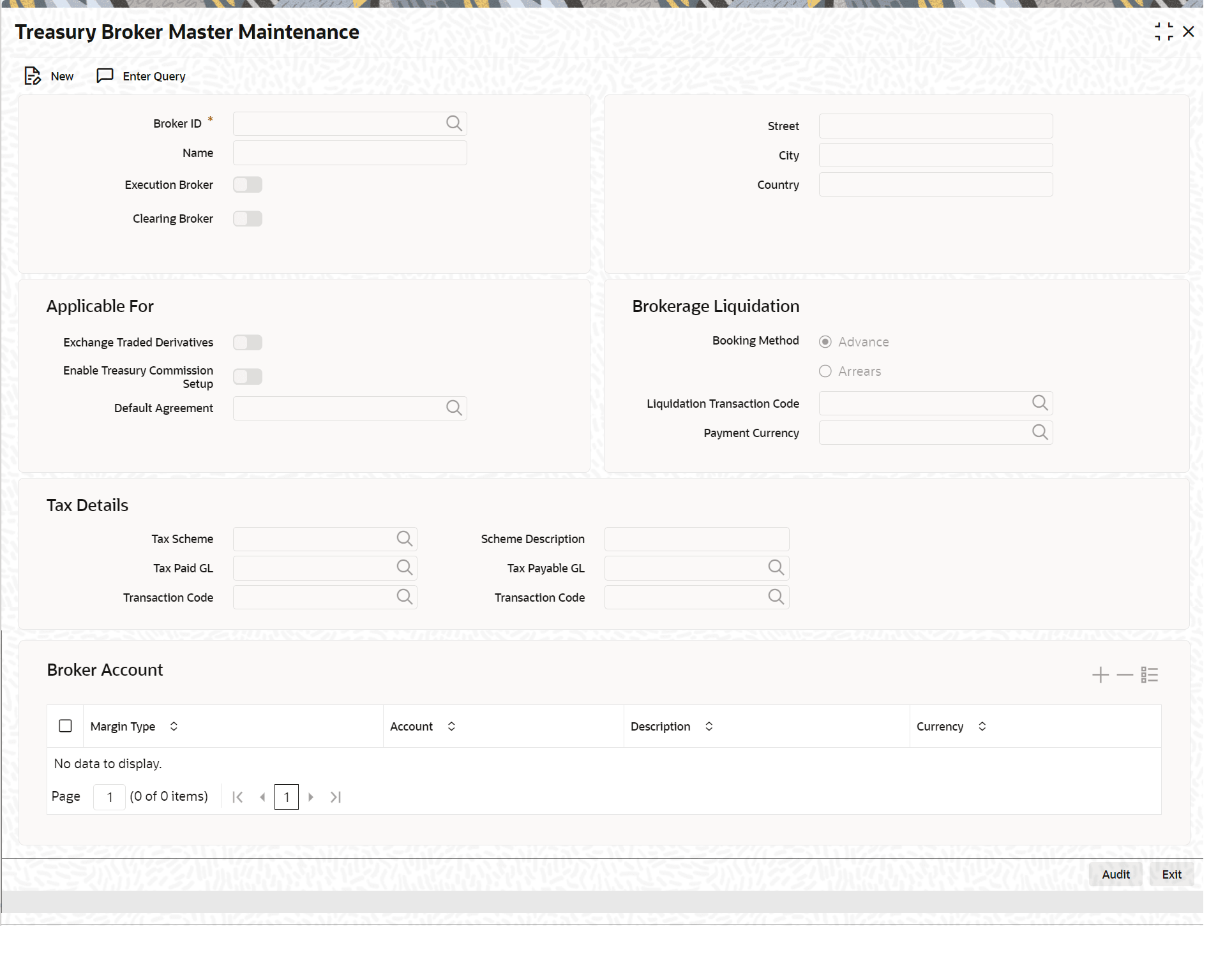

  1. On the Home page, enter BRDMAST in the field at the top right corner of the application tool bar and click Next.
    The Treasury Broker Master Maintenance screen displays.
    Figure 1-1 Treasury Broker Master Maintenance
    Description of Figure 1-1 follows
    Description of "Figure 1-1 Treasury Broker Master Maintenance"
    All fields with the (*) symbol are mandatory.
  2. In the Treasury Broker Master Maintenance screen, specify the fields.
    For description of the fields, refer to the below table.
    Table 1-1 Treasury Broker Master Maintenance- Field Description
