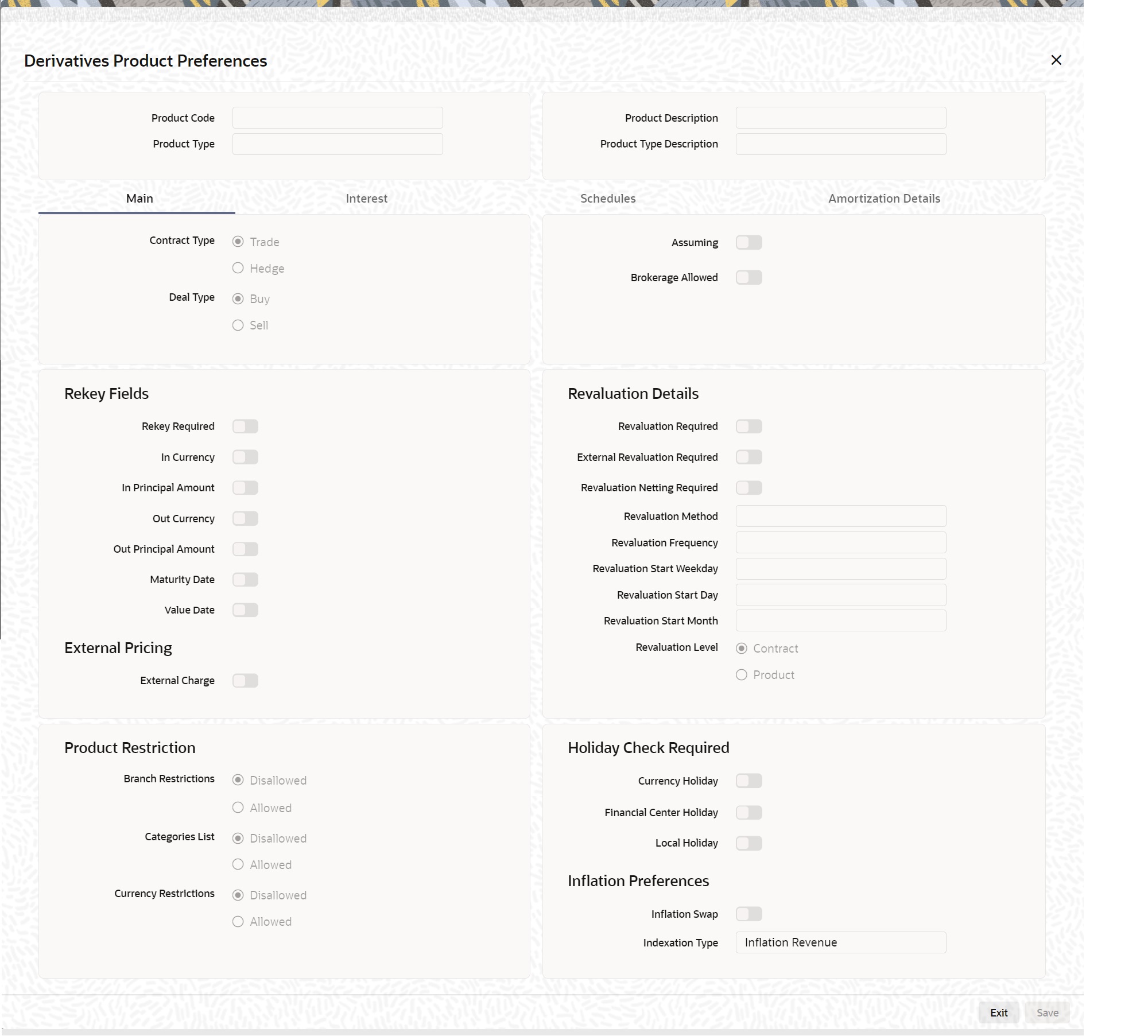

3.1.2 Preference
This topic describes the systematic instruction to define specific preferences screen.
- On Derivative Product Definition, click Preferences to process the Derivatives Product Preferences and to define specific preferences for the product.
The Product Code and Product Type are defaults from the Product Maintenance screen.
Preferences options are available for defining the attributes of a product. The preferences that define for a product are inherited by all derivative contracts that are associated with the product.
The Derivative Product Preferences screen is displayed - On Derivative Product Preferences, specify the fields and
click Ok.
For more information on fields, refer to the below table.
Table 3-2 Main Tab - Field Description
Field Description Contract Type
Indicate whether the product for which you are defining preferences is meant for Trade contracts or Hedge contracts.
Note: Its possible to Amend this preference while entering the details of the contract.
Deal Type
The first preference defines the derivative product is the Deal Type. Indicate the default nature of deals processed under this product. The choices available for these fields are:- Buy
- Sell
Note: The deal type that you specify will default to contracts under this product. However, you are allowed to change this while entering the details of the contract.
Assuming
Check this box to indicate that the assumed contract is from the counterparty. Uncheck this box if the product is used for a fresh contract.
Brokerage Allowed
Specify whether brokerage must be applied to deals involving this product by checking the box. If the brokerage is specified for the product, you can waive it for specific deals. But if you have specified that brokerage is not applicable to the product, it will not be able to levy brokerage on a specific deal involving the product.
Rekey Fields
When a derivative contract is processed for authorization- as a crosschecking mechanism, specify that the values of certain fields should be entered before the contract is authorized called the Rekey option. While defining the product, indicate the fields whose values need to specify before an authorized contract. Thus, it becomes mandatory for you to specify the values of rekey fields for all contracts linked to the product.
Note: It is possible to amend this preference while entering the details of the contract
Specify the following as rekey fields:- In Currency
- Out Currency
- Maturity Date
- In Principal Amount
- Out Principal Amount
- Value Date
If no rekey fields are defined, the details of the contract are displayed immediately, when the authorizer calls the product for authorization.
External Pricing Specify the fields.
External Charge
Check this box to indicate that external charges are fetched from external pricing and billing engine for contracts created under this product.
External Charge is enabled only when the system integrates with external pricing and billing engine (PRICING_INTEGRATION = Y at CSTB_PARAM level).
Revaluation Details
You may want to revalue your deal portfolio periodically to account for the gains and losses due to changes in the market interest rates or exchange rates.
Oracle Banking Treasury provides a feature to revalue the worth of derivative contracts linked to the product based on the Fair Price the Contract Rate or the Bank Rate.
Revaluation Required
Revalue the worth of contracts associated with the product at regular intervals.
Check this box to indicate whether revaluation is required for the defined product.
Note: At the time of processing a contract if decided that revaluation is not required, then choose to waive this option (even if at the product level you have specified that revaluation is necessary for contracts involving the product).
However at the product level, you have specified that revaluation is not required, then while processing the contract you will not be allowed to choose the revaluation option.
External Revaluation Required
Select the check box next to the External Revaluation Required, for the revaluation to be done externally.
If this field is checked, ensure to set the external revaluation level to either branch level or product level in Derivative Branch Parameter Maintenance.
Note: You can choose either the option Revaluation Required or External Revaluation Required at a time. Both these options cannot be chosen at the same time.
Revaluation Netting Required
If indicated that revaluation is required for the product, then indicate whether accounting passed entries is at the leg level or the contract level.
Check this box to indicate that revaluation entries should be passed at the contract leg level.
Revaluation Level and Method
In Oracle Banking Treasury, revaluation entries can be passed either at the product level or at the contract level.
After indicating the level for revaluation, indicate the method to be used for revaluation. The options available are:
- Fair Price
- Contract Rate
- Branch specific Interest Rate
The revaluation level and specified method determines how the product is revalued.
Note: Each of the above methods explained in detail in the chapter titled Defining Fair Price revaluation methods.
Revaluation Frequency
The frequency with which a product must be revalued has to be specified as a product preference. Once you have indicated the level and the method for revaluation, you can specify the frequency with which a product must be revalued.
The frequency are one of the following:
- Daily
- Weekly
- Monthly
- Quarterly
- Half Yearly
- Yearly
Note: If the revaluation date falls on a holiday, the revaluation is done as per your holiday handling specifications in the Branch Parameters screen.
Revaluation Start Weekday
In the case of weekly revaluation, specify the day of the week on which revaluation must be carried out. For example, if the revaluation must be carried out every Friday is specified, then the contract or product (depending on the level specified) is revalued every Friday of the week.
Note: The specified Revaluation Frequency at the product level cannot be changed while processing the contract.
Revaluation Start Day
In the case of monthly, quarterly, half-yearly or yearly revaluation, specify the date on which the revaluation must be done during the month. For example, if you specify the date as 30, revaluation will be carried out on that day of the month, depending on the frequency.
To fix the revaluation date for the last working day of the month, specify the date as 31 and indicate the frequency. If you indicate the frequency as monthly, the revaluation is done at the end of every month - that is, on 31st for months with 31 days, on 30th for months with 30 days and 28th or 29th, as the case may be, for February.
If you specify the frequency as quarterly and fix the revaluation date as 31, the revaluation is done on the last day of the month at the end of every quarter. It works similarly for half-yearly and yearly revaluation frequency.
Revaluation Start Month If you set the revaluation frequency as quarterly, half-yearly or yearly, you have to specify the month in which the first revaluation has to begin, besides the date on which the revaluation should be done.
For instance, You have selected the half-yearly option and specified the start date as 31 and the start month as of June, the system will do the first revaluation on the 30th of June for the period from 1st January to June 30th, and the second one on 31st December for the period from 1st July to 31st December.
Currency Holiday Select this check box, to execute the currency holiday calendar validation of the dates and movement of schedules.
Financial Center Holiday Select this check box, to execute the financial center holiday calendar validation of the dates and movement of schedules.
Local Holiday Select this check box, to execute the local holiday validation of the date and movement of schedules.
Inflation Preferences Specify the following fields.
Inflation Swap Check this box to indicate that the product type must be Inflation swap.
Indexation Type Select the indexation type from the adjoining drop-down list. The list displays the following values:- Inflation Revenue
- Zero Coupon
- Year on year

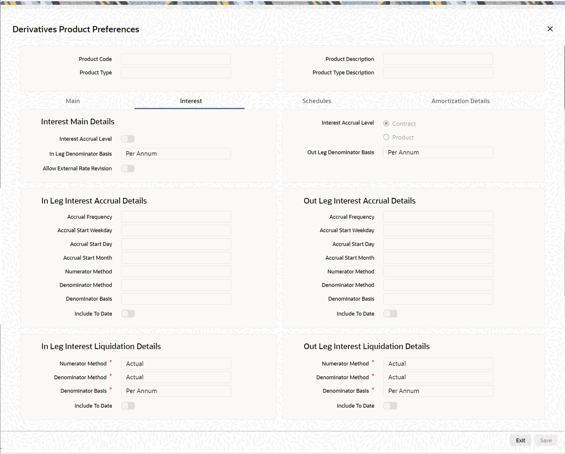

- On the Derivatives Product Preferences screen, click the Interest Tab
The Interest screen is displayed.
Figure 3-3 Derivatives Product Preferences- Interest
Description of "Figure 3-3 Derivatives Product Preferences- Interest" - On the Derivatives Product Preferences Interest screen, specify the fields, and click Ok.
For more information on fields, please refer to the below table..
As part of setting up the product preferences, you have to specify the relevant interest accrual details. The accrual details that you specify will be made applicable to all hedge contracts associated with the product.
Indicate whether interest must be accrued at the product or contract level for hedge deals. The interest accrual specifications must be done for both the inward and outward legs of the contract.
Table 3-3 Interest Field tab- Field Description
Field Description Interest Accrual Level
Check the box to indicate whether interest accrual is required for the contract. Leave the box unchecked to indicate that accrual is not applicable.
Note: Specify the accrual related details individually for the In and Out legs to indicate that interest accrual is required for the contract.
Here you can indicate the level at which accrual entries should be passed for the in leg of the contract. The options available are:
- Product
- Contract
At the product level, accruals will be passed for the product and currency combination. Those contracts for which accrual is required will be identified by the system and accrual entries will be passed based on the accounting entry set-up defined.
Indicates the level at which accrual entries must be passed for the in the leg of the contract. The available options are:
- Product
- Contract
At the product level, accruals will be passed for the product and currency combination. Those contracts for which accrual is required will be identified by the system, and accrual entries are passed based on the accounting entry set-up defined.
At the contract level, accruals are passed for individual contracts linked to the particular product.
In Leg Denominator Basis
Specify the interest accrual rate for the inward leg of the contract as one of the following:
- Per annum
- Per schedule period
Out Leg Denominator Basis
Specify the interest accrual rate for the outward leg of the contract as one of the following:
- Per annum
Allow External Rate Revision
Click the Allow External Rate Revision check-box to indicate that for the contracts linked to this product, you can allow rate revision based on the rates uploaded from an external system.
In Leg/Out Leg Interest Accrual Details The details maintained here are specific to the interest calculation methods to be applied during accruals. Any of the following combinations are allowed for calculating interest:
Actual / Actual
Click on Actual in Numerator Method field. Click on Actual in Denominator Method field.
The Actual number of days in the period, and the Actual number of days in that year.
Actual / 365
Click on Actual in Numerator Method field click on 365 days in the Denominator Method field.
The number of actual calendar days for which calculation is done or 365 days in a year.
Actual – Japanese /Actual
This is similar to the Actual/365 method except that leap days are always ignored in the denominator day count calculation.
Click on Actual in the Denominator Method field, click on Actual Japanese in the Numerator Method field.
365 – ISDA / Actual
Sum of (A) and (B) are:
A = (Interest accrual days falling within the leap year) / 366
B = (Interest accrual Days not falling within the leap year) /365
The denominator is the actual number of days in a year. Click on 365 ISDA in Numerator Method field; click on Actual in Denominator Method field.
Actual / 360
Click on Actual in Numerator Method field; click on 360 in Denominator Method field.
The actual number of calendar days for which calculation is done / 360 days.
The General Formula used for the day count method is described here Day count fraction = Number of Interest Accrual Days/ (Numerator) Days/ in the specified period (Per Annum/Per Period) (Denominator)
Note: Setting the Interest Frequency is done in the same manner as setting the Revaluation Frequency.
Numerator Method
Select the Interest method that should be applied during accrual for in/out leg from the adjoining drop down list. The list displays the following values:- 1
- ACT-ISMA
- 30-Euro
- 30-US
- Actual
- 30-ISDA
- 30-PSA
- Actual-Japanese
Denominator Method
Select the Interest method that should be applied during accrual for in/out leg from the adjoining drop down list. The list displays the following values:- 360
- 365
- Actual
- 1
- ACT-ICMA
Include To Date
Check this box, to take into account on the last day in an accrual period when arriving at the accrual days.
In Leg/Out Leg Interest Liquidation Details
Specify the fields:
Numerator Method
Select the Interest method that should be applied for liquidation for in/out leg from the adjoining drop down list. The list displays the following values:- 1
- ACT-ISMA
- 30-Euro
- 30-US
- Actual
- 30-ISDA
- 30-PSA
- Actual-Japanese
Denominator Method
Select the Interest method that should be applied for liquidation for in/out leg from the adjoining drop down list. The list displays the following values:- 360
- 365
- Actual
- 1
- ACT-ICMA
- Once you authorize the deal at the contract level, no changes will be allowed at the deal level for contract.

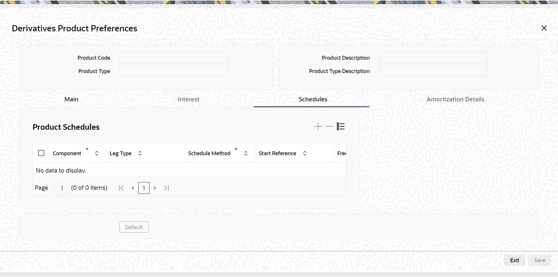

- On the Derivatives Product Preferences screen, click the Schedules Tab
The Schedules screen is displayed.
Description of the illustration dvdprmnt--cvs-preference--tab-schedules.png - On the Schedules screen, specify the fields, and click
Ok.
The schedule preferences for each of these components have to be defined separately for both the In and Out legs. Click the Schedules tab in the Product Preferences screen.
Specify the interest accrual preferences you have to indicate the repayment schedules for the following components:
- Principal (Repayment of principal schedules)
- Interest (Repayment of interest schedules)
- Revision of interest rates for a contract with periodic interest rates
Table 3-4 Product Schedule Details - Field Description
Field Description Component
Specify the component for which you are defining the schedule.
Leg Type
Indicates whether the component displayed is an In leg component or an Out leg component.
Schedule Method
Indicates the schedule type to which the component belongs. The component belongs to any one of the following types:
- Principal Reset: Identifies the schedule method as principal reset
Start Reference
The reference date is the date based on which the repayment schedules for the various components (Principal, Interest, Revision) is calculated. Specify the scheduled start period must either be based on the Value Date of the contract or that it must be based on a Calendar Date.
If you specify that the reference should be the Value Date the dates for scheduled repayment dates will be determined by the date of initiation of the contract and the frequency that you specify.
If the Reference is specified as Calendar Date, the dates for scheduled repayments are based on the Start Day, Month, and Frequency combination.
Frequency
The frequency of schedules that you specify along with the Start Reference and the Frequency Unit will determine the actual repayment schedules for the particular component.

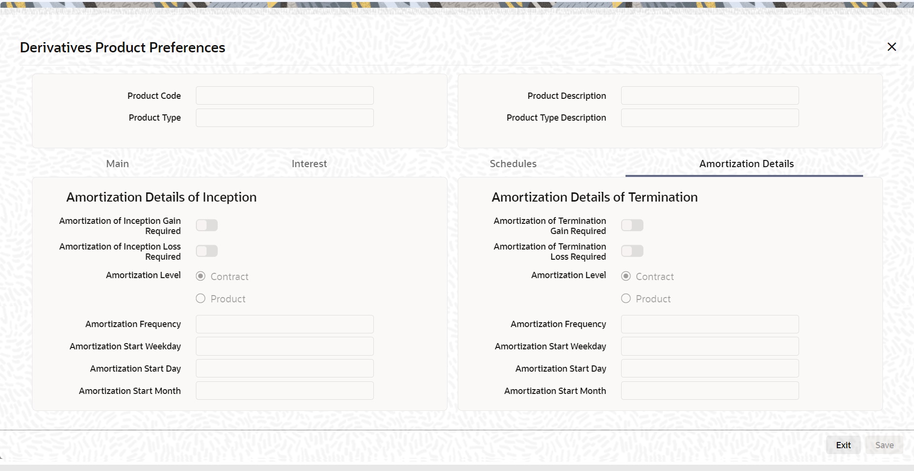

- On the Derivatives Product Preferences screen, click Amortization Details Tab.
The Amortization is displayed.
- On Amortization screen, specify the fields, and click
Ok.
The Product Code and Product Type are by default from the Product Maintenance screen. In this screen, specify the following:
Table 3-5 Amortization Details - Field Description
Field Description Amortization of Inception/Termination Gain Required
Indicates whether inception/termination gain requires amortization.
Check the respective box to indicate that amortization is required for inception/termination gain. Uncheck if amortization is not required.
If you choose these options, then amortization of inception/termination gain will be made applicable to all contracts associated with the product. You can, however, change it while entering the details of the contract. But if you indicate that amortization is not required, then you will not be allowed to change this preference while processing the contract.
At the time of inception, Gain is distributed throughout the period from Effective Date to Maturity Date of the contract.
At the time of termination, Gain is distributed throughout the period from Termination Date to Maturity Date of the contract.
In case of Termination Gain, system amortizes from the Termination Date to the Maturity Date of the contract; Whereas, in case of Inception Gain, system amortizes from the Effective Date to the Maturity Date of the contract.
Amortization of Inception/Termination Loss Required
Indicates whether inception/termination loss requires amortization.
Check the respective box to indicate that amortization is required for inception/termination gain. Uncheck if amortization is not required. The amortization loss value must be negative.
If you choose these options, then amortization of inception/termination loss will be made applicable all contracts associated with the product. You can however change it while entering the details of the contract.
At the time of inception, Loss is distributed throughout the period from Effective Date to Maturity Date of the contract.
At the time of termination, Loss is distributed throughout the period from Termination Date to Maturity Date of the contract.
In case of Termination Loss, system amortizes from the Termination Date to the Maturity Date of the contract; Whereas, in case of Inception Loss, system amortizes from the Effective Date to the Maturity Date of the contract.
Amortization Level
Indicate the level at which the amortization entries for inception/termination gain and/or loss should be passed. The options available are:
- Product
- Contract
At the product level, amortization entries will be passed for the product and currency combination. The system identifies those contracts, which need to be amortized for inception gain and/or loss and passes accounting entries based on the set-up defined for accounting entries.
At the contract level inception gain/loss amortization entries will be passed for individual contracts linked to the particular product.
Amortization Frequency
Indicate the amortization level for gain and loss of contract inception and termination, you have to specify the frequency at which amortization should take place.
The frequency can be one of the following:
- Daily
- Weekly
- Monthly
- Quarterly
- Half yearly
- Yearly
Amortization Start Weekday
In the case of weekly accrual, you should specify the day of the week on which interest accruals should be carried out. For instance if you specify that accruals should be carried out every Friday, then the contract or product (depending on the level specified) will be accrued on every Friday of the week.
Amortization Start Day
In the case of monthly, quarterly, half yearly or yearly amortization, you should specify the date on which the amortization should be done during the month. For example, if you specify the date as 30, amortization will be carried out on that day of the month, depending on the frequency.
If you want to fix the amortization date for the last working day of the month, you should specify the date as 31 and indicate the frequency. If you indicate the frequency as monthly, the amortization will be done at the end of every month - that is, on 31st for months with 31 days, on 30th for months with 30 days and on 28th or 29th, as the case may be, for February.
Specify the frequency as quarterly and fix the amortization date as 31, amortization will be done on the last day of the month at the end of every quarter. It works similarly for half-yearly and yearly amortization frequency.
If the amortization date falls on a holiday, the amortization is done as per your holiday handling specifications in the Branch Parameters screen.
Amortization Start Month
If the amortization frequency is set to quarterly, half yearly or yearly, specify the month in which the first amortization has to begin, besides the date on which the amortization must be done.
For example, if the half-yearly option is selected, and specified the start date as 31 and the start month as June.
The system process the first amortization on the 30 of June for the period from January 1 to 30th June. The second one is done on the 31st of December for the period from 1st July to 31st December.
