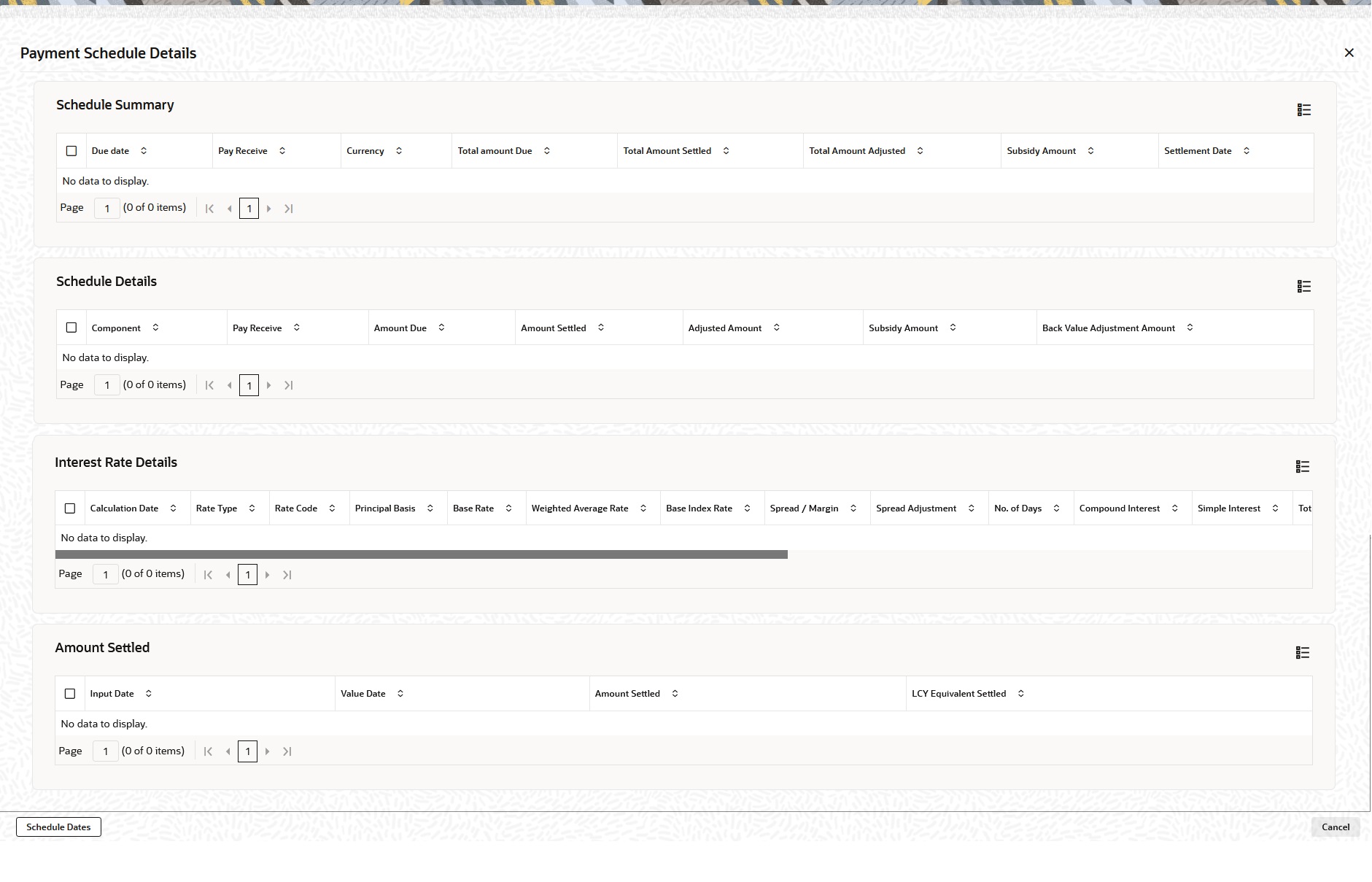

  1. On Islamic Money Market Contract Input > Schedules details screen, click Explode.
    Payment Schedule Details screen is displayed.
    Figure 4-5 Payment Schedule Details
    Description of Figure 4-5 follows
    Description of "Figure 4-5 Payment Schedule Details"
  2. On the Payment Schedule Details screen, view the Schedule Summary and Schedule details as required.
  3. On Money Market Contract Input with Schedules tab, View the details of the schedules for a particular deal as required.
    In this screen you can see the following details for the component:
    • The Due date of the Schedule
    • The Amount Due as of the due date
    • The amount liquidated against the schedule

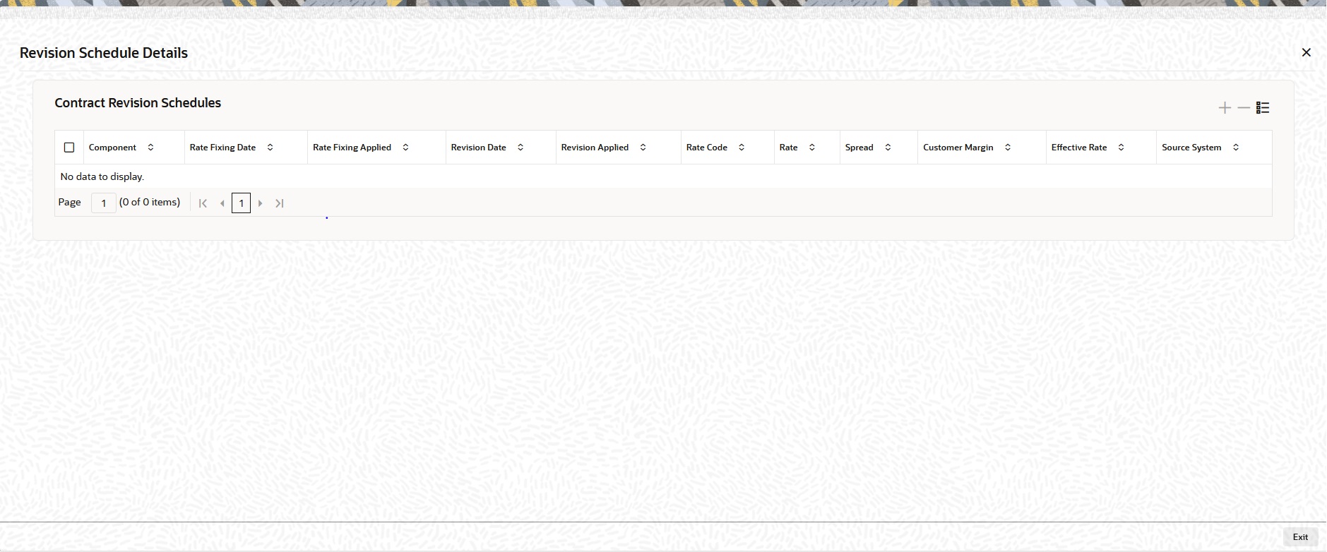

  4. On Money Market Contract Input screen, click Revision details.
    Revision Schedule Details screen is displayed.
    Figure 4-6 Revision Schedule Details
    Description of mmdtronl--cvs-rev-schedule-details.jpg follows
  5. View the details of the revision schedules for a particular deal.
    • Rate Fixing date
    • Rate fixing applied
    • Revision date
    • Revision Applied
    • Rate Code
    • Rate
    • Spread
    • Customer Margin
    • Effective rate
    • Source System
    Note that the system generates the SGEN only when the rate fixing applied option is Y for all the revision schedules.
