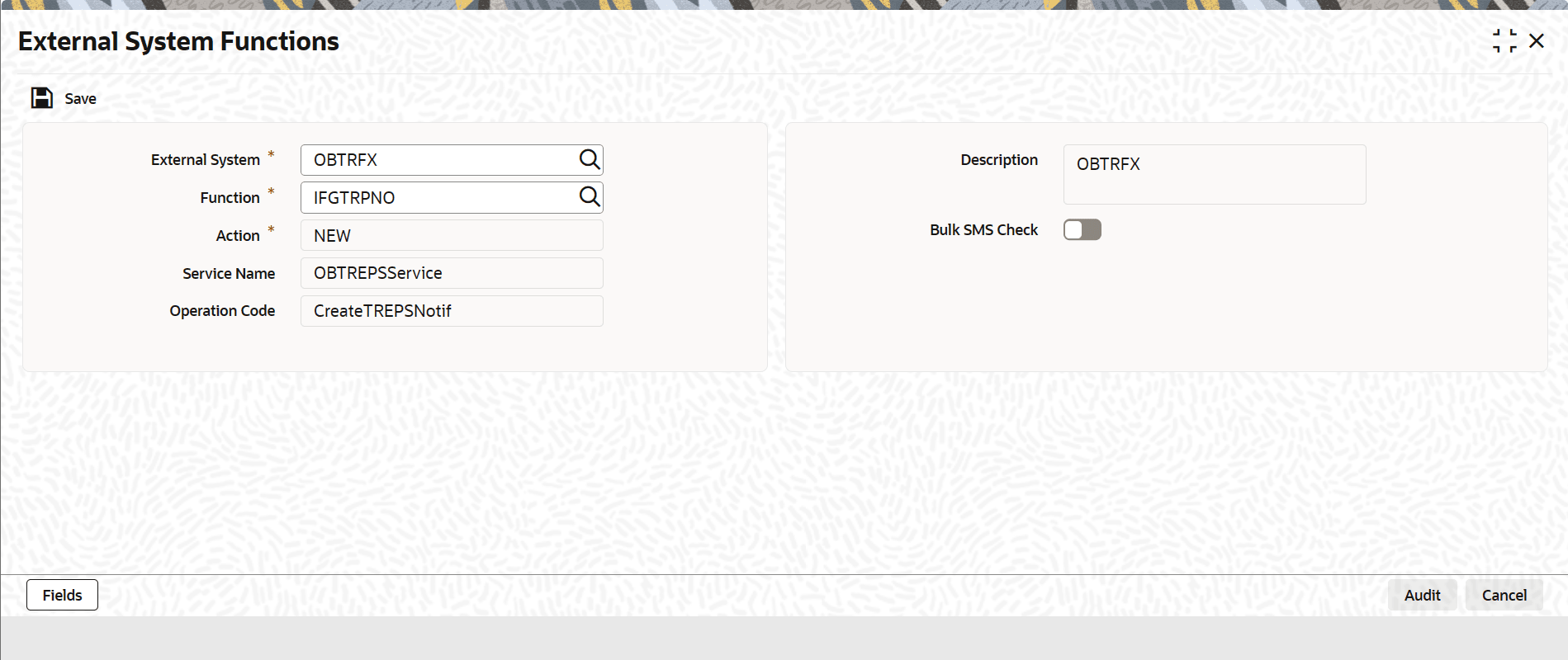

  1. On Home page, enter GWDETFUN in the text field and then click Next.
    The External System Functions screen displays.
    Figure 1-2 External System Functions
    Description of Figure 1-2 follows
    Description of "Figure 1-2 External System Functions"
  2. On the External System Functions screen, specify the fields.
    For more information on fields, refer to field description table.
    Table 1-5 Fields Specification
    Field Specification
    Source Code For all OBTR modules where outgoing payment or receive notice is initiated, the source code is “OBTR<Module-ID>”. For example, the source code for the FX module is “OBTRFX.”
    Service Name SOBTREPSService
    Operation Code CreateTREPSNotif
