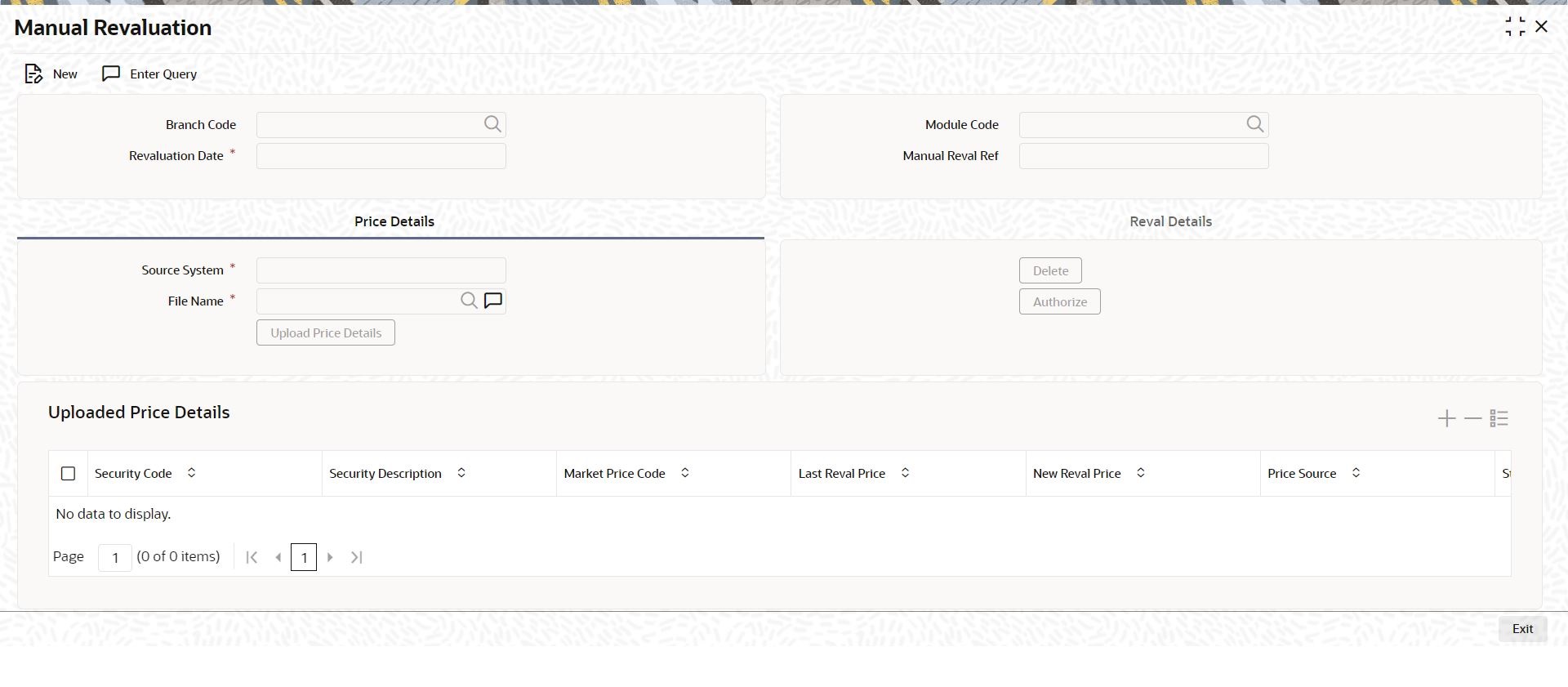

  2. On the Manual Revaluation screen, specify the details as required.
    Click a new icon from the toolbar. The screen is displayed with no value in the fields. To view details of records previously maintained, call on the Summary View screen. The details of all the records maintained is displayed in a tabular format. Highlight the record of your choice and double click it.
    For more information on these fields, refer to the below table.

  3. Click the Upload Price Details button. The system displays the details.
    If the back dated revaluation is not required, then you can delete a specific security price details record by clicking ‘Delete’ button. You can also select the multiple records at a time and delete it.
    If you are ready to update the new reval price to perform the back dated revaluation, then click on the Authorize button to authorize.

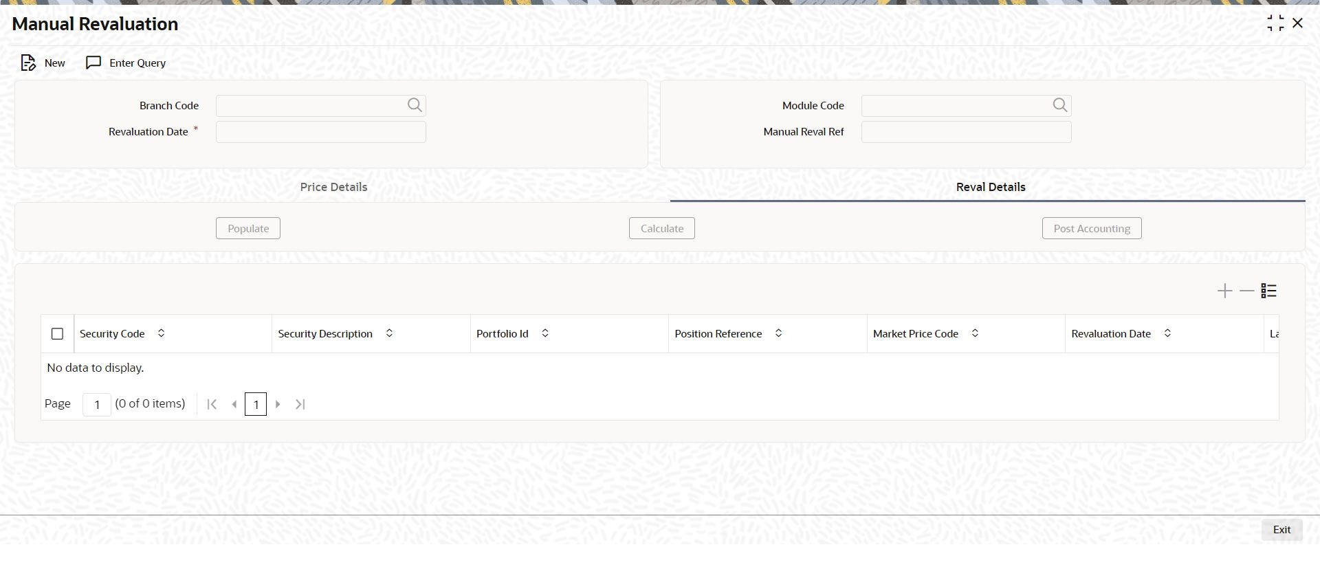

  4. On the Manual Revaluation screen, click Reval Details.
    Manual revaluation- Reval details is displayed.
    Figure 25-2 Manual revaluation- Reval details
    Description of sedxmrtu-reval-details-tab.jpg follows
  5. On the Reval Details tab, click the Populate button. The system displays the details required.
