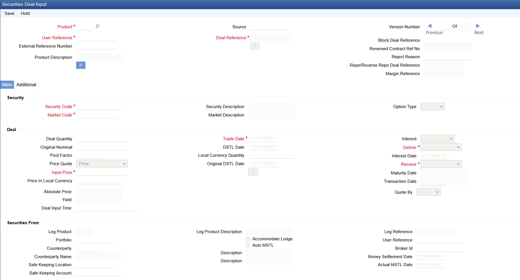

  1. On the Home page, specify SEDXDLNL in the text box, and click next arrow.
    Securities Deal Input screen is displayed.
    Figure 21-1 Securities Deal Input
    Description of Figure 21-1 follows
    Description of "Figure 21-1 Securities Deal Input"
    If you are calling a deal that has already been created, choose the Deal Input Summary option. The details of all the deals that you entered earlier will be displayed in a tabular form. From the summary screen, you can open an existing deal by double clicking it.
  2. On the Security Deal Input screen, specify the fields.
    The securities deal input screen, as it appears contains a header and a footer containing fields that are specific to the deal you are entering. Besides these, you will also notice two tabs and an array of icons, along the lines of which you can enter details of a securities deal.

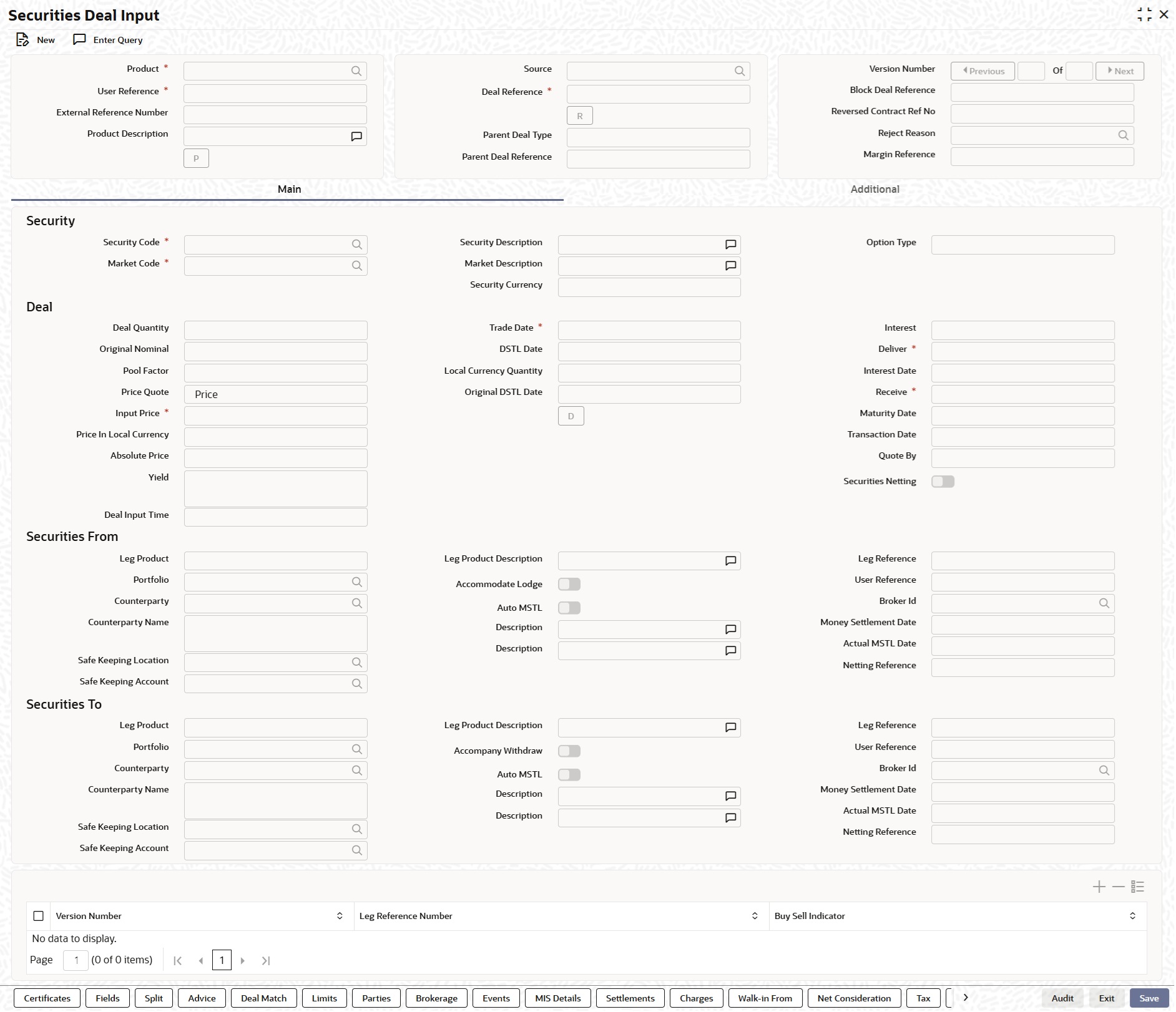

    Table 21-1 Field Description
    Field Description
    Main
    Click this tab to enter the essential terms of a deal. This screen, along with its fields have been detailed under the head ‘Entering the details of a deal’.
    Additional
    In the screen that corresponds to this tab, you can enter additional details that are required to process the deal. The screen also displays price-related details, calculated on the basis of the amounts that you specified in the Main screen. The features of this screen have been detailed under the head ‘Entering additional details of a deal’.
    On the Securities Deal Input screen, you will also notice a toolbar with icons. The same set of icons is available for each leg of a deal. The buttons on this toolbar enable you to invoke several functions that are vital to processing a deal. These buttons have been briefly described below:
    Advices
    Click this icon to invoke the advices screen. In the screen corresponding to this icon you can view, suppress and prioritize the advices that are to be generated for each leg of the deal. This screen along with its fields has been detailed under the head ‘Specifying Advices for a deal'.
    Brokerage
    Click this icon to indicate brokerage details applicable to the deal leg.
    Charges
    This button process the Charge service of Oracle Banking Treasury Management. On invoking this function you will be presented with a screen where the charge rate, amount, currency, and the waive charge parameter can be specified.
    The procedure for making charge components applicable to a deal leg is discussed under the head 'Levying charges on a deal'.
    Deal Match
    If you are trading in a portfolio that involves deal matching, you can indicate deal-matching preferences. Click this button to match earlier buys in a portfolio, to the deal you are processing.
    Events
    Click this icon to view details of the events and accounting entries that the deal involves. The screen also displays the overrides that were encountered for the deal.
    Limits
    Click this icon to view the forward profit that you have made or the loss that you have incurred on account of the deal.
    WalkIn
    In the screen that corresponds to this button, you can indicate the credit lines under which your liability to the deal should be tracked. The details of this screen are discussed under the head ‘Specifying credit administration details’.
    MIS Details
    Click this icon to define MIS details for the deal.
    Netcons
    Click this icon to view your net consideration in the deal.
    Parties
    In the screen that corresponds to this button, you can indicate the parties involved in the deal.
    Settlements
    Click this icon to invoke the settlement screens. Based on the details that you enter in the settlement screens, the deal will be settled. The details of these screens have been discussed in the section titled ‘Maintaining Settlement Instructions.
    Tax
    This screen process tax. The application of tax on a deal is discussed under the head 'Levying tax on a deal'.

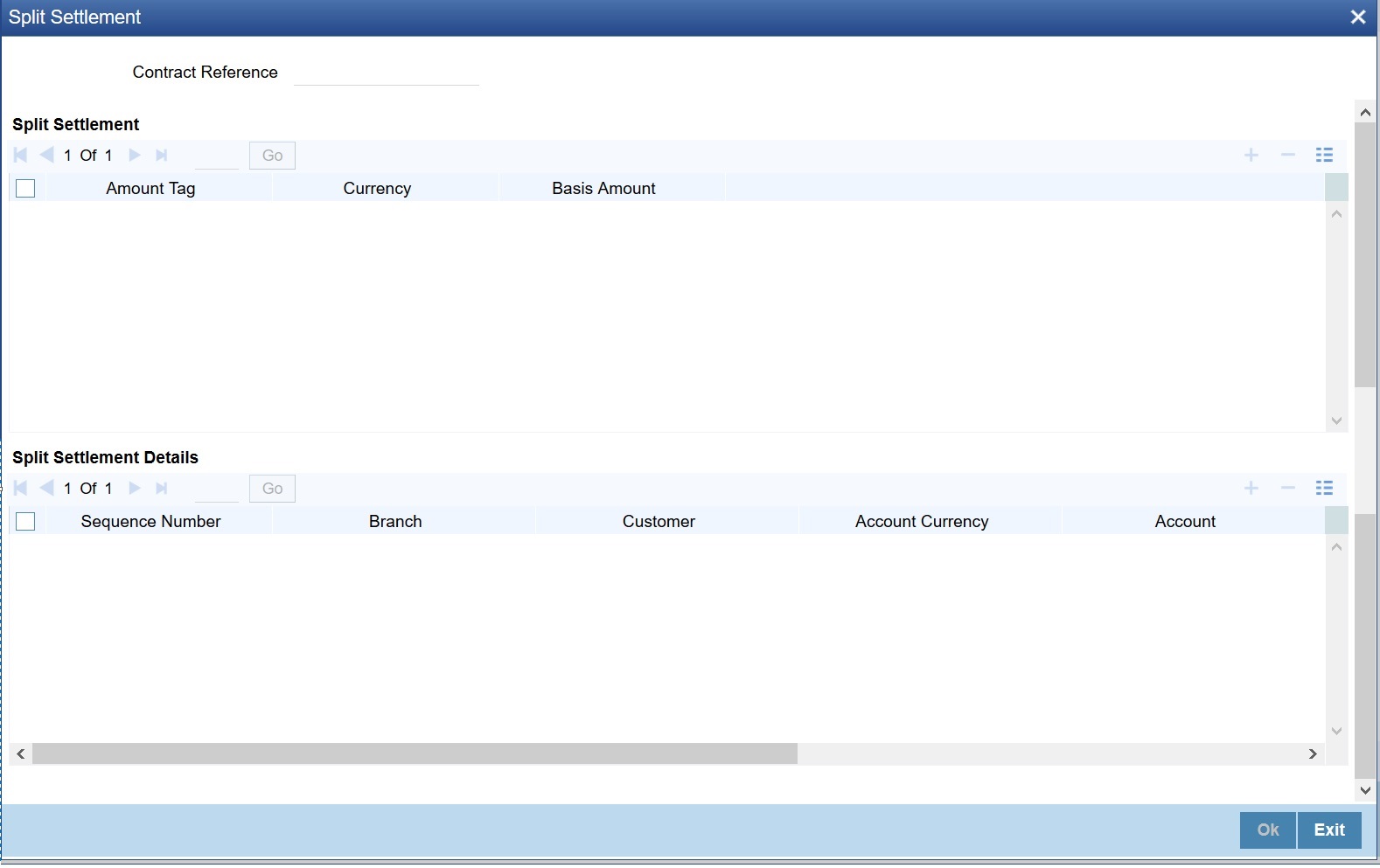

  4. On the Security Deal Input screen, click Split.
    Split Settlement screen is displayed.

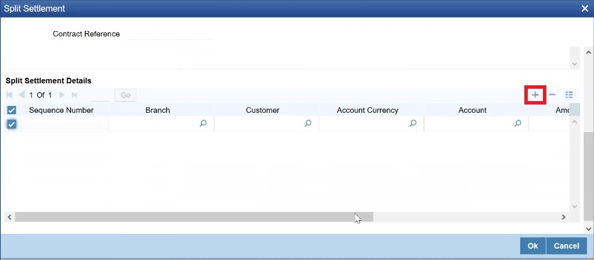

  5. On the Split Settlement screen, select a contract.
  6. On the Split Settlement screen, under the Split Settlement Details, click the + Icon.
    Split Settlement screen with New Row added is displayed.

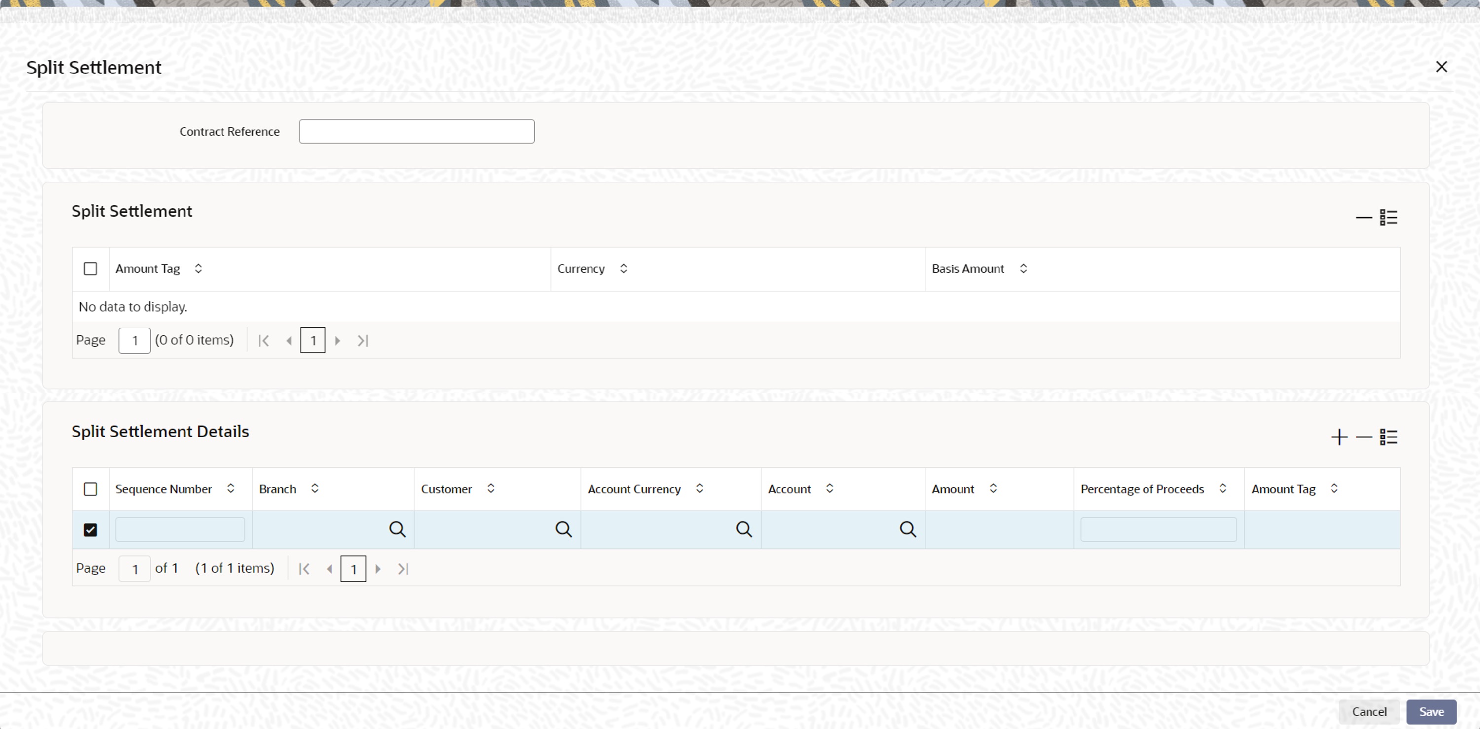

    This process of splitting the settlements for a contract is allowed on the principal, Interest (Anticipated Interest for new contracts), and charges.
  7. On the Split Settlement screen, Select the Account Currency, Account, and, other necessary details as required to create a split.
    • For every settlement contract the system allows a maximum of twelve splits.
    • In case of auto-liquidation, you must unlock the contract and register the split, upfront, that is prior to auto-liquidation. You can update the split settlement for interest component after you save and authorize. SGEN is generated for each split amount. System will suffix the reference number in field 72 of MT202 and MT202COV with a hyphen followed by a running sequence number for each SGEN.
    • Only if split settlement details are available, system will process the transaction accordingly, else the payment/settlement is treated as a single payment transaction
    • If you are splitting the contract during the rollover, the application considers the latest available split details and process the liquidation amount, if any. If split settlement details are not available, the transaction (partial (liquidation as part of rollover) is treated as normal/regular/non-split liquidation. The split is allowed in manual rollover as well.
    • For a single component, you can split the settlement amount and use the same settlement account more than once. There is no restriction on the repetition of split settlement amount for the same NOSTRO/settlement account.
    • Cross currency split settlement is supported. The Amount field/column in the Split tab is, by default, in the contract currency (though not evident in the User Interface). The currency of the settlement account can be in a different currency. The converted amount has to be viewed in the accounting entries as part of Events tab only.
    • Appropriate Amount tags, for each component like principal, interest and charges, are made available at the relevant event(s) for enriching the split settlement details.
