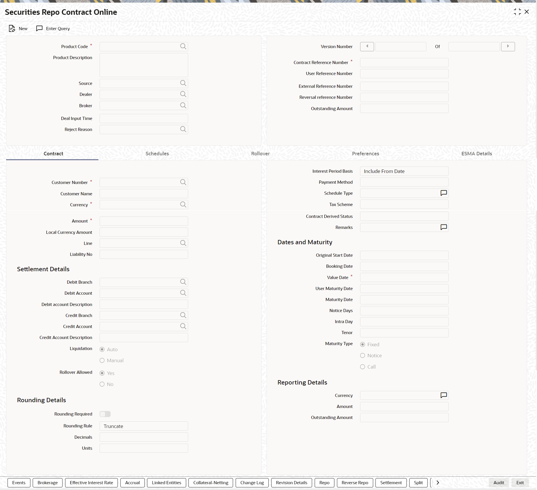

  1. On the Home page, specify SRDTRONL in the text box, and click next arrow.
    The Securities Repo Contract Online screen is displayed.
    Figure 2-16 Securities Repo Contract Online
    Description of Figure 2-16 follows
    Description of "Figure 2-16 Securities Repo Contract Online"
  2. On the Securities Repo Contract screen, specify the fields.
    The base number of the counterparty (customer)
    • The currency of the contract
    • The principal amount (for a deal with True Discounted interest, the user must enter the nominal).
    • Securities pledged detail for repo
    • Securities received detail for reverse repo
    • The credit line under which the reverse repo has to be tracked
    • The tenor related details for the deal
    • The code of the broker involved
    • The dealer involved
    • The default settlement account
    • The maturity details
    • The interest details
    • Whether the deal is rolled over
    The following details displayed cannot be changed:
    • Product type
    • Default tax scheme
    • Schedule payment method
    • Interest type Rollover count
    Table 2-19 Security Repo Contract - Field Description
    Field Description
    Product Code
    This is a mandatory field
    Click the search icon and select the Product code from the list of options displayed.
    Product Description
    The description of the selected product code is displayed.
    Source
    Indicate the source from which contracts have to be uploaded.If this value is left null, then the user will not be able to amend the contract. Amendment for the contract can be uploaded only through the same source as that used for creation.
    Dealer
    Select the Dealer involved in the deal from the list
    Broker
    Select the Broker involved in the deal from the list
    Deal Input Time
    This field captures the deal execution time at the time of deal booking received from front office.
    Format: YYYY-MM-DD HH:MM:SS:SSS (Default).
    Here SSS is milliseconds.
    Note: The above date format can be changed in the user setting option based on requirement.
    System throws an error when the user gives the wrong date or time format on modification.
    Reject Reason
    Specify the Reject reason Code for payment reversal message. The option list displays all valid code maintained in the system. Choose the appropriate one.
    Contract Reference Number
    The system automatically generates a Contract Reference Number for each deal. A running serial number, the date in Julian format, the product code, and the branch code are combined to book the deal.
    A three-digit branch code, a four-character product code, a five-digit Julian Date, and a four-digit serial number make up the Reference Number.
    The Julian Date has the following format:
    “YYDDD”
    Here, YY stands for the last two digits of the year. and DDD for the number of days (s) that has/have elapsed in the year.
    For example, 31 January 1998 translates into the Julian Date: 98031.
    On 5 February, the Julian format changes the number 1998 to 98036. This occurs when the number of days that have passed in January is added to the number of days that have passed in February. Therefore, 98036 is determined by the sum of the days in both months.
    In case of entity length changes Contract Reference number format will be changed to Product/Process Code (4 char) + Julian Date (5 char) + Sequence Number (7 digits).
    User Reference Number
    The user can enter any reference number for a deal that the user enter. The deal is identified through this number in addition to the Contract Reference Number generated by the system. No two deals can have the same User Reference Number. By default, the Contract Reference Number generated by the system is taken as the User Reference Number. The user can use this number, besides the deal Reference Number, to retrieve information relating to a deal.
    External reference Number
    If the transaction is being uploaded from an external source, the user can specify the identification for the transaction in the external source, as the external reference number. The user cannot amend this value post contact save.
    Reversed Reference Number
    The reference number of the contract that is being reversed and rebooked is displayed here. To enable amendment of SR Contract details Oracle Banking Treasury Management will reverse the old contract and rebook a new contract with the old user reference number and external reference number. The old contract is reversed and a new contract is booked with Reversed FCC ref as the parent contract.
    Outstanding Amount
    The system displays the total amount due as of the value date.
    Customer Number
    This is a mandatory field.
    Select the customer number from the list of values displayed.
    Customer Name
    The associated customer name from the selected customer number is displayed.
    Currency
    Select the currency from the list of values displayed.
    Amount
    Specify the Amount details as per requirement.
    If a product has bearing or discounted type of interest, the user must enter the principal of the deal in this screen. For a deal involving a true discounted product, the user must enter the face value (nominal) of the deal. The user can enter “T” or “M” to indicate thousands or millions, respectively. For example, 10T means 10,000 and 10M means 10 million. Amendment to this field is considered a financial amendment.
    Note: The amount, which the user enter, would be taken to be in the currency that the user specify as the deal currency.
    Local Currency Amount
    If the deal amount is in foreign currency, the system displays the equivalent local currency amount.
    Line
    By default, the user will view the Reverse Repo credit line defined for the customer. The user can change over to another authorized credit line if the user wants to track the Reverse repo under a different line.
    During upload, the credit lines for the given Counterparty, Product, Branch, Currency combination are fetched by the system. If there is only one credit line available, the system will display it here. If there are multiple lines found, the field is left blank.
    Interest Basis
    The method in which the number of days are to be calculated for interest, charge, commission or fee components and whether their application is tenor based is displayed here based on the specification the user made at the product level. The user can choose to change it. The following are the options available:
    • 30(Euro)/360
    • 30(US)/ 360
    • Actual/360
    • 30(Euro)/365
    • 30(US)/365
    • Actual/365
    • 30(Euro)/Actual
    • 30(US)/Actual
    • Actual/Actual
    • 30(Euro)/364
    • 30(US)/ 364
    • Actual/364
    The value of interest basis maintained here is used for calculating interest for repo contract.
    Payment Method
    The payment method defined for the main interest for the product (whether bearing, discounted or true discounted) applies to the contract as well. The method defined for the product is displayed here.
    • Bearing: Interest is liquidated on schedule payment date(s).
    • Discounted: In this interest payment method, the interest is deducted at the time of initiating the deal.
    • True discounted: In this interest payment method, the interest is calculated on the principal of the deal and not on the nominal. All the same, like the discounted method, here too, it is deducted from the principal at the time of initiation of the deal.
    Schedule Type
    If the user has defined repayment schedules for a product, which is applied to a deal involving the product, automatically. However, the user can change the schedule while processing a deal under the product.
    When a deal for which the repayment schedules a changed is rolled over, the new deal can have the repayment schedules defined for the product, or the schedules for the deal.
    Tax Scheme
    The tax scheme, which has been specified for the product, is displayed in this screen. The tax scheme cannot be changed at the time of deal processing.
    Contract Derived Status
    The status of placement is indicative of the status of repayments on it. If the user has specified automatic status movement for the placement, it is moved automatically to the status, as per your definition. However, if the user indicates the status change is made manually on the placement, the user can change the status manually in this screen. Even if the user has defined placement with automatic status movement, the user can still change the status manually before the automatic status change is due.
    There is another scenario, where the user has defined placement with automatic status moving forward, but manual status movement in the reverse direction. That is, when the conditions for placement being in a particular status no longer exist, if the user has specified manual reverse movement, then the user has to move the placement to the appropriate status manually.
    A placement on which the latest repayment has been made is in the Active status. If a payment is outstanding on a placement, its status is changed, based on your requirements of reporting placements with outstanding payments. The different status codes applicable for placement are defined for a product, and it applies to the placement, by default. However, the user can change the status of the contract through this screen.
    When the user captures the placement details, the system allows the status Active by default. The user may change it to any of the status codes as per your requirement. While doing manual status change, ensure the status order as defined. For example, the status codes are defined as follows, in that order:
    • Active
    • Past Due
    • Non-accrual
    • Write-off
    The user cannot change the status of placement from Active to Non-accrual, bypassing Past Due. If the requirement is that the placement has to be put in the Non-accrual status from the Active status, the user must first change the status to Past Due, store and authorize this status change and then change it to the Non-accrual status. If a status change is defined with a change in the GL, the entries are passed for the GL movement.
    Remarks
    The user can enter information describing the deal that the user is processing. This is available when the user retrieve information on the deal. However, this information will not be printed on any advice printed for the customer's benefit. This information is displayed whenever the user retrieve information on the deal either as a display or in print.
    Settlement Details Specify the Settlement Details.
    Debit Branch
    When selecting the settlement details of a deal, the user must specify the debit account Branch.
    Debit Account
    Specify the account to be debited for the money market deal.
    Debit Account Description
    The system displays the description of the specified debit account number based on the details maintained at 'Customer Account Maintenance' level.
    Credit Branch
    When selecting the settlement details of a deal, the user must specify the credit account branch.
    Credit Account
    Specify the account to be credited for the money market deal.
    Credit Account Description
    The system displays the description of the specified credit account number based on the details maintained at 'Customer Account Maintenance' level.
    Liquidation
    When setting up a product, the user specify the mode of liquidation, whether automatic or manual, for the different components of a deal. By default, all deals involving the product will inherit this definition. However, the user can change the mode of liquidation, from automatic to manual, or vice versa, while processing a deal.
    Select the type of the Liquidation required.
    The options are:
    • Auto
    • Manual
    Rollover Allowed
    Select the option if the Rollover is required or not.
    While setting up a product, if the user specify the deals involving the product are automatically rolled over, all deals involving the product are rolled over on their respective Maturity Dates, if they are not liquidated. This feature is called auto rollover. If the auto rollover is specified for the product, the deal involves, it is indicated on this screen. However, if the user does not want the deal (whose details are being captured) to be rolled over, the user can disallow rollover for the deal. If rollover has been disallowed for a product, the user cannot rollover deals involving the product.
    Note: For rollover to be applicable for the deal, it has to be defined for the product.
    Original Start Date
    For a deal that has been rolled over, this is the date on which the deal was originally initiated. If a deal has been rolled over more than once, this is the date on which the first deal was initiated.
    If the users enter a deal that has already been initiated, the user must enter the date on which the deal began. In this case, the date is for information purposes only and for all accounting purposes the Value Date is considered as the date on which the deal was initiated.
    Booking Date
    The date on which the deal details are entered would be displayed in this screen. This defaults to the system date (today’s date). This date is for information purposes only. The accounting entries are passed as of the Value Date of the deal (initiation date of the deal). Amendment to this field is considered a financial amendment
    Value Date
    This is the date on which a deal takes effect. The accounting entries for the initiation of the deal is passed as of this date. The tenor of the deal will begin from this date, and all calculations for interest and all the other components based on tenor is made from this date onwards.
    The system defaults to today’s date. The user can enter a Value Date of your choice here. The date that the user enter is any one of the following:
    • Today’s date
    • A date in the past
    • A date in the future (the user can enter a date in the future only if Future Dating has been allowed for the product).
    The Value Date must not be earlier than the Start Date or later than the End Date defined for the product involved in the deal. In case of a child rolled over the contract, this value is the same as the maturity date of the parent contract.
    If the liquidation date for any component falls before today’s date, the liquidation entries (as defined by the user for the product) is passed if the user has specified for the product. If the Maturity Date of a deal is earlier than today, maturity entries are passed.
    Once the deal details have been stored and authorized, this date is amended, if the deposit has a bearing type of interest and NO schedule has been liquidated. Modification to this field is considered as a financial amendment.
    An override is sought if the Value Date falls on a holiday, in the country of the deal currency.
    User Maturity Date
    Change the maturity date of the deal here, based on the requirement.
    Maturity Date
    If the Maturity Type is fixed (that is, the Maturity Date of the deal is known when the deal is initiated) specify the Maturity Date. This date must be later than the Start Date of the product. If the product has a Default Tenor, this date is defaulted based on the tenor and the From date of the contract. If the user change this date, an override must be provided while saving the deal.
    For a deal with Call or Notice type of maturity, the Maturity Date is not entered at the time of deal booking. The user can get this date updated through value dated amendment. This date must be later than the Start Date of the product.
    If the product has a Default Tenor, this date is defaulted based on the tenor and the From date of the contract. If the user has specified auto liquidation for the deal, liquidation is done automatically on that date. If manual liquidation has been specified, the user will have to liquidate the deal through the Manual Liquidation function manually.
    For a deal with Fixed Maturity Type, this date can either be extended or brought backwards through the Value Dated Changes function, once the deal has been initiated.
    Notice Days
    For a contract maturing at notice, the user must enter the notice period (in days). This is for information purposes only. When the notice to repay is issued to the counterparty, the user must indicate the Maturity Date of the deal using value dated amendment screen.
    Intra Day
    For Intra-day deals, the system populates the intra-day deal date in this field. The intra-day deal date is populated as value date +1. Only the user can enter intra-day deals using a product meant for intra-day deals (as set in the Product Preferences).
    Tenor
    If the product has a Default Tenor, this tenor is defaulted based on the tenor. On overriding this maturity date will get adjusted.
    Maturity Type
    Select the Maturity type from the options as required.
    The Options available are:
    • Fixed
    • Notice
    • Call
    Rounding Details Specify the Rounding Details fields.
    Rounding Required
    Select the checkbox if the Rounding process is required
    Rounding Rule
    Select the Rounding Rule from the drop-down box.
    Decimals
    Specify the decimal point to be rounded.
    Units
    Specify the Units to be rounded.
    Reporting Details Specify the Reporting Details fields.
    Currency
    Select the reporting currency from the option list.
    Amount
    The system displays the amount.
    Outstanding Amount

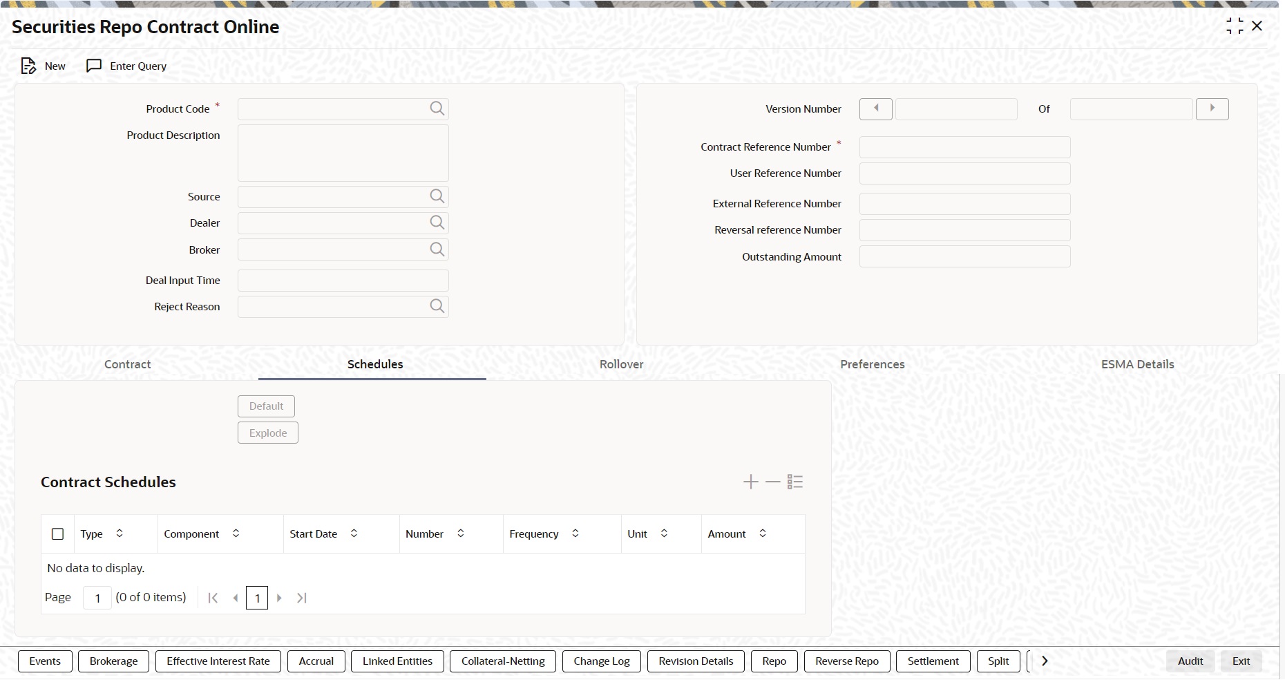

  3. On Security Repo Contract Online screen, click Schedules.
    The contract inherits the schedule details from the associated product where the changes are allowed at the contract level.
    The Security Repo Contract Online- Schedules Tab details is displayed.
    Figure 2-17 Security Repo Contract Online - Schedules
    Description of Figure 2-17 follows
    Description of "Figure 2-17 Security Repo Contract Online - Schedules"

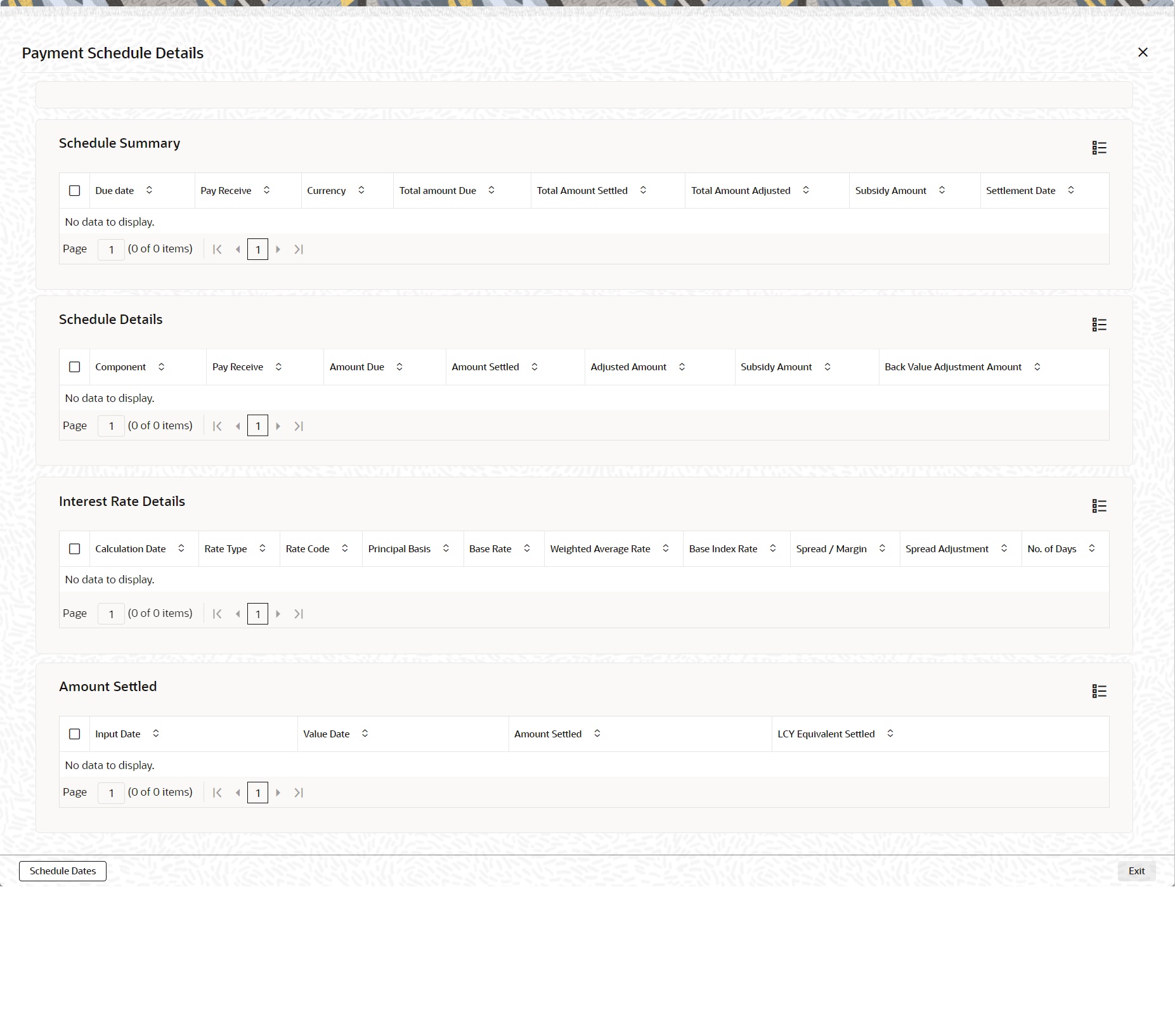

  4. On the Security Repo Contract Online - Schedules Tab screen, click Explode.
    The Payment Schedule Details screen is displayed.
    Description of srdtronl--payment-schedule.png follows
  5. On the Payment Schedule Details screen, refer to the provided payment schedule break-up.
    The following details are available:
    Table 2-20 Schedule Breakup- Field Description
    Field Description
    Schedule Summary
    • Due Date after applying payment delay
    • Pay Receive
    • Currency
    • Total Amount Due
    • Total Amount Settled
    • Total Amount Adjusted
    • Subsidy
    • Amount
    Schedule Details
    • Component
    • Pay Receive
    • Amount Due
    • Amount Settled
    • Adjusted Amount
    • Subsidy Amount
    • Back Value Adjusted Amount
    Interest Rate Details
    • Calculation Date
    • Rate Type
    • Rate Code
    • Principal Basis
    • Base Rate
    • Base Index Rate
    • Spread/Margin
    • Spread Adjustment
    • No. of Days
    • Compound Interest
    • Simple Interest
    • Total Interest
    • Cumulative Interest
    • Rate Pickup Date
    Amount Settled
    • Input Date
    • Value Date
    • Amount Settled
    • LCY Equivalent Settled
  6. On the Security Repo Contract Online - Schedules Tab screen, specify the details as required.
    For information on fields, see the table below:
    Table 2-21 Schedules Tab- Field Description
    Field Description
    Contract Schedules Specify the Contract Schedules details.
    Type
    Specify the Type of schedule maintained for the contract.
    Component
    Specify the Component for which schedule is build.
    Start Date
    Specify the start date of the schedule.
    Number
    Specify the number of schedule for each component.
    Frequency
    Select the schedule frequency from drop down value
    • Bullet
    • Daily
    • weekly
    • Monthly
    • half yearly
    • Quarterly
    • Yearly
    Unit
    Specify the Units for each frequency
    Amount
    System defaults the component amount for each schedule
    Contract Linkages Specify the Contract Linkages details.
    Type
    Specify the Contract linkage type
    Linked To Account
    Specify the linked account
    Currency
    System defaults the currency linked to the account
    Available Amount
    System defaults the available balance of the linked account
    Exchange Rate
    System defaults the currency exchange rate
    Linked Amount
    Specify the linked amount.

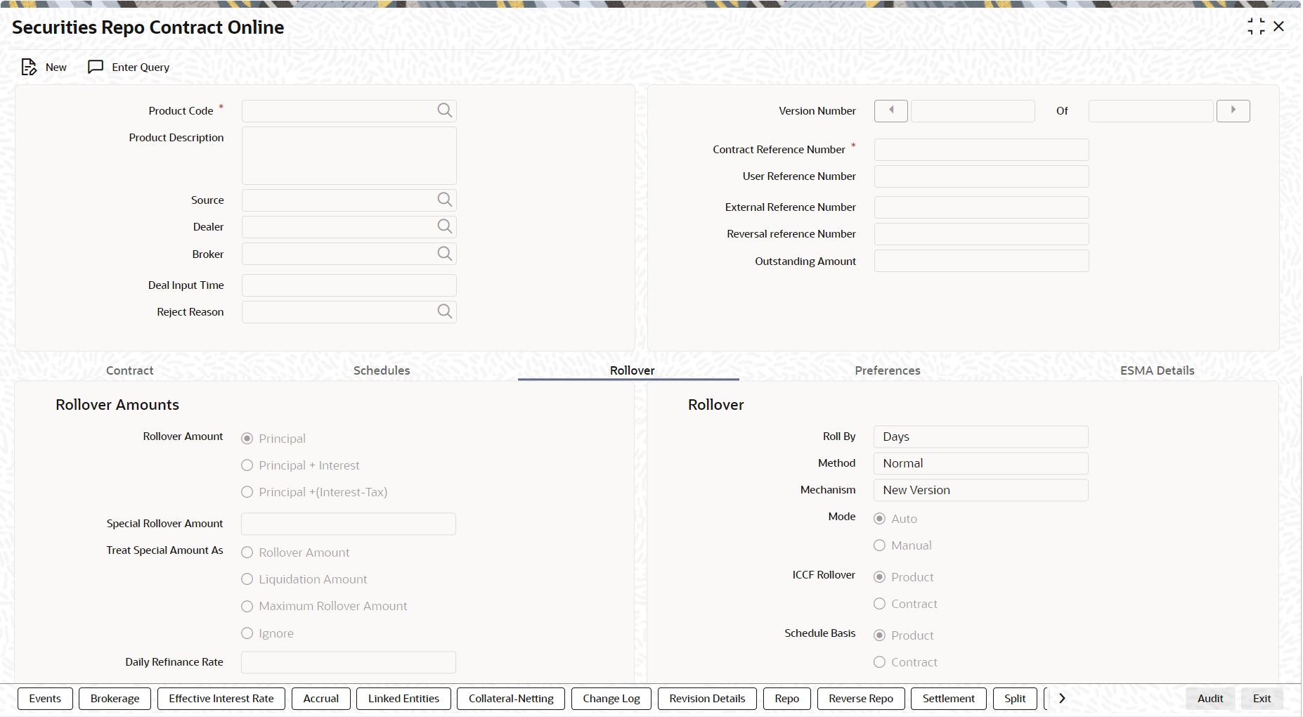

  7. On the Security Repo Contract Online screen, click Rollover.
    The Security Repo Contract Online- Rollover Tab details is displayed.
    Figure 2-18 Security Repo Contract Online- Rollover
    Description of Figure 2-18 follows
    Description of "Figure 2-18 Security Repo Contract Online- Rollover"
  8. On the Security Repo Contract Online - Rollover Tab screen, specify the details as required.
    For more information on Rollover process, refer to the below table.
    For information on fields, see the below table:
    Table 2-22 Security Repo Contract Online - Rollover Tab - Field Description
    Field Description
    Rollover Amount
    Specify the option for the Rollover Amount from the drop down list as required. The options are:
    • Principal
    • Principal + Interest
    • Principal + (Interest - tax)
    Special Rollover Amount
    Specify the special amount if applicable
    Treat Special Amount As
    If the Special amount is specified, from the following options specify the what must it be treated as:
    • Rollover Amount
    • Liquidation Amount
    • Maximum Rollover Amount
    • Ignore

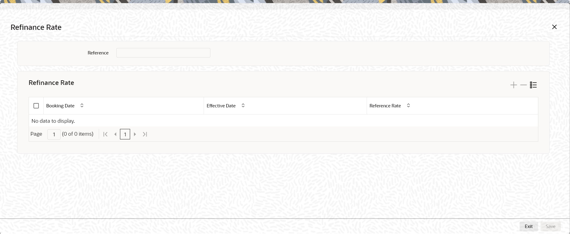

    Daily Refinance Rate
    Specify the refinance rate as per the requirement.
    Rollover Specify the Rollover details.
    Roll By
    Select the option from the drop-down list.
    The options available are:
    • Days
    • Months
    • Quarters
    • Semiannual
    • Years
    Method
    Select the Method from the drop-down list.
    • Normal
    • Split
    • Consolidated
    Mechanism
    Select the Mechanism from the drop-down list.
    • New Version
    • Spawn Contract
    • Linked Contract
    Mode
    Select the Mode as required.
    The options are:
    • Auto
    • Manual
    ICCF Rollover
    Select the ICCF Rollover details as required:
    The options are:
    • Product
    • Contract
    Schedule Basis
    Select the Schedule Basis details as required.
    The options are:
    • Product
    • Contract
    Preferences Specify the Preferences details.
    Apply charge on Rollover Amount
    Select this Check box if charge is applied on Rollover
    New Components Allowed
    Select this Check box if new component is allowed for the rolled over contract
    Liquidate Overdue Schedules
    Select this Check box to liquidate over due schedules on rollover
    Apply Tax on Rollover Amount
    The user must indicate if the tax must be applied on the rolled over deal.
    Update Limits Utilization
    Whether the credit limit utilization is to be updated when a reverse repo deal is rolled over, that is, the interest that has been accrued on reverse repo is also considered as a part of the ‘utilized amount’ for the purpose of risk tracking. This option applies only if the user wants to roll over a deal with interest.
    Maturity Specify the Maturity details.
    Maturity Days
    Specify the new maturity days for rolled over contract.
    Maturity Date
    Specify the new Maturity date for the rolled over contract.
    Maturity Type
    Select the Maturity Type as required.
    • Fixed
    • Notice
    • Call
    Interest Basis Specify the Interest Basis details.
    Component
    System defaults the component which is to be rolled over.
    Basis
    Select the option from the drop-down list as required.
    • Product
    • Contract
    • User Rate
    Rate Type
    Select the rate type from the drop-down list.
    • Fixed
    • Floating
    Code Usage
    Select the Code Usage from the drop-down list.
    • Auto
    • Periodic
    Interest Basis
    Select the Interest Basis from the drop-down list.
    • 30-Euro/360
    • 30(US)/360
    • Actual/360
    • 30(Euro)/365
    • 30(US)/365
    • Actual/365
    • 30-Euro/Actual
    • 30(US)/Actual
    • Actual
    Rate Code
    Specify the new rate code for rolled over contract when the basis is user
    Spread
    Specify the new spread for the rolled over contract when the basis is user
    Margin
    Specify the new margin for the rolled over contract when the basis is user
    Amount
    Specify the new Interest amount for the rolled over contract when the BASIS is user.
    Tenor
    Specify the new tenor for the rolled over contract

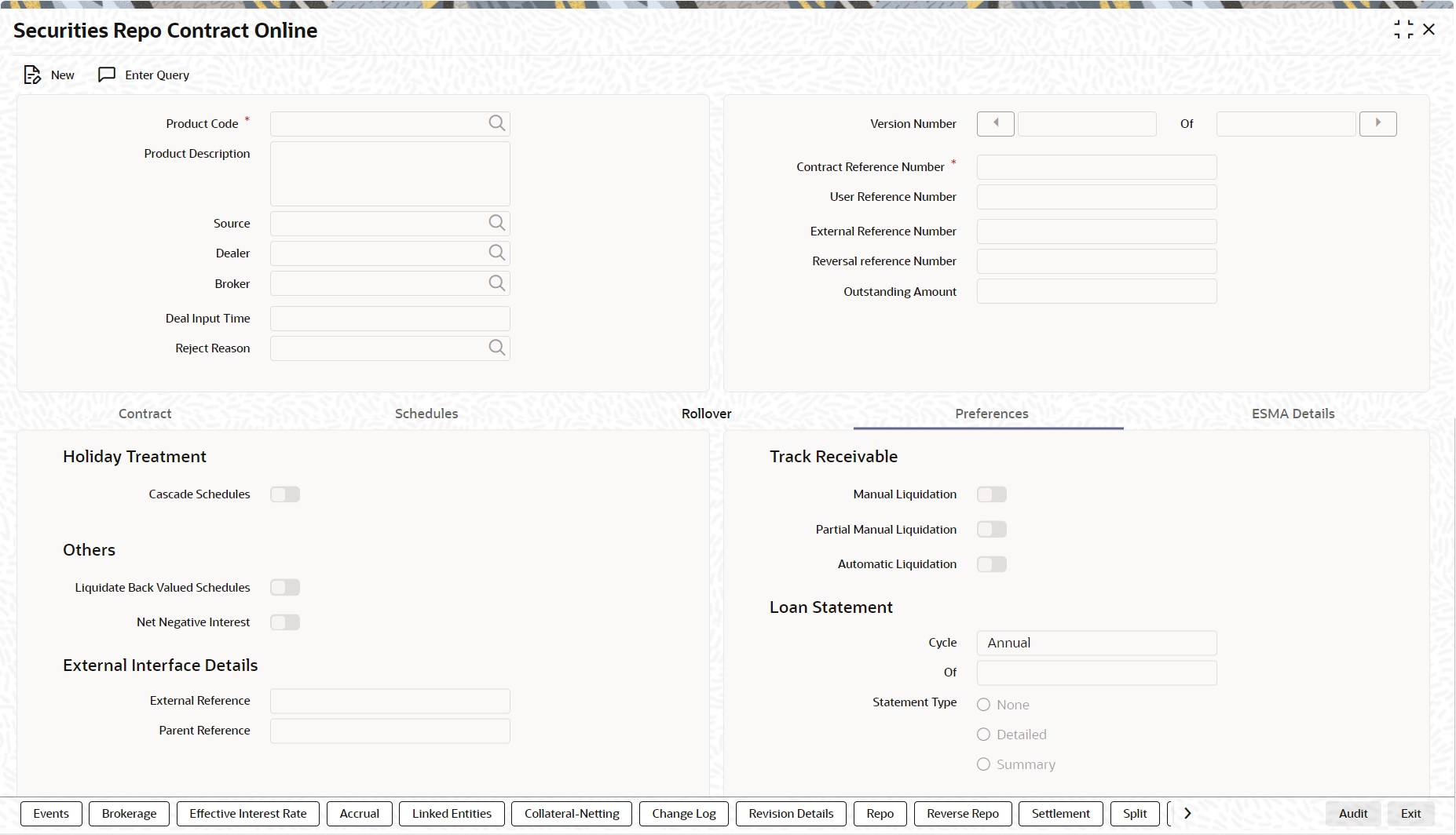

  9. On Security Repo Contract Online screen, click Preferences.
    Preferences are options. For instance, for a product, the users have the option of:
    • Making liquidation automatic or manual
    • Allowing or disallowing rollover
    • Applying tax or waiving it
    • Applying prepayment penalty or waiving it etc
    • Generation of Deliver verse Payment message
    • Generation of Receive verse payment message
    • Giving Cash margin details
    The Security Repo Contract Online - Preference tab details is displayed.
    Figure 2-19 Security Repo Contract Online - Preference
    Description of Figure 2-19 follows
    Description of "Figure 2-19 Security Repo Contract Online - Preference"
  10. On the Preferences tab, specify the details as required.
    Table 2-23 Securities Repo Contract Online - Preference Tab - Field Description
    Field Description

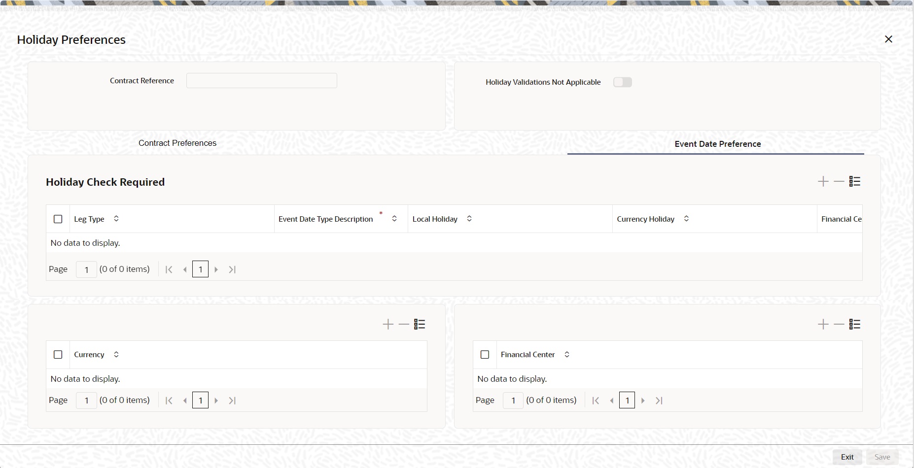

    Holiday Treatment
    Specify the Holiday Treatment details.
    Cascading schedules
    Select this check box, if one schedule is moved backwards or forward because of a holiday, the other schedules are accordingly shifted. If the user does not want to cascade schedules, then, only the schedule, which falls on a holiday, is shifted as specified and the others will remain as they were.
    Move Across Months
    Select this check box, if the user needs to move a schedule falling due on holiday either forward or backwards to the next or previous working day and it crosses over into a different month, then the system moves the scheduled date. If not, scheduled date is kept in the same month, on the last or first working day of the month, depending on whether the schedule is over the month-end or the beginning of the month.
    Move Payment Schedule
    Select this box, if user needs to move the payment schedule. When the system computes the repayment date, there is a chance that one or more schedules fall due on holiday.
    Move Revision Schedules
    Select this box, if user needs to move the Revision schedule falling on a holiday
    Move Forward
    Check against this field to indicate that the schedule of the contract must be moving forward to the next working day.
    Move Backward
    Check against this field to indicate that the scheduled date of the contract is moved back to the previous working day.
    Others Specify the Others details.
    Liquidate Back Valued Schedules
    Select this checkbox to define the product, that a back-dated deal with repayment schedules before today's date, the schedules are liquidated when the deal is initiated, the same will apply to the deal the user is entering. However, through this, the user can choose not to liquidate back valued schedules.
    Net Negative Interest
    Check this box to indicate that the system should internally net the positive and negative amounts being paid to the customer during interest liquidation.
    Track Receivable Specify the track receivable fields.
    Manual Liquidation
    Select this option to track receivables during manual liquidation. In case of manual payments, the system will display an override if sufficient funds are not available in the settlement account. If the user say Yes to the override, the system will mark the fund as a receivable amount.
    Partial Manual Liquidation
    During manual liquidation, if sufficient funds are not available in the settlement account of the contract, the user can opt to make a partial payment. In this case, the deal is liquidated to the extent of the amount available in the account. The balance due is tracked as a receivable amount. During EOD processing of the contracts, based on the availability of funds, the deal is liquidated. This process will continue until the deal is recovered fully. The deal is in the active status till full liquidation happens. If the user does not choose to make a partial payment, then the entire amount that is being manually paid are tracked as a receivable against the settlement account.
    Automatic Liquidation
    Select this option if the user want to track receivables during automatic liquidation.
    Loan Statement
    Specify the Loan statement details.
    Cycle
    Specify the cycle on which loan statement must be generated
    Statement Type
    • None
    • Detailed
    • Summary
    External Interface Details Specify the External interface details.
    External Reference
    System updates the external reference number
    Parent Reference
    System updates the parent reference number
    REPO Specify the Repo details.
    Delivery Verse Payment
    Select this checkbox to Generate MT543/MT541 message on Repo Booking and liquidation.
    Reverse Repo Speify the Reverse Repo details.
    Receive Verse Payment
    Select this checkbox to Generate MT541/MT543 message on Repo Booking and liquidation.
    Settlement Message Generation Details Specify the Settlement Message Generation Details.
    Settlement Message Generation Required
    Select this checkbox, to settle message generation required.
    Demand Basis
    The options are:
    • SGEN
    • Billing Notice
    Cash Margin Specify the cash margin details.
    Margin Account
    Specify the value from the list of values displayed. The Options available are GL or CASA account for cash margin transaction.
    Note: This is a Mandatory field if collateral revaluation preference is margin settlement at SR Product.
    Account Currency
    Specify the Currency of the account maintained.
    This is a Mandatory field if margin account is chosen
    Account Branch
    Specify the branch of the account maintained.

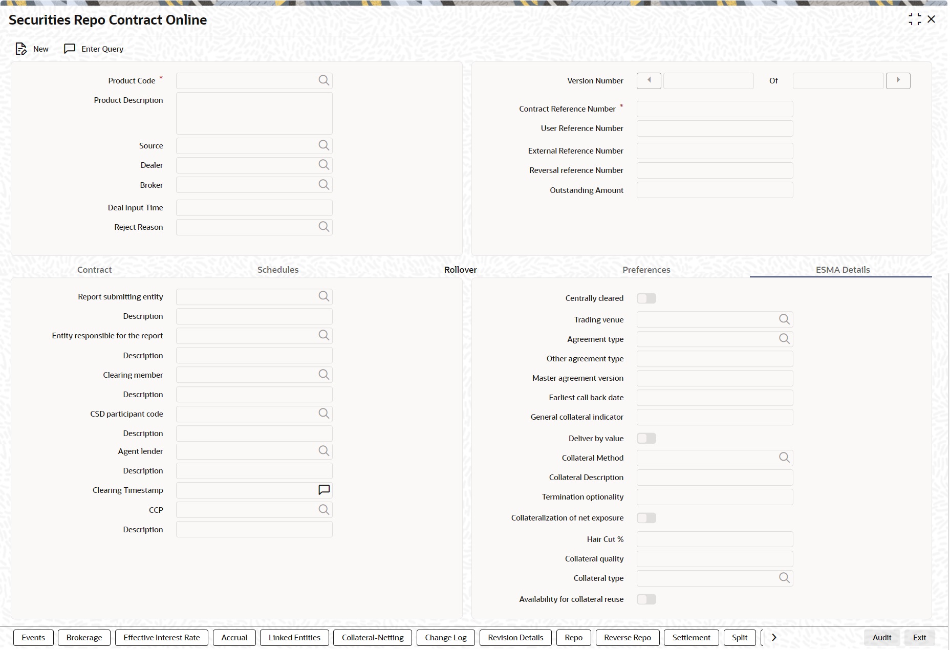

  11. On the Security Repo Contract Online screen, click the ESMA Details tab.
    The Security Repo Contract Online - ESMA Details page is displayed.
    Figure 2-20 Security Repo Contract Online - ESMA Details
    Description of Figure 2-20 follows
    Description of "Figure 2-20 Security Repo Contract Online - ESMA Details"
  12. On the Securities Repo Contract Online screen, click the ESMA Details tab and specify the ESMA details as required.
    For more information on fields, refer to the below table.
    Table 2-24 Securities Repo Contract Online - ESMA Details Tab - Field Description
    Field Description
    Report submitting entity
    Specify the unique code from the displayed list of values for identifying the reporting counterparty.
    Description
    The system displays the description of the selected report submitting entity.
    Entity responsible for the report
    Specify the unique code from the displayed list of values for identifying the financial counterparty responsible for reporting on behalf of the other counterparty.
    Description
    The system displays the description of the selected entity responsible for the report
    Clearing member
    Specify the unique code from the displayed list for identifying the responsible clearing member of the reporting counterparty.
    Description
    The system displays the description of the selected clearing member.
    CSD participant code
    Specify the unique code of the CSD participant or indirect participant of the reporting counterparty from the displayed list, where both the CSD participant and indirect participant are involved in the transaction.
    Note: This CSD Participant Code field is not applicable to commodities.
    Description
    The system displays the description of the selected CSD participant.
    Agent lender
    Specify the unique code of the agent lender involved in the securities lending transaction.
    Description
    The system displays the description of the selected agent lender .
    Clearing timestamp
    Specify the time and date when clearing took place, where the contract is cleared.
    CCP
    Specify the unique code of central clearing counterparty (CCP) that cleared the contract.
    Description
    The system displays the description of the selected CCP.
    Centrally cleared
    Select the Centrally cleared check box to clear the trade centrally.
    Trading venue
    Specify the unique code for identifying the venue of execution of the SFT. Where the SFT was concluded over the counter (OTC) and the respective collateral is admitted to trading, MIC code ‘XOFF’ is used.
    Agreement type
    Specify the unique code for identifying the master Agreement type under which the counterparties concluded a documented SFT.
    Other agreement type
    Enter the name of the master agreement in this field.
    Note: This field is applicable, if OTHR is selected in Agreement type field.
    Master agreement version
    The user must enter year of the master agreement version used for the reported trade.
    Earliest call back date
    Specify the Earliest call back date that the cash lender has the right to call back a portion of the funds or to terminate the transaction.
    General collateral indicator
    Select the SFT associated to a general collateral arrangement from the drop-down list.
    The drop-down list shows the following options:
    • SPEC – Specific Collateral
    • GENE – General Collateral
    Deliver by value
    Select the Deliver by value to settle the transaction by using DBV mechanism.
    Collateral method
    Specify the unique code from the list of values for identifying whether the collateral in the SFT is subject to a title transfer collateral arrangement, a security financial collateral arrangement, or a security financial collateral arrangement with the right of use.
    Description
    The description of the selected collateral transfer method is specified.
    Termination optionality
    Select the Termination optionality from the drop-down list. The drop-down list shows the following options:
    • Evergreen
    • Extendable
    Indicates whether the counterparties to the SFT is extendable or evergreen.
    Collateralization of net exposure
    Select the Collateralization of net exposure check box for net exposure.
    Indicates whether the collateral has been provided for a net exposure, rather than for a single transaction.
    Haircut
    Specify the collateral haircut value in percentage.
    Collateral haircut, a risk control measure applied to the underlying collateral at ISIN level, whereby the value of that underlying collateral is calculated as the market value of the assets reduced by a certain percentage.
    Collateral quality
    Select the collateral quality from the drop-down list.
    • Investment Grade
    • Non Investment Grade
    • Non-Rated
    Indicates the risk of security classification as a collateral.
    Collateral type
    Specify the unique code from the displayed list for identifying the type of collateral.
    Availability for collateral reuse
    Select the Availability for collateral reuse check box to reuse the securities.
    Indicates whether the collateral taker can reuse the securities provided as a collateral.

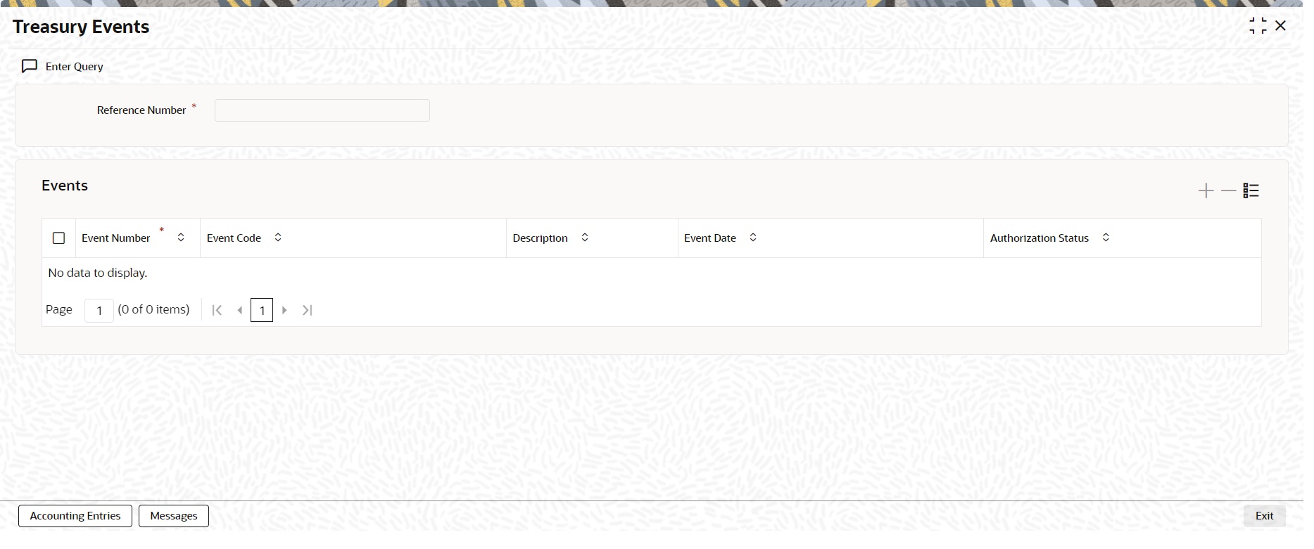

  1. On the Security Repo Contract Online screen, click Events
    The Treasury Events screen is displayed.
    Figure 2-21 Treasury Events
    Events
  2. On the Treasury Events screen, specify the details as required.
    Table 2-25 Treasury Events - Field Description
    Field Description
    Reference Number
    Payment reference number automatically gets defaulted for the current payment.
    Events Specify the events details.
    Event Number
    This is a Mandatory field.
    Event Code
    Displays the contract event code
    Description
    Displays the Event description
    Event Date
    Displays the Date on which event is generated
    Authorization Status
    Displays the event authorization status
    Maker Id
    Displays the maker ID
    Checker Id
    Display the Checker ID

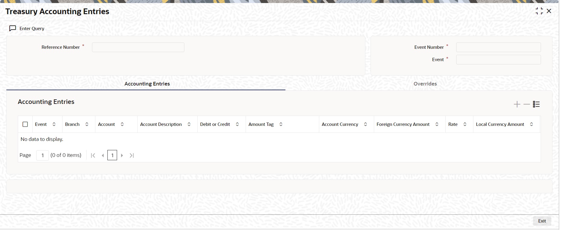

  3. On the Treasury Events screen, click Accounting Entries.
    The Treasury Accounting Entries screen is displayed.
    Figure 2-22 Treasury Accounting Entries
    Accounting entries
  4. On the Treasury Accounting Entries screen, specify the details as required.
    Table 2-26 Treasury Accounting Entries- Field Description
    Field Description
    Reference Number
    Specify the contract reference number.
    Event Number
    Specify the event number.
    Event
    Specify the event code.
    Accounting Entries Specify the accounting entries details.
    Event
    Displays the Event code for the contract
    Branch
    Displays the Account branch
    Account
    Displays the Account number
    Account Description
    Displays the Account Description
    Debit or Credit
    Displays whether the account is Dr or Cr
    Amount Tag
    Displays the amount tag associated to the event
    Account Currency
    Displays the account currency
    Foreign Currency Amount
    Displays the Foreign currency amount
    Rate
    Displays the exchange rate
    Displays the Local currency equivalent amount when the contract currency is in FCY currency
    Date
    Displays the Transaction date
    Value Date
    Displays the value date of the event
    Txn Code
    Displays the transaction Code

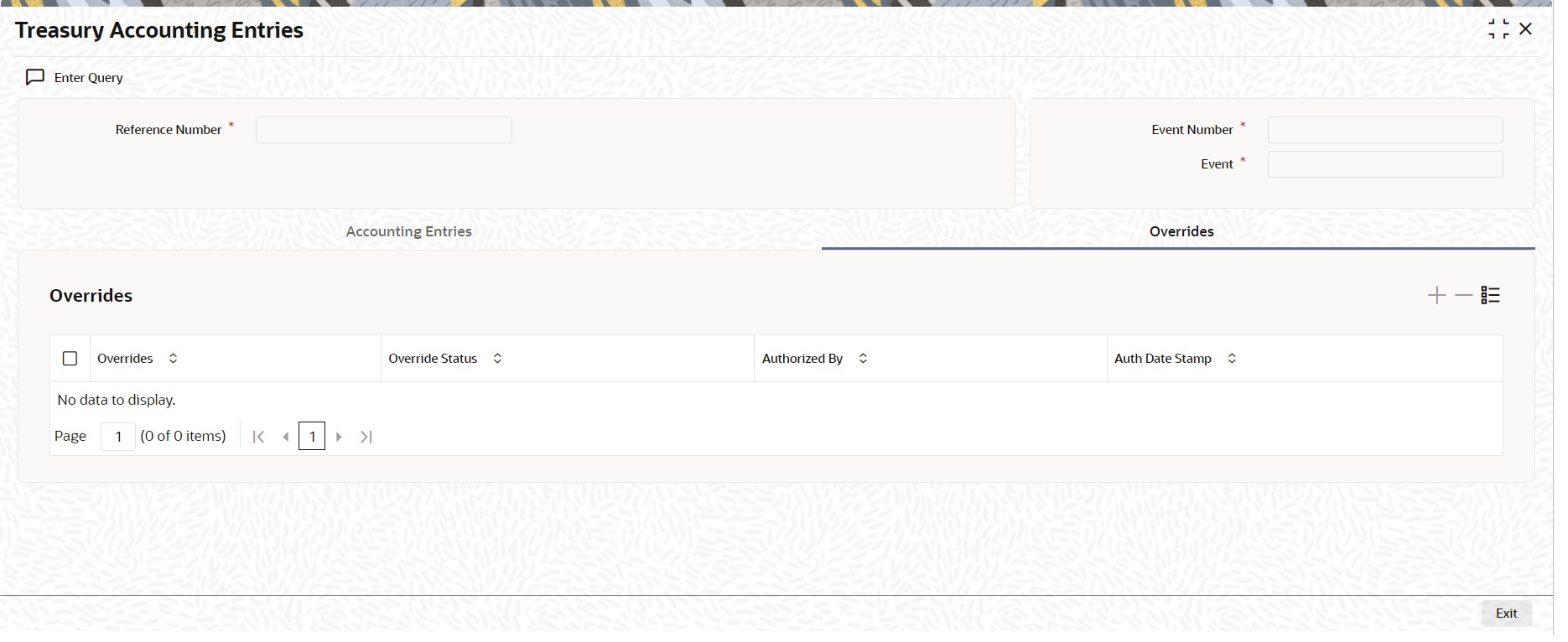

  5. On the Treasury Accounting Entries screen, click Overrides.
    The Treasury Accounting Entries screen with Overrides tab details is displayed.
    Figure 2-23 Treasury Accounting Entries- Overrides
    Description of Figure 2-23 follows
    Description of "Figure 2-23 Treasury Accounting Entries- Overrides"
  6. On the Overrides tab, specify the details as required.
    For more information on fields, see the below table:
    Table 2-27 Overrides - Field Description
    Field Description
    Reference Number
    Displays the contract reference number
    Event Number
    Displays the event number
    Event
    Displays the event code
    Overrides
    Displays the Override message generated for the event
    Override Status
    Displays the override status
    Authorized By
    Displays the Authorizer user ID
    Auth Date Stamp
    Displays the authorization Time stamp

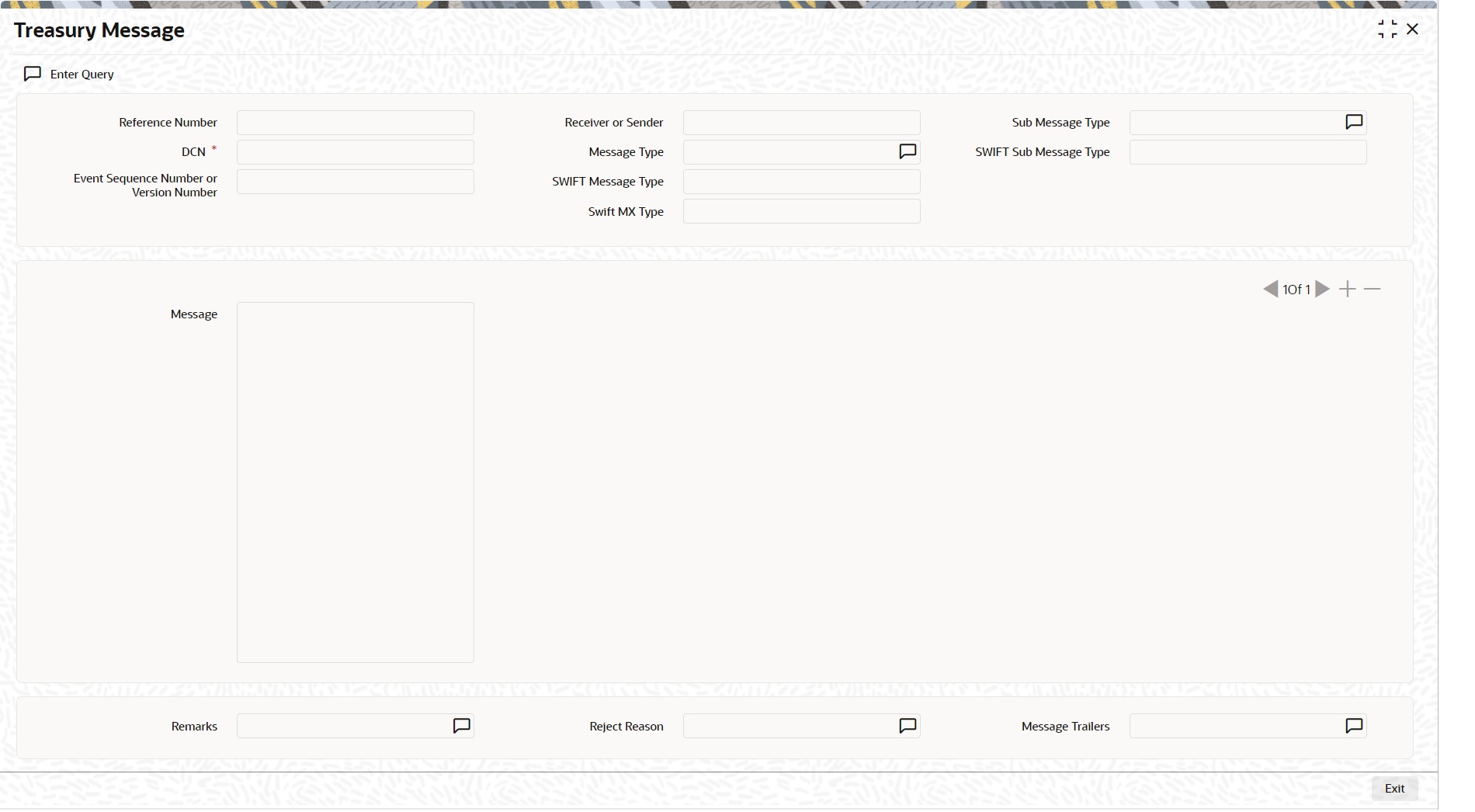

  1. On the Treasury Events screen, click Messages.
    The Treasury Message screen is displayed.
  2. On the Treasury Message screen, specify the details as required.
    For information on fields, see the below table.
    Table 2-28 Treasury Message- Field Description
    Field Description
    Contract Reference
    Event Sequence Number
    Displays the Event sequence number
    Event
    Messages Specifies the messages details.
    Message Type
    Displays the Message Type
    SWIFT Message Type
    Displays the Swift Message Type
    Sub Message Type
    Displays the Sub Message Type
    SWIFT Sub Message Type
    Displays Swift Sub Message type
    Test Status
    Displays Test status
    Medium
    Displays message medium
    Message Status
    Displays the Message status
    Displays Message Authorization status
    Receiver
    Displays the Receiver of the message
    Receiver Name
    Displays the Receiver name of the message

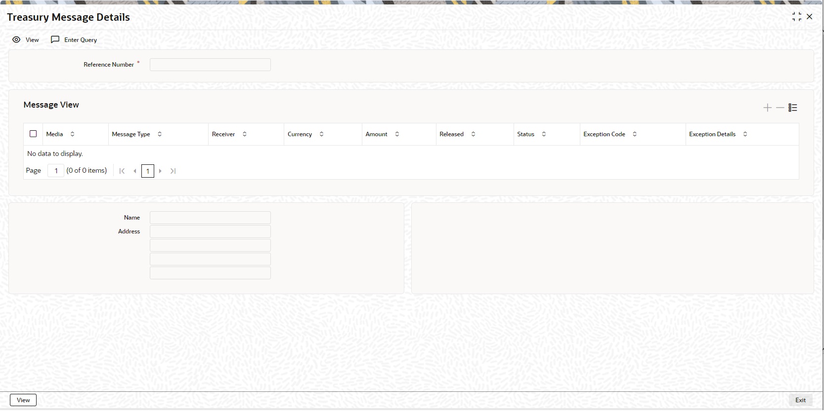

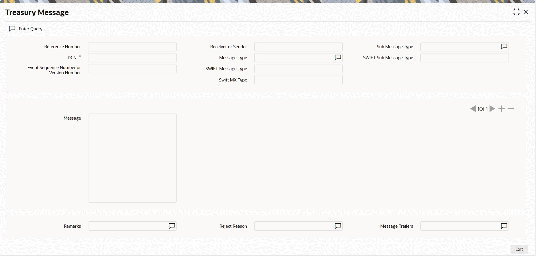

  3. On the Treasury Message screen, click Message Details.
    Treasury Message screen with Message Details is displayed.
  4. On the Treasury Message screen, specify the details as required.
    To view the text of a message, highlight the message and click Message Details. Click Exit or Cancel button to exit the screen.

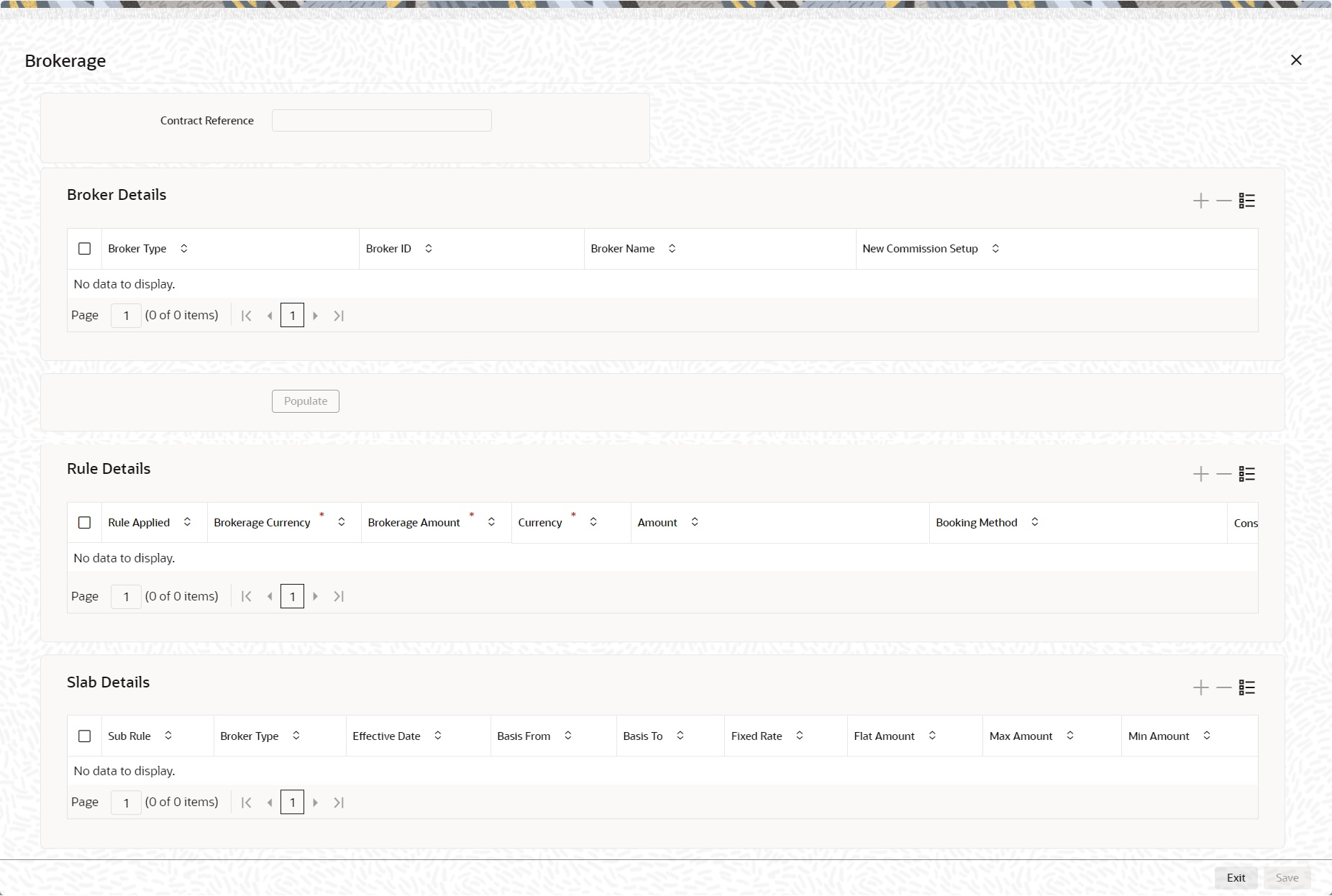

  1. On Security Repo Contract Online screen, click Brokerage.
    The Brokerage screen is displayed.
  2. On Brokerage screen, specify the details as required.
    Table 2-29 Brokerage- Field Description
    Field Description
    Broker
    Defaults Broker ID mapped for the deal
    Broker Name
    Displays the Broker name
    Rule
    Defaults the Broker Rule mapped at the product
    Payable Specify the payable details.
    Currency
    Defaults Broker payable currency
    Amount
    Defaults the Broker amount to be paid
    Brokerage Specify the Brokerage details.
    Currency
    Defaults the Broker currency
    Amount
    Liquidation Specify the Liquidation details.
    Status
    Displays the brokerage liquidation status
    Reference Number
    Displays the brokerage liquidation reference number
    Booking Specify the Booking details.
    No Booking
    To waive brokerage for the transaction, choose the 'No Booking' option.
    Advance
    Brokerage is booked when the deal is initiated
    Arrears
    Brokerage is booked when the deal is liquidated
    Consider For Discount
    This option is defaulted from the deal product level. However, checkbox is unchecked if the booking method is other than Advance.

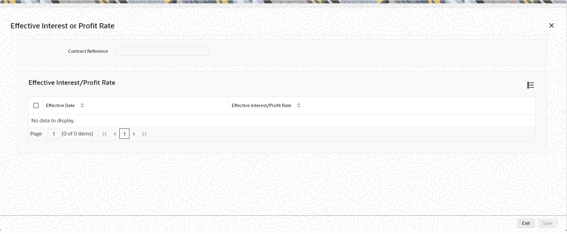

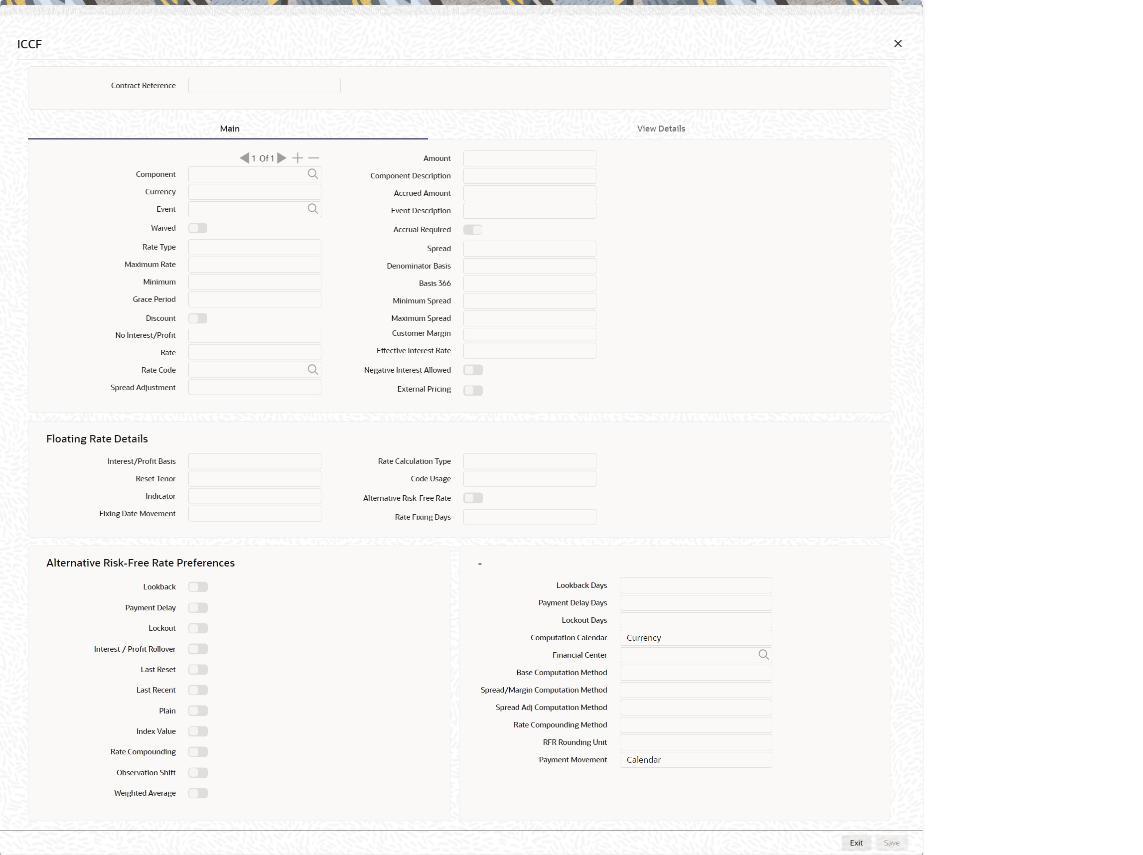

  3. On Security Repo Contract Online screen, click Effective Interest Rate.
    The Effective Interest or Profit Rate screen is displayed.
    Figure 2-27 Effective Interest or Profit Rate
    Description of Figure 2-27 follows
    Description of "Figure 2-27 Effective Interest or Profit Rate"
  4. The processing related to Effective Interest Rate is as follows:
    1. During rate revision of contracts with negative interest allowed products, based on the effective interest rate after rate revision being positive or negative, the system assigns the interest rate to main interest or negative interest component internally.
    2. If the effective rate is negative, the system updates the main interest component rate as zero and assigns the negative rate to negative interest component.
    3. If negative interest is not allowed for the product, then the system skips rate revision for the contract, if the effective rate becomes negative. Exception is logged for the same. You need to initiate amendment of the spread such that net interest rate becomes positive in such cases.
    4. If default minimum value is maintained for the main interest component, then the system defaults the same during rate revision, if the interest rate goes below the specified rate.
  5. On the Effective Interest or Profit Rate screen, specify the details as required.
    For Information on fields, see the below table
    Table 2-30 Effective Interest or Profit Rate- Field Description
    Field Description
    Contract Reference
    Displays the Contract reference number.
    Effective Date
    Displays the effective date on which rate is revised.
    Effective Interest/Profit Rate
    Displays the Revised Effective interest rate.

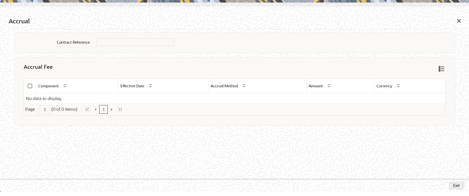

  6. On the Security Repo Contract Online screen, click Accrual.
    The Accrual screen is displayed.
    Figure 2-28 Security Repo Contract Online- Accrual
    Description of Figure 2-28 follows
    Description of "Figure 2-28 Security Repo Contract Online- Accrual"
  7. On the Accrual screen, specify the details as required.
    Table 2-31 Accrual- Field Description
    Field Description
    Contract Reference
    Component
    Displays the accrual component
    Effective date
    Accrual Method
    Displays the Accrual method
    Amount
    Displays the Accrual amount
    Currency
    Displays the Accrual currency

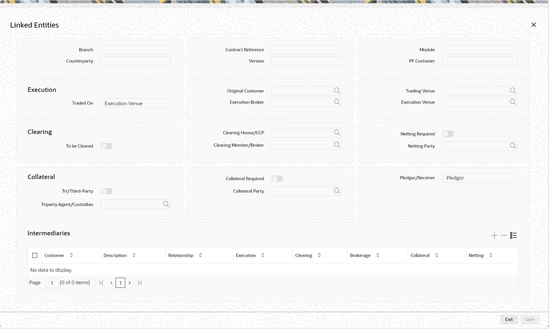

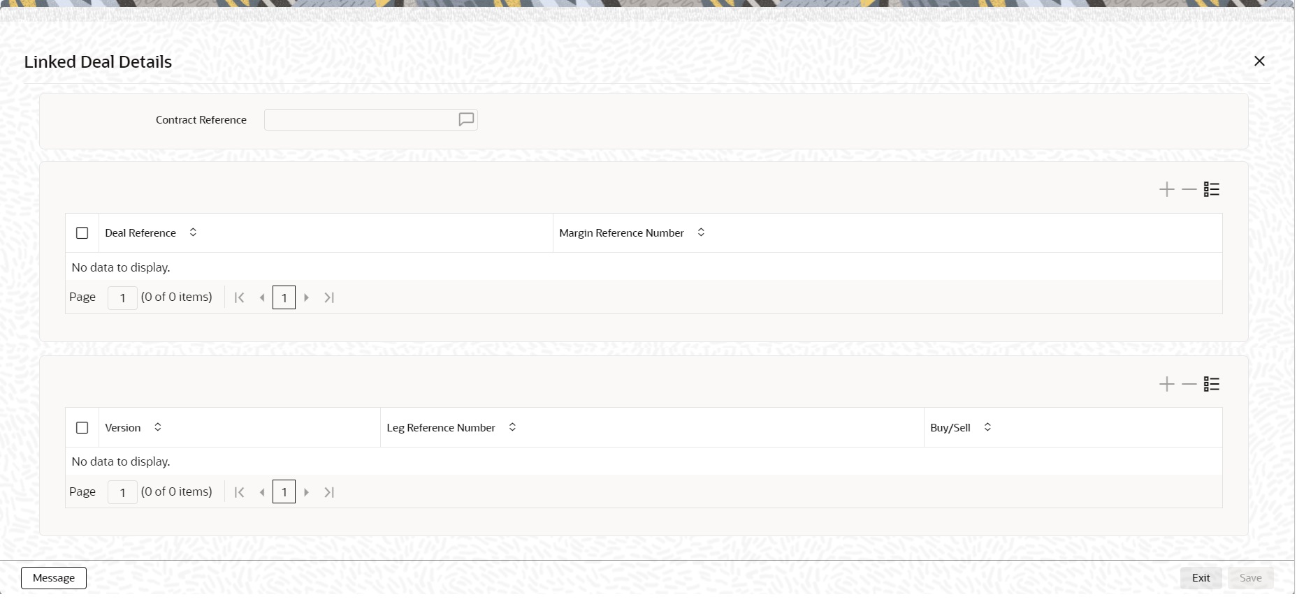

  8. On Security Repo Contract Online screen, click Linked Entities.
    Security Repo Contract Online- Linked Entities screen is displayed.
  9. On the Linked Entities screen, specify the details as required.

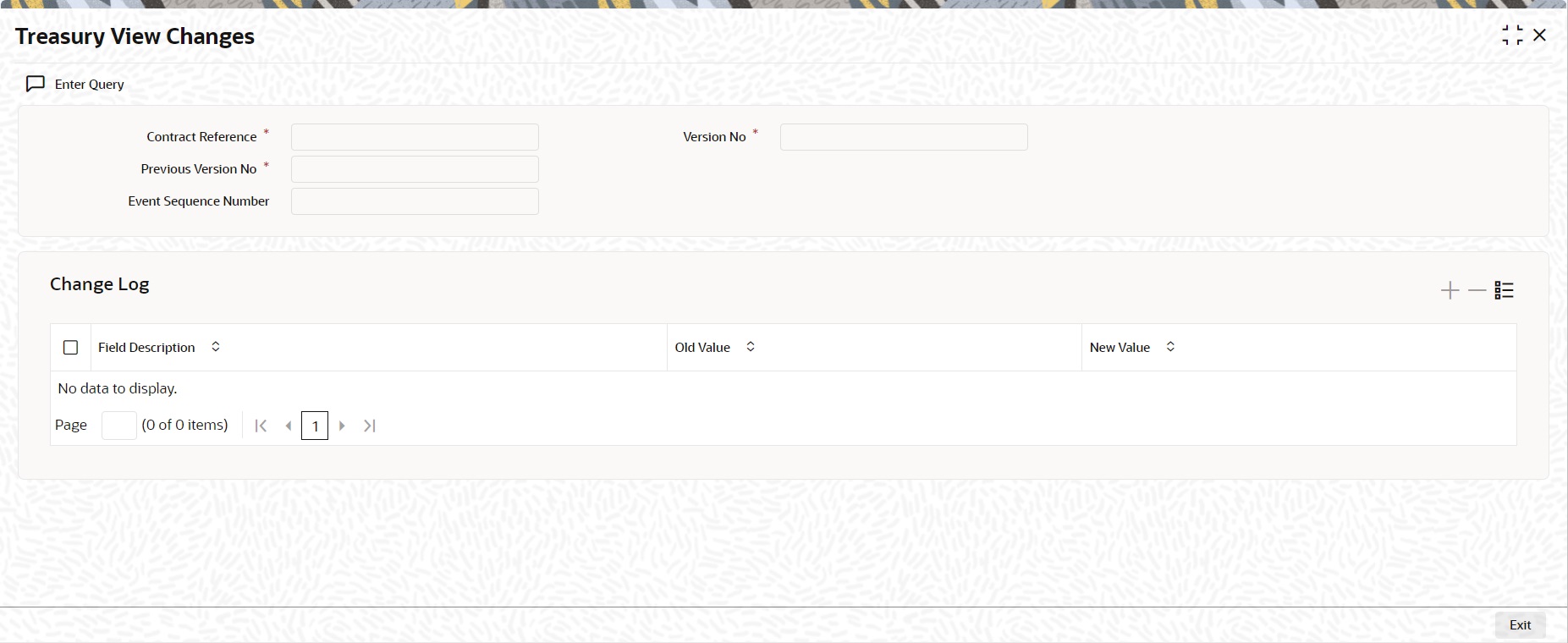

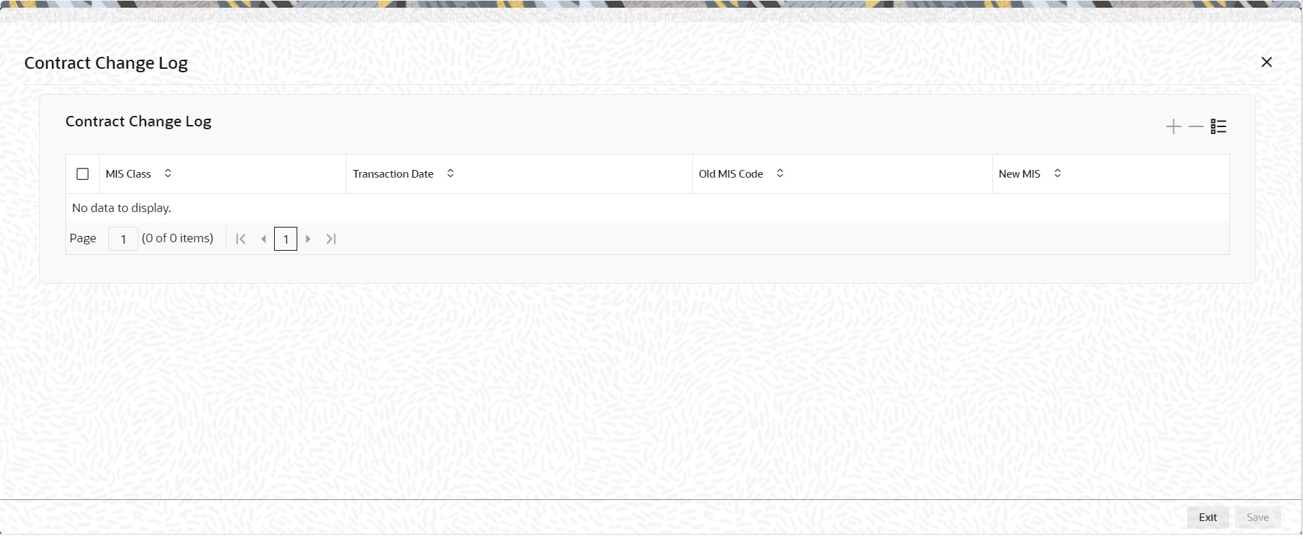

  10. On the Security Repo Contract Online screen, click Change Log.
    Treasury View Changes screen is displayed.
    Figure 2-30 Treasury View Changes
    Description of Figure 2-30 follows
    Description of "Figure 2-30 Treasury View Changes"
  11. On the Treasury View Changes screen, specify the details as required.
    Table 2-32 Treasury View Changes- Field Description
    Field Description
    Displays the event sequence number
    Version No
    Displays the event version number
    Field Description
    Displays the modified field
    Old Value
    Displays the old value
    New Value
    Displays the New value

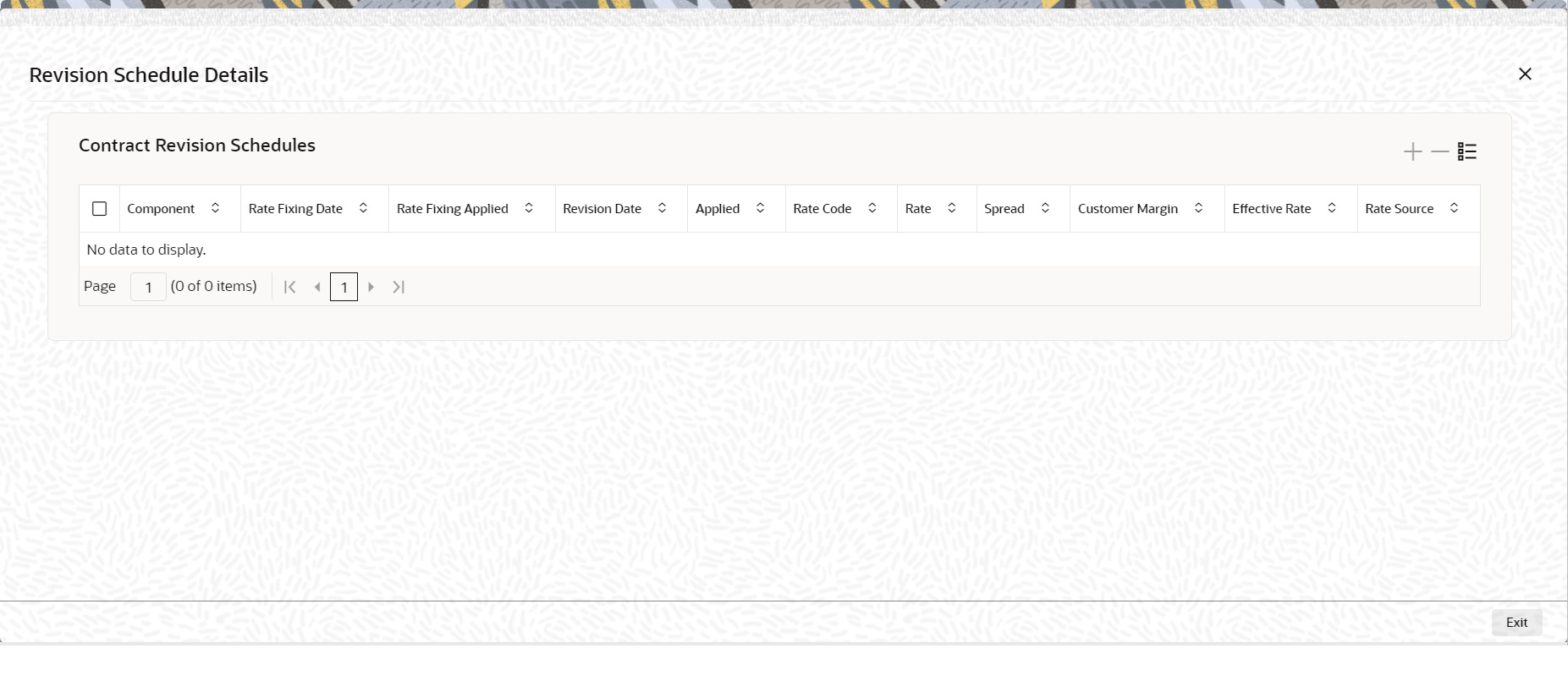

Interest Rate Revision Schedule
A Floating Rate Table containing the market rates for the day - is maintained in the ICCB sub-system so that the latest rates are applied to deals.
The market rates vary daily and are maintained in this table. The rates are applied either every time they change or at periodic intervals. Usually, for Securities Repo deals, floating rates are applied, i.e., the latest market rate is applied. The user can also apply these rates periodically so that the user is in tune with the market rates (as opposed to fixed interest rates which remain the same for the entire period of the deal), and at the same time, the user need not apply the market rates daily.
The user can specify if the latest market rates have to be applied every time they change or apply periodically by defining an attribute called the Rate Code Usage. The Rate code usage is applied through the Product ICCB Details screen for a floating interest type. If the user specifies auto rate code usage, all the rate changes made during the liquidation or accrual period is considered. If the user specifies periodic rate code usage, the rates are periodically refreshed and the rates as of a specific frequency, or date, is applied.
For a deal that has been defined with Periodic Interest that has to be applied at periodic intervals, the user can specify the following:
  • The frequency at which the periodic rate change has to be applied.
  • The dates on which the periodic rate change has to be applied
Specify the Rate Revision Frequency
In the SR Contract Schedules screen, select the component, for which the Rate Revision frequency has to be defined (say INTEREST1). Select the Type as 'R' (Revision), then enter your specifications in the frequency (it could be daily, weekly, etc.), the number, and unit fields. Also, give the Start Date on which the first revision has to take place.
For example, if the user specify the frequency, like weekly, the revision will take place every week beginning on the Start Date that the user has specified.
Specify the Rate Revision Dates
Instead of specifying the other schedule details like the frequency, the number and unit, indicate the date in the Start Date field. The rate revision is done on that date.
Interest Repayment Schedules as Different from Rate Revision Schedules
For a deal on which floating interest is applied at periodic intervals, the user may have to define:
  • An interest rate revision schedule for the interest component.
  • A repayment schedule.
The following example shows how this is achieved:
The user has a deal where for the component interest; the user has to define an interest rate revision schedule for revisions every week as well as a fortnightly interest repayment schedule. The Start Date of the deal is 1 October ‘97, and the End Date is 31 October ‘97. The deal is defined with a periodic rate and the rates in the floating rate table change in the following manner:
Define a frequency based rate revision schedule
To define a schedule with periodic rate code usage, through the Contract Schedules screen, mark the component as a revision schedule and specify the component, say INTEREST, from the pick list. Give the frequency at which the interest rate has to be refreshed, say weekly. Give the Start Date, say 8 October. The first revision will happen on this day, and every week from then on. Save the inputs.
Define a date based rate revision schedule
If the user were to define specific dates - 7 October, 15 October and 23 October - for the rate revision to happen, then, through the Contract Schedules screen, mark the component as a revision schedule and specify the component, say INTEREST, from the pick list.
Specify the date on which the rate revision is to be done, in the Start Date field, as 7 October. Similarly, define the other dates, but by picking up the same component INTEREST from the pick list each time.

  1. On Security Repo Contract Online screen, click Revision Details.
    The Revision Schedule Details screen is displayed.
    Description of srdtronl-cvs-revsionscheduledetails.png follows
  2. On the Revision Schedule Details screen, specify the details as required.
    Table 2-36 Revision Schedule Details - Field Description
    Field Description
    Component
    Specify the component for which the schedule is being defined. The options are
    • Principal
    • Fee
    • Commission
    • Charge or interest
    Rate Fixing Date
    Displays the derived Rate fixing date
    Rate Fixing Applied
    Displays whether Rate fixing is applied for the contract or not.Values - N, Y
    The system generates the SGEN only when the rate fixing applied option is Y for all the revision schedules.
    Revision Date
    Displays the revision date for the schedule
    Revision Applied
    Displays whether revision is applied or not Values - N, Y.
    Rate Code
    Displays the Floating Rate code mapped to the contract
    Rate
    Displays the Floating rate from the floating rate table
    Spread
    Displays the Rate Code spread for the contract
    Customer Margin
    Displays the customer margin
    Effective Rate
    Displays the Effective interest rate
    Rate Source
    Displays the Rate source from where the rate is taken
  3. On the Security Repo Contract Online screen, click Interest.
    The ICCF screen is displayed.
  4. On Interest screen, specify the fields.
    Table 2-37 Interest- Field Description
    Field Description
    Contract Reference
    Displays Contract reference number
    Component
    Displays the Interest component mapped to the contract
    Currency
    Displays the Interest component currency
    Event
    Display the Event associated with the component
    Waived
    Specify whether user wants to waive the interest
    Rate Type
    Select the Rate Type from the drop-down list.
    The options are:
    • Floating
    • Special
    • Fixed
    Maximum Rate
    Displays the maximum rate for the component
    Minimum
    Displays minimum rate for the component
    Grace Period
    Select the Grace Period from the drop-down list.
    The options are:
    • Months
    • Years
    • Days
    Discount
    Defaults discount flag from product
    No Interest/Profit
    Displays the contract Interest
    Rate
    Specify the contract Fixed interest rate. System defaults 'Default rate' from product. User can modify the same.
    Rate Code
    Defaults Floating rate code from product. User can modify the same.
    Amount
    Specify the special interest amount for the contract.
    Spread Adjustment
    Specify the Rate code spread adjustment.
    Component Description
    Display the component description.
    Accrued Amount
    Displays the Interest accrued amount
    Event Description
    Accrual Required
    Specify if Interest accrual required or not
    Spread
    Specify the rate code spread for a floating interest rate
    Denominator Basis
    Denominator Basis is used to specify how the month of February is treated when the denominator is 'Actual'.
    Basis 366
    Defaults from product. This is applicable only if the Denominator Basis is set to 'Per Annum'.
    Minimum Spread
    Displays minimum spread for the floating rate code
    Maximum Spread
    Displays maximum spread for the floating rate code
    Customer Margin
    Specify the customer margin
    Displays the effective interest rate of the contract
    Negative Interest Allowed
    Check this box to indicate that the negative interest should be allowed for the product.
    If this box is checked, then the system allows Negative fixed rates or resolved rates at the SR contract and during VAMI,
    External Pricing
    Defaults external pricing from product
    Interest/Profit Basis
    Defaults Interest Basis from product, which indicates the Interest basis for the component for which penalty is being computed
    Reset Tenor
    Floating interest rates are defined for specific amount slabs and tenor combinations.
    User can indicate the reset tenor for which floating rates need to be picked up.
    Indicator
    The user can use this field to indicate whether the borrowing rate, lending rate or mid rate must be picked up from the floating rate table, for the specified rate code.
    Fixing Date Movement
    Defaults Rate fixing date movement from product. user can modify the same. The options are:
    • Backward movement
    • Forward movement
    Rate Calculation Type
    Defaults the rate calculation type from product
    Code Usage
    Specify the rate code usage. It can be periodic or automatic. In case of periodic user needs to define revision schedule for the floating interest component
    Alternative Risk-Free Rate
    Specify if the interest rate code is a risk free rate
    Rate Fixing Days
    Defaults the rate fixing days from product.
    The method in which the number of days are to be calculated for interest, charge, commission or fee components and whether their application is tenor based is displayed here based on the specification the user made at the product level. The User can choose to change it.
    • 30(Euro)/360
    • 30(US)/ 360
    • Actual/360
    • 30(Euro)/365
    • 30(US)/365
    • Actual/365
    • 30(Euro)/Actual
    • 30(US)/Actual
    • Actual/Actual
    • 30(Euro)/364
    • 30(US)/ 364
    • Actual/364
    Select the movements from the drop-down list.
    The available movements are:
    • Forward
    • Backward
    • None
    as per the requirement for the effective revision date.
    Select the Alternate Risk-Free Rate check box to enable the Alternate Risk Free-Rate preferences.
    For more information on the
    Alternate Risk Free-Rate preferences fields, refer to .

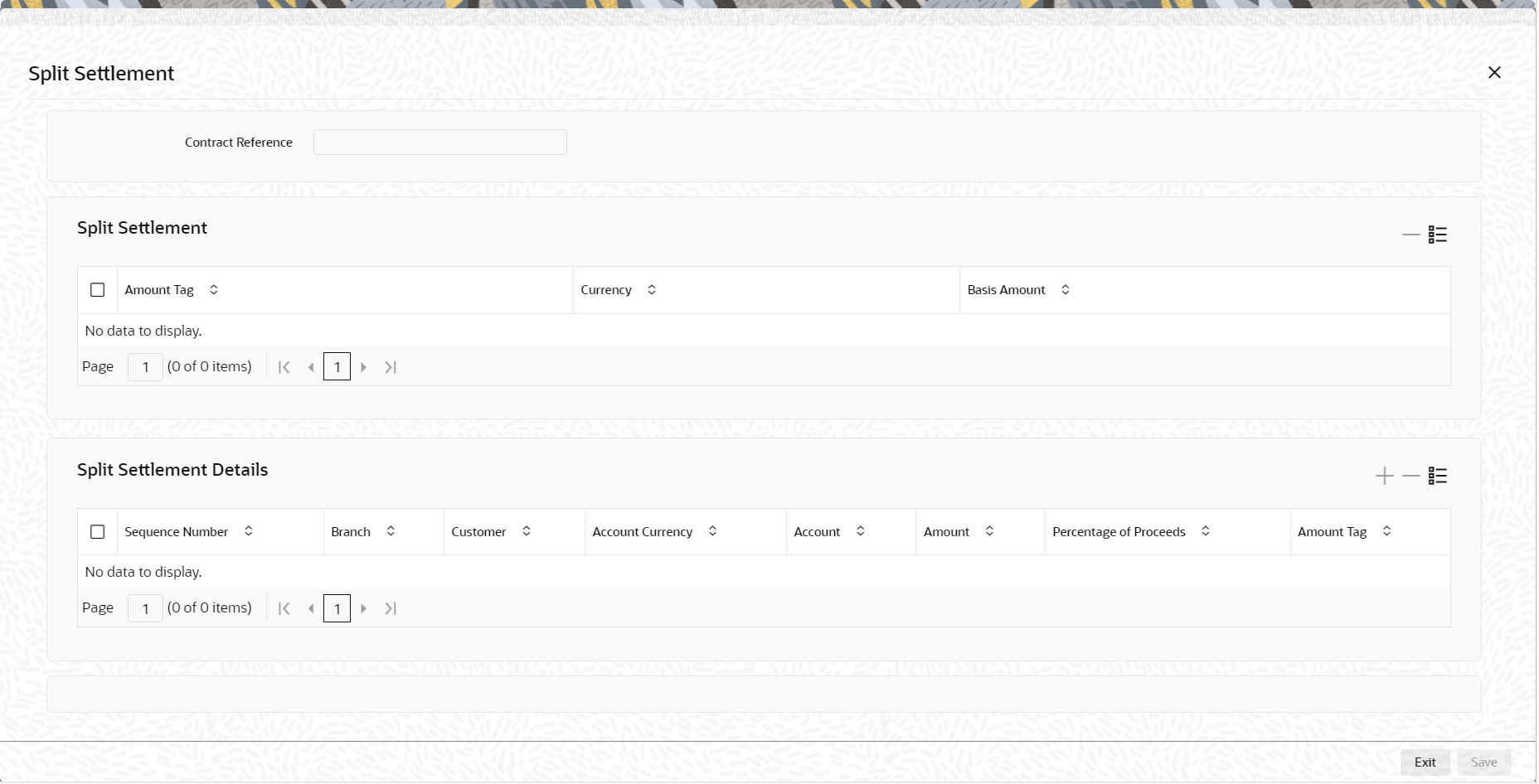

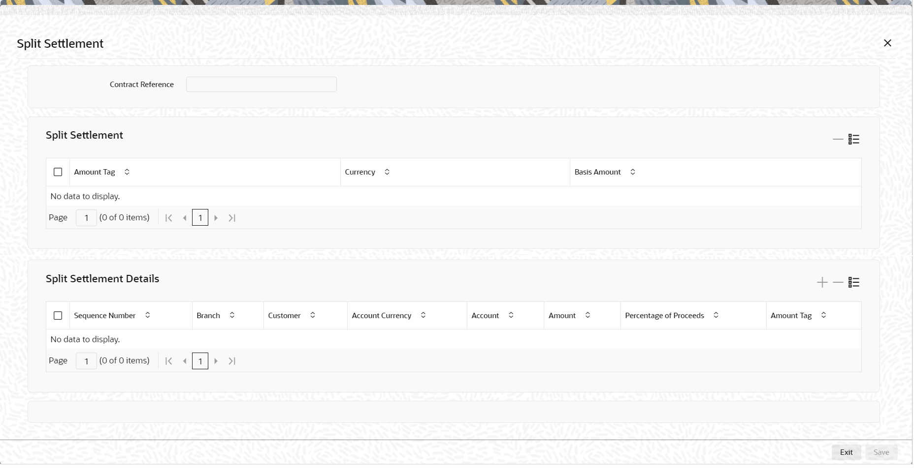

  6. On the Securities Repo Contract Online screen, click Split.
    The Split Settlement Screen is displayed.
  7. On the Split Settlement screen, select a contract.
  8. On the Split Settlement screen, under the Split Settlement Details, click the + Icon.
    Split Settlement screen with new row is displayed.
    Figure 2-33 Split Settlement with a new row added
    Description of Figure 2-33 follows
    Description of "Figure 2-33 Split Settlement with a new row added"
    This process of splitting the settlements for a contract is allowed on the principal, Interest (Anticipated Interest for new contracts), and charges.
  9. On the Split Settlement screen, specify the details as required.
    For information on fields, refer to the below table:
    Table 2-38 Split Settlement- Field Description
    Field Description
    Contract Reference
    The selected contract reference number is displayed.
    Basis Amount
    The Basis Amount details is displayed.
    Sequence Number
    The Sequence number details is displayed.
    Branch
    The Branch details is displayed.
    Click the search icon and select the branch as required.
    Customer
    The Customer number is displayed.
    Click the search icon and select the customer as required.
    Account Currency
    Click the search icon and select the account currency from the list displayed.
    Account
    Click the search icon and select the account details from the list displayed.
    Amount
    Specify the amount details as required.
    Percentage of Proceeds
    This is a read only field, system displays the percentage of proceeds after save.
    Amount Tag
    System displays the amount tag details as required.

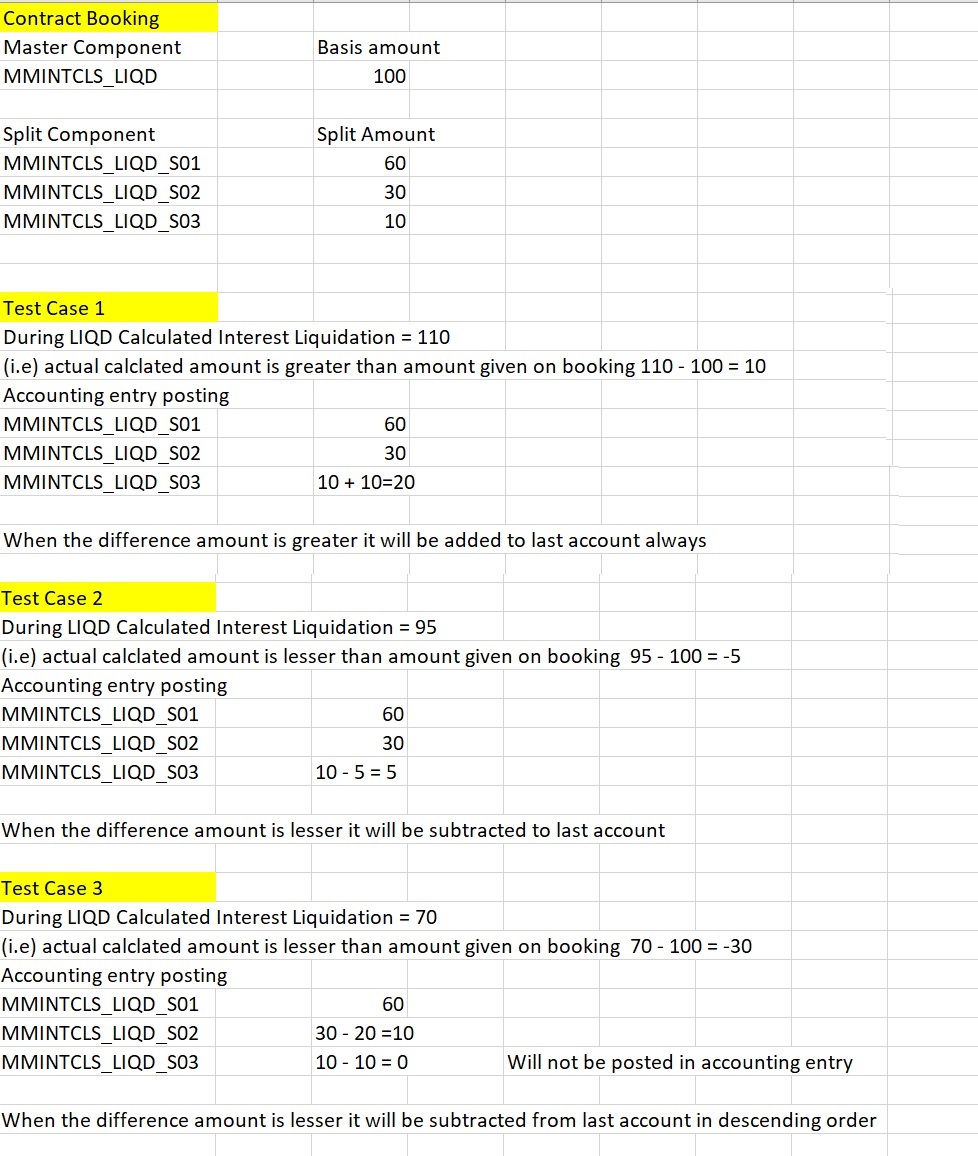

  10. Choose the Account Currency, Account, and other necessary details, to create a split.
    • For every Settlement contract the system allows a maximum of twelve splits.
    • In case of auto-liquidation, the user must unlock the contract and register the split, upfront, that is prior to auto-liquidation. The updating provision, split settlement for the interest portion, is only available after saving and first approval. For each split amount, SGEN is produced. In field 72 of MT202 and MT202COV, the system will suffix the reference number with a hyphen followed by a running sequence number for each SGEN.
    • Only if split settlement details are available, system will process the transaction accordingly, else the payment/settlement is treated as a single payment transaction
    • If the user are splitting the contract during the rollover, the application considers the latest available split details and process the liquidation amount, if any. If split settlement details are not available, the transaction (partial (liquidation as part of rollover) is treated as normal/regular/non-split liquidation. The split is allowed in manual rollover as well.
    • For a single component, the user can split the settlement amount and use the same settlement account more than once. There is no restriction on the repetition of split settlement amount for the same NOSTRO/settlement account.
    • Cross currency split settlement is supported. The Amount field/column in the Split tab is, by default, in the contract currency (though not evident in the User Interface). The currency of the settlement account can be in a different currency. The converted amount has to be viewed in the accounting entries as part of Events tab only.
    • Appropriate Amount tags, for each component like principal, interest and charges, are made available at the relevant event(s) for enriching the split settlement details.
    Example
  11. On Security Repo Contract Online screen, click Messages.
    Treasury Message Details screen is displayed.
    Figure 2-34 Treasury Message Details
    Description of Figure 2-34 follows
    Description of "Figure 2-34 Treasury Message Details"
  12. On the Treasury Message Details Screen, specify the details as required.
    The following details of Advices are displayed:
    • The message type
    • The Name and ID of the recipient of the message and
    • The status of the message.
    click Messages to view the list of advices applicable to a particular event in the lifecycle of the repo.
  13. On the Treasury Message Details screen, click View.
  14. On the Treasury Message screen, specify the details as required.
    To view the text of a message, highlight the message and click . Click Exit or Cancel button to exit the screen.
    View the following details:
    • Reference number of the message/advice
    • Document number generated for the message/advice
    • Version number of the message/advice
    • Receiver/sender of the message
    • Type of the message
    • Type of the SWIFT message
    • Complete text of the message/advice
    • Remarks, if any
    • Reject reason, if any
    • Message trailer

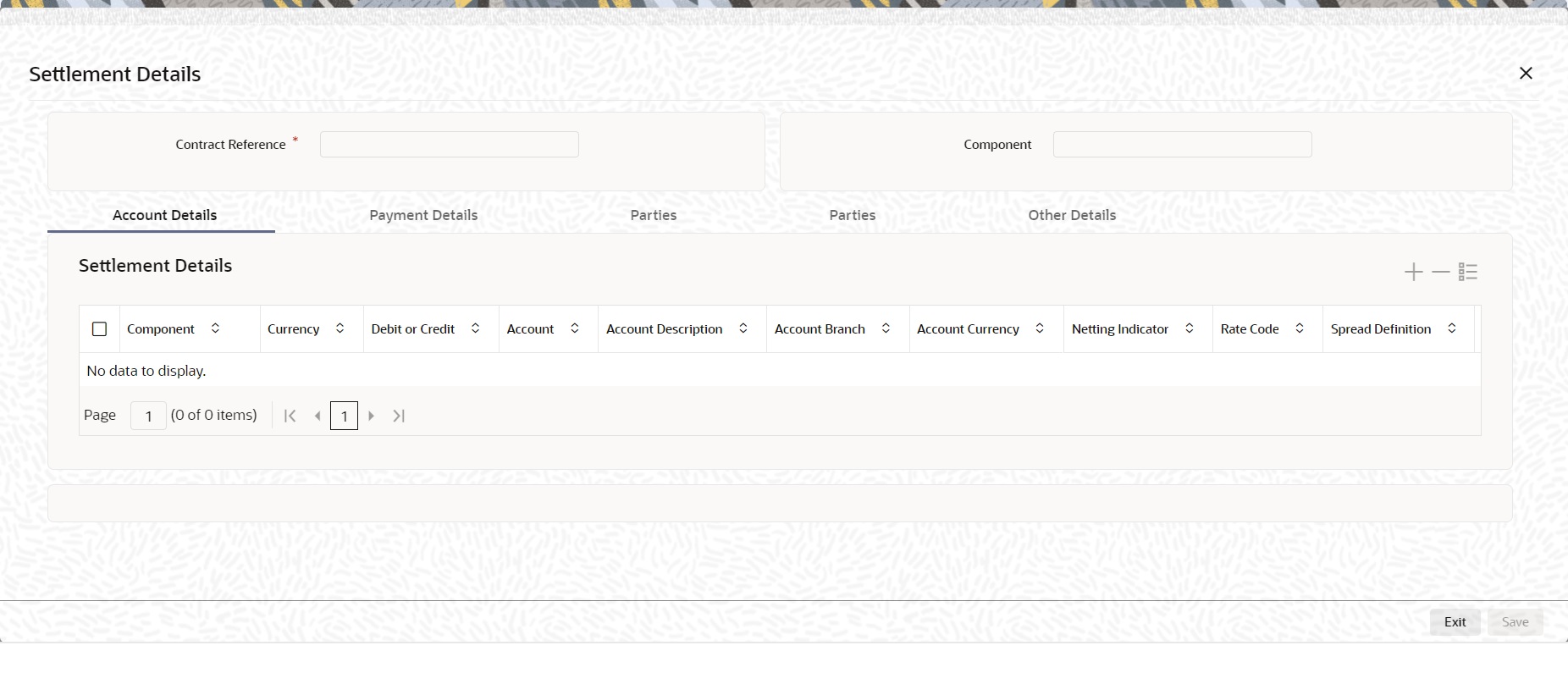

  15. On Security Repo Contract Online screen, click Settlement.
    The settlement account details of each deal is displayed in the Settlement Instructions screen. Click on the contract for which the user want to view the settlement details and it is displayed in the Settlement Instructions section. For each amount tag, the following settlement details are displayed:
    • Settlement account
    • Currency of the settlement account
    • Settlement account branch
    • Payable or Receivable
    • Ordering Institution
    • Ordering Customer
    • Beneficiary Institution
    • Ultimate Beneficiary
    • The settlement details for the latest event of the deal is displayed.
    The Settlement Details screen is displayed.
  16. On the Settlement Details screen, specify the details as required.
    The deal gets settled based on the details specified in the settlement screen.
    For more details on this screen, refer to Settlements User Manual, section Processing Settlements.

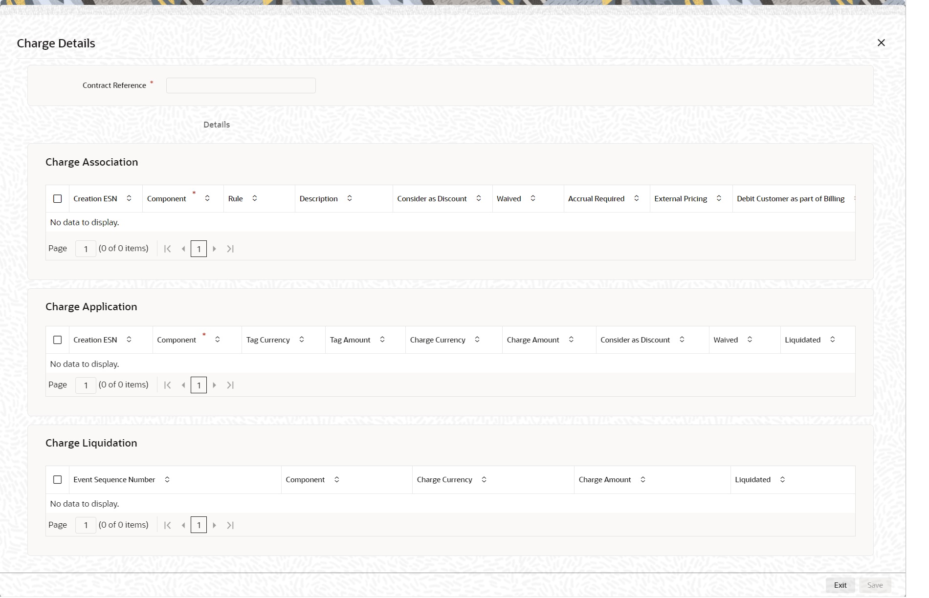

  17. On the Security Repo Contract Online screen, click Charges.
    The Charge Details screen is displayed.
  18. On the Charge Details screen, specify the details as required.
    The ICCF rate, amount, currency and the user can specify waive charge parameter. The Processing Charges and Fees manual, details the procedure for maintaining charge rules.

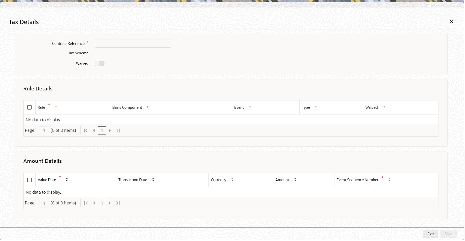

  19. On the Security Repo Contract Online screen, click Tax.
    The Tax Details screen is displayed.
  20. On the Tax Details screen, specify the details as required.
    Table 2-39 Tax Details - Field Description
    Field Description
    Contract References
    Tax Scheme
    Displays the tax scheme associated to the product.
    Waived
    Specify if the tax must be waived
    Rule Details Specify the Rule details.
    Rule
    Displays the tax rules
    Basis Component
    Defaults the basis component from the product.
    Event
    Displays the event associated to the tax.
    Type
    Displays the type of tax.
    Waived
    Amount Details Specify the Amount details.
    Value Date
    Value date of tax liquidated
    Transaction date
    Transaction date of the tax processing
    Currency
    Displays the tax currency
    Amount
    Displays the tax amount collected

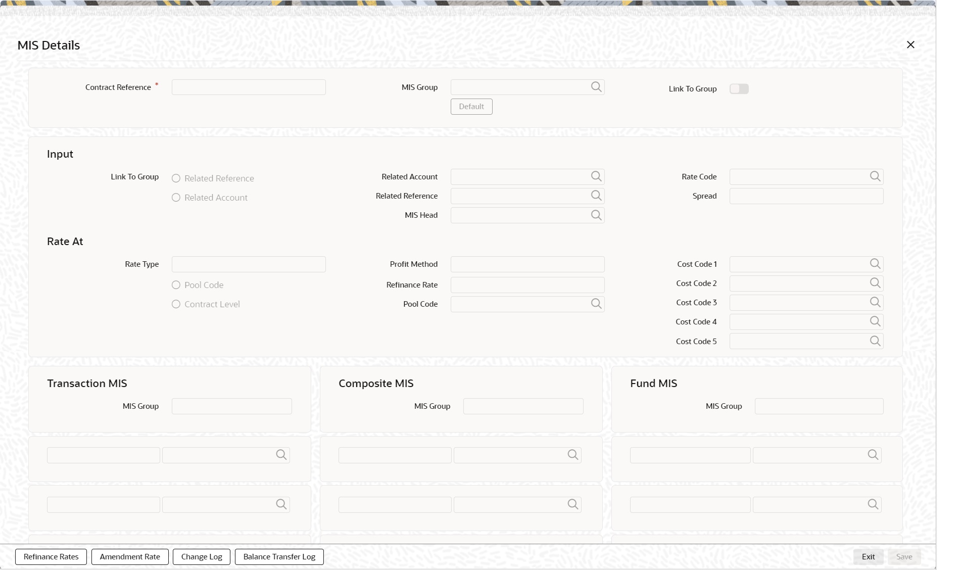

  21. On the Security Repo Contract Online screen, click MIS.
    The MIS Details screen is displayed.
    Figure 2-39 MIS Details
    MIS details
  22. On the MIS Details screen, specify the details as required.
    For information on fields, refer the MIS User Guide.
  23. On the MIS Details screen, click Refinance Rate.
    The Refinance Rate screen is displayed.
  24. On the Refinance Rate screen, specify the details as required.

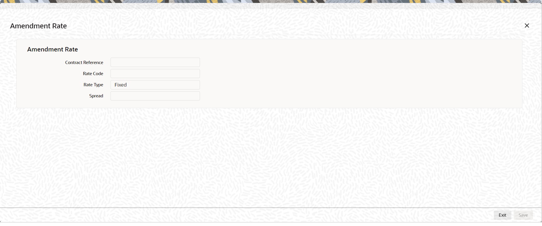

  25. On the MIS Details screen, click Amendment Rate.
    The Amendment Rate screen is displayed.
  26. On the Amendment Rate screen, specify the details as required.
    Table 2-40 Amendment Rate- Field Description
    Field Description
    Rate Type
    The Options are:
    • Fixed
    • Floating
    • Automatic
    • Floating Periodic
    Contract Reference
  27. On the MIS Details screen, click Change Log.
    The Change Log screen is displayed.
  28. On the Change Log screen, specify the details as required.
  29. On the MIS Details screen, click Balance Transfer Log.

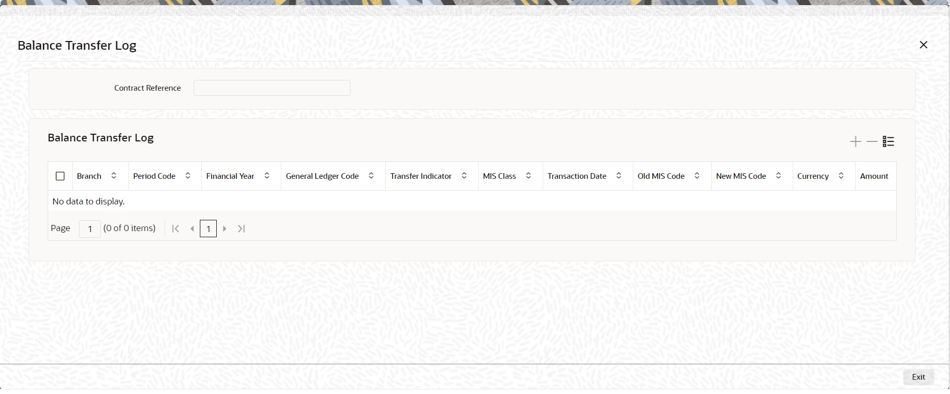

    The Balance Transfer Log screen is displayed.
    Figure 2-43 Balance Transfer Log
    Description of Figure 2-43 follows
    Description of "Figure 2-43 Balance Transfer Log"
  30. On the Balance Transfer Log screen, specify the details as required.

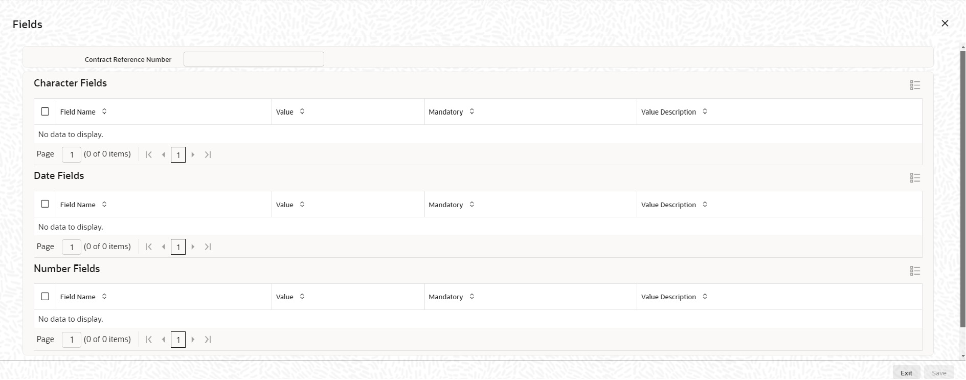

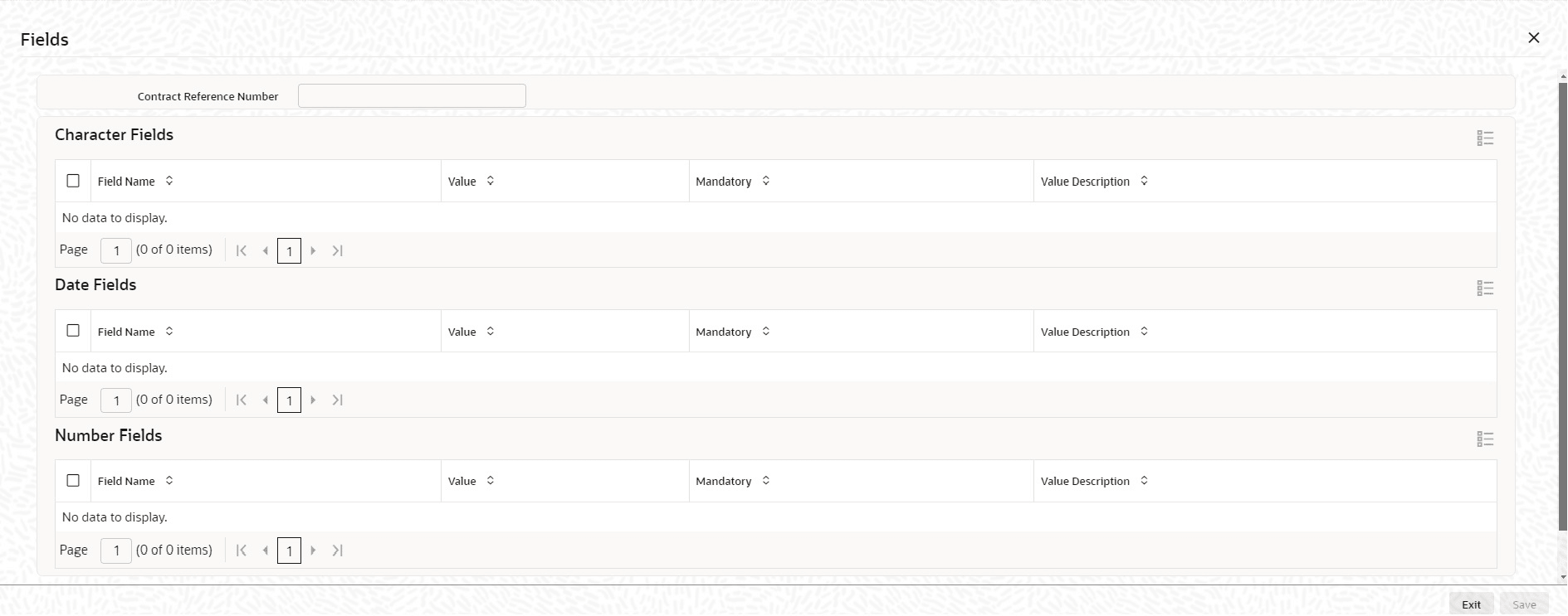

  31. On the Security Repo Contract Online screen, click Fields.
    The Fields screen is displayed.
    Figure 2-44 Fields
    Fields
  32. On the Fields screen, specify the details as required.
    Table 2-41 Fields - Field Description
    Field Description
    Displays contract reference number
    Field Name
    Defaults user defined field name mapped to the product
    Value
    Specify the UDF value
    Mandatory
    Defaults the mandatory flag from user defined maintenance screen
    Value Description
    Displays the user defined value description
  33. On the Security Repo Contract Online screen, click Linked Deal Details.
    The Linked Deal Details screen is displayed.
    Figure 2-45 Linked Deal Details
    Description of Figure 2-45 follows
    Description of "Figure 2-45 Linked Deal Details"
  34. On the Linked Deal Details screen, specify the details as required.
    Table 2-42 Linked Deal Details - Field Description
    Field Description
    Contract Reference
    Deal Reference
    Displays all linked deal reference number for the repo contract.
    The options of Deal type are:
    • Buy deal
    • Sell deal
    • Block deal
    Margin Reference Number
    Displays all the margin reference number created for the repo contract on margin processing
    Version
    Once the user clicks the Deal reference, system displays the leg reference version number
    Leg Reference Number
    Once the user clicks the Deal reference, system displays the leg reference number
    Buy/Sell
    Displays the leg type
  35. On the Linked Deal Details screen, click Messages.
    User can view the MT5X message generated for a repo/reverse repo deal.
    Treasury Messages Details screen is displayed.
    Figure 2-46 Treasury Messages Details
    Message details
  36. On the Treasury Messages Details screen, specify the details as required.
    Table 2-43 Treasury Messages Details - Field Description
    Field Description
    Reference Number
    Media
    Displays the message media
    Message Type
    Displays the message type
    Receiver
    Displays Receiver ID.
    Currency
    Displays message currency
    Amount
    Displays the amount
    Released
    Displays the released status
    Status
    Displays current status of message.
    Exception Code
    Displays the exception code, if the message goes in exception
    Exception Details
    Displays the exception details.
    Name
    Displays the name of the receiver.
    Address
    Displays the receiver address.
  37. On the Treasury Messages Details screen, click View.
    Treasury Messages screen is displayed.
    Figure 2-47 Treasury Messages
    Messages
  38. On the Treasury Messages screen, specify the details as required.
    Table 2-44 Treasury Messages - Field Description
    Field Description
    Reference Number
    DCN
    Displays document reference number of a contract
    Event Sequence Number or Version Number
    Receiver or Sender
    Displays Receiver or Sender ID.
    Message Type
    Displays the type of message.
    SWIFT Message Type
    Displays the Swift MT number of the message sent or received.
    Sub Message Type
    Displays the sub message type
    Displays the Swift sub message type.
    Message
    Displays the Message view
    Remarks
    Displays the remarks
    Reject Remarks
    Displays the reject remarks.
    Message Trailers
    Displays the message trailers.
  39. On the Securities Repo Contract Online screen, click Holiday Preference.
    Holiday Preference screen is displayed
  40. On the Holiday Preference screen, specify the details as required.
    Table 2-45 Holiday Preference - Field Description
    Field Description
    Contract Reference
    The Contract Reference number from the main screen is displayed here.
    Holiday Validations Not Applicable
    Check this box to indicate that the holiday calendar validation must not be performed.
    Local Holiday
    Select this check box, if the local holiday validation of dates and schedule movement is required, which is defaulted from product and amendable.
    Currency Holiday
    Select this check box, if the currency holiday calendar validation of dates and schedule movement is required, which is defaulted from product and amendable.
    Financial Center Holiday
    Select this check box, if the financial center holiday calendar validation of dates and schedule movement is required, which is defaulted from product and amendable.
    Move Across Months
    Check this box to indicate that the final date must be derived next month if the date falls on holiday. Otherwise, final date becomes end of the month though actual date derived is on next month.
    Date Movement
    Select the holiday date movement when the date falls on holiday. The adjoining drop-down list displays the following values:
    • Forward
    • Backward
    Currency
    Specify the currency details for which the holiday validation for dates and schedules movement is required, which is defaulted from product and amendable.
    Financial Center
    Specify the financial center from the adjoining option list. The list displays all active financial centers maintained in the system. You can choose the appropriate one.
  41. On the Holiday Preferences screen, click Event Date Preference
    The Holiday Preferences with Event Date tab details is displayed.
    Figure 2-48 Event Date- Holiday Preferences
    Description of Figure 2-48 follows
    Description of "Figure 2-48 Event Date- Holiday Preferences"
  42. On the Event Date Preference tab, specify the details as required.
    The following are the field descriptions:
    Table 2-46 Event Date Preference- Field Description
    Field Description
    Leg Type
    Select the leg type for the holiday preferences from the adjoining drop-down list. The list displays the following values:
    • In Leg
    Event Date Type Description
    Specify the description of event date type for which the holiday calendar validations must be performed. The adjoining option list displays all valid event description maintained in the system. You can choose the appropriate one.
    Local Holiday
    Select this check box if the local holiday validation of the dates and schedule movement has to be executed.
    Currency Holiday
    Select this check box, to execute the currency holiday calendar validation of the dates and movement of schedules.
    Financial Center
    Select this check box, to execute the financial center holiday calendar validation of the dates and movement of schedules.
    Event Date Type
    The event date type details is displayed in this field.
    Move Across Months
    Date Movement
    • Not Applicable
    • Forward
    • Backward
    Currency
    Specify the currency from the adjoining option list. The list displays all valid currencies maintained in the system. You can choose the appropriate one.
    This field is mandatory if event date level currency holiday validation is required.
    Financial Center
    This field is mandatory if event date level financial center holiday validation is required.
    Based on the requirement you can choose more than one holiday check at the same time.
    The Value Date, Maturity Date, Rate Revision Schedule Date, Rate Fixing Date and Interest Schedule date fields will be validated for Local, Currency and Financial Center holidays while Repo deal booking and the system displays an appropriate override message.
    When any one or all of Rate Revision Schedule Date, Rate fixing date and Interest Schedule date falls on a holiday, then the date will be moved according to the date movement selected in ‘Event Preference’ tab, either Forward or Backward to a Business day.
    When any one or all of Rate Revision Schedule Date, Rate fixing date and Interest Schedule date falls on a holiday and the date movement is selected as ‘Not Applicable’ in ‘Event Preference’ tab, an error message will be displayed and the date movement needs to be changed to ‘Forward’ or ‘Backward’.

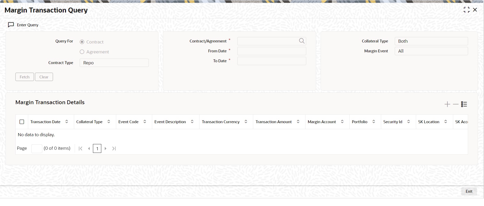

  43. On the Securities Repo Contract Online screen, click Margin Details.
    Margin Transaction Query screen is displayed.
    Figure 2-49 Margin Transaction Query
    Description of Figure 2-49 follows
    Description of "Figure 2-49 Margin Transaction Query"
  44. On the Margin Transaction Query screen, Specify the details as required.
    For information on fields, refer to the section 6.1.1.1 Margin Transaction Query screen in Collateral Margin and Settlement Netting User Guide
