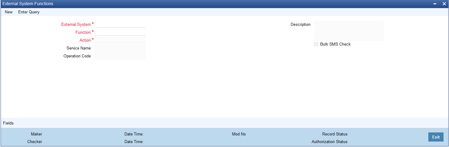

  1. On the Home page, enter GWDETFUN in the text field and then click the next arrow.
    The External System Functions screen is displayed.
    Figure 1-2 External System Functions
    Description of Figure 1-2 follows
    Description of "Figure 1-2 External System Functions"
  2. On the External System Functions screen, specify the fields.
