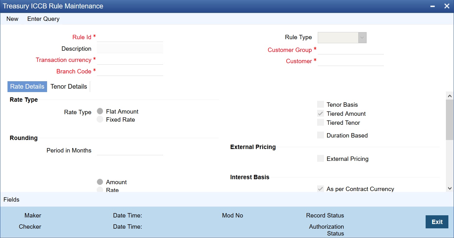

  1. On the Homepage, enter CFDTRRLM in the text field and then click the next arrow.
    The Treasury ICCB Rule Maintenance screen is displayed.
    Figure 1-2 Treasury ICCB Rule Availability Maintenance
    Description of Figure 1-2 follows
    Description of "Figure 1-2 Treasury ICCB Rule Availability Maintenance"
  2. On the Treasury ICCB Rule Maintenance screen, specify the fields.
    For field details and description, refer to the below table.
