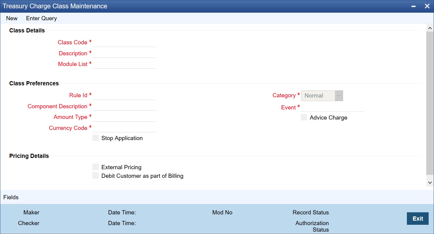

You have to define a charge class for transactions in FX modules using the ‘Charge Class Maintenance’ screen, invoked from the Application Browser.
  1. On the Homepage, enter CFDTROCH in the text field and then click the next arrow.
    The Treasury Charge Class Maintenance screen is displayed.
    Figure 1-7 Treasury Charge Class Maintenance
    Description of Figure 1-7 follows
    Description of "Figure 1-7 Treasury Charge Class Maintenance"
  2. On the Treasury Charge Class Maintenance screen, specify the fields.
    For field details and description, refer to the below table.
    Table 1-7 Treasury Charge Class Maintenance - Field Description
    Field Description
    Class Code
    Specify a unique code to identify the class.
    Description
    Specify a brief description for the class.
    Module List
    Specify the module to which the class should be applicable. The adjoining option list displays all module codes available in the system. You can choose the appropriate one.
    Class Preferences Specify the Class Preferences details.
    Rule ID
    Specify the rule that should be linked to the class. The adjoining option list displays all valid rules maintained in the system. You can choose the appropriate one.
    Component Description
    Define a component here for the rule. Based on this component, six corresponding accounting roles will be generated by the system.
    Amount Type
    Specify the basis amount type for collection of charge. The adjoining option list displays all valid basis amount types available in the system. You can choose the appropriate one.
    Currency Code
    Specify the currency for collection of the charge. The adjoining option list displays all valid currency codes maintained in the system. You can choose the appropriate one.
    Stop Application
    Check this box to indicate that collection should stop for the charge component.
    Category
    Select Normal as the category of the basis amount on which charge should be collected.
    The available options are:
    • Normal
    • Outstanding
    • Overdue
    • Expected
    Event
    Specify the event at which collection of the charge should be triggered, The adjoining option list displays all events available in the system for the module specified. You can choose the appropriate one.
    Advice Charge
    Check this box to indicate that charge should be collected for dispatching the customer advice.
    Pricing Details Specify the Pricing Details
    External Pricing
    Check this box to indicate that external charges can be fetched from external pricing and billing engine for contracts created under this product.
    Debit Customer as part of Billing
    Check this box to indicate that the configured charge will be debited from customer account as part of billing feed from external pricing and billing engine.
