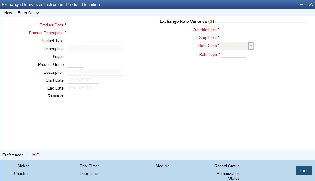

  1. On the Home page, enter EDDPFPRD in the text box, and then click next arrow.
    The Exchange Derivatives Portfolio Product Definition screen is displayed.
    Figure 5-1 Exchange Derivatives Portfolio Product Definition
    Description of Figure 5-1 follows
    Description of "Figure 5-1 Exchange Derivatives Portfolio Product Definition"
  2. On the Instrument Definition screen, click New.
  3. On Instrument Definition screen, specify the following Instrument Details, and then click Enter Query.
    For more information on the fields, refer to the below Field Description table.
    Table 5-1 Instrument Definition - Field Description
    Field Description
    Product Code and Product Description
    You can identify a product that you maintain with a unique Product Code, and a brief description.
    In the Product Code field, you must assign the product a unique code (which is unique across all the modules of Oracle Banking Treasury Management). This code helps in identifying the product. You can briefly describe a product that you create in the Description field.
    Product Module
    The services that you offer in a module will be specific to the module. For example, a portfolio maintenance scheme is specific to the ETD (Portfolio) module. To view the module in which you are creating a product in the Product Module field.
    Product Type
    The first attribute that you define for a portfolio product is its type. You can broadly classify portfolio products into two types:
    • Customer Portfolio (C) – the definition and maintenance of customer portfolio products help you manage your customer’s trades and investments.
    • Own Portfolio (O) – the definition and maintenance of Own portfolio products help you manage your banks own trades and investments.
    Under each type you can create multiple portfolio products.
    Product Slogan
    Type a slogan for the product that you are creating. In the Slogan field enter a slogan that suitably announces the product to your customers.
    If you are creating your own portfolio, you can identify it with an appropriate slogan for your bank’s internal reference purposes.
    Product Group
    Grouping products according to the common features they share, helps you organize information relating to the services you provide. This helps you retrieve information easily.
    You can invoke a list of all the product groups that you have maintained in your bank. Choose the product group to which the product you are creating belongs.
    Product Start Date and End Date
    When you create a product, you must also specify a date from which it can be offered. You may also specify the date up to which you would like to offer the product. Enter these dates in the Start Date and End Date fields.
    You cannot offer a product beyond the specified end date. If you do not specify an end date for a product, you can offer it for an indefinite period.
    Remarks
    If you want to enter any remarks regarding the product, do so in the Remarks field.

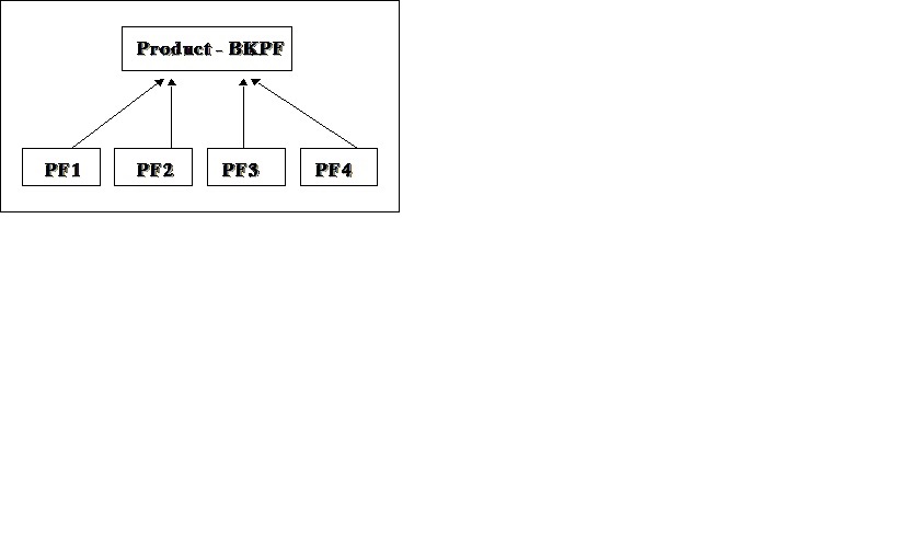

    Let us assume that your bank has maintained a portfolio product titled BKPF. Since a product can have multiple portfolios, you have maintained several portfolios within BKPF. Each of these portfolios will cater to specific instrument types.
    Figure 5-2 Portfolio Product – Portfolio Relationship Diagram
    The portfolio PF1 is meant for deals involving Currency and Index Options
    As per the preferential hierarchy method, the role to head mappings specified for this product is as follows:

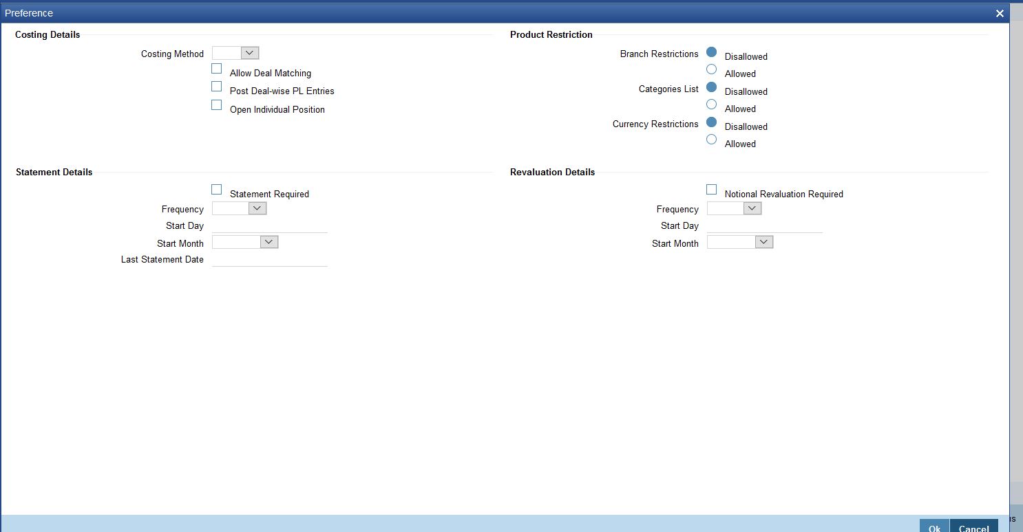

  8. On the Exchange Derivatives Portfolio Product Definition screen, click the Preferences tab.
    The Preferences screen is displayed.
    Table 5-14 Preferences - Field Description
    Field Description
    Costing Method
    costing method is used to determine your holding cost in a portfolio. Based on the preference of your bank you can select an option from the option list: The costing methods are as given below:
    • Weighted Average Cost (WAC)
    • Last in first out (LIFO)
    • First in first out (FIFO)
    • Deal matching (DMAT)
    In Oracle Banking Treasury Management profit and loss calculations are maintained only for the bank’s own portfolio. Therefore, you can specify this preference only while setting up your own portfolios.
    Allow Deal Matching
    Select this box to indicate that intra-day manual matching should be allowed, even though the costing method selected is FIFO or LIFO.
    This check box is enabled only when costing method selected is ‘FIFO/LIFO’. For any other costing method, this is disabled.
    Open Individual Position
    Select this box to indicate that accounting entries for opening and closing of positions should be posted individually for each deal, when the costing method is DMAT.
    This checkbox is enabled only when costing method selected is ‘DMAT’. For any other costing method, this is disabled.
    Post Deal -wise PL Entries
    Select this box to indicate that accounting entries for realized PL should be posted individually for each pair of deals matched, when the costing method is FIFO, LIFO or DMAT.
    This checkbox is enabled only when costing method selected is ‘FIFO/LIFO/DMAT’.
