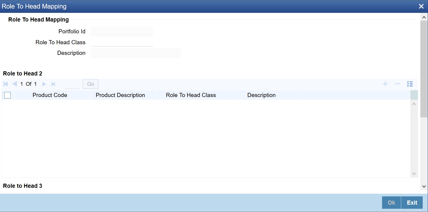

- On the Portfolio Definition Maintenance screen, click the Role to Head tab.
The Role to Head Mapping screen is displayed.
In the Portfolio Role to Head Mapping screen, you can link accounting Role to Head mapping classes with any of the following:
- Portfolio and an Instrument ID
- Portfolio and an Instrument Product
- Portfolio ID
For a detailed procedure on:
- How to map Accounting Roles to Account Heads, or
- How to link an accounting class with any of the three levels.
Refer to the Common Procedures User Manual of Oracle Banking Treasury Management.

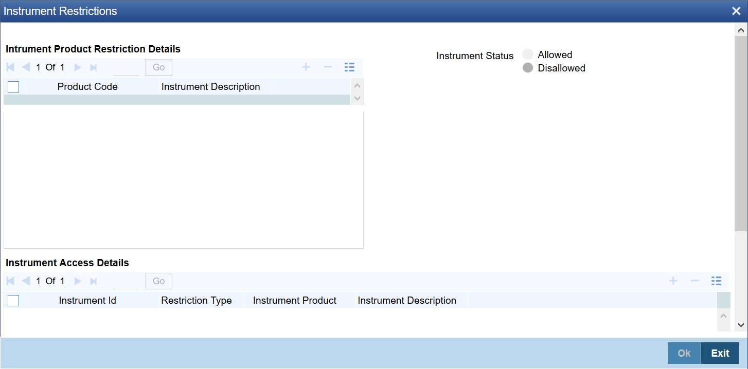

- On Portfolio Definition Maintenance screen, click the Instrument Restrictions tab.
The Instrument Restrictions screen is displayed.
In this screen, you can identify the Instruments or Instrument Products the portfolio can trade in. As a result, the portfolio will not be allowed to trade in those instruments/instrument products that you restrict in this screen.
You can establish certain controls over the instruments and instrument products that a portfolio can trade in. You can achieve these controls by specifying restrictions through the Instrument Restrictions screen.
For a detailed procedure on how to restrict specific instruments or instrument products refer to the Common Procedures manual of Oracle Banking Treasury Management.

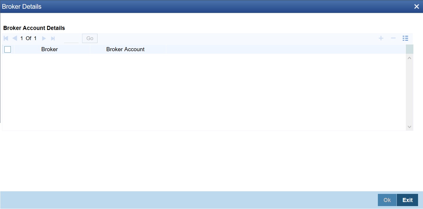

- On the Portfolio Definition Maintenance screen, click the Broker tab.
The Broker Details screen is displayed.
Annexure A lists all the possible accounting entries for your banks and customer portfolios.
Through the Portfolio Broker Account Linkage screen you can:
- Identify the brokers that are to be associated with the portfolio.
- Identify broker accounts and map them to relevant Broker codes.
