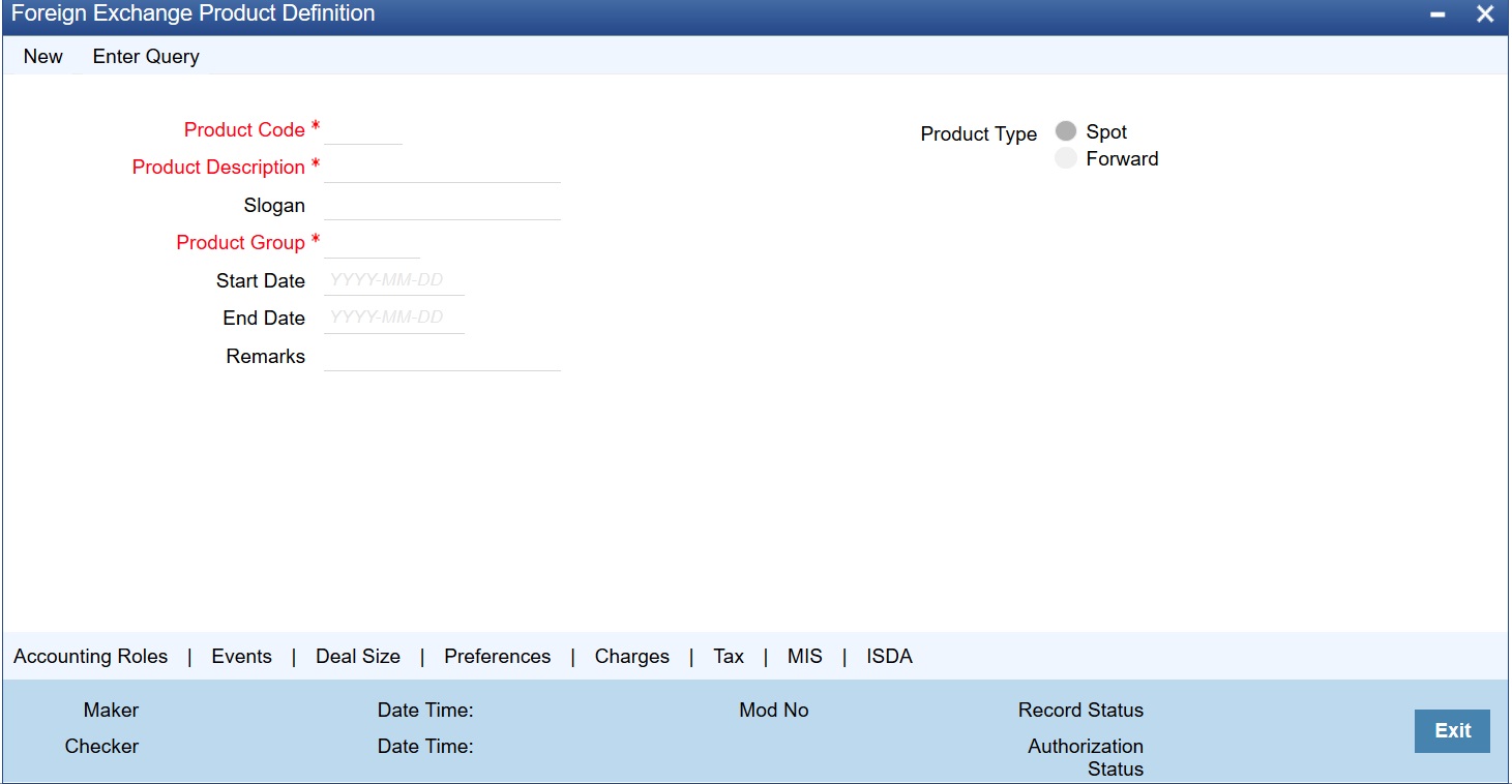

3.2.1 FX Product Definition
You can create FX products using the Foreign Exchange Product Definition screen.
  1. On the Home page, type FXDPRMNT in the text box, and click next arrow.
    The Foreign Exchange Product Definition screen is displayed.
    Figure 3-1 Foreign Exchange Product Definition
    Description of Figure 3-1 follows
    Description of "Figure 3-1 Foreign Exchange Product Definition"
  2. On the Foreign Exchange Product Definition screen, Enter basic information relating to a foreign exchange product such as the Product Code, Product Description, etc based on the requirement.

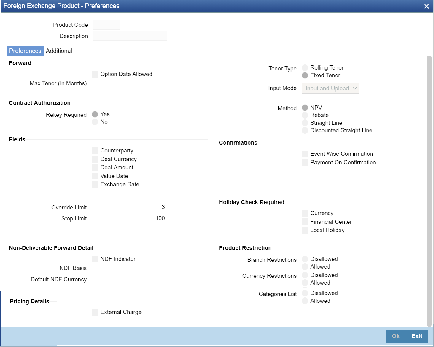

  3. On the Foreign Exchange Product Definition screen, click Preferences to display the preference screen.
    The Foreign Exchange Product - Preferences screen is displayed.
    Figure 3-2 Foreign Exchange Product - Preferences
    Description of fxdprmnt_preferences.png follows
  4. On the Foreign Exchange Product Preferences screen, specify the preferences for a product as required.
