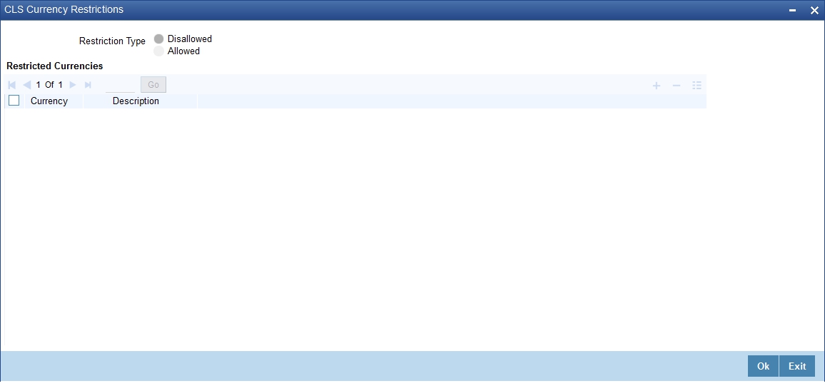

    CLS Currency Restrictions screen is displayed.
    Figure 6-2 CLS Currency Restrictions
    Description of stdcif__cvs_cls.jpg follows
    All the currencies that are allowed for CLS trading will be listed as available currencies. You may define a list of allowed or disallowed CLS currencies for a specific customer. By default, every customer who is a ‘CLS Participant’ will be allowed to trade in all the available CLS currencies unless specifically mentioned. Only if the customer is allowed to transact in a CLS currency, the particular deal will be eligible for CLS trading.
