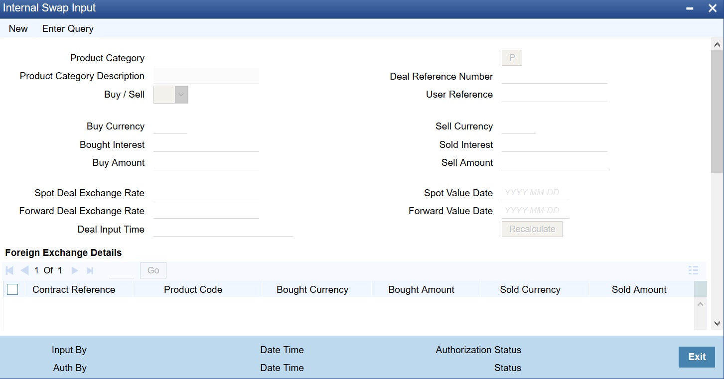

Internal Swap Input screen is displayed.
Figure 5-28 Internal Swap Input
Description of the illustration fxdswpin__cvs_main.jpg - Click New on the Internal Swap Input screen and specify the details as required. Click Save to save the details, or click Cancel.
For information on fields, refer to xref.

The screen will also display the individual transactions created in detail blocks upon authorization of the internal swap input transaction. Three FX transactions created will be created within a single block and two MM transactions will be created in the other.
Deal Input time
This field captures the deal execution time at the time of deal booking received from front office.
Format: YYYY-MM-DD HH:MM:SS:SSS (Default).
Here SSS is milliseconds.
The above format can be changed in the user setting option based on requirement.
System throws an error when you give the wrong date or time format on modification.
The information displayed for the FX transactions will be as follows:
- FX Contract Reference Number
- Product Code
- Bought Currency
- Bought Amount
- Sold Currency
- Sold Amount
- Value Date
- Exchange Rate
The information displayed for the MM transactions will be as follows:
- MM Contract Reference Number
- Product Code
- Currency
- Amount
- Value Date
- Maturity date
- Interest Rate
