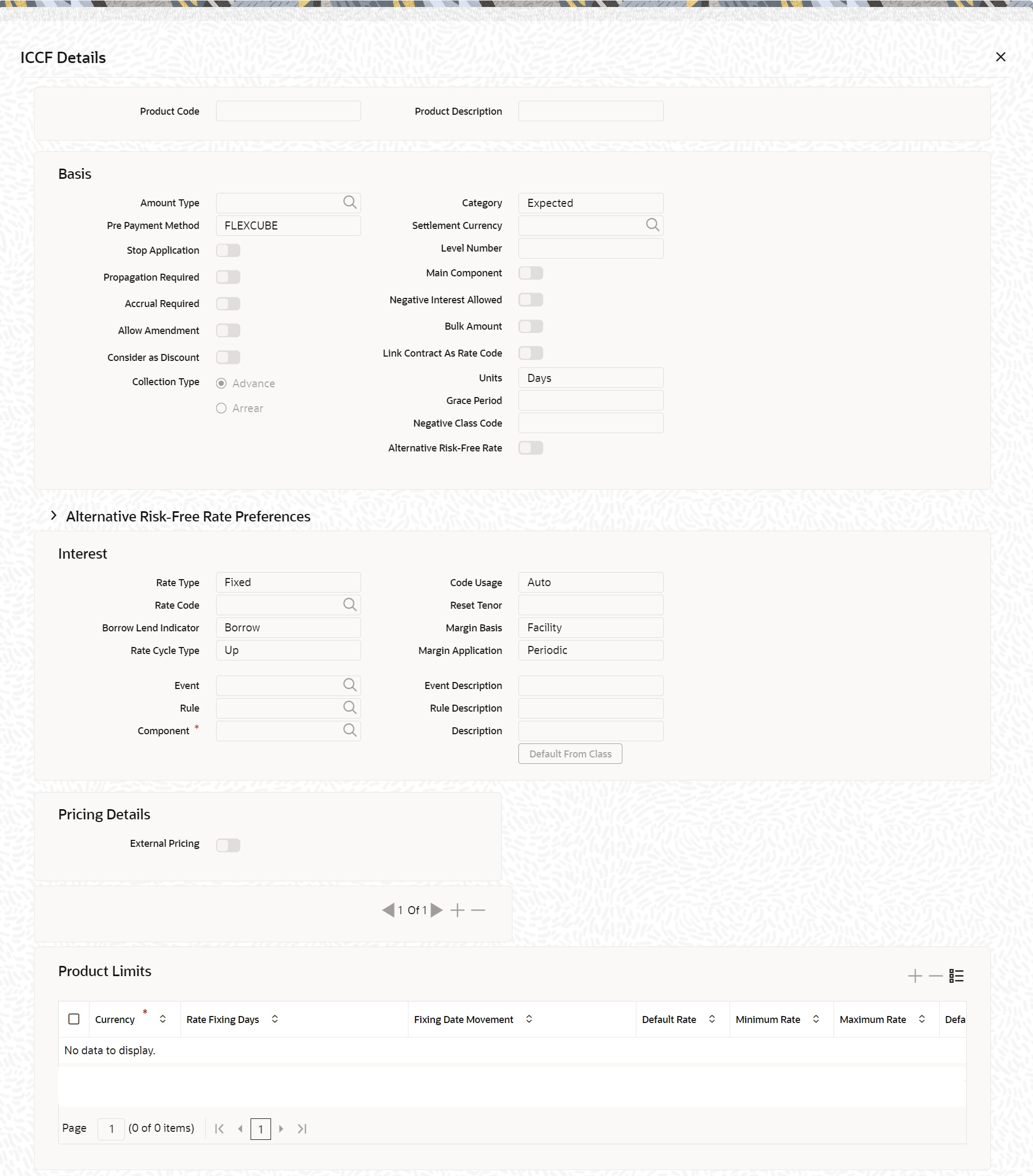

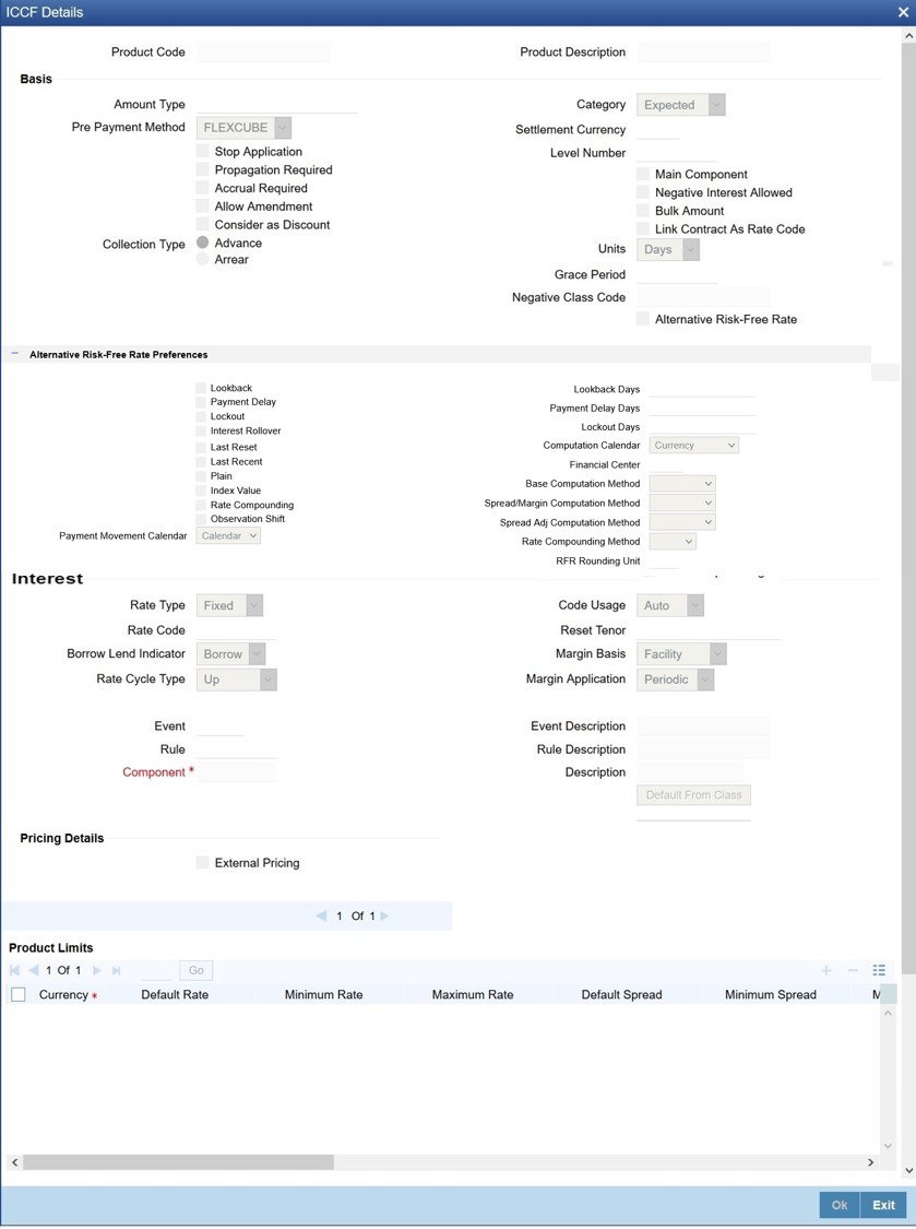

- Click Interest in the Product Definition screen.The ICCF Details screen is displayed.
- In the ICCF Details screen, specify the fields.The system dynamically adds a list of suffixes to the main interest component. Each of these suffixes stand for:Table 1-14 Suffix and Description Suffix Represents AQR Acquired interest receivable AQP Acquired interest payable REC Receivable EXP Expense INC Income PAY Payable RIA Received in Advance PIA Paid in Advance ADJ Adjustment A similar list of accounting roles will be built up for each component that you associate with the product.For detailed explanation on the fields, refer to the below table.Note: Note Since you need to identify Accounting Roles (GL/SL Types) and map them to Account Heads (Actual GL/SLs) to post accounting entries for specific events, you will have to choose the appropriate accounting roles for each component and map them to corresponding Account Heads.Table 1-15 ICCF - Field Description Field Description Amount Type Specify the basis on which interest has to be calculated. By default, the principal will be taken as the basis. Pre Payment Method The prepayment method identifies the computation of the prepayment penalty for the contract. Stop Application Select this check box to stop application. The attributes defined for a product will be automatically applied to all contracts involving the product. If, for some reason, the user want to stop applying the Interest Rule defined for the product on contracts that are to be initiated in the future (involving the product), the user could do so through the Product ‘ICCB Details’ screen. In effect, stopping the application of a component for a product would be equivalent to deleting the component from the product. By specifying that the application of the component must be stopped, the user has the advantage of using the definition made for the component again, by making it applicable. Propagation Required Select this check box if the propagation is required. If the interest amount collected from the borrower must be passed on to participants of the contract, check the 'Propagation Required' check box. Accrual Required Select this check box if the accrual is required. Allow Amendment A change to a contract (after it has been authorized) that involves a change in its financial details constitutes an Amendment on the contract. The user can indicate whether such an Amendment, called a Value Dated Change, must be allowed for the interest component being defined. The user can amend the following through this function: - Interest rate
