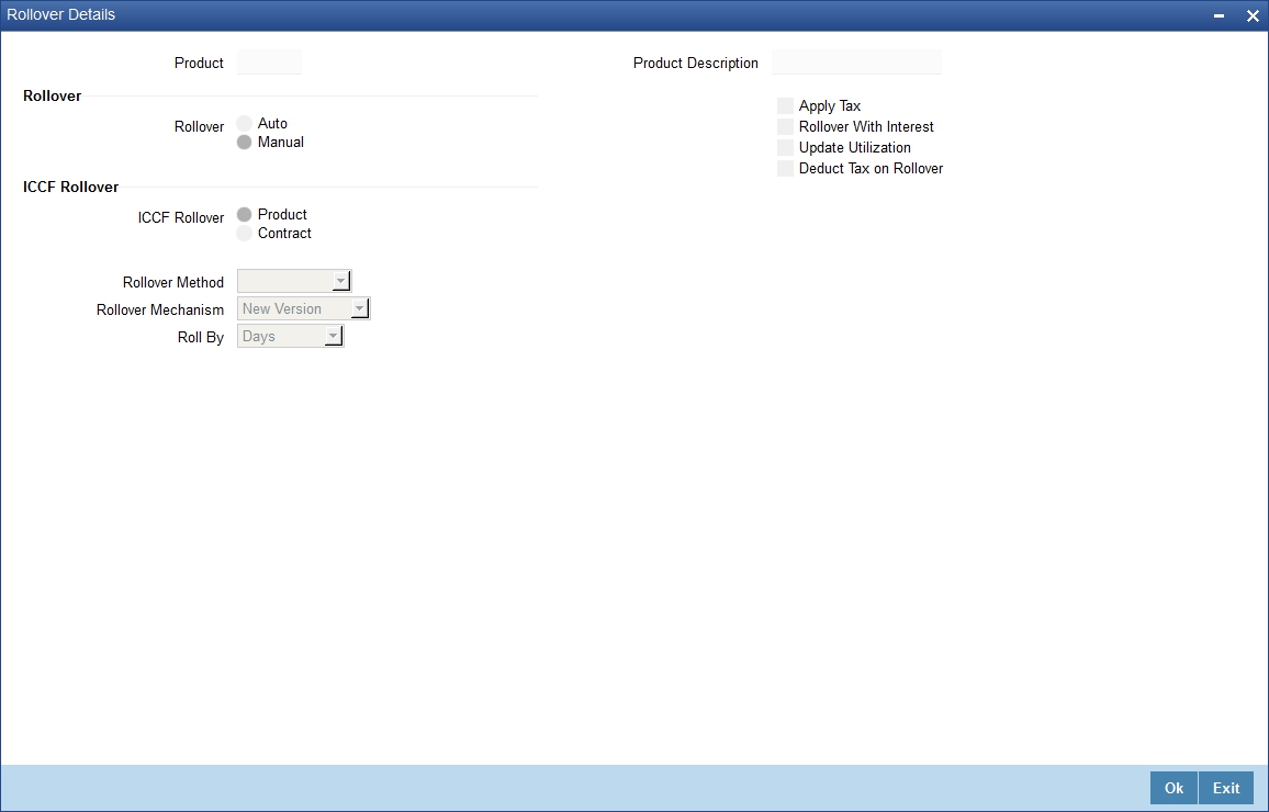

6.2 Rollover Details
This topic provides the instructions to capture the Rollover Details.
  1. On the Product Preferences screen, click Rollover.
    Rollover details screen is displayed.
  2. On the Rollover details screen, specify the details as required.
  3. Click Ok to save the details or click Exit to close the screen.
    For information on the fields, refer to the below table.
    Table 6-1 Rollover details - Field Description
    Field Description
    Mode of Rollover
    For deals involving a product for which a rollover is allowed, you should specify the mode of rollover - automatic or manual - during processing.
    A deal is automatically rollover on the maturity date if ‘Auto’ is selected at the product level.
    If you choose ‘Manual’, on the maturity of a deal, you will need to indicate for rollover manually.
    ICCB Rollover
    The Profit, charge and fee components of the new (rolled over) deal is picked up either from the old deal or from the product involving the old deal.
    Choose the option:
    • Product if you want the system to pick up the components from the product involving the old deal.
    • Contract if you want the system to pick up the components from the old deal.

    In addition, you have to specify the following details for a product for which rollovers are permitted:
    Update Utilization
    Whether the credit limit utilization is to be updated when a placement is rolled over, that is, the profit that has been accrued on placement is also considered as a part of the ‘utilized amount’ for the purpose of risk tracking. The following example illustrates how this concept works.
    This option applies only if you want to roll over a deal with Profit.
    Apply Tax
    For tax to be applicable on a rolled over deal:
    • It should be applicable to the product involving the deal should not have been waived for the old deal
    You should indicate whether tax has to be applied on the rolled over deal.
    Rollover with Profit
    You have to specify whether the deal that you are rolling over should be rolled over along with the outstanding profit. If you so specify, the principal of the new deal is the sum of the outstanding principal and the outstanding profit on the old deal. This applies only to deals with a bearing (add-on) method of profit liquidation.
    If all the outstanding profit is paid out, then the deal is renewed without the profit. If not, it is rolled over with the profit that is still outstanding on it.
    A deal is rolled over with only the main profit that is outstanding. The main profit is that profit component which you specify as the ‘main profit’ in the ICCB Product Details screen (this is displayed in the Contract Main screen). Other profit components and the penalty profit if any will not be rolled over.

    Roll By
    Indicate the tenor basis upon which the maturity days specified for the rolled-over contract is reckoned. The options are Days, Months, Quarters, Semi-annuals and Years.
    If you specify the ‘days’ maturity basis, and do not specify the maturity days, the system ‘rounds’ the tenor of the original contract to the nearest maturity days basis. The rounded tenor is considered as the new tenor of the rolled-over contract.
    Rollover Mechanism
    This indicates whether rolling over a contract using the product must create a new version of the existing contract, a new contract or a chills contract that is linked to the parent contract. You can choose from the following options:
    • New Version - A new version will get created in existing MM deal as part of a rollover, with the same details specified in the contract ‘Rollover Details’ screen.
    • Spawn Contract - In this mechanism, the existing contract will get liquidated, and the system will book a new contract as part of a rollover, with the details specified in the contract ‘Rollover Details’ screen. Booking of the new contract happens through the MMAUTDLY batch.
    • Linked Contract - In this mechanism, a new MM deal is created manually and linked to the parent deal. On the maturity date of the parent contract, the contract will get liquidated into a rollover wash GL, and the new contract that was input will get initiated automatically.
    You can select ‘Linked Contract’ only in case you have checked the option ‘Auto’ for rollover.
    Rollover Method
    If you have indicated the rollover mechanism applicable for contracts using the product in the Rollover Mechanism field as ‘Spawn Contract’, use this field to indicate whether a single new contract must be created for the rolled over amount, or whether the original contract must be split into multiple contracts, or consolidated with other contracts into a single new contract, when rolled over using the rollover operation. Accordingly, select any of the options, ‘Normal’, ‘Split’ or ‘Consolidated’, in this field, as applicable.
