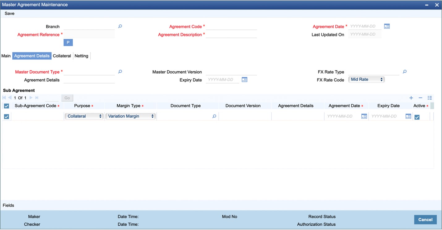

2.8.3 Agreement Details
User can define the details of the agreement including document type and expiry.
  • Details about the linked sub-agreements can be captured.
Click the Agreement Details tab in the Treasury Master Agreement Maintenance screen to open this screen.
Figure 2-21 Master Agreement Maintenance - Agreement Details
Description of Figure 2-21 follows
Description of "Figure 2-21 Master Agreement Maintenance - Agreement Details "
The following table describes the fields captured for agreement details.
* indicates mandatory fields.
