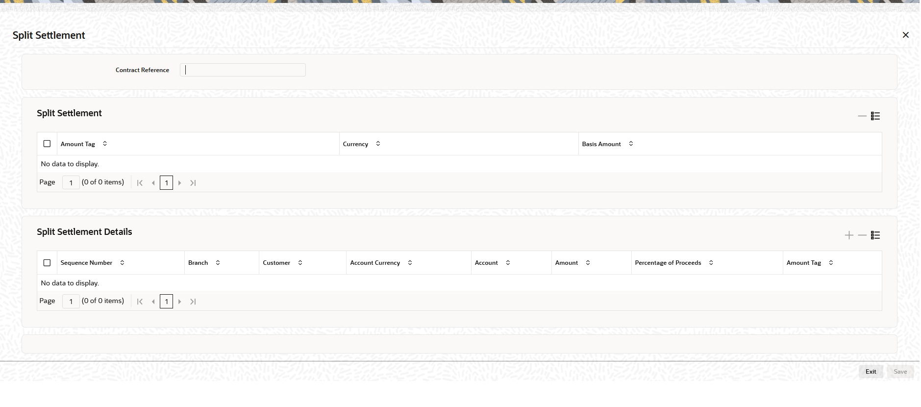

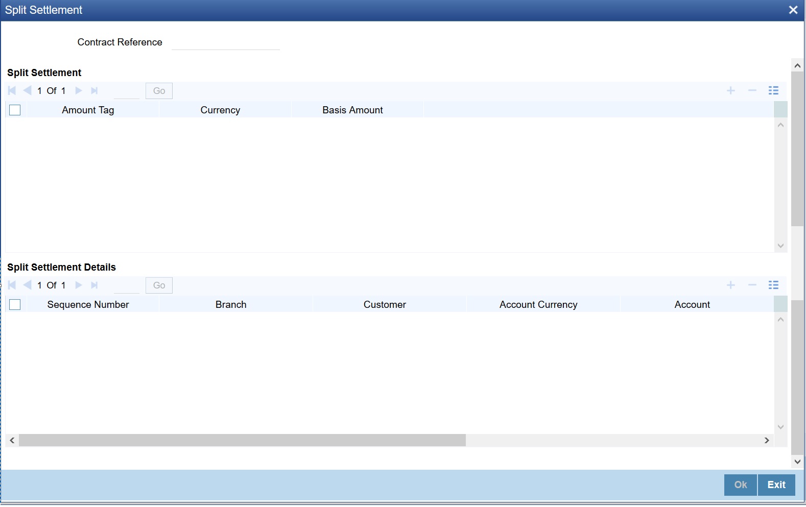

- On the Money Market Contract Input screen, click
Split.
Split Settlement screen is displayed.

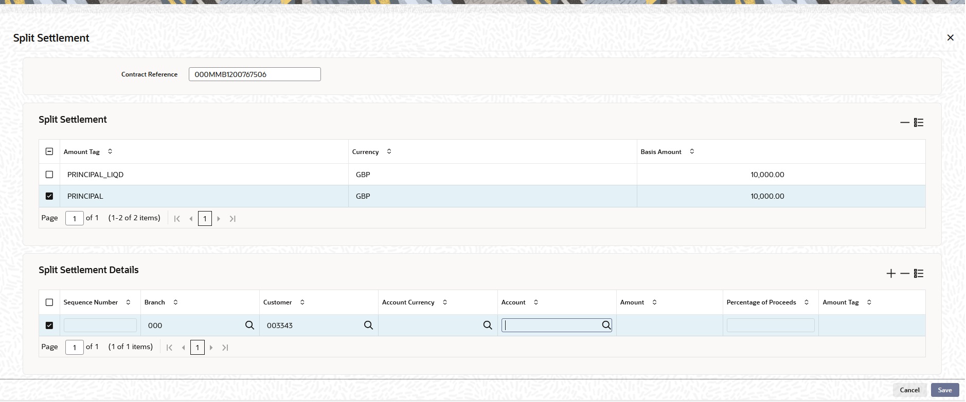

- From the displayed list, select a contract.

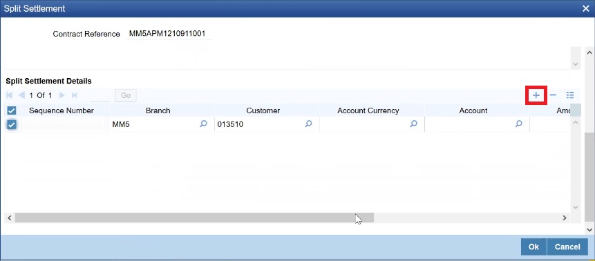

- On the Split Settlement screen, under the Split Settlement Details, click the Plus symbol.
A new row is added under Split Settlement Details as shown in below.
Figure 3-12 Split Settlement with a new row added
Description of "Figure 3-12 Split Settlement with a new row added"Note:
This process of splitting the settlements for a contract is allowed on the principal, Interest (Anticipated Interest for new contracts), and charges.
- Choose the Account Currency, Account, and other necessary details, to create a
split.
