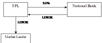

Since the market rate is higher than the strike rate (9.5%), TPL exercises the swaption. Simultaneously, it borrows 50,000,000 USD from the market with six-monthly interest payment at LIBOR.
Figure B-1 Flow Diagram
The resultant swap after exercise of the swaption, along with the impact of the market borrowing, is diagrammatically shown as follows:
