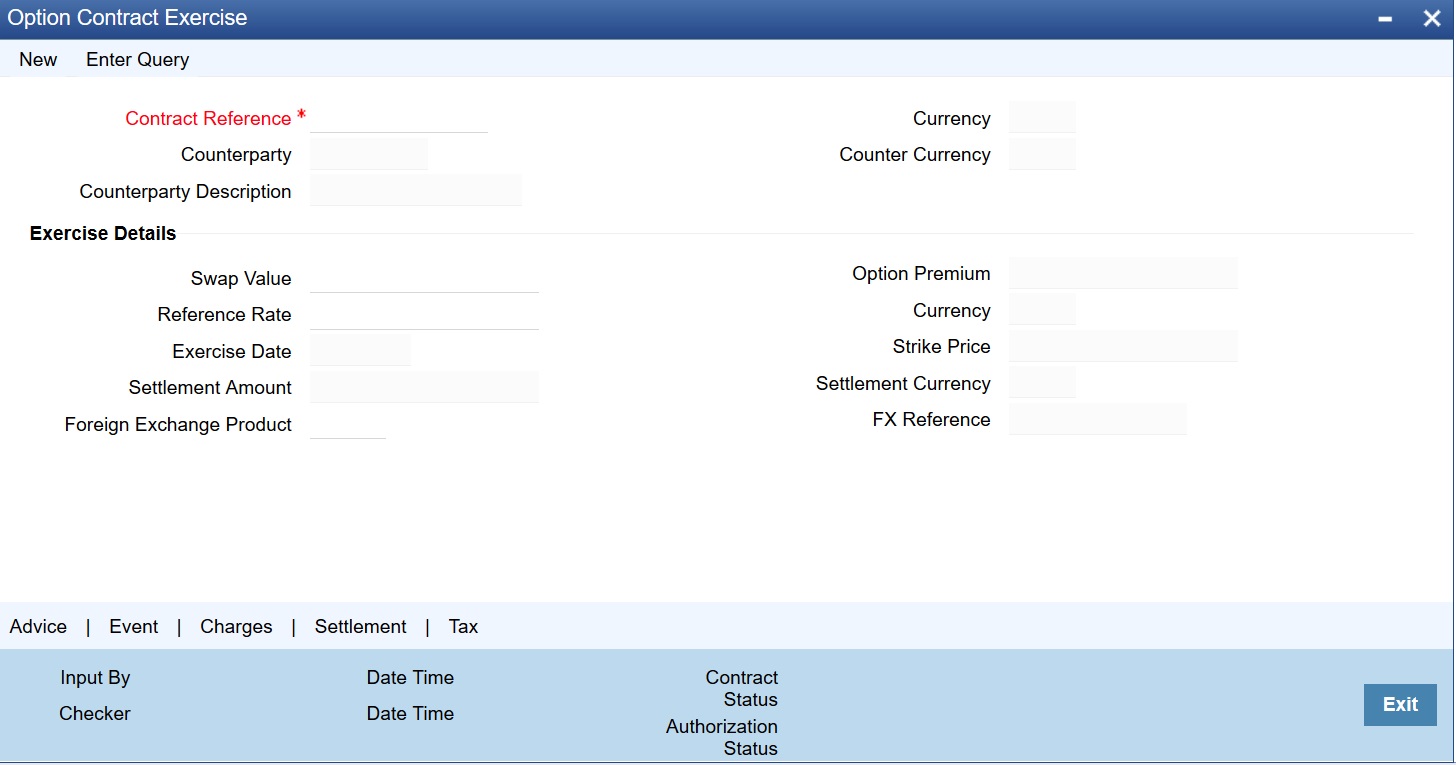

  1. On Home page, type OTDXCXER in the text box, and then click next arrow.
    The Option Contract Exercise screen is displayed.
    Figure 4-25 Option Contract Exercise
    Description of Figure 4-25 follows
    Description of "Figure 4-25 Option Contract Exercise"
  2. On the OT Contract Termination screen, click New and specify the fields.
    For more information on the fields, refer to the below Field Description table.

    Contract Reference Number Specify the contract reference number .
    Settlement Date The settlement date is the date when you enter the application for manual exercise of the contract. This is populated automatically by the system.
    Reference Rate The reference rate is also automatically picked up by the system based on your specifications for the contract. You can modify it. This is used for calculating the settlement amount.
    Swap Value For swaption trade deals, you have to enter the swap value. This field is disabled for other types of options.
    FX Product Code For external currency option contract, the FX contract is separately uploaded with Oracle Banking Treasury Management reference number. While uploading the contract, the validation is done between maturity date of currency option contract and value date of FX contract.
    During EOTI process, the system will run a validation to check whether the creation of DV contract is pending for any IRO contract with its Swaption style as External.
    Key details pertaining to the option – counterparty, contract currency, premium, premium currency, counter currency and strike rate – are automatically populated by the system.
    A foreign exchange spot contract is created by the system on the exercise of physically settled currency options. For such contracts, the FX spot product under which the FX contract is to be created has to be specified. This is defaulted from your specifications at the product level. For such contracts, the contract reference number of the uploaded FX product is also displayed on the screen.
