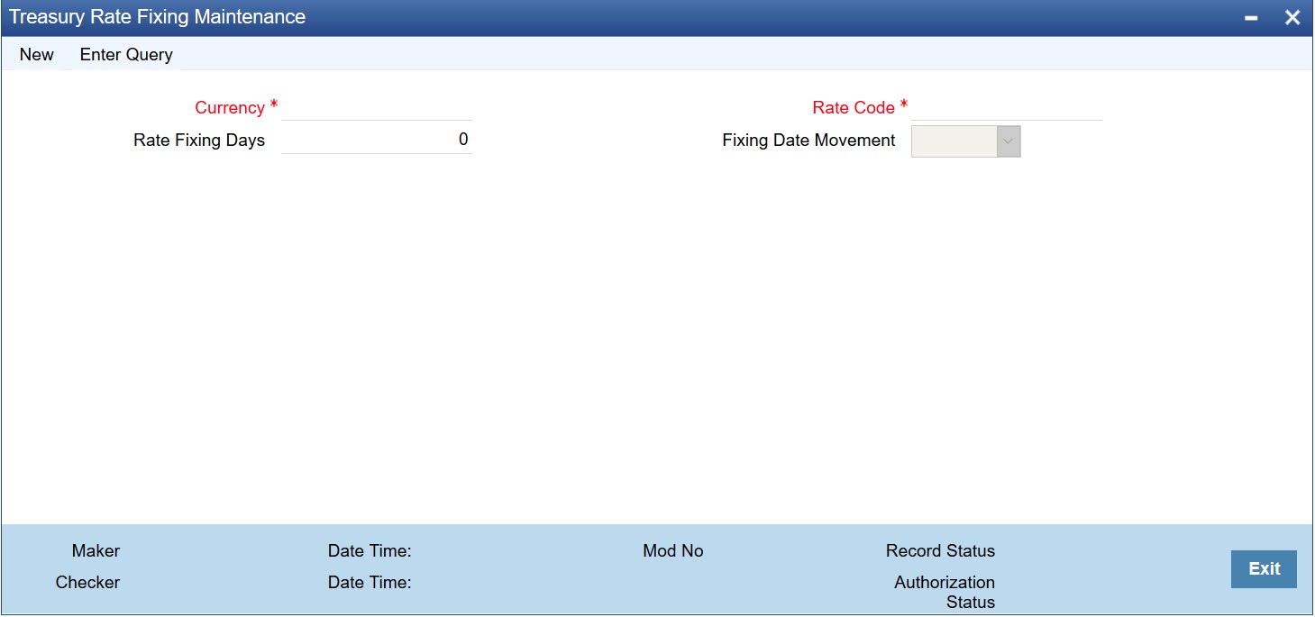

  1. On the Home page, type TRDRTFXD in the text box, and click the next arrow.
    The Treasury Rate Fixing Maintenance screen is displayed.
    Figure 4-29 Treasury Rate Fixing Maintenance
    Description of trdrtfxd_cvs_main.jpg follows
  2. On the Treasury Rate Fixing Maintenance screen, Specify the details as required.
    The system allows the Manual Rate fixing through interface/web service. The Event RTFX is triggered on authorization of rate fixing. Fields 32H and 37((G,R, and M) for payment messages) will have the updated values in MT362(Interest Rate Reset/Advice of Payment.
