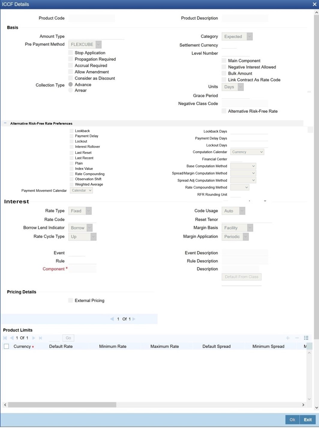

1.2.3 ICCF Details
Use ICCF Details screen to calculate the interest that applies on a contract.
Calculating the interest component for a contract is achieved by:
  • Creating interest rules
  • Building interest classes (specifically, for the Securities module)
  • Associating a product with an interest rule (or an interest class in case of the Securities module). This rule applies on all contracts processed under the product.
  • Amending, if required, certain interest details that a contract acquires from the product under which it is processed
  1. Click the Interest button in the Product Definition screen to invoke the ICCF Details screen.
    The system displays the ICCF Details screen.
  2. In the ICCF Details screen, specify the fields.
    In this screen, you can associate the product you are creating with an Interest Rule. The attributes defined for the interest rule or class that you link to a product default to all contracts processed under the product.
    For products created in certain modules of Oracle Banking Treasury Management, you may have to specify additional interest details. These details have to be specified in the Product Preferences screen of the module.
    For detailed explanation on the fields, refer to the below table.
    Table 1-2 ICCF Details- Field Description
