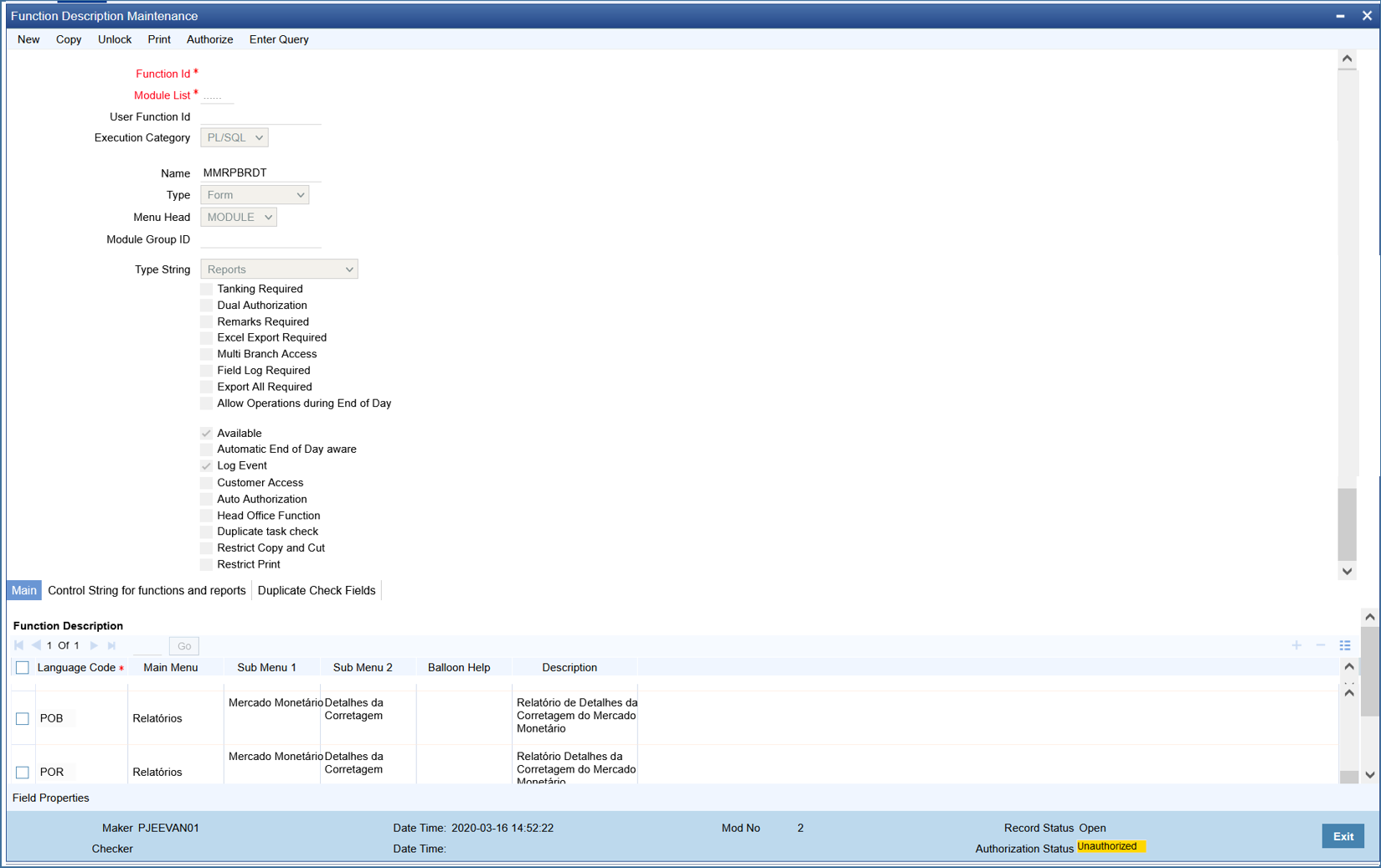

- On the Home page, enter SMDFNDSC in the text field, and click the next arrow.
The Function Description Maintenance screen is displayed.
Figure 1-1 Function Description Maintenance
Description of "Figure 1-1 Function Description Maintenance" - In the Function Description Maintenance screen, ensure that Available field is enabled to activate by modifying the record.
We recommend that you modify and authorize the record.

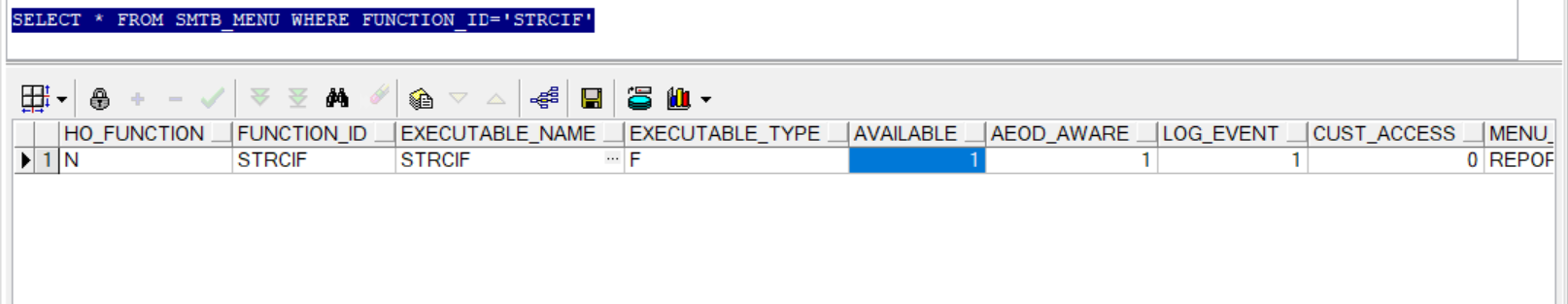

Back End Activation using Menu
Reports can also be activated from back end by updating the static data of SMTB_MENU Available column to ‘1’ for all the reports.

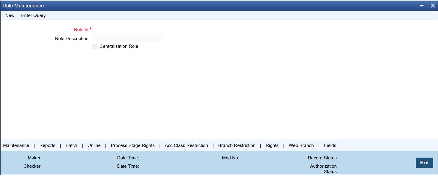

- On the Home page, enter SMDROLDF in the text field, and click the next arrow.
The Role Maintenance screen is displayed

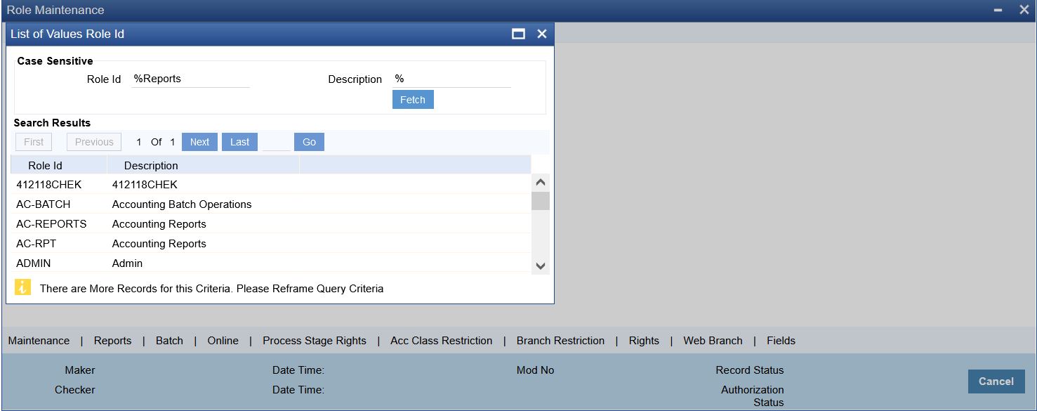

- Click the Search icon to search for the report roles in the displayed list of values.
The List of values Role Id page is displayed.

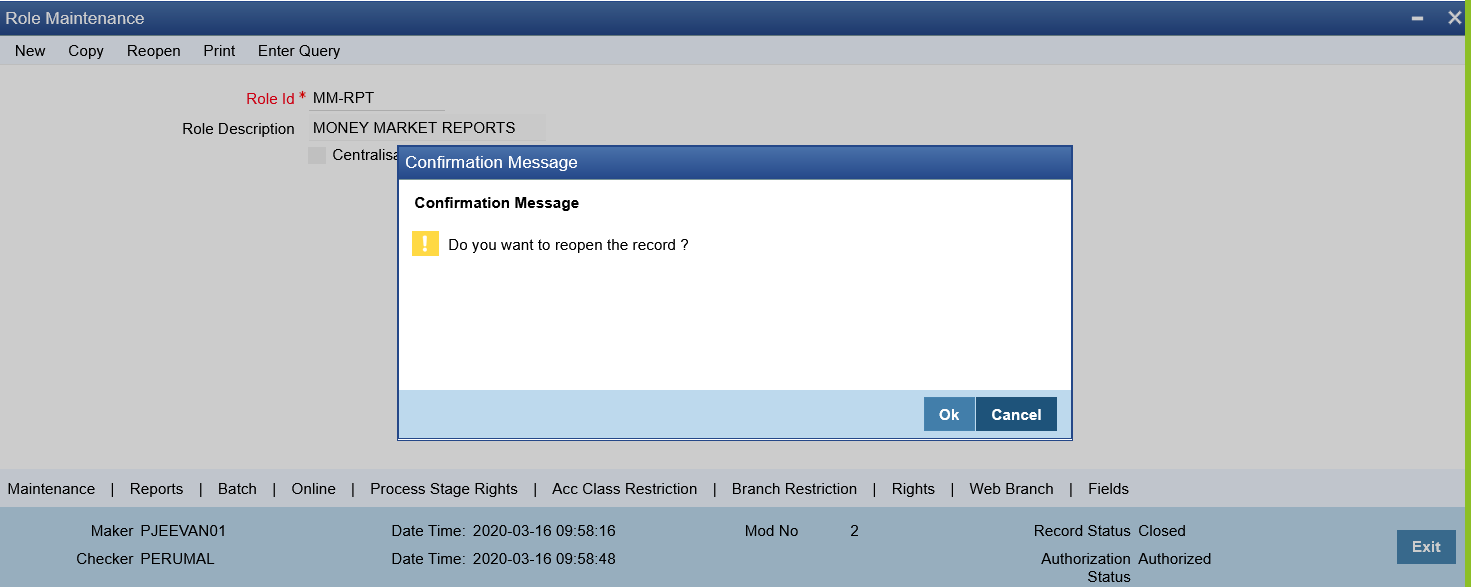

- Initially all the report roles are in ‘closed’ status, click Reopen to reopen the report roles.
The system displays a confirmation message.
Figure 1-5 Role Maintenance - Reopen Confirmation Message
Description of "Figure 1-5 Role Maintenance - Reopen Confirmation Message" - In the displayed Confirmation Message page, click Ok to reopen the Record.

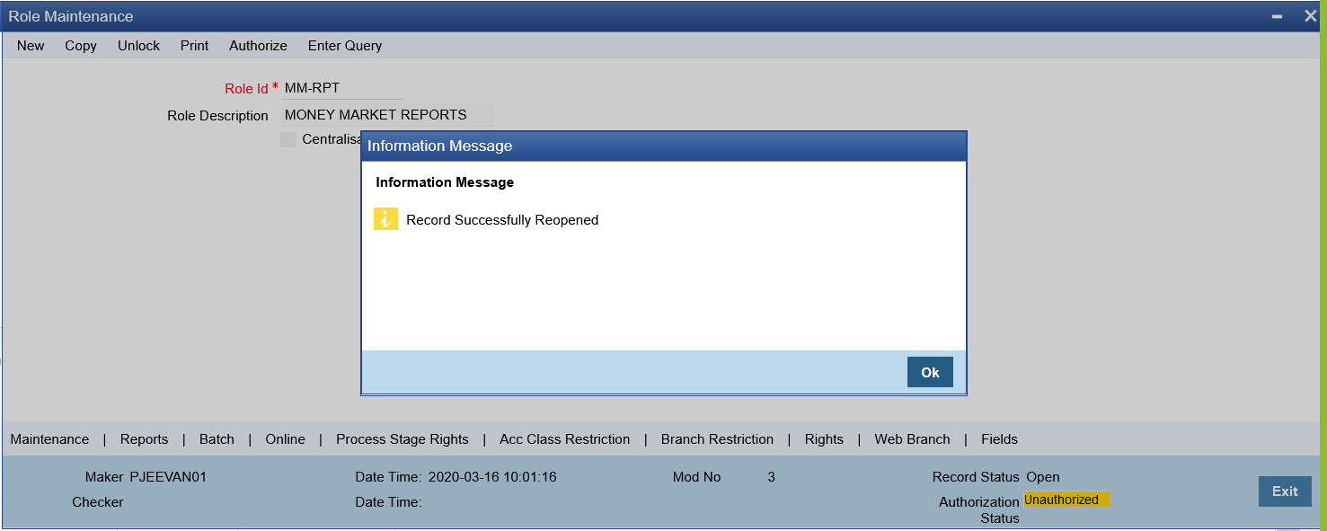

Click Cancel to cancel the record reopening operation.The system displays an Information Message.Figure 1-6 Role Maintenance - Reopen Information Message
Description of "Figure 1-6 Role Maintenance - Reopen Information Message" - In the displayed Information message page, click Ok. The record is reopened successfully.
