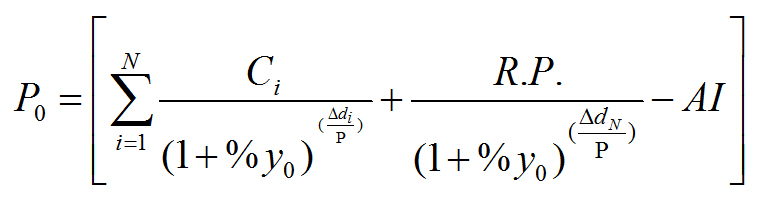

18.3.1 Process Bonds and T-bill based on the YTM parameters
While processing a Bond, if the Price quote is not by ‘Yield to Maturity’, the YTM is computed based on the formula given below:
Where:
- P0 is the Purchase price of the Bond
- N is the Total number of coupons
- Ci is the Coupon payment for coupon i
- y0 is the Periodic YTM
- Y0 is the Annualized YTM
- A is the Day Count Method – Denominator
- n is the Coupons in a Year
- P is the Period of Reinvestment. If Null, defaulted to A/n
- R.P. is the Redemption Price
- AI is the Accrued Interest
- di is the Coupon Date ¡V Value Date
- dN is the Redemption Date – Value Date
