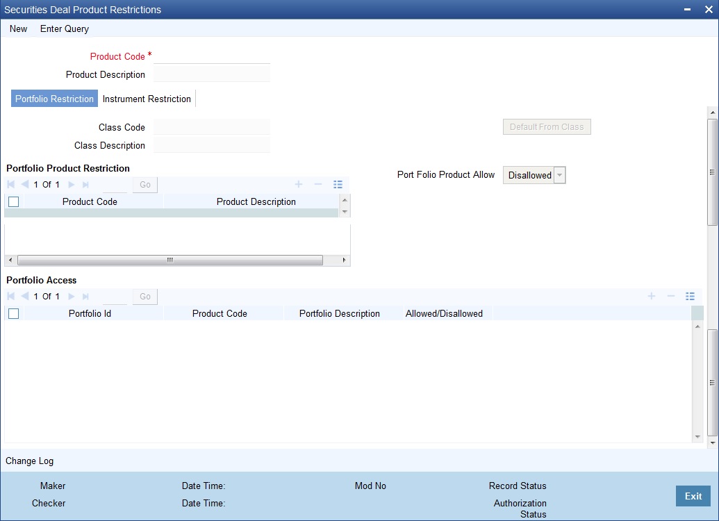

- On the Home page, specify SEDPRDRS in the text box, and click next arrow.
Securities Deal Product Restriction screen is displayed.
Figure 16-2 Securities Deal Product Restriction
Description of the illustration sedprdrs__cvs_main.jpg - On the Securities Deal Product Restriction screen, specify the fields.
For more information on fields, refer to the below table.
Table 16-5 Security Deal Product Restriction - Field Description
Field Description Product Code
Specify the product code. Alternatively, you can select the product code from the list.
Product Restriction
The description will be displayed based on the Product Code selected.
Class Code
In Oracle Banking Treasury Management, each portfolio restriction class that you maintain is identified by a unique ten-character code called a Class Code. You can follow your convention for devising this code, however, one of the characters of the code should necessarily be a letter of the English alphabet.
Class Description
The description will be displayed based on the Class Code selected.
Portfolio Product Restriction
Portfolio product restriction identifies a unique list of allowed or disallowed portfolio products.
Product Code
It represents the list of Security Product Code maintained under Securities Security Product Definition. Click add icon to display the list of Security Product Code through its option list which has been maintained under Securities Security Product Definition. You have to select one which you want to move to Allowed/Disallowed list.
Product Description
Description of Security Product Code that you choose to Allowed/Disallowed list.
Portfolio Id
It is the Internal Security Id for which Security Portfolio has been maintained under Securities Security Portfolio Definition.
Product Code
It is the Security Portfolio Code that has been maintained under Securities Security Portfolio Definition.
Portfolio Description
It is the description of portfolio identification.
Allowed/Disallowed
Specify portfolio restrictions in the form of an allowed, or disallowed list.
Class Code
Class Description
Instrument Product Restriction
Instrument product restriction identifies a unique list of allowed or disallowed security products.
Security Code
It represents the list of Security Product Code maintained under Securities Security Product Definition. Click add the icon to display the list of Security Product Code through its options list which has been maintained under Securities Security Product Definition. You have to select one which you want to move to the Allowed/Disallowed list.
Security Id
It is the Security Id for which Security Product has been maintained.
Product Code
It is the Security Product Code that has been maintained under Securities Security Product Definition.
Security Description
It is the description of Security Identification.
Restriction Type
Parent topic: Securities Deal Product
