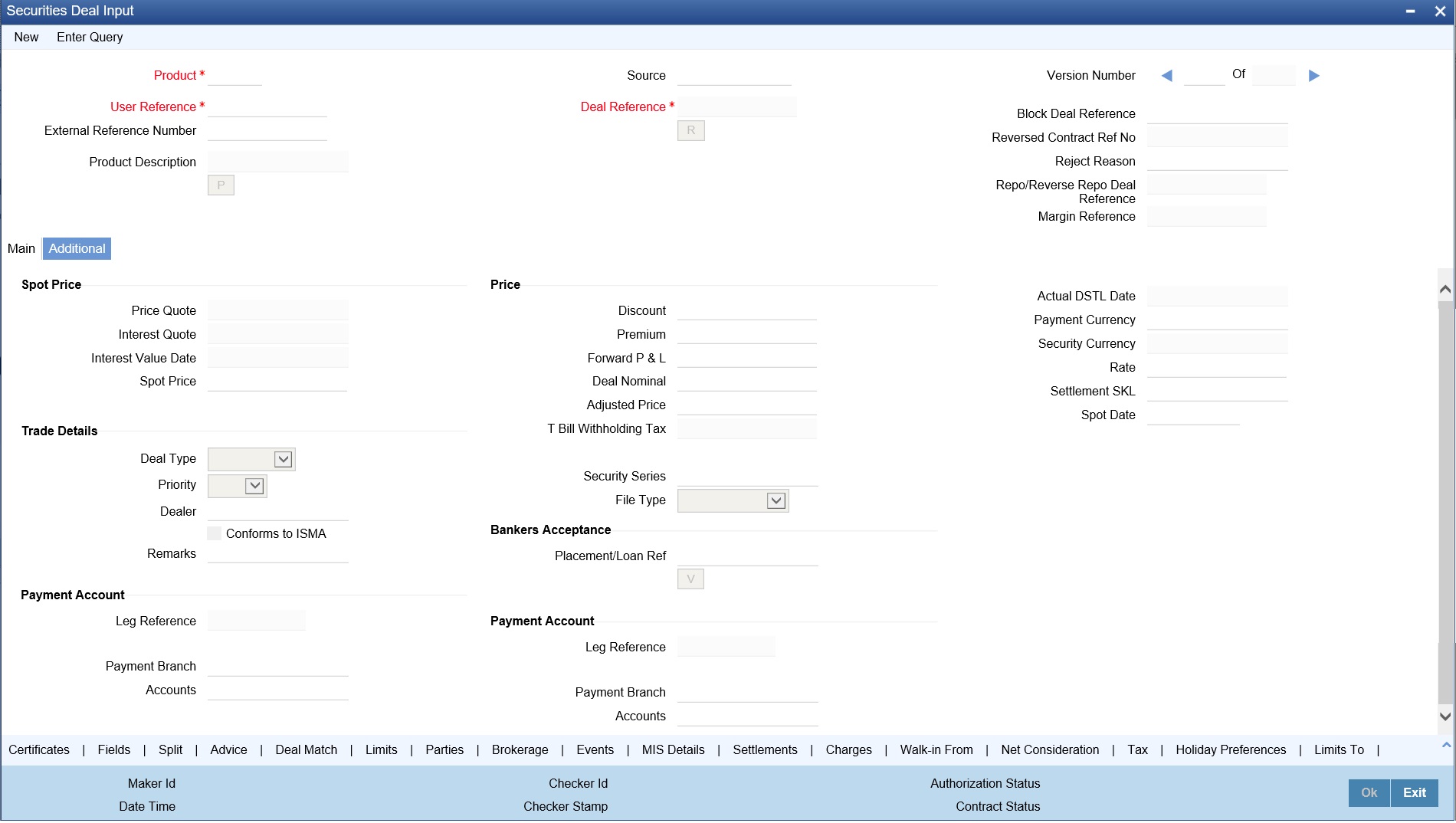

Each field value that needs to be changed will be compared to Set 1 and Set2. Any difference in the field value will trigger a business logic validation. If the validation fails, the system will return a fault message. When a financial amendment is done, the existing contract is reversed and a new contract with the modified value is created. The new contract will contain the reference number of the reversed contract against the field ‘Reversed Contract ref no’.
Figure 21-15 Additional
Description of sedxdlnl__cvs_main__tab_additional.jpg follows
