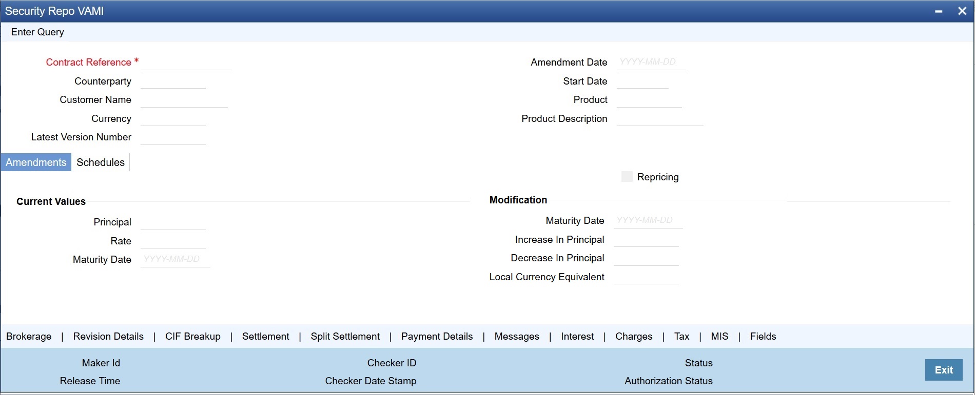

This topic describes how to use Security Repo Vami to capture the Security Repo Vami details.
  1. On Homescreen, specify SRDXVMND in the text box, and click the next arrow.
    Security Repo Vami screen is displayed.
  2. On the Security Repo VAMI screen, specify the details as required.
    For information on fields, see the below table:
    Table 2-65 Security Repo VAMI - Field Description
    Field Description
    Contract Reference
    SR Contract Reference Number or Agreement Reference Number
    Counterparty
    The Counterparty details is displayed.
    Customer Name
    Customer name is displayed.
    Currency
    Contract currency details are displayed.
    Latest Version Number
    Contract version number is displayed.
    Amendment Date
    The date of amendment is displayed.
    Start Date
    The start date of contract is displayed.
    Product
    The product details is displayed.
    Product Description
    The default description is displayed.
    Current Values
    Specify the Current Values.
    Principal
    The Principal details are displayed.
    Rate
    The rate is displayed.
    Modification
    Specify the modification details.
    Maturity Date
    The Maturity date of the contract is displayed.
    Repricing
    Repricing of purchased repo/reverse repo is specified.
    Increase in Principal
    Change in principal on repricing is given.
    Decrease in Principal
    Decrease in principal can be given if repricing is selected.
    Local Currency Equivalent
    Specify the local currency equivalent for the total paid amount. The local currency equivalent is calculated.
    • If Collateral revaluation is by repricing, value dated amendment is initiated. The Value dated amendment is done from SRDXVMND Repo VAMI screen.
    • If the Repricing flag is enabled, the user can increase or decrease the principal amount and change the repo rate for repricing.
    WARNING:
    The Principal decrease is allowed for repricing only.

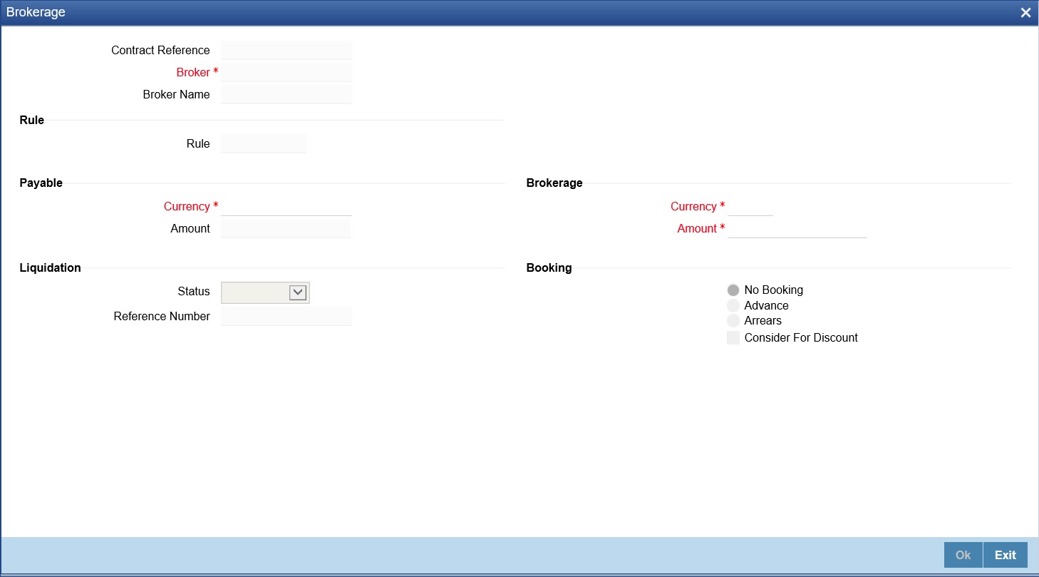

  3. On the Security Repo VAMI screen, click Brokerage.
    The Brokerage screen is displayed.
  4. On Brokerage screen, specify the details as required.
    For information on fields, see the section: Step 21. Brokerage

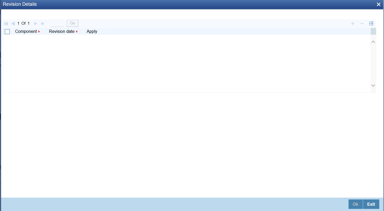

  5. On the Security Repo VAMI screen, click Revision Details.
    Revision Schedule Details screen is displayed.
    Figure 2-68 Revision Schedule Details
    Description of Figure 2-68 follows
    Description of "Figure 2-68 Revision Schedule Details"
  6. On the Revision Schedule Details screen, specify the details as required.
    Table 2-66 Revision Schedule Details - Field Description
    Field Description
    Component
    Displays Interest component
    Revision Date
    This is a mandatory field.
    Displays Rate revision date
    Apply
    Displays whether revision is applied or not

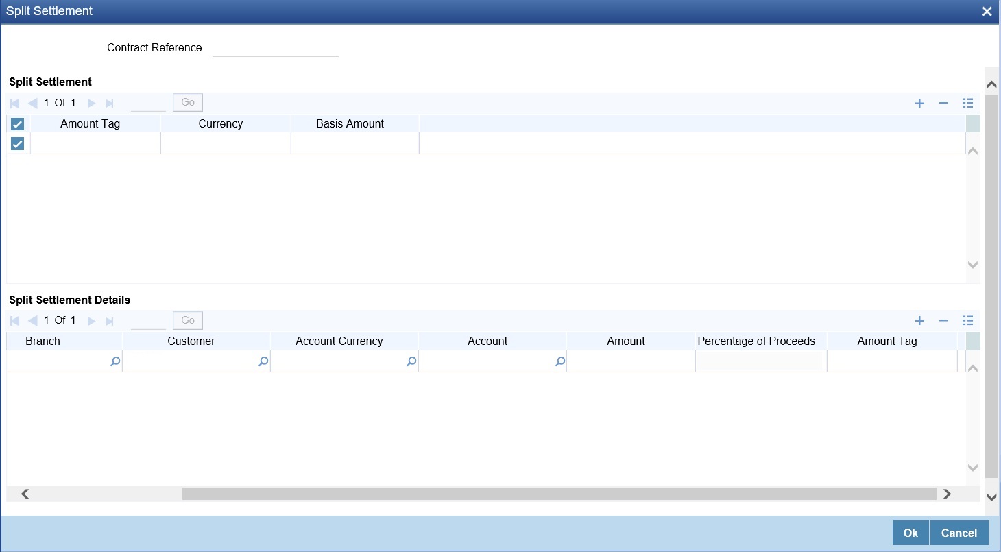

  7. On the Security Repo VAMI screen, click Split Settlement.
    Split Settlement Screen is displayed.
  8. On the Split Settlement screen, specify the details as required.
  9. On the Split Settlement screen, select a contract.
  10. On the Split Settlement screen, under the Split Settlement Details, click the + Icon.
    Split Settlement screen with New arrow is displayed.
    Figure 2-70 Split Settlement with a new row added
    Description of Figure 2-70 follows
    Description of "Figure 2-70 Split Settlement with a new row added"
    This process of splitting the settlements for a contract is allowed on the principal, Interest (Anticipated Interest for new contracts), and charges.
  11. On the Split Settlement screen, specify the details as required.
    For information on fields, refer to the below table:

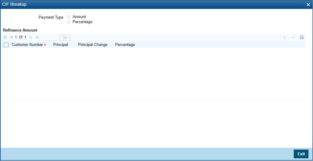

  12. On Security Repo VAMI screen click CIF Breakup.
    The CIF Breakup screen is displayed.
  13. On CIF Breakup screen, specify the fields.
    For more information on fields, see the below table:

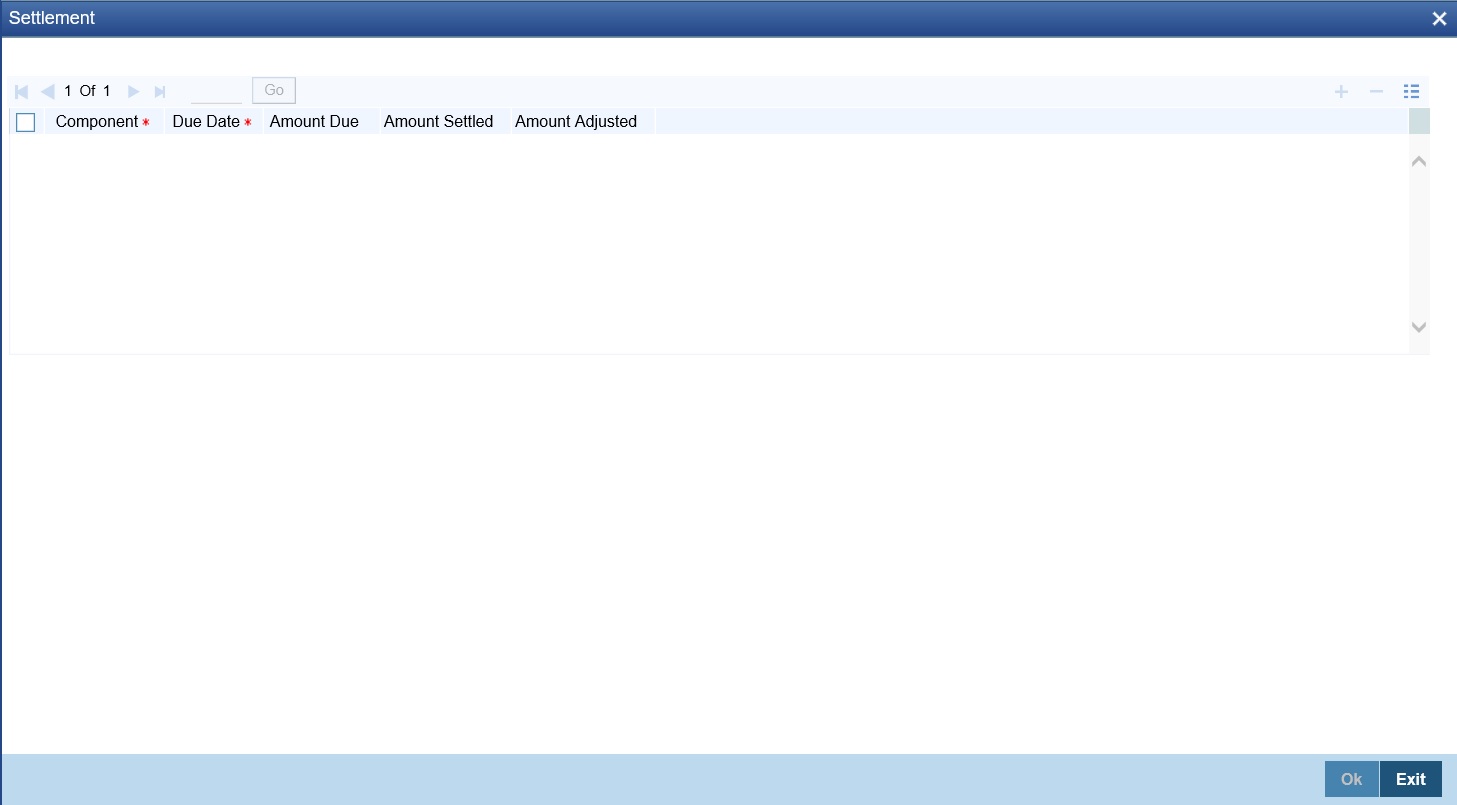

  14. On Security Repo VAMI screen click Settlement.
    The Settlement screen is displayed.
  15. On the Settlement Details screen, specify the details as required.
    For information on fields, refer to the Settlement User Guide.
  16. On the Security Repo Vami Screen, click Payment Details.
  17. On the Settlement Details screen, specify the details as required.
    Table 2-69 Settlement - Field Description
    Field Description
    Component
    Displays Component details
    Due Date
    Displays Payment due date
    Amount Due
    Displays Payment Due amount
    Amount Settled
    Displays Payment amount which is already settled
    Amount Adjusted
    Displays Adjustment amount

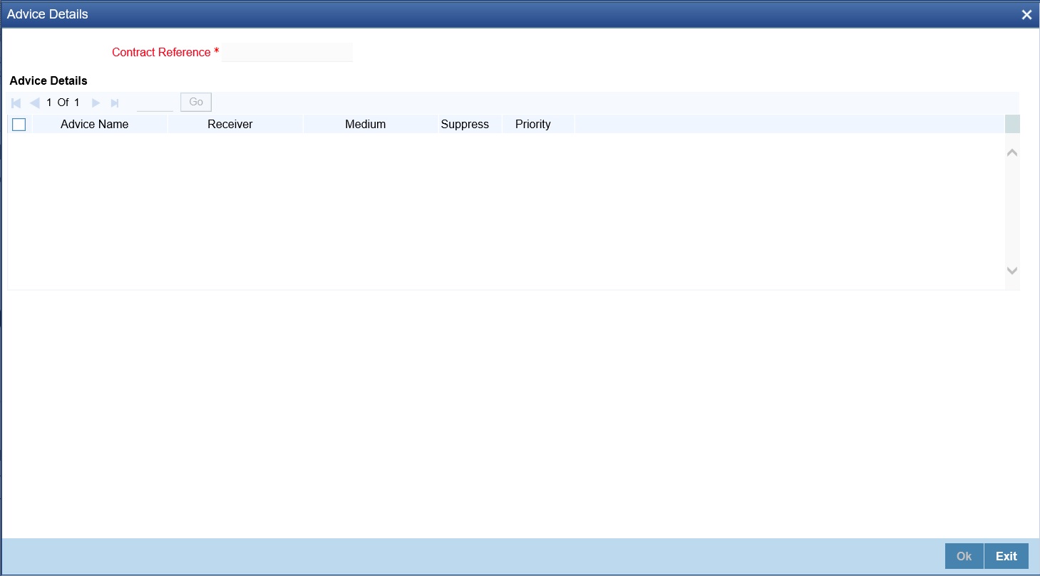

  18. On the Security Repo Vami Screen, click Messages
    Advice Details screen is displayed.
  19. On the Advice Details screen, specify the details as required.
    Table 2-70 Advice Details - Field Description
    Field Description
    Contract Reference
    Displays Contract reference number
    Advice Name
    Displays the Advice name applicable for the contract
    Receiver
    Displays the Receiver ID
    Medium
    Displays the Message medium
    Suppress
    Displays whether message must be suppressed or not
    Priority
    Displays the message priority

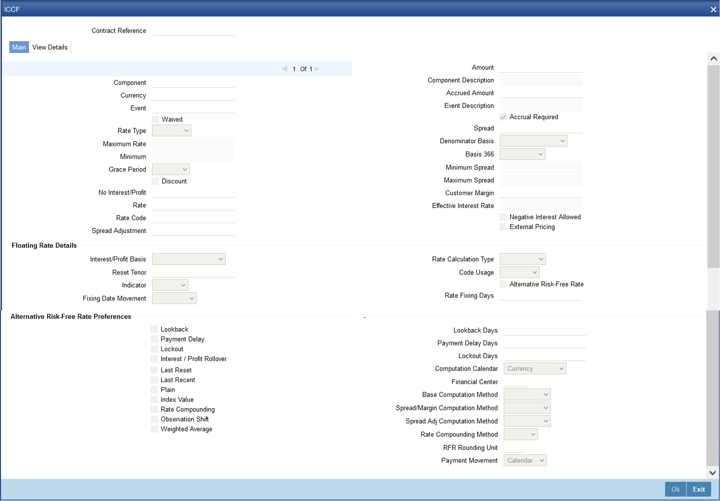

  20. On Security Repo VAMI screen, click Interest.
    ICCF screen is displayed.
  21. On Interest Details screen, specify the fields.
    Table 2-71 Interest Details - Field Description
    Field Description
    Interest Basis
    The method in which the number of days are to be calculated for interest, charge, commission or fee components and whether their application is tenor based is displayed here based on the specification the user made at the product level. The user can choose to change it. The following are the options available:
    • 30(Euro)/360
    • 30(US)/ 360
    • Actual/360
    • 30(Euro)/365
    • 30(US)/365
    • Actual/365
    • 30(Euro)/Actual
    • 30(US)/Actual
    • Actual/Actual
    • 30(Euro)/364
    • 30(US)/ 364
    • Actual/364
    Fixing Date Movement
    Select the movements from the drop-down list.
    The available movements are:
    • Forward
    • Backward
    • None
    as per the requirement for the effective revision date.
    Rate Fixing Days
    Specified the rate fixing days, If rate fixing days is greater than zero, movement is selected either as forward or backward. If rate fixing days is zero, then fixing date movement will remain blank.

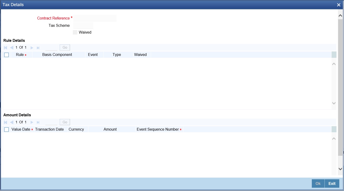

  25. On the Securities Repo VAMI screen, click Tax.
    The Tax Details screen is displayed.
    Figure 2-77 Tax Details
    Description of srdtronl__cvs_tax.png follows
  26. On the Tax Details screen, specify the details as required.
    For information on fields, refer to: Step 31. Tax
