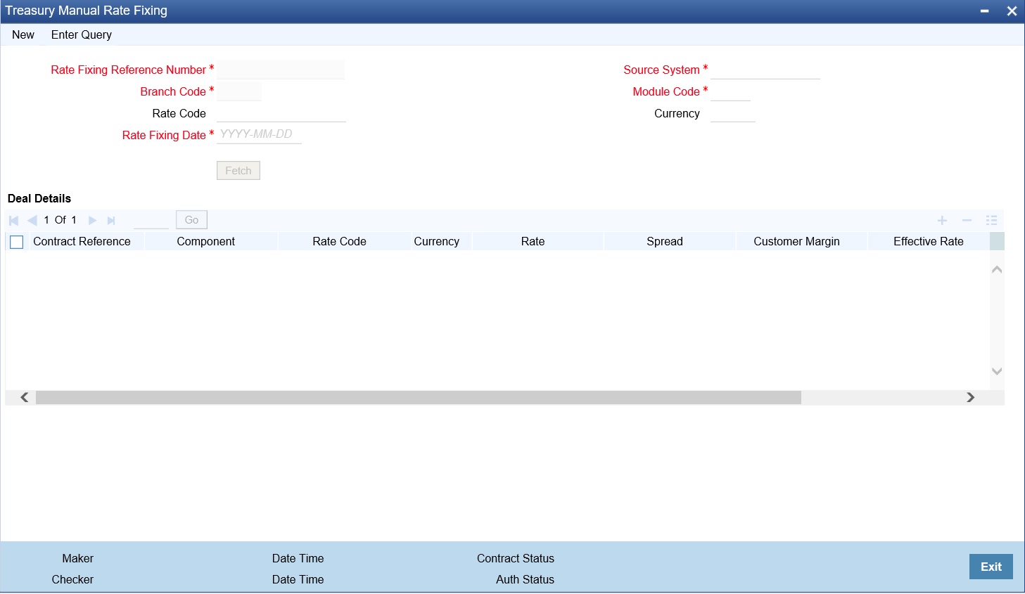

Use the Treasury Manual Rate Fixing to fetch the contracts which require rate fixing and also apply the rate fix on the selected float rate type contracts having the fixing date as the primary search criteria to query deals.
- On the homepage, type TRDMRTFX in the text box, and click the next arrow.
Treasury Manual Rate Fixing screen is displayed.
- On the Treasury Manual Rate Fixing screen, specify the details as required.

Table 2-64 Treasury Manual Rate Fixing- Field Description
Field Description Rate Fixing Reference Number
This is a Mandatory Field.
The system generates the reference number for rate fixing.
Branch Code
Specify the Branch code as per the requirement.
Rate Code
Specify the Rate code from the list of values displayed.
Rate Fixing Date
Specify the Rate fixing date as per the requirement.
Source System
Specify the Source System as per the requirement.
Module Code
This is a Mandatory Field. Specify the Module code from the list of values displayed.
Currency
Specify the Currency details as required from the list of values displayed.
The rate fixed contracts having status Authorized or Unauthorized is not listed here.
Contract Reference
Displays the contract reference number for which rate fixing is done
Component
Displays the interest component
Rate Code
Displays the rate code for which rate fixing is done
Currency
Displays the rate code currency
Rate
Displays the floating rate
Spread
Defaults the rate code spread from contract
Customer Margin
Displays customer margin from product
Effective Rate
Displays the effective interest rate
Rate Fixing Date
Displays the rate fixing date
Effective Date
Displays the effective date
