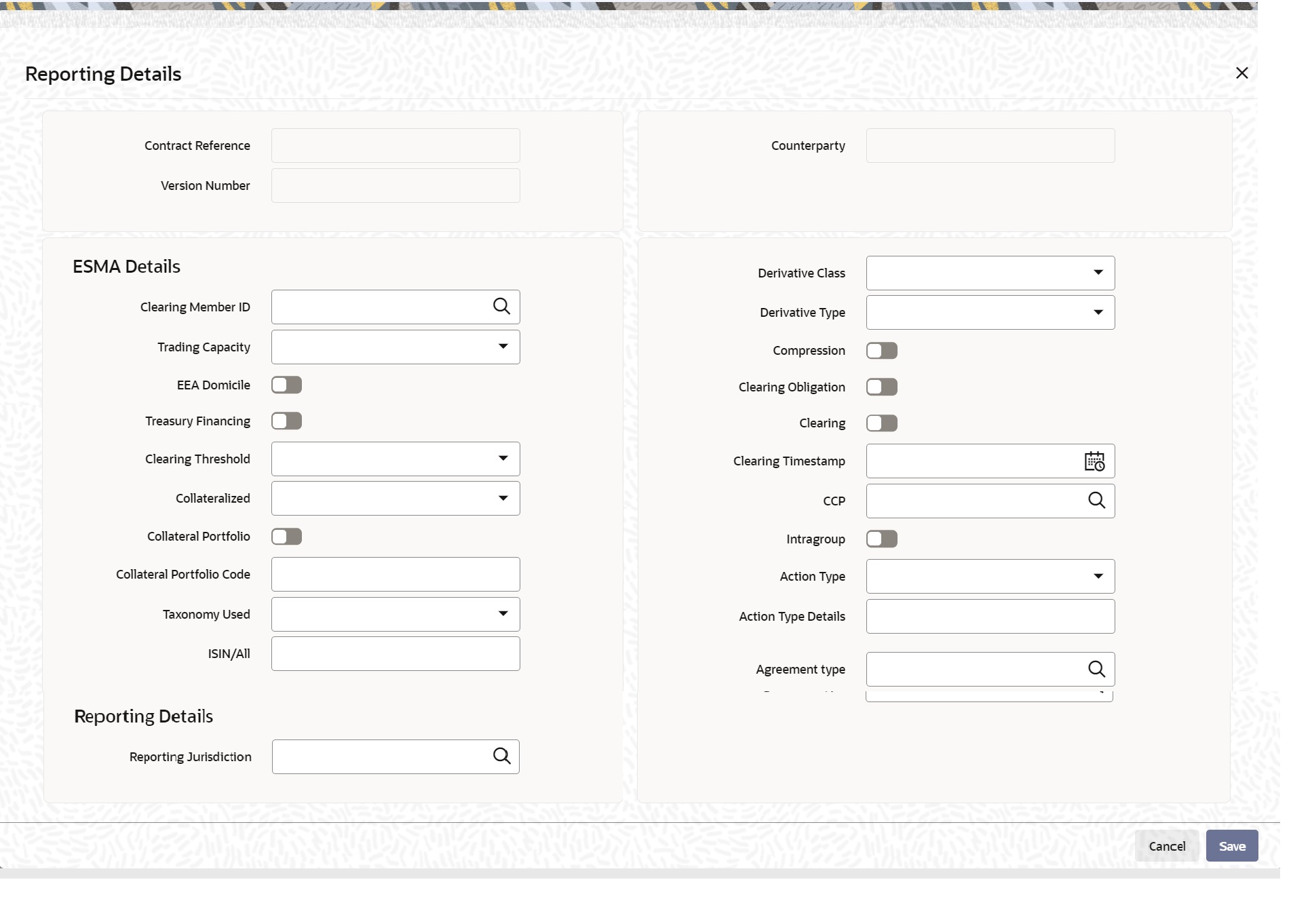

The ESMA Details call form is enhanced in Contract Input screen for assisting the third-party reporting system to report OTC trades in the required format of the respective CCP. European Securities and Market Authority (ESMA) introduced European Market infrastructure regulation (EMIR) reporting regulation to increase the transparency of the over-the-counter (OT) derivatives market, and to reduce the operational risk of the market.
  1. On the Contract Input screen, click the Reporting Details tab.
    The Reporting Details screen is displayed.
  2. On the Reporting Details screen, specify the details as required, and click Ok.
    For more information on the fields, refer to the below table.
