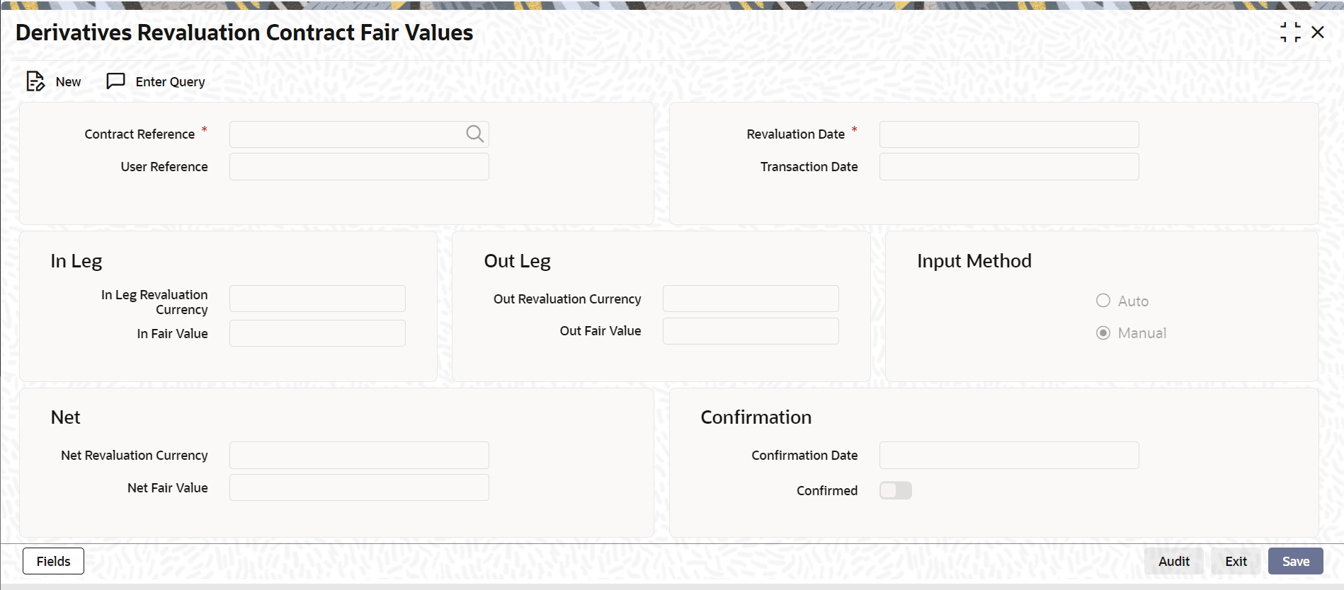

  1. On the Home page, type DVDCNVAL in the text box, and click next arrow.
    The Derivatives Revaluation Contract Fair Values screen is displayed.
    Figure 3-6 Derivatives Revaluation Contract Fair Values
    Description of Figure 3-6 follows
    Description of "Figure 3-6 Derivatives Revaluation Contract Fair Values"
  2. On the Derivatives Revaluation Contract Fair Values screen, specify the fields.
  3. On the Derivatives Revaluation Contract Fair Values screen, select new to change the revaluation frequency of a specific contract.
  4. On the Revaluation Contract Fair Value screen, select the reference number of the contact to change revaluation frequency. Enter the revaluation date, the new in and out leg values, and the net fair value.
  5. Select the Summary option under Contract Price to call an existing contract price maintenance record.
    On the Summary screen, double click a record to open it.
  6. Click the unlock icon or select Unlock from the menu to modify the in and out leg values. Enter the in and out leg values, and compute the new net fair value and save the record.
