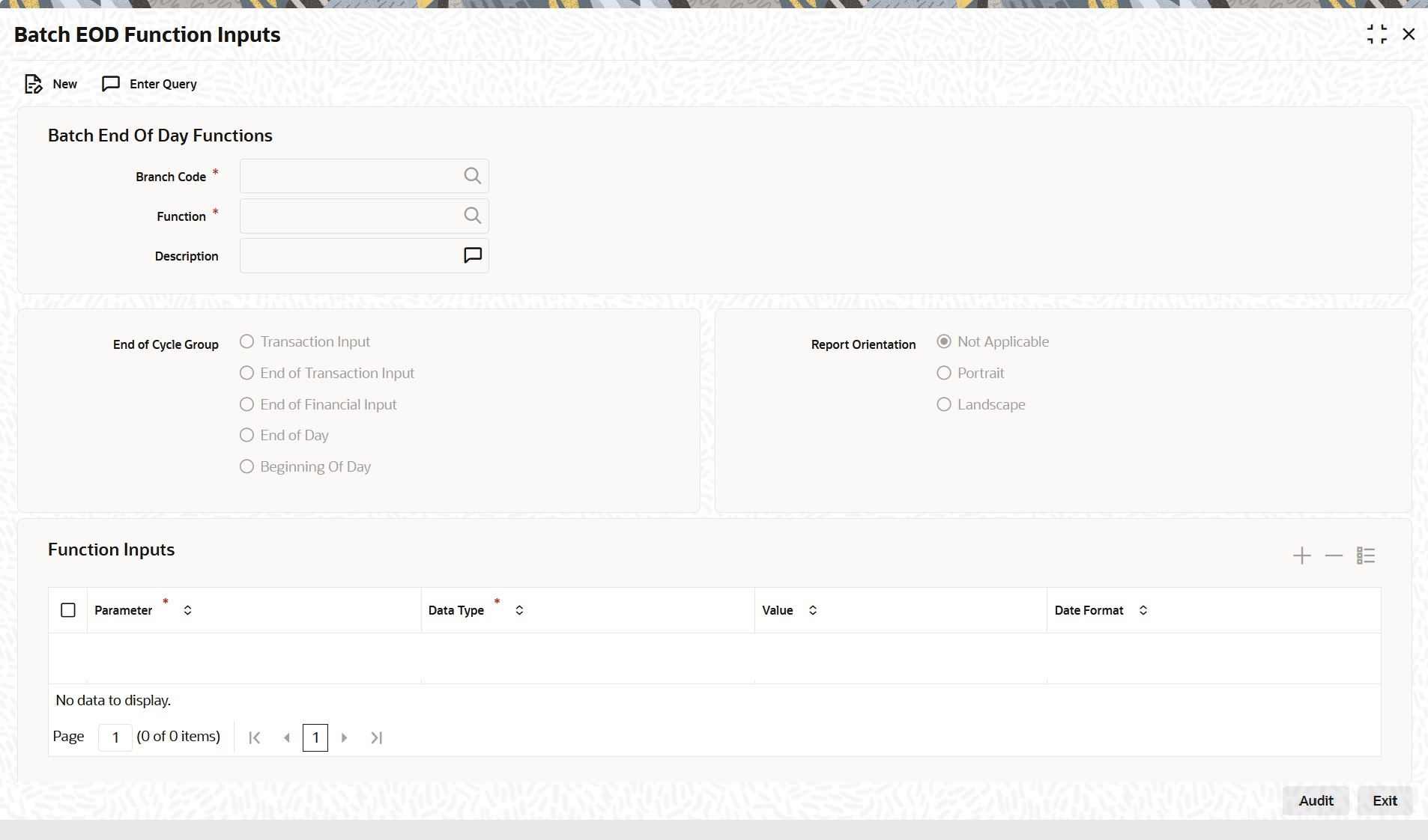

  1. On the Home page, type BADEODFE in the text box, and then click next arrow.
    The Batch EOD Function Inputs screen is displayed.
    Figure 9-2 Batch EOD Function Inputs
    Description of Figure 9-2 follows
    Description of "Figure 9-2 Batch EOD Function Inputs"
  2. On the Batch EOD Function Inputs screen, click New.
  3. On the Batch EOD Function Inputs screen, specify the fields details, and then click Enter Query.

    Branch Code
    Select the Branch of the bank involved
    Function
    Select the Function Identification of the EOD function
    • EDINPRHF for Instrument Price Details Hand-off
    • EDINSTHF for Instrument Details Hand-off
    End of Cycle Group
    Select the End of Cycle Group to which the function belongs (in this case you must choose End Of Day)
    Report Orientation
    Select Orientation of the generated report (this is optional)
    After specifying the above details, you can add the input of the function for the function in the Function Inputs table. You must mandatorily specify the Parameter and Data Type for each function. Now you can proceed with maintaining the Instrument Batch Hand-off process as a mandatory program.
