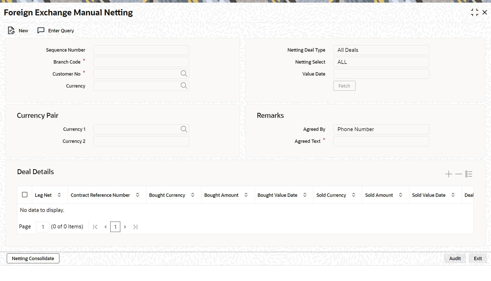

- On the Home page, type TRDMNNET in the text box, and click next arrow.
Foreign Exchange Manual Netting screen is displayed.
Figure 5-6 Foreign Exchange Manual Netting
Description of "Figure 5-6 Foreign Exchange Manual Netting" - On the Foreign Exchange Manual Netting screen, specify the details as per the requirement to initiate manual netting of FX contracts.
