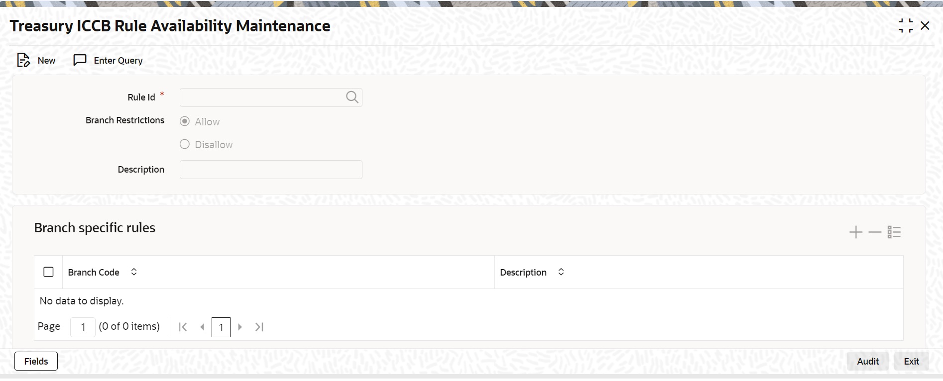

So far we have discussed the concept of a ‘main’ interest, the attributes of an interest component, and floating rate codes. Now, we go on to definition of an Interest Rule. An Interest Rule identifies the basic nature of an interest component. Each Interest Rule is defined by an alphanumeric code called the Rule ID. Attributes are defined for this Rule ID, which is then linked to a product. When a contract is processed, the interest attributes defined for the Rule ID linked to the product will be applied on the contract, some of which can be changed. An interest rule is created in the same way that any Interest, Commission, Charge and Fee (ICCB) rule is created, as follows:
               - The rule is created at the head office branch, by giving it a unique identification and description, in the ‘Treasury ICCB Rule Branch Availability’ screen. In this screen, the rule is made available for use in the required branches by maintaining an allowed / disallowed list of branches.
 - At the required branch, in the ‘Treasury ICCB Rule Details’ screen, the attributes for the rule are defined. Maintaining the attributes in this screen is subject to whether maintenance of ICCB rules is allowed for the branch, and also whether the rule for which attributes are being defined, is allowed for the branch. To recall, at the head office of your branch, you can create appropriate ICCB rules and make the rules available to the required branches.
In the Treasury ICCB Rule Availability Maintenance screen, you can maintain ICCB rules, which you can make available to desired branches. You can do this by maintaining a list of branches for which the use of the rule is allowed, or disallowed.
