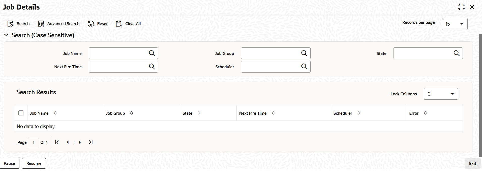

  1. On Homescreen, specify SMSJBBRW in the text box, and click Next.
    Jobs Details screen displays.
  2. On Job Details screen, specify the details.
    Table 4-3 Jobs Details - Field Description
    Field Description
    Job Module Select the job module from the drop-down list.
    Status Select the status from the drop-down list.
    • Stopped
    • Running
    • Halted
    Process Specify the process.
  3. Select any or all of the above parameters for a query and click Search button.
    The records meeting the selected criteria are displayed as follows:
    • Job Module
    • Process
    • Process Sequence Number
    • Status
  4. Check the required process in the search results table and click Start button to start the process.
  5. Click Stop button to stop the process, at any point.
  6. Click the Exit button to end the transaction.
