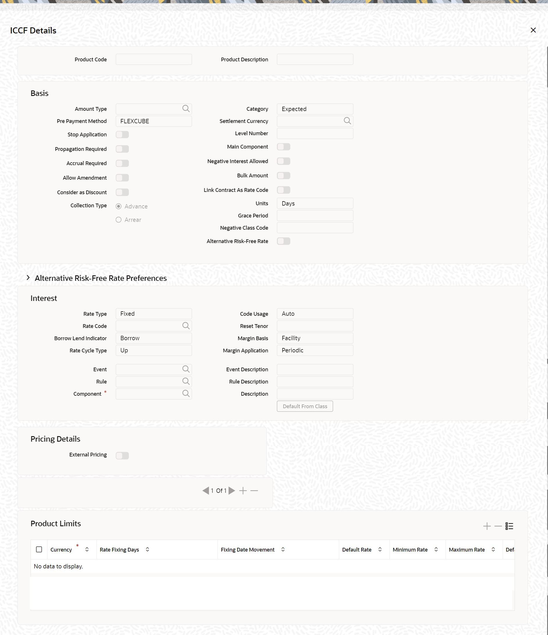

Use ICCF Details screen to calculate the interest that applies on a contract.
- Creating interest rules
- Building interest classes (specifically, for the Securities module)
- Associating a product with an interest rule (or an interest class in case of the Securities module). This rule applies on all contracts processed under the product.
- Amending, if required, certain interest details that a contract acquires from the product under which it is processed
- Click the Interest button in the Product Definition screen to invoke the ICCF Details screen.The system displays the ICCF Details screen.
- In the ICCF Details screen, specify the fields.In this screen, you can associate the product you are creating with an Interest Rule. The attributes defined for the interest rule or class that you link to a product default to all contracts processed under the product.
For products created in certain modules of Oracle Banking Treasury Management, you may have to specify additional interest details. These details have to be specified in the Product Preferences screen of the module.For detailed explanation on the fields, refer to the below table.Table 1-2 ICCF Details- Field Description
Field Description Amount Type
Specify the basis on which interest has to be calculated. By default, the principal will be taken as the basis.
Pre Payment Method
The prepayment method identifies the computation of the prepayment penalty for the contract.
Stop Application
Select this check box to stop application.

Accrual Required
Select this check box if the accrual is required.
Allow Amendment
A change to a contract (after it has been authorized) that involves a change in its financial details constitutes an Amendment on the contract. The user can indicate whether such an Amendment, called a Value Dated Change, must be allowed for the interest component being defined.
The user can amend the following through this function:

Collection Type
Select the collection type. The options are:
- Advance
- Arrear

Level Number
Grace Period and Level Number
The user can apply interest at various levels:
- Main interest on principal – Level 0 (Category: Expected)
- Interest on overdue interest – Level 1 (Category: Overdue)
- Interest on Level 1 interest – Level 2 (Category: Overdue) … and so on.

Alternative Risk-Free Rate
Select the Alternate Risk-Free Rate check box to enable the Alternate Risk Free-Rate preferences. Rate Type
The Rate Type indicates whether the interest is a Fixed Rate, a Floating Rate or a Special amount. When creating a product, the user must specify the Rate Type through the ‘Product - ICCB Details’ screen.
If the Rate Type is a Floating Rate, the user must also specify the Rate Code to which the product has to be linked.
Rate Code
Each Rate Code corresponds to a rate defined for a combination of Currency, Amount (if it is necessary) and an Effective Date. These details are maintained in the Floating Rates table.
This rate will be applied to contracts involving the product.

Interest Basis
This field indicates how the system must consider the tenor basis upon which interest is computed over a schedule or interest period, in respect of the interest component being associated with the product.
Denominator Basis
This field indicates the interest methods which have their interest basis set to ACTUAL i.e. 30(EURO)/ACTUAL, 30(US)/ACTUAL and ACTUAL/ACTUAL. Denominator Basis is used to specify how the month of February is treated when the denominator is 'Actual'. There are two types of denominator basis methods:- Per Interest Basis – Here the computation would be done based on ACT/ACT–ISMA Interest Method. In this case, the '366 Basis' field will not be applicable.
- Per Annum (A) – Here the interest calculation will depend on the value the user specify for 366 Basis
366 Basis
This is applicable only if the Denominator Basis is set to 'Per Annum'. The user can select one of the following values here:
